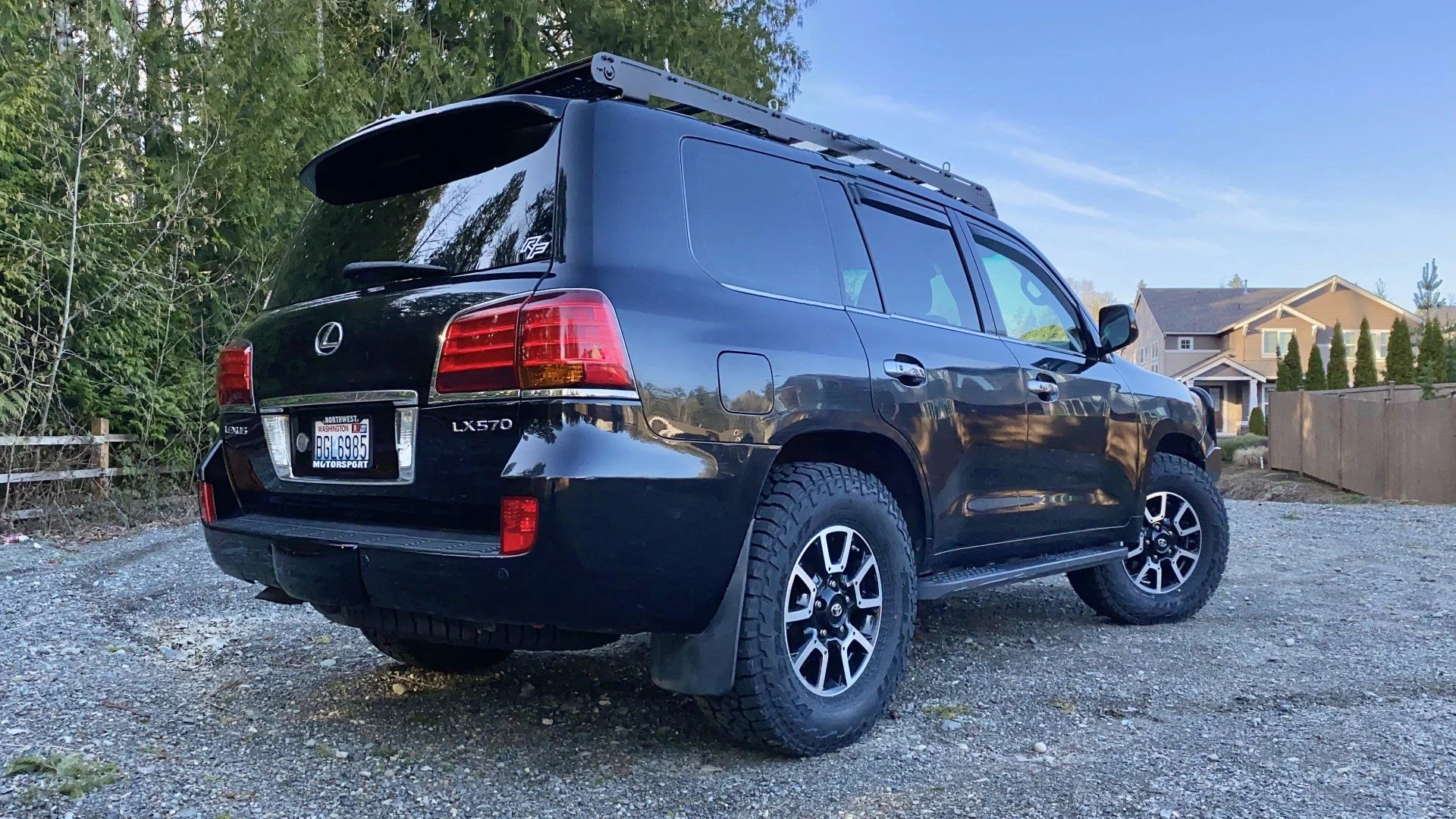

Falken Wildpeak 295/70/18
This week I concluded the 12k mile mud terrain experiment and decided to go back to an AT tire.
If you are a considering a mud-terrain, here's what you'll love:
  • Absolutely velcro-like traction in dirt, mud, clay, rock, and fresh powder. I never ever got stuck with them.
  • Nearly indestructible 3-ply sidewalls.
  • Brutally handsome good looks. Who doesn't like a knobbly sidewall, especially on an understated dad or mom mobile?
  • You'll get a nod of approval from your tire installer.
Here's what you'll compromise on:
  • They will be loud and hum and thrum and different speeds. We just did a road trip to the coast and it was miserable at hour 4.
  • The sidewall is really stiff. Mine were stiff for first 5k miles even after much aired-down use.
  • They absolutely will scare you in in any snow other than powder. Seriously — the factory dunlops would be an improvement.
  • They will be noticeably heaver than a comparable AT.
I don't regret trying the MTs—now I know they aren't for me.

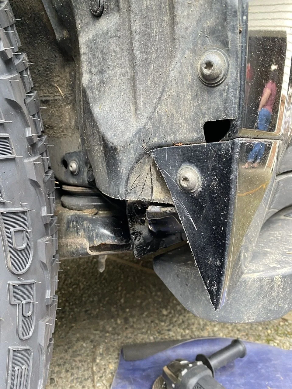

Tidying up and taking care of the last bit of rub. Hat tip @TeCKis300 and @radman for the suggestions!
I used a multi tool to cut off the inside bolt and flap of the rocker panel. Next I used a 4” grinder and cutoff wheel to remove the bracket. I cut 3/4 way up and then the rest broke off with some vice grips. I filed down and painted. 10 minute job and no more rubbing.
Too funny. This exact same “tidy up item” is on my agenda this weekend!

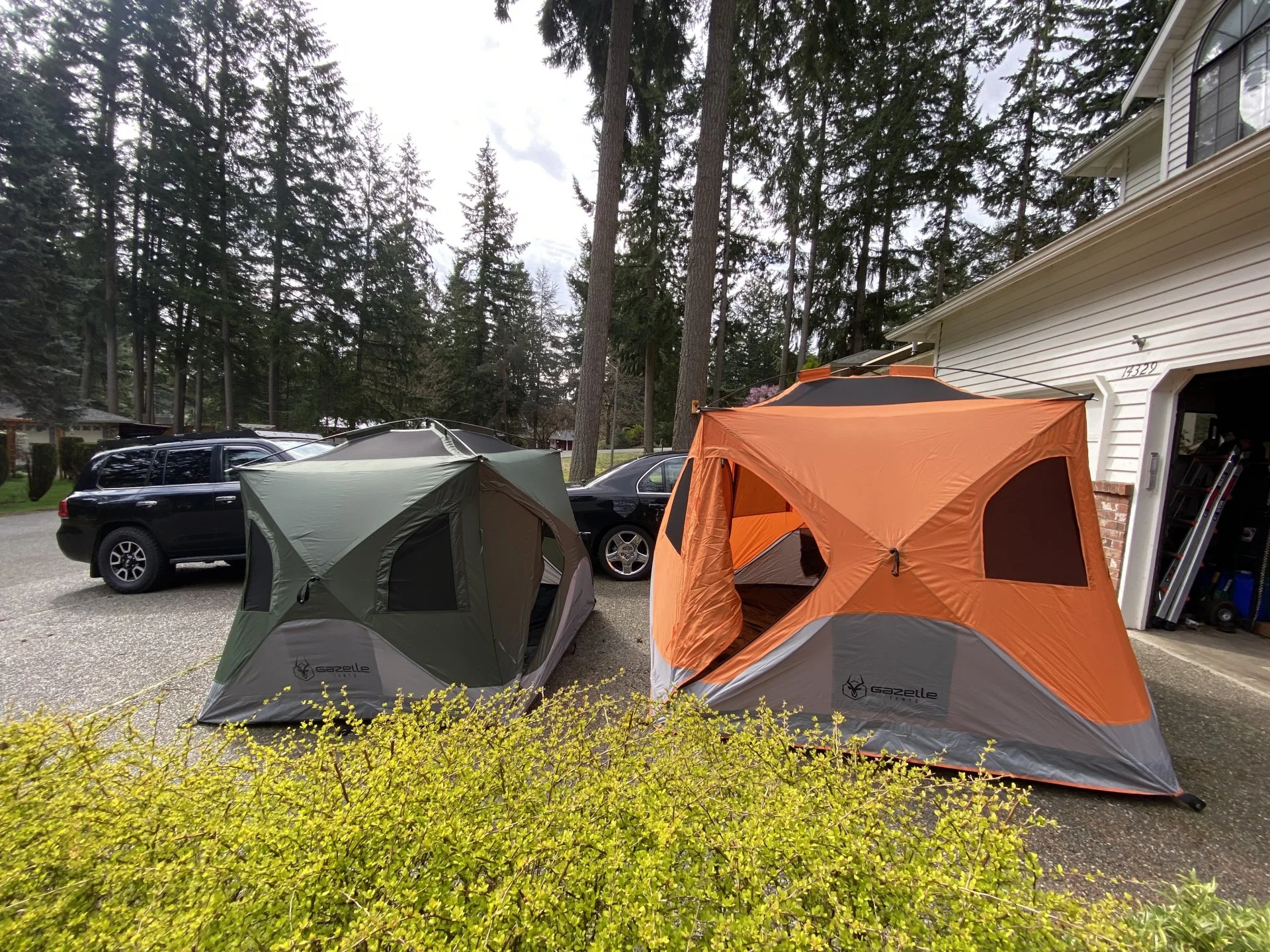

New tents
For the last 4 years we’ve camped with a cheap “instant cabin” that was easy to setup but very impractical and poorly made. And for trips without my girls it was not practical. Rather than re-up on a big tent, we went modular and got Gazelle T3 and T4:
This setup will be so practical for my family. My wife and dogs in the orange tent, girls in the green. Or for solo trips I can just take the smaller T3.

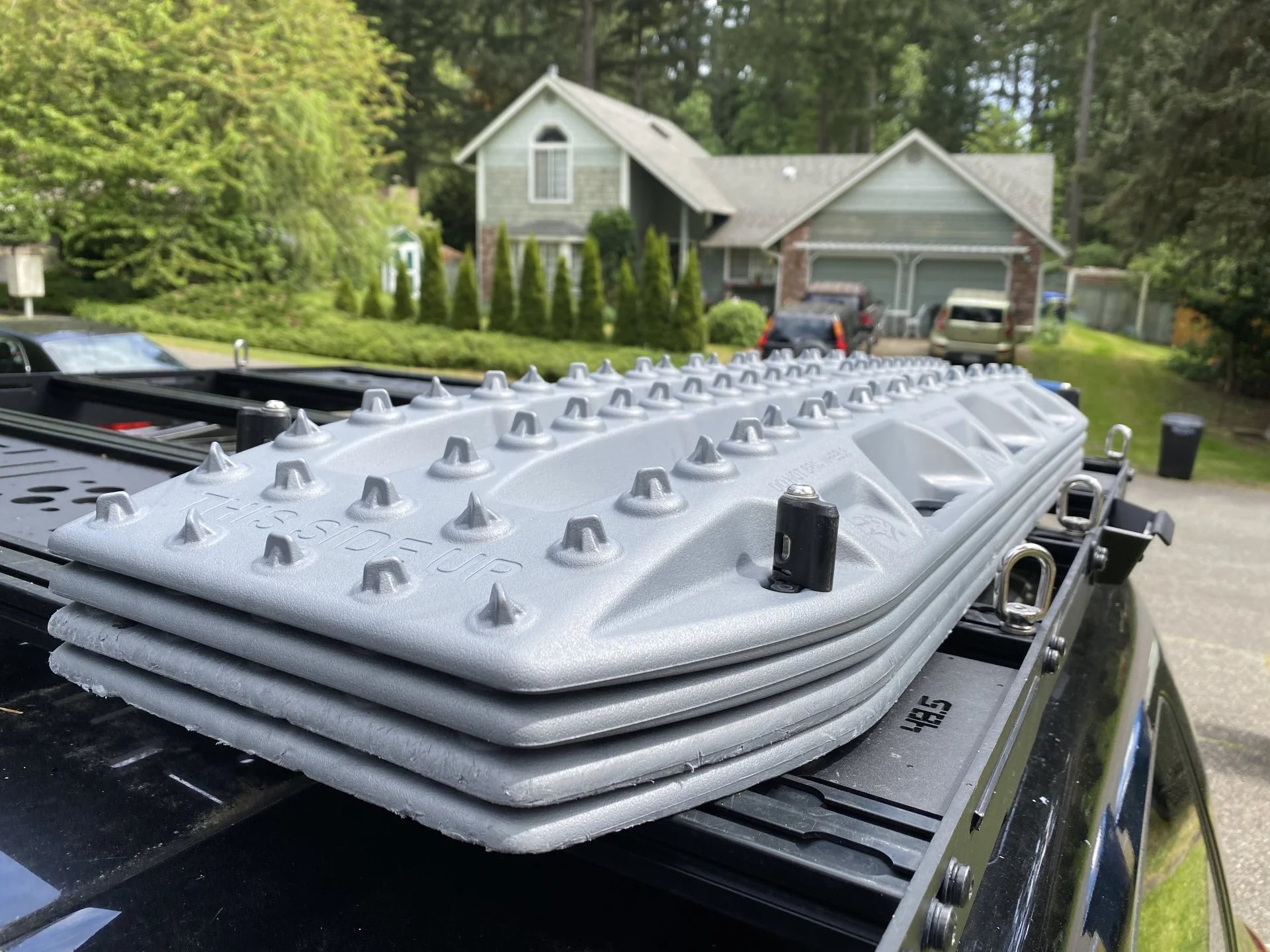

Recovery
After nearly failing to self recover in a open snow field earlier this year I finally picked up a second set of maxtrax. For a truck this size you really need 4 boards. And the brand is worth the premium. I’ve witnessed first hand the generic boards snap and chip - but not these.

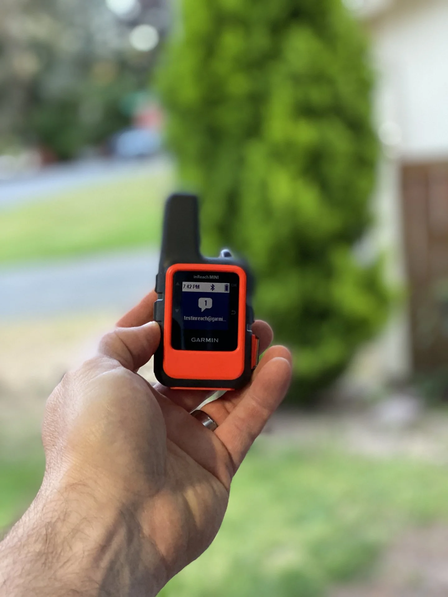

When all else fails
In the event that I cannot recover, or injured or something worse, a Garmin InReach adds some peace of mind. They recently added more flexible monthly plans making it more practical to justify.

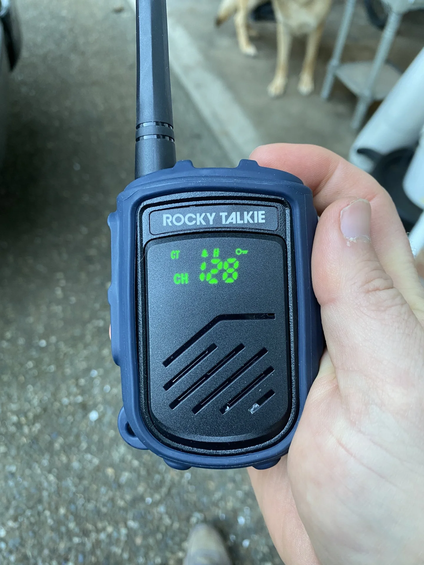

Comms
The batteries on my cheap midland FRS radios where barely holding a charge so trying something new. Picked up a Rocky and other than it not having a clip I really like them. The charge with USB-C and I save battery by not having an always on screen.

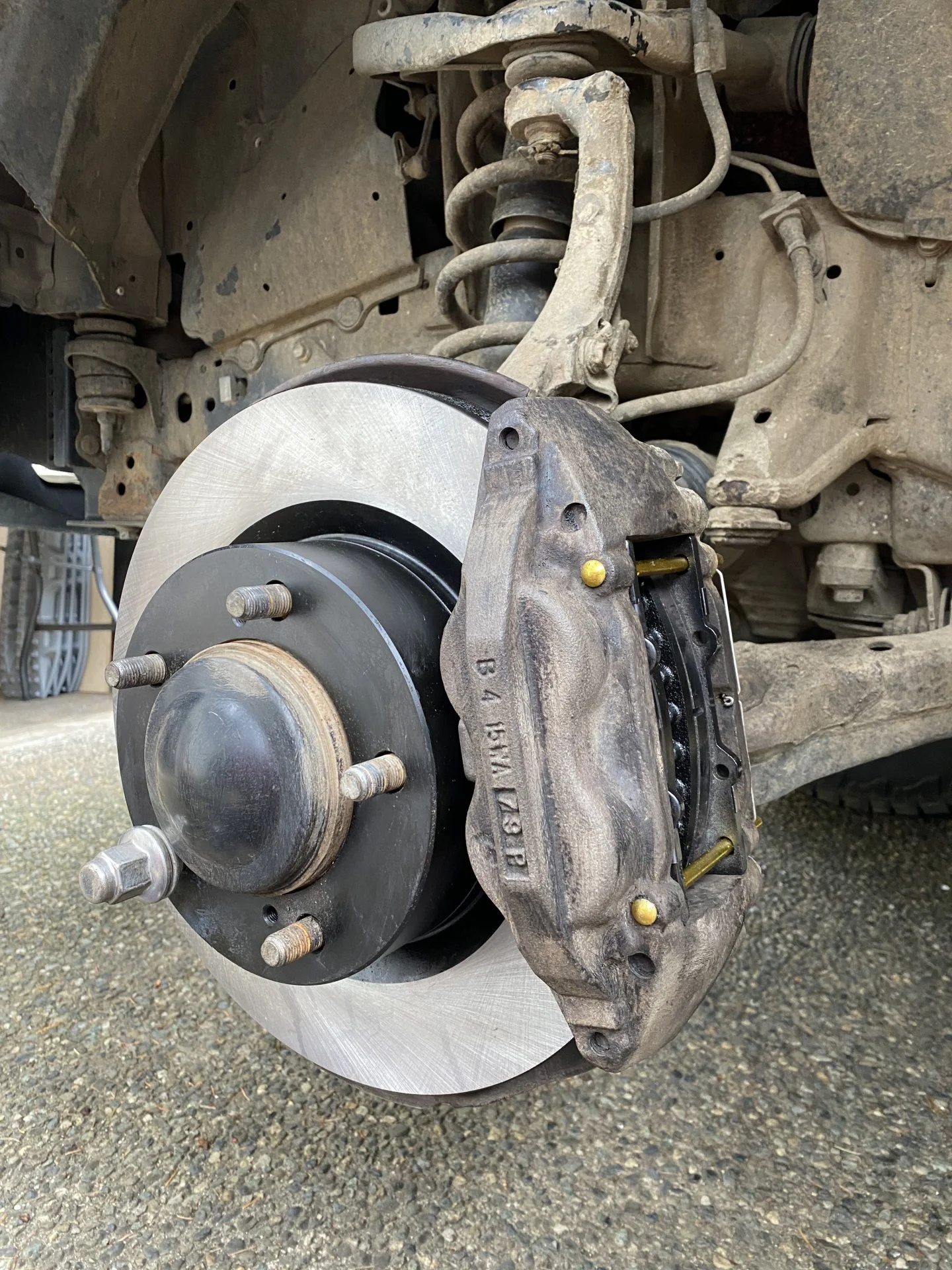

Brake refresh
I was up against the wear indicators on the front so decided to refresh everything. There was absolutely life left in the rotors but I find getting them turned very impractical. Very happy with hawk LTS pads and centric coated rotors.
Button up by having my local Indy do a fluid flush and vacuum bleed.

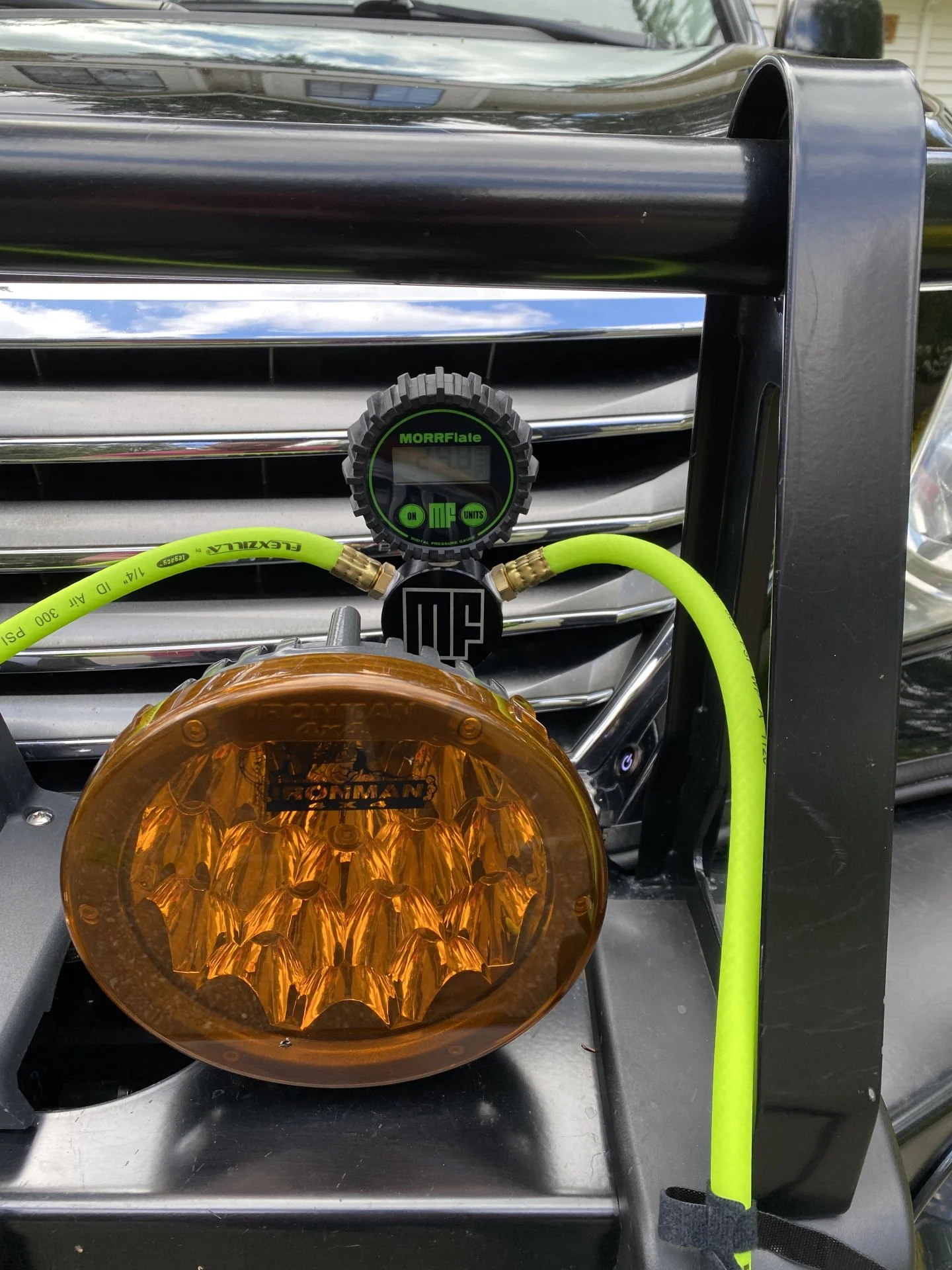

Morrflate
I cant believe that I waited so long to hop on this bandwagon. Absolute game changer.

New tents

Morrflate

New tents

Morrflate

The gazelle stuff is really nice and high quality, but for the life of me, I cannot understand why they don’t use aluminum poles. Even if I doubled the price, it would be comparable to other high end tents. Still, they make great stuff.
On morflate, I am with you. What a nice bit of gear. Seems expensive, but all the components are top-line, and I’m not sure you could replicate it cheaper factoring time. Even though I have a modest compressor, it was great to be able to sit back and not have to babysit each tire.
It’s nice to have it all debugged for sure, and I just looked at that manifold and it’s pretty neat. I might build a v2 with a manifold, but this is an easy 1 hour project either way. Parts are about $100 (Four outlets using a t instead of the manifold)
Yeah, I thought about a DIY, and I have no doubt that you could do it in an hour. Me on the other hand, it took me an hour just to think through all of the parts. On top of all the other projects I’ve had going on the past few months, I decided this was one that I could happily outsource. Plus I like to support the local guys when I can.
Having said all that, I am not sure if it is my tpms or their gauge, but one of them is about 3-4 pounds off. I pulled out my arb gauge and it was off the other direction from my tpms. So at this point I’m not sure which gauge is most accurate, but I am going to try to do some calibration this weekend.

New tents

Morrflate

I’ve been within a credit card thickness of throwing down on a Gazelle tent for the last six months, but just haven’t pulled the trigger. Will be looking forward to your impressions. Also, where did you order the tie downs for your Prinsu…they look much beefier than the ones supplied with the rack.
Nice updates👍
Nice updates👍

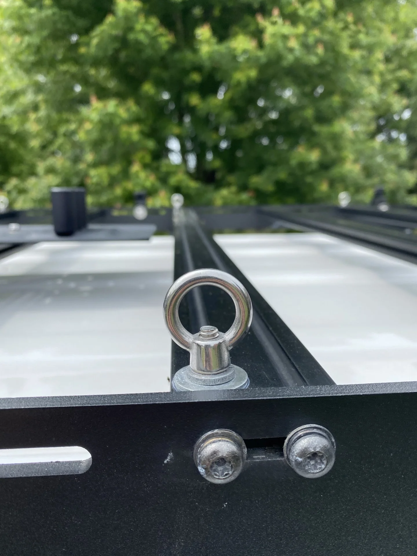

Hey! They are in fact the prinsu tie downs. I ordered a couple of extra sets.
One thing I’ve noticed is that they will rattle loose. I’ve lost a couple on the trail. I try to make it habit to check them when I air up snd down.
The gazelle stuff is really great. My buddy had one of the big hub tents and it’s been bulletproof. The zippers are beefy, the material is beefy, and I love that they are standup height.
Nice. I have a pre- CBI Prinsu that I bought used from another MUD member, and these are the included tie downs.
And after our camping trip this weekend I think I’ve decided to go with the Gazelle. We have a really nice Big Agnes tent, but there’s something really appealing about the rapid setup/ breakdown times for the Gazelle.👍
