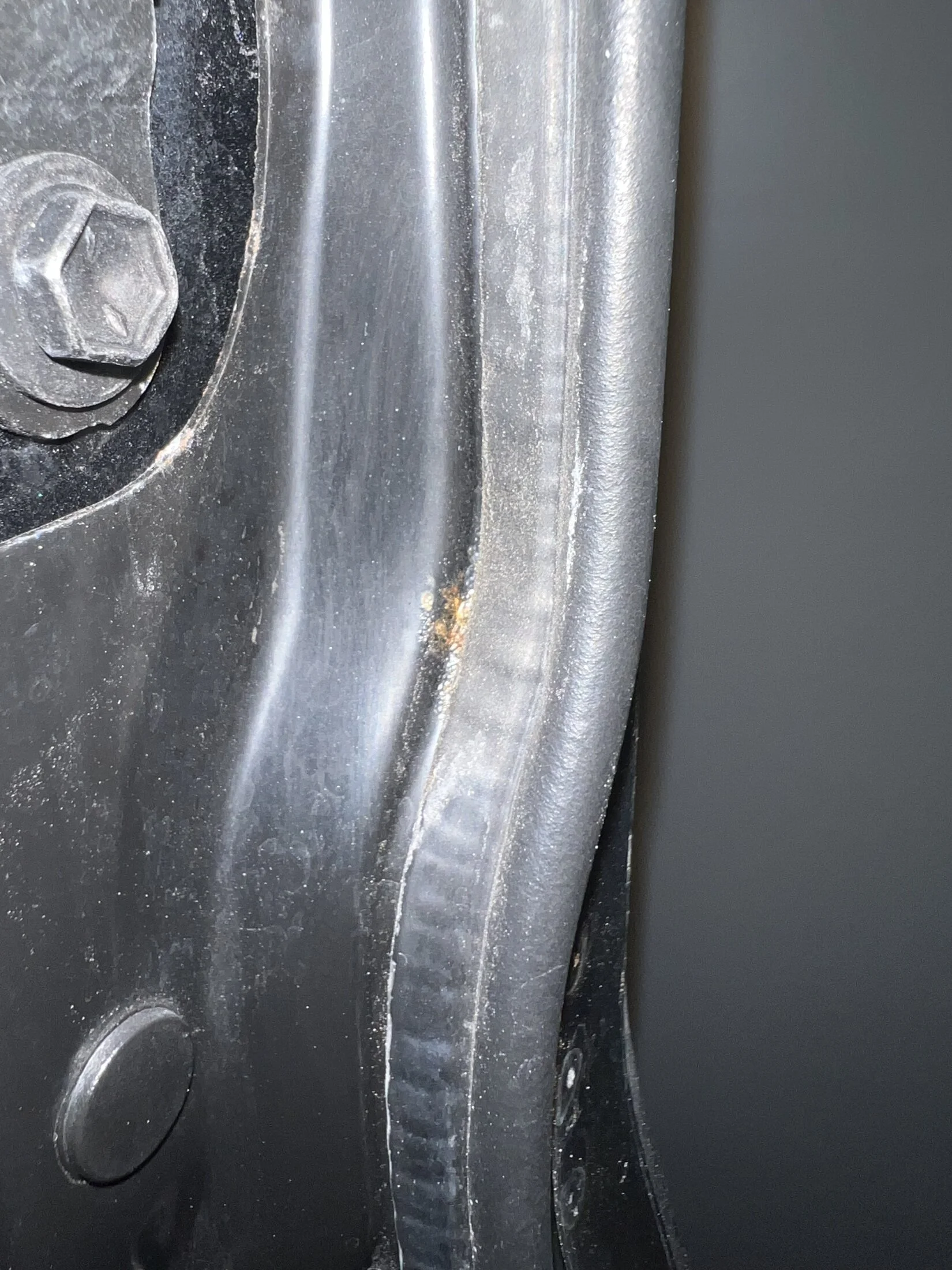

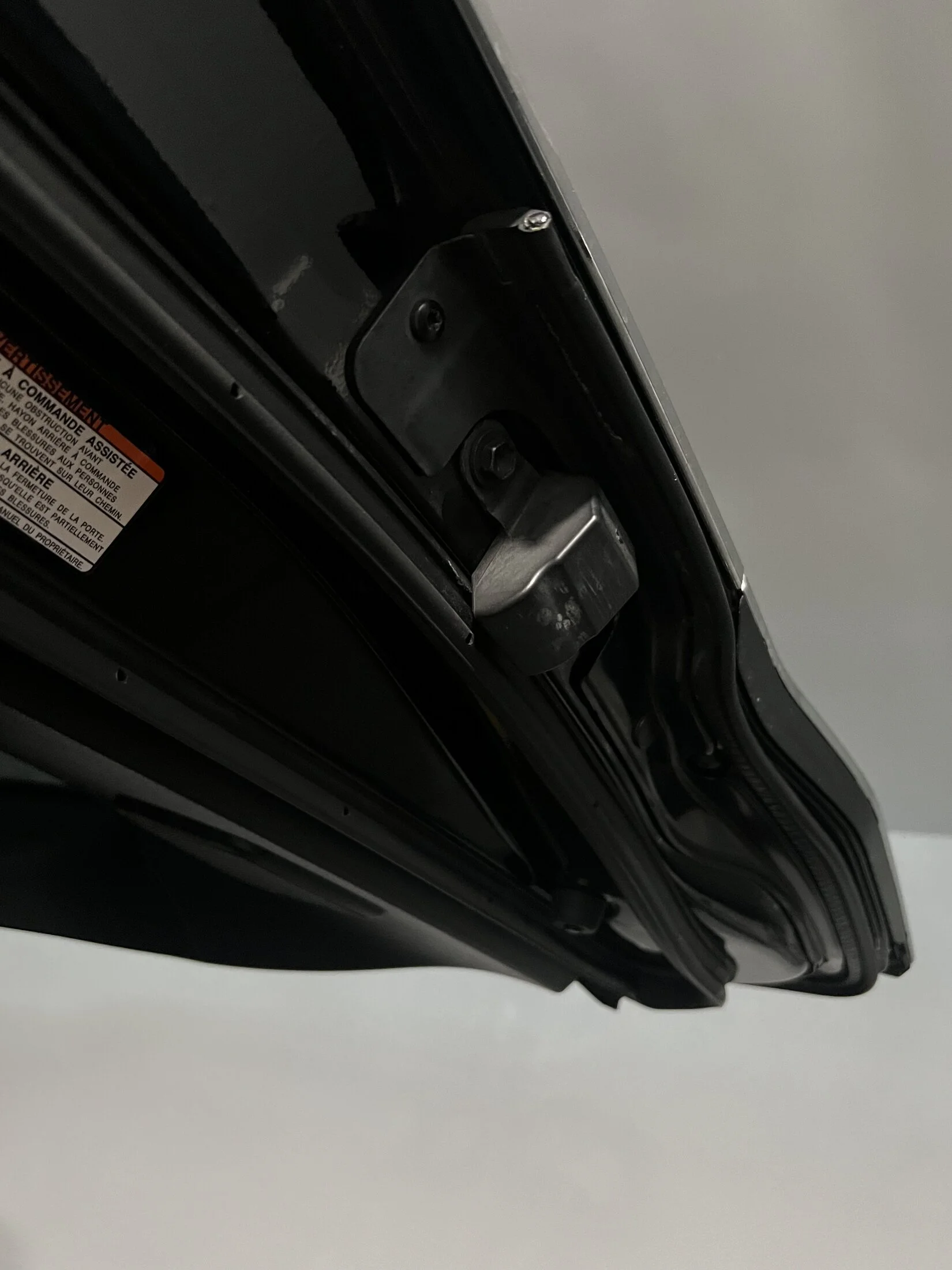

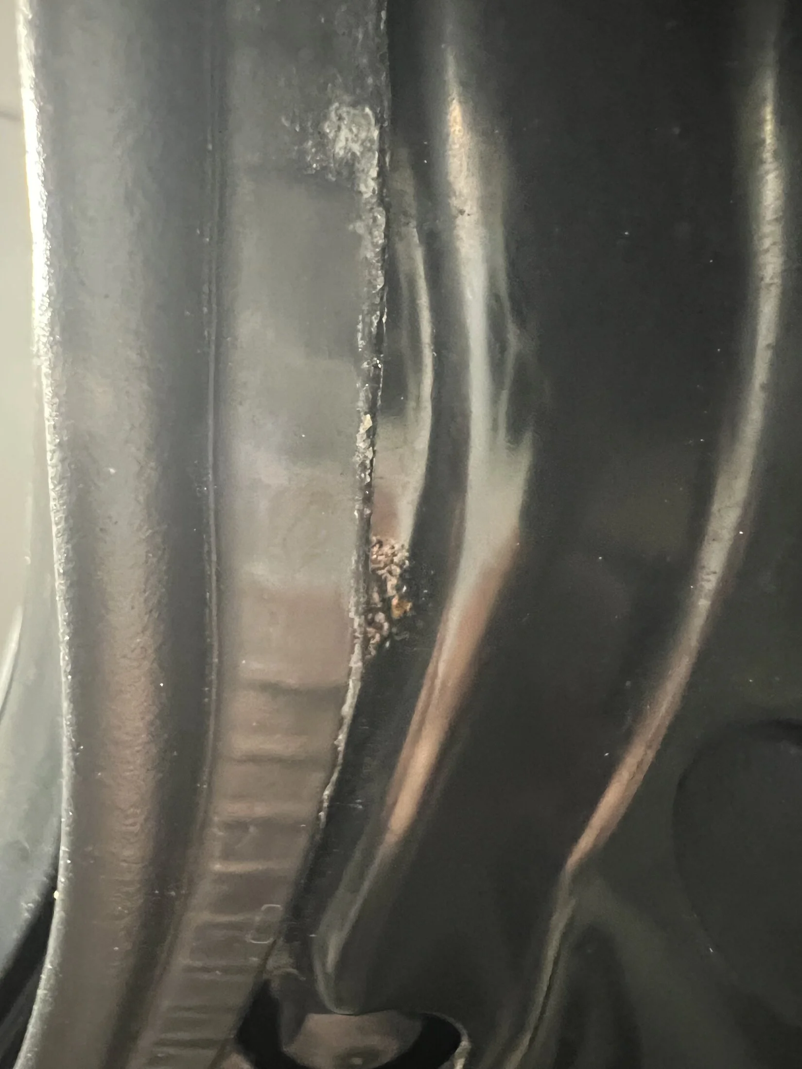

Hi All,
Does anyone know if this small sheet of metal is removable? Has anyone done it before? Im thinking of removing to get it sanded and repainted, Thanks
Yes they are. It's part of the rear door sensor and each side retails for about $600.
I've done it on my rig although it was in much better conditions than yours. Careful with sanding and repainting. The sensor well has a sensor in it and wires. Paint yes, powder no. Judging by the amount of rust it looks like sand blasting is in order. Take care to protect the sensitive parts.
Here is a recent thread where someone went in and tried to fix. Just be careful. Sometimes the juice isn't worth the squeeze.
