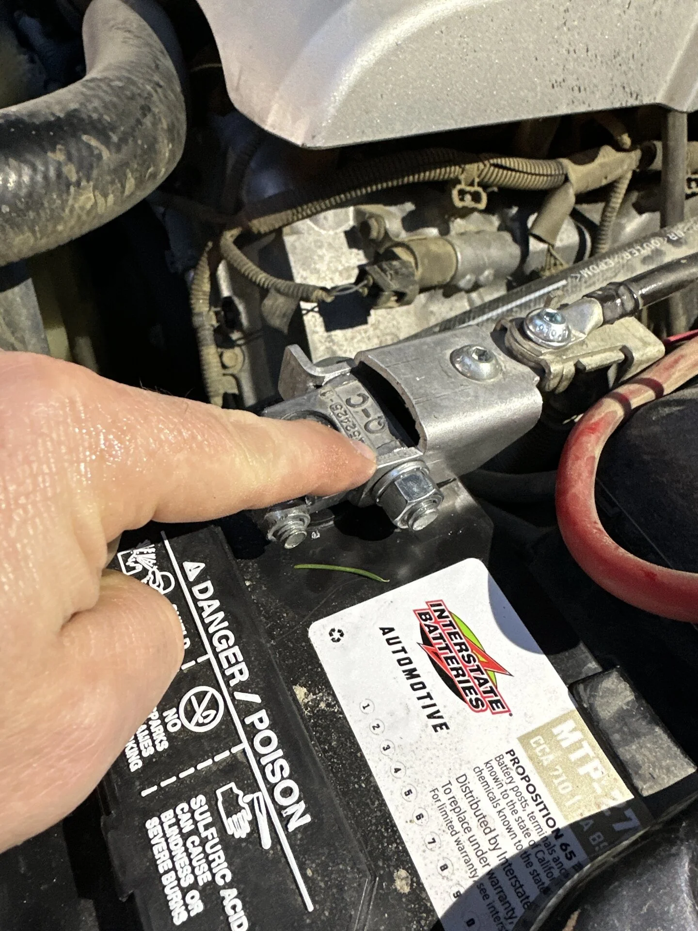

Tell us about those post terminals . . . lots of these issues have come down to faulty terminals
Positive is the old slee "upgraded" terminals, the onese before billet. They are really for a group 31 - I'm not running the negative one because it wouldn't fit. So it's a stock negative terminal.
those terminals have a lot of posts on them . . . with the issues you describe

I can't say every set ever made from the gen 1 extensions isn't working great, but there are lots of threads where this comes up and the fix is replace with something else, and that fixes the problem. Often the replacement is another builder sourced aluminum billet extension for $150.
I personally extended using a quick disconnect on negative, and a $20 piece of copper bar for positive.
<edit - there are plenty of $25 to $50 extensions in the audio amplifier scene as alternatives, too>

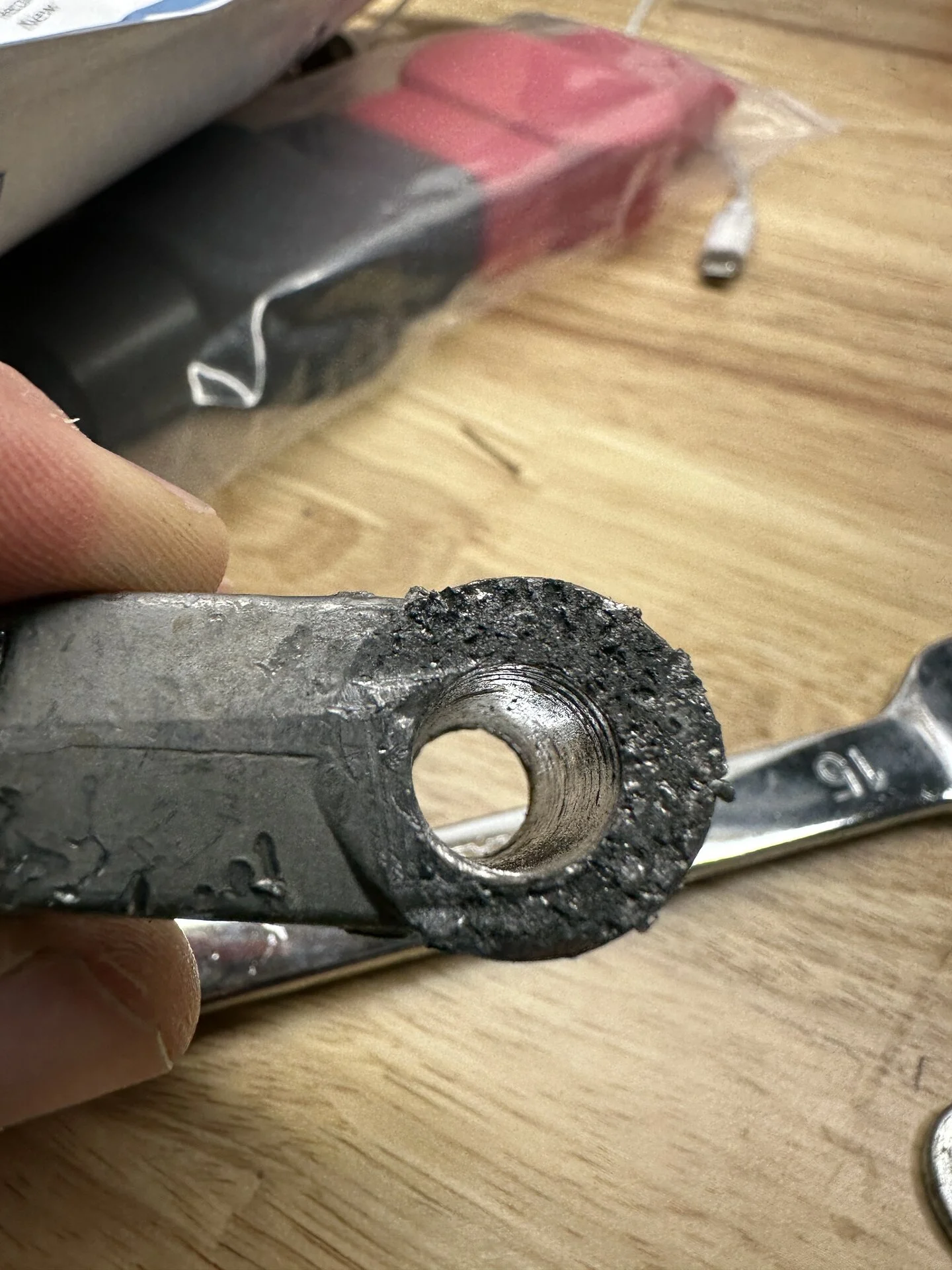

Holy s***. @grinchy called it.
The inside of my terminal and the extension are incredibly pitted.
among my mud friends, I’m no longer convinced this wasn’t a wild good chase and I just preemptively replaced my starter.
You’re just practicing patience and became more familiar with the starter replacement process to help the next guy out.
I didn’t think of my own issue until I saw your picture of your old Slee terminal and thought, “I wonder if…” And sure enough, @grinchy had already commented it 👌🏼
It says QC right on the terminal. That is some next level subliminal right there.
If it makes you feel any better, I believe you did have a starter issue based on the original symptoms. The way I see it is that your terminals and battery ultimately failed as a result of how things played out. Helped along by the deep draw from winch use.
Lead acid batteries tend to release gasses when they're stressed. In a long pull and with deep discharge, they'll out gas exascerbating any corrosion that was already there. And finally caused these other things to give up the ghost.
Good thing is you're re-baselined on these components and good to go.
