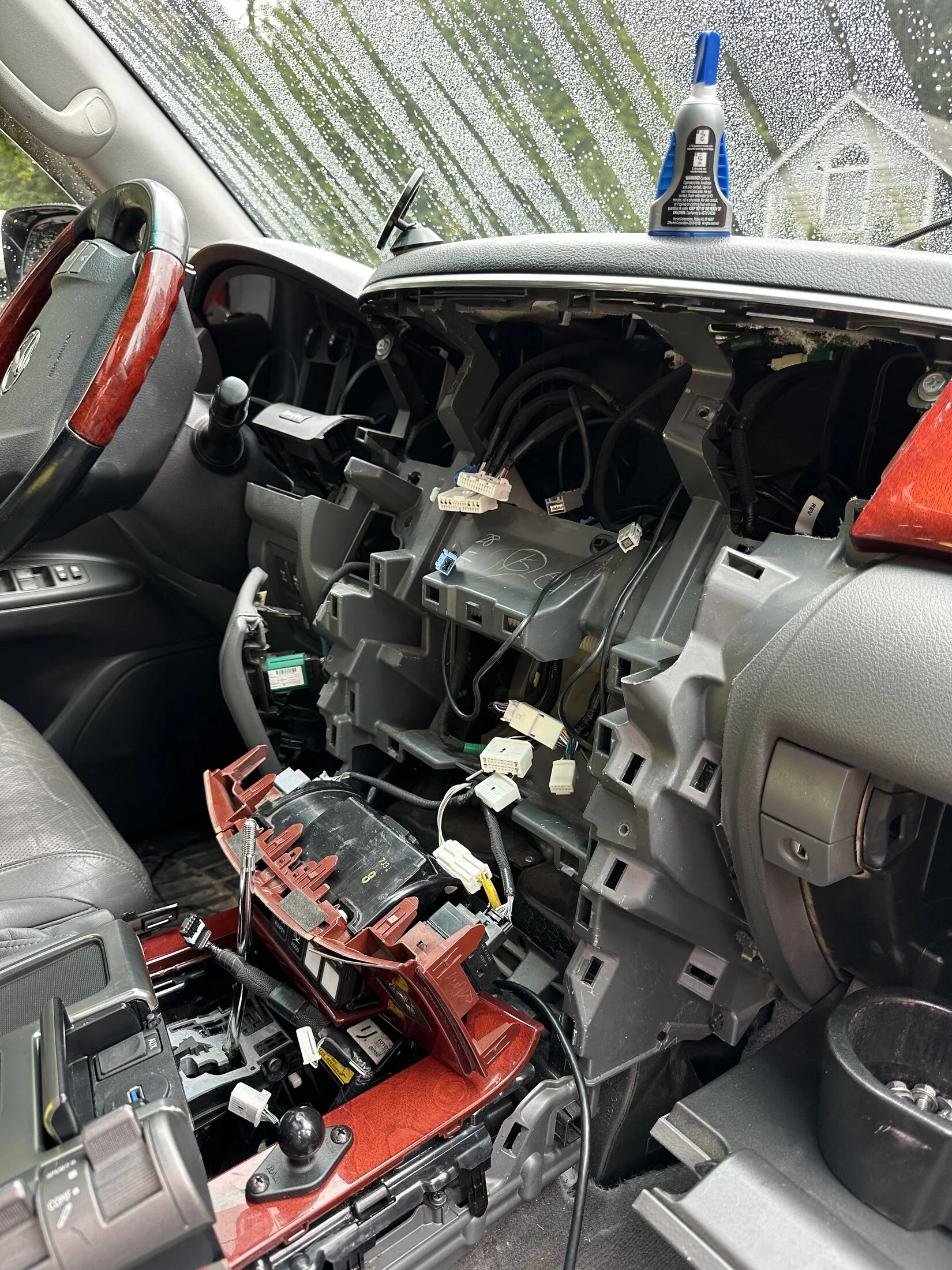

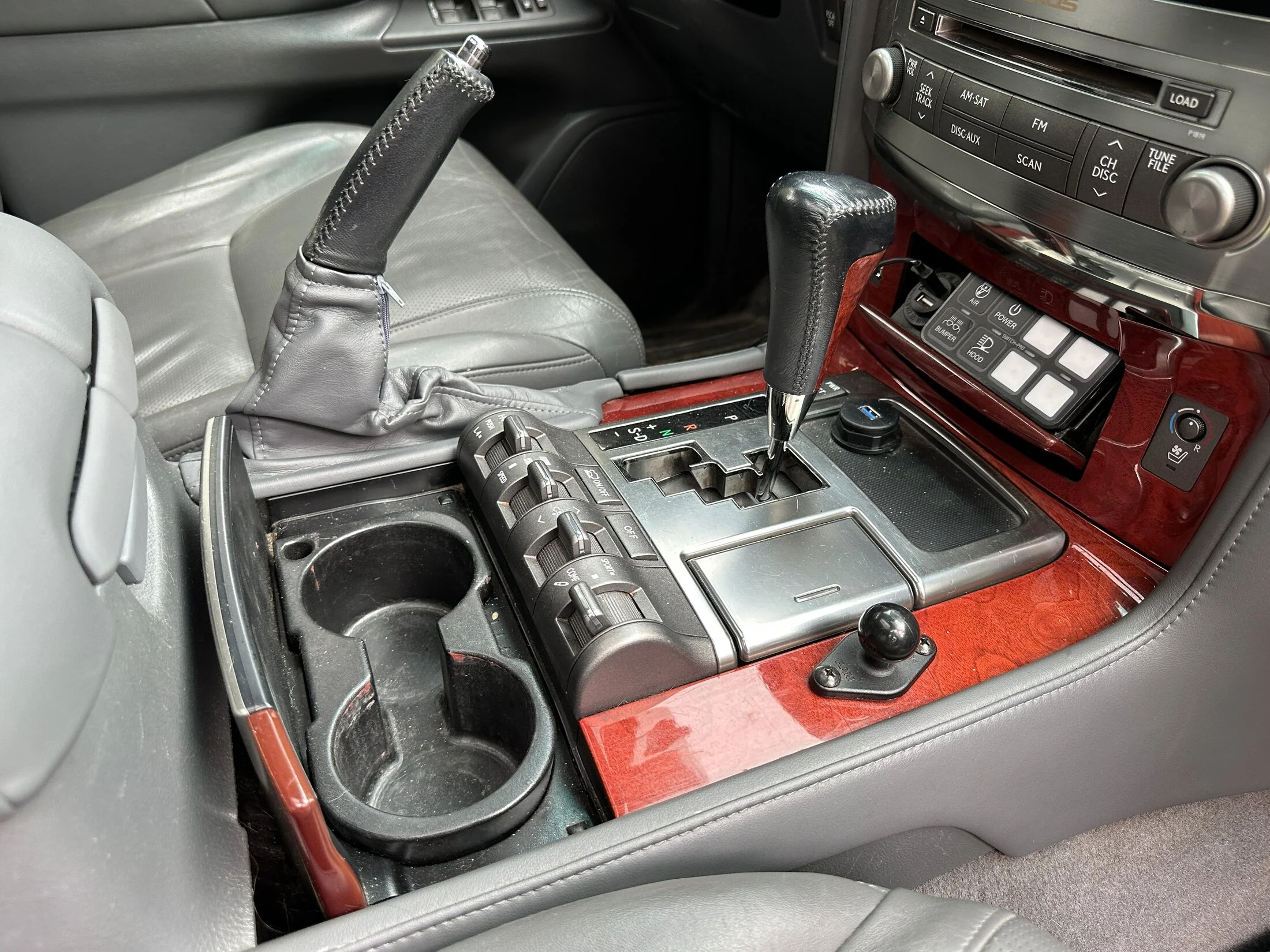

Minor quality of life mod this weekend. When I installed my Grom V-line I put in a surface mount socket for wired CarPlay. Upon installing I immediately hated how it looked. Plus after drilling a 1” hole i discovered that the socket interfered with the flaps that slide with gear selector so I created a ton of work for myself to make it work.

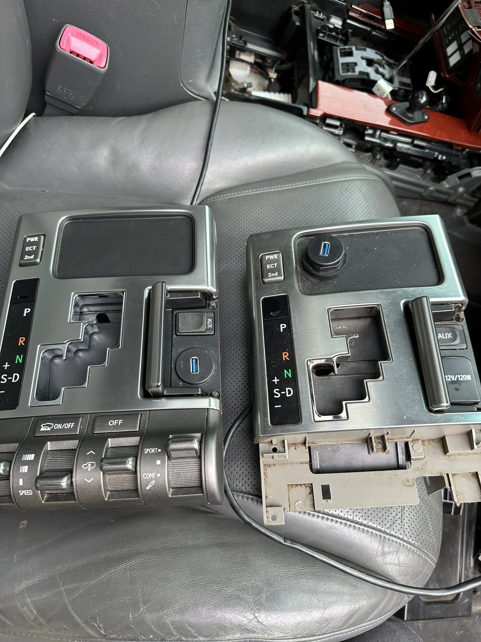

One morning I was cruising eBay and found an almost new gear selector panel and parking brake boot! When it arrived I couldn’t believe how like new it was.
I tried to delicately remove the factory 12v socket and enlarged it to 1” and sunk a USB-in socket into it. Here is the side by side after I moved over the off road switches
Of course this requires surgery, everything has to come out:
(The super glue was to glue up some veneer above the heated seat knob that was delaminated)
Overall super happy with this cleanup job.

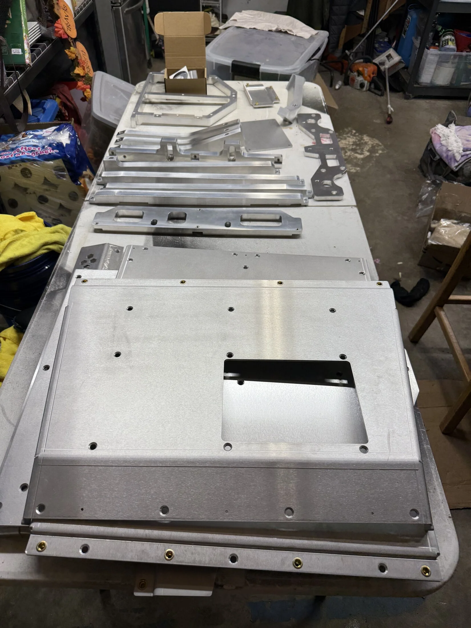

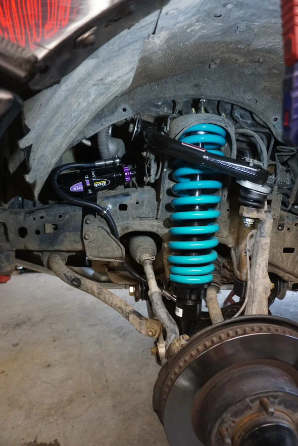

First, the easiest one—I ditched my ARB steel skid plates for a beautiful set of E&E offroad full-aluminum ones. This really was no-brainer. They are lighter by ~ 30 pounds, offer more coverage, make changing the oil easier, and are seriously over engineered. And bonus, working with Oliver was super easy.
AHC Delete

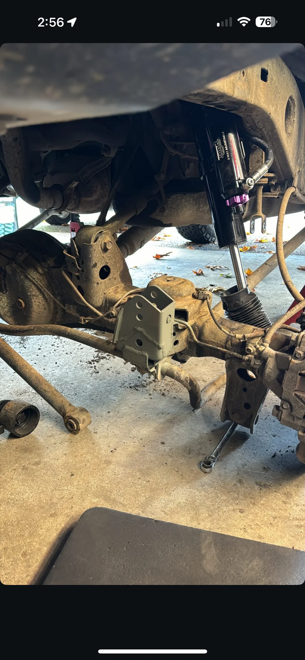

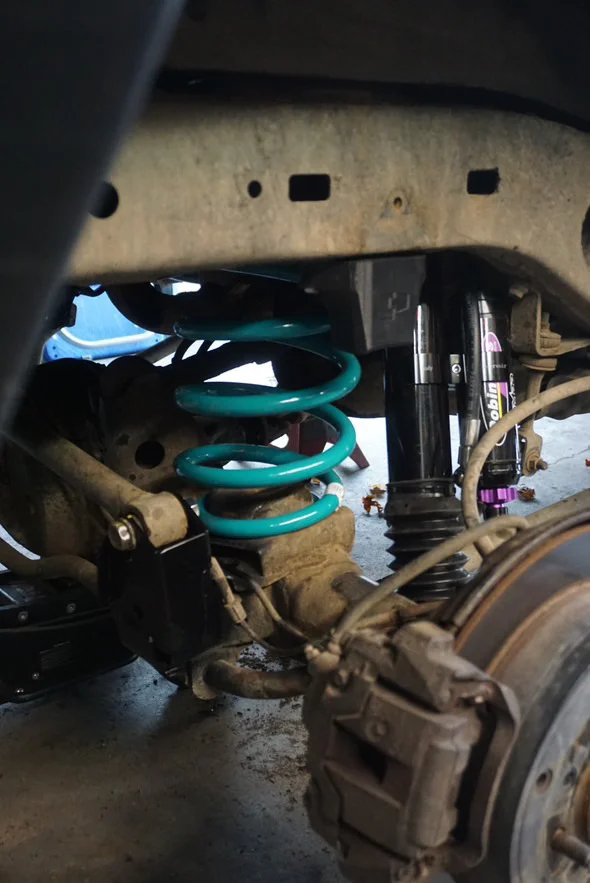

The next one is a doozie. I deleted my beloved AHC and replaced it with a set of weapons-grade Dobinsons 3-Way MRAs. What I say next might surprise you—AHC is really good. Like top of the food chain for stock suspension. I really liked it. I abused it and it never complained. I absolutely would buy another AHC truck, and who knows what will wander into my driveway in the future. If you have a rust-free LX with AHC in working order, you should maintain it and keep it. Replacing it is not a small undertaking and you have to be really meticulous or you aren't going to like the performance.
Ultimately, rust was going to take my AHC at some point at probably an inconvenient time. My truck is Canadian and the mechanical AHC components are looking very concerning. All of the valve blocks that hold the accumulators, the cross-over hard line, etc all have a concerning amount of rust on them. So the decision point was start replacing these lines and components or just move on. For every mod I make, I try to ask, will ask:
  1. Keep the truck on the road longer?
  2. Get me out more?
  3. Allow me to tackle more difficult / technical terrain?
  4. Have more fun?
Replacing rusty AHC would give me 1 (and would be cheaper), deleting AHC would give me 1 and 4. I agonized over this decision for a really long time—in fact I was going to do it last year and felt like it was such a big decision that I put off making it for a while. Ultimately what there were two things that helped out:

  • Suspension had to be adjustable. This is my favorite AHC feature so this ruled out any basic monotube options. IMO that would be a huge downgrade.
  • Down-travel is more important to me than absolute lift. My sensor-lifted AHC in high mode offer tons of clearance offroad in high mode—netting almost 3" of lift but of course road like a wagon because it easily topped out.
  • Keep AFS
  • Stock-ish suspension geometry and neutral handling.
  • While I'm in there—do some preventative maintenance
Build of materials
Once I had the parts, I disconnected the suspension control module at the CANBUS junction (thanks @TN LX570 !) and dropped the truck off with friend Tuan at Integrated Metal Works to do the install as well as an agressive BMC for the eventualality that I do something silly in @MTKID's garage.
No going back

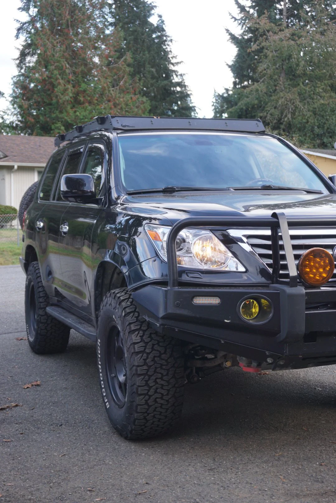

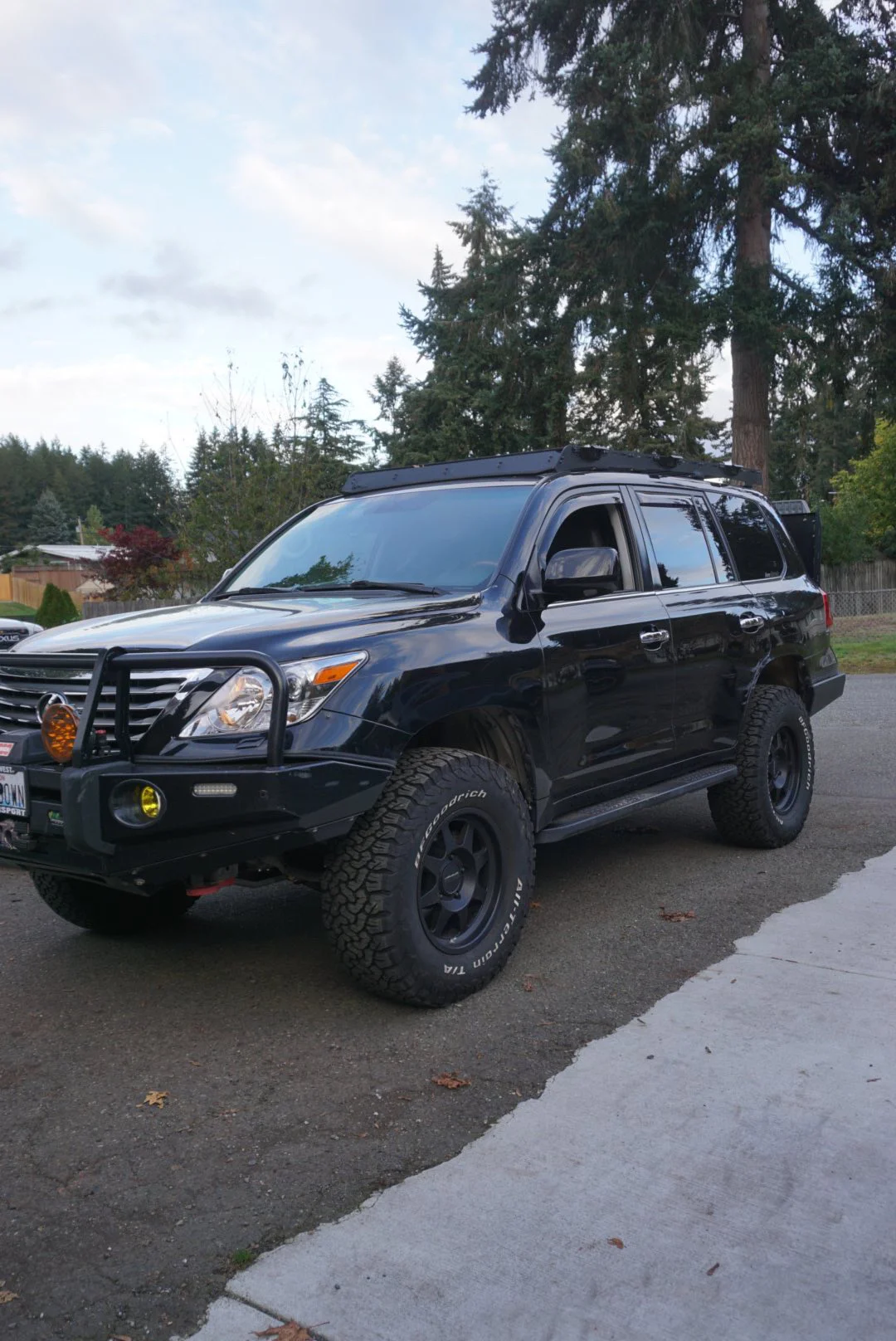

I should have grabbed measurements but I was heading out to airport when I dropped the truck off but sitting at just under 2.5" of lift. And it's pretty bang-on side to side.
Ride impressions
Extremely happy so far with tunings that Tuan recommended. My goal was plush but composed and I got it. Honestly couldn't wipe the smile off my face yesterday. The truck just feels very athletic now. Not harsh, but nimble. Ride is subjective but I'm super excited.
IMO AHC's biggest flex is it's ability to corner flat and I did lose some of that. But not much. I dont tow and my load is pretty static so also not worried about augmenting with airbags etc.

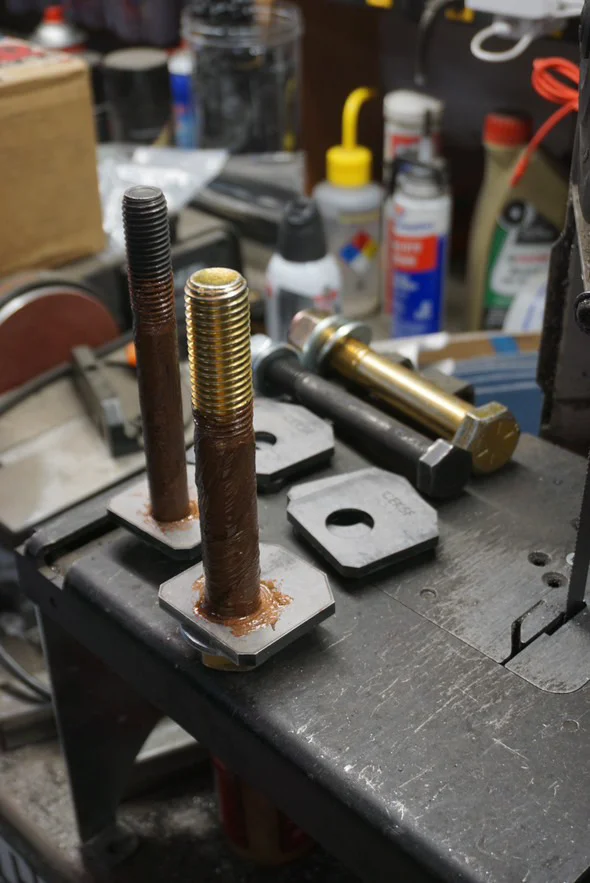

Question…. LCA bolts…. Did you remove the caster/camber adjustment gizmos or is the LX different in that area?

No but the 333 hardware has square plates instead of oval so less likely to get knocked out of alignment. They promise set-and-forget alignment.

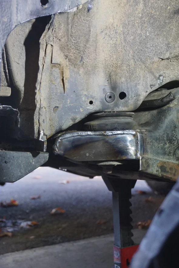

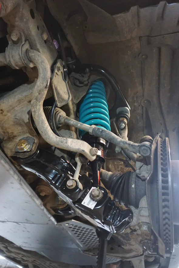

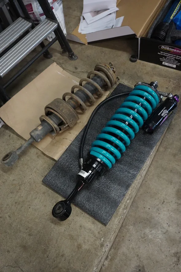

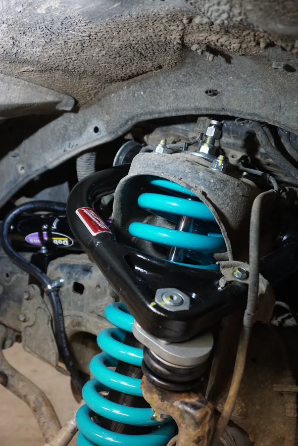

No going back
View attachment 3752292View attachment 3752293View attachment 3752297View attachment 3752300View attachment 3752301View attachment 3752302View attachment 3752303

Thanks! The unique design feature of the EE skids are the rigid subframe. This design overcomes the short coming of aluminum being more prone to dents and deformation.
