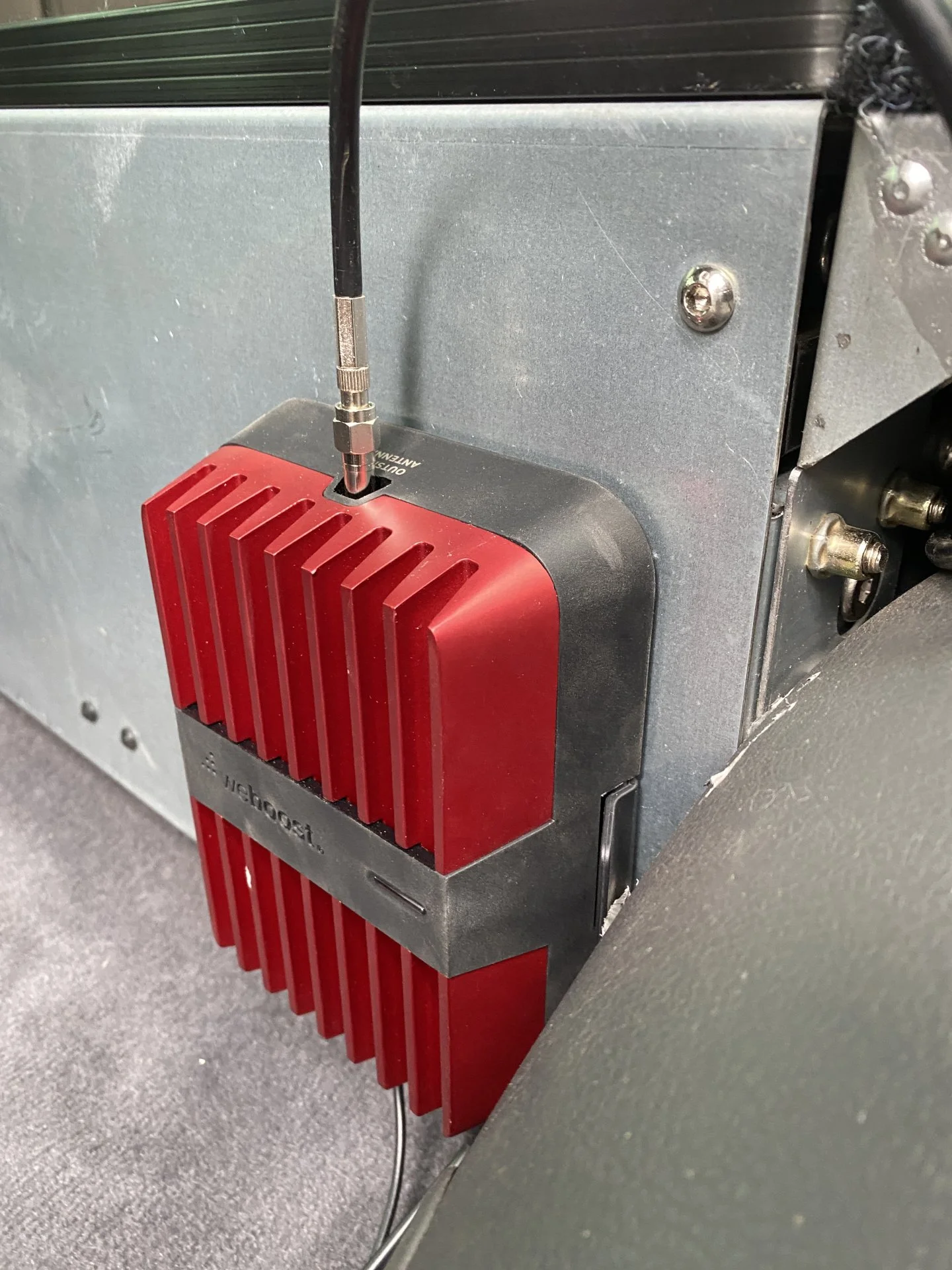

Weboost
I installed a Weboost this weekend. I had originally intended on mounting the mast on the tire carrier but it really wouldn’t clear the tire so I ended up putting it on the accessory panel.
The amp is on the back of my Dobinson’s drawers:
Thankfully no oscillation issues. It was literally plug and play.
I couldn’t leave it alone and ended up remounting the amp using m5 machine screws and nutserts into the back of my drawers. SOLID.

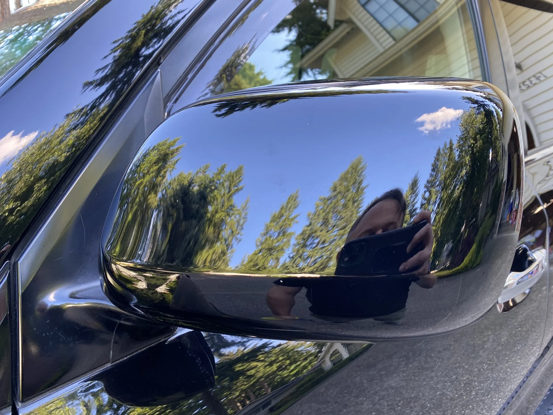

My wife got me a full exterior detail for our wedding anniversary year and was finally able to cash it in.
One might question my sanity for spending money on a paint correction knowing it’s going to go right back on the trail. However my main concern wasn’t the pin stripes, it’s that the paint wasn’t shiny anymore. It was looking very cloudy and had a lot of microswirls.
I had low expectations but the truck turned out amazing:

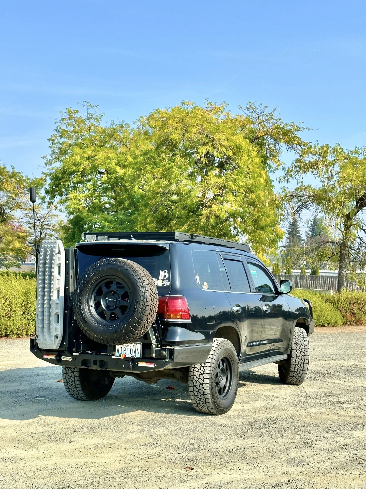

First, I love having a bumper and dual swing outs. The extra 15 seconds it takes to open for everyday use is totally worth it.
Aside from hanging the spare it’s allowed me to get the maxtrax off the roof which not only free up space but are so much more convenient to access.

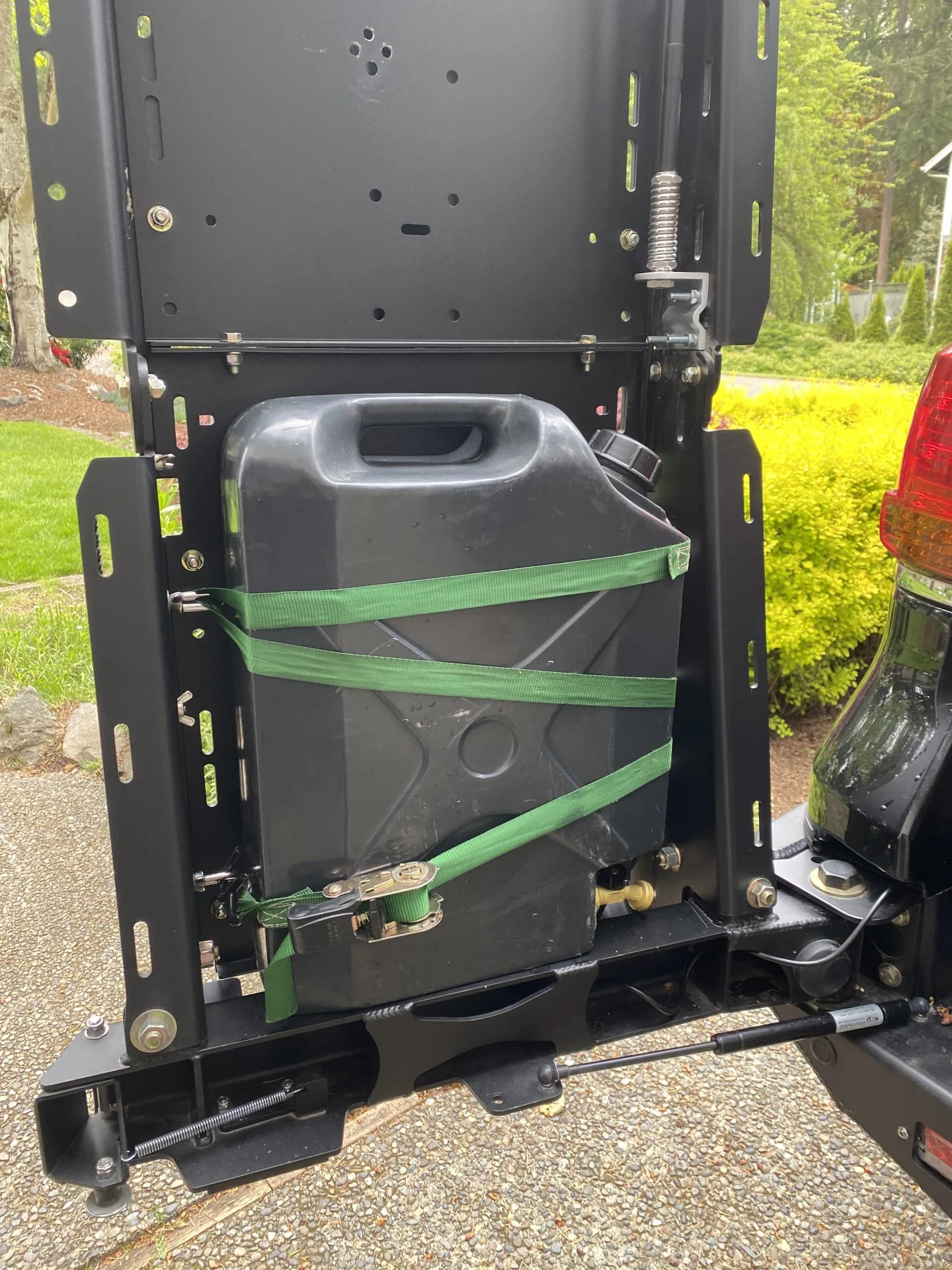

Inside the accessory panel is the perfect spot for a water or fuel can:

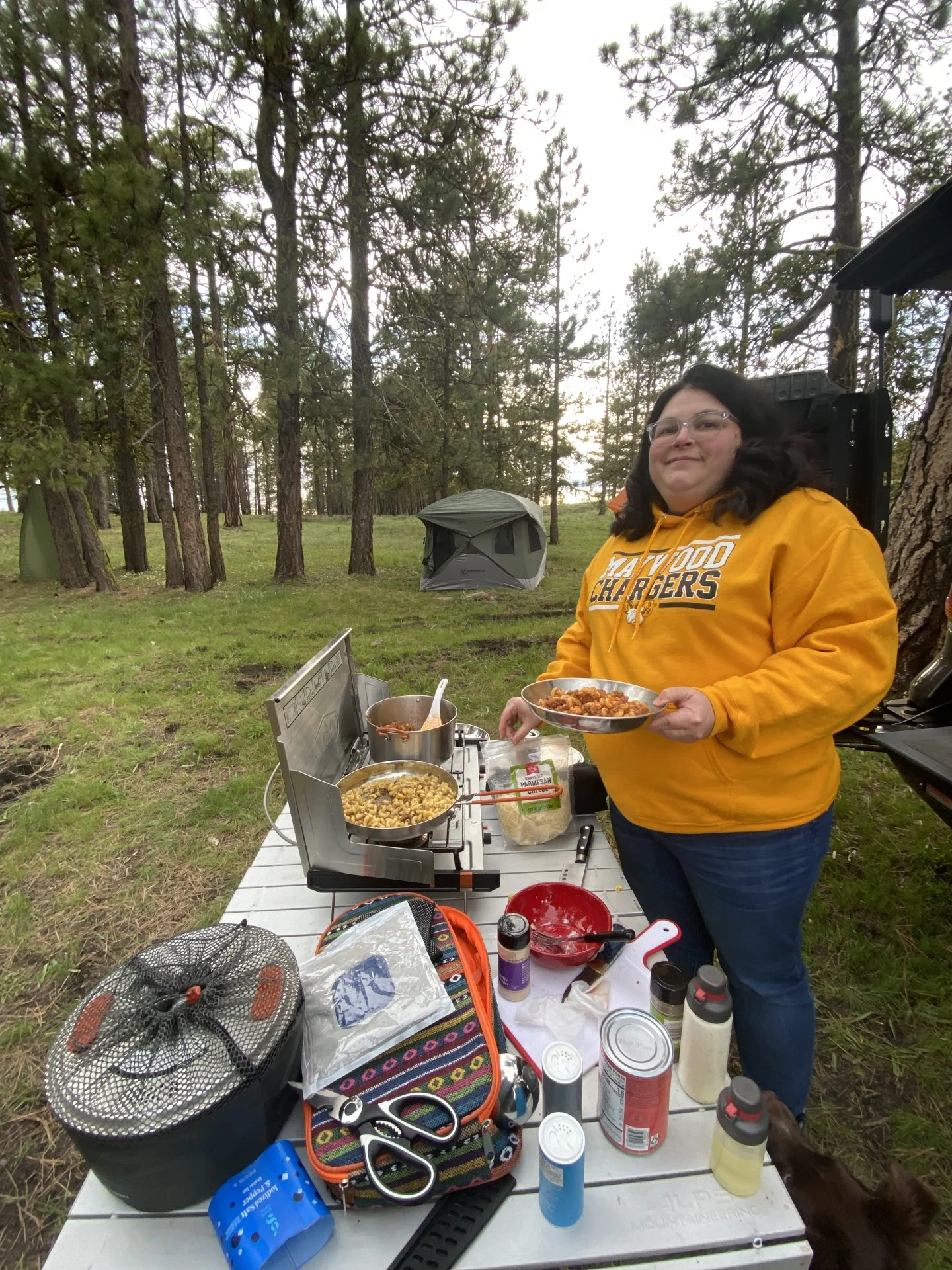

I also replaced my Coleman dual burner stove with a GSI Pinnacle. GSI announced the pinnacle pre-pandemic and then it took them two years to start shipping. Totally worth the wait:
It stows to only a inch thick and is incredibly precisely made. And the burners are really, really good.

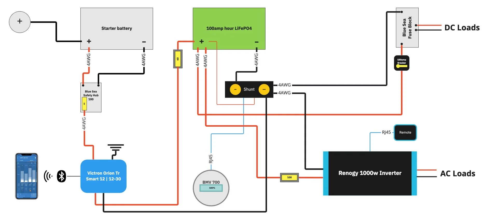

This week I completed a substantial electrical upgrade and installed a lithium house battery and carplay.

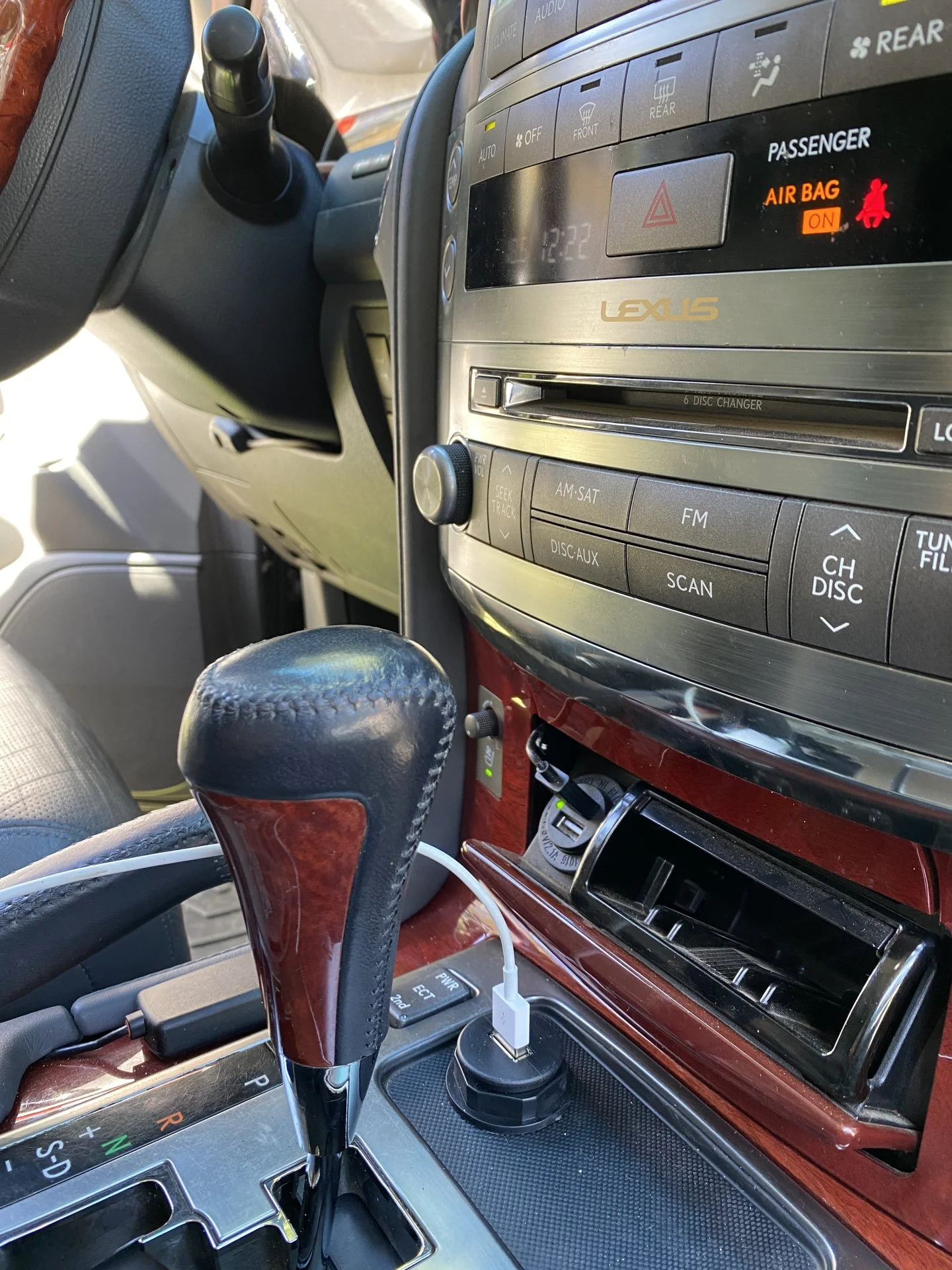

First, the way the LX works from the factory is weird, at least on my 2008. If you have the cameras set to auto, when they come on and turn off, the multimedia system completely ignores what the previous screen was. In fact you can't even keep it on radio, it will always return to map. This creates an extra click with the Grom. If the camera comes on (including reverse), you'll have to manually switch back to the Grom input. You can save some steps by disabling the front/side camera form automatically coming on.
Bluetooth wireless CarPlay works great 94% of the time. But wired worked 100% of the time, and it's less laggy and faster to come on. Occasionally my wireless CarPlay would disconnect, and while it would recover it took what seemed like forever. I ended up installing a surface mount USB extension socked in the console.
Note this is a flush mount socket, or is supposed to be. In typical fashion, I drilled first and planned second. Just below this spot is where the plastic card that moves along with the gear selector. It extends about 50% more than the gear slot and would interfere with my socket. So I ended up using this "stand off" to decrease the depth of the socket under the surface and still ended up trimming the plastic card a bit. For future installers, the right side of this rubber mat is 100% unobstructed. I should have stayed right lol.

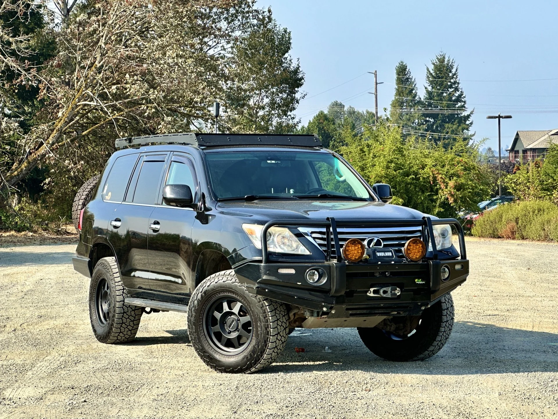

First, for no other reason other than I wanted them—I bought 5 new Method 501 18x9 25mm offset wheels. It was kind of cool, I've only had junkyard wheels on this truck.
I bought these direct from Method and had them installed at my local Discount tire. There is still a few mm left between my 295s and the front body mount but it's definitely tighter.

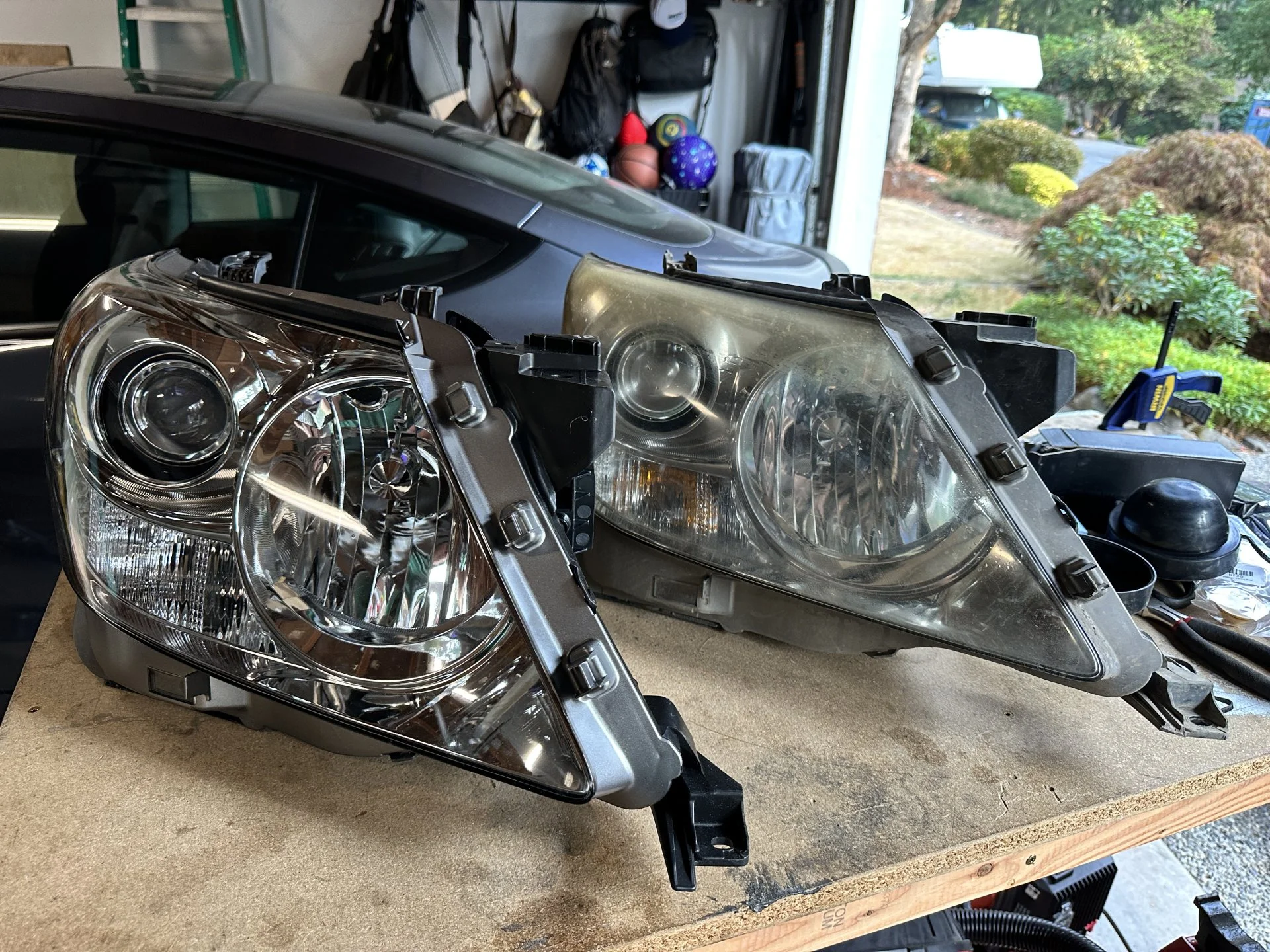

New headlights
Second thing, new OEM headlights. My originals were trashed, way beyond polishing. New units are super expensive because the assembly includes all of the AFS servos etc. However when you see them side by side, it's all worth it:

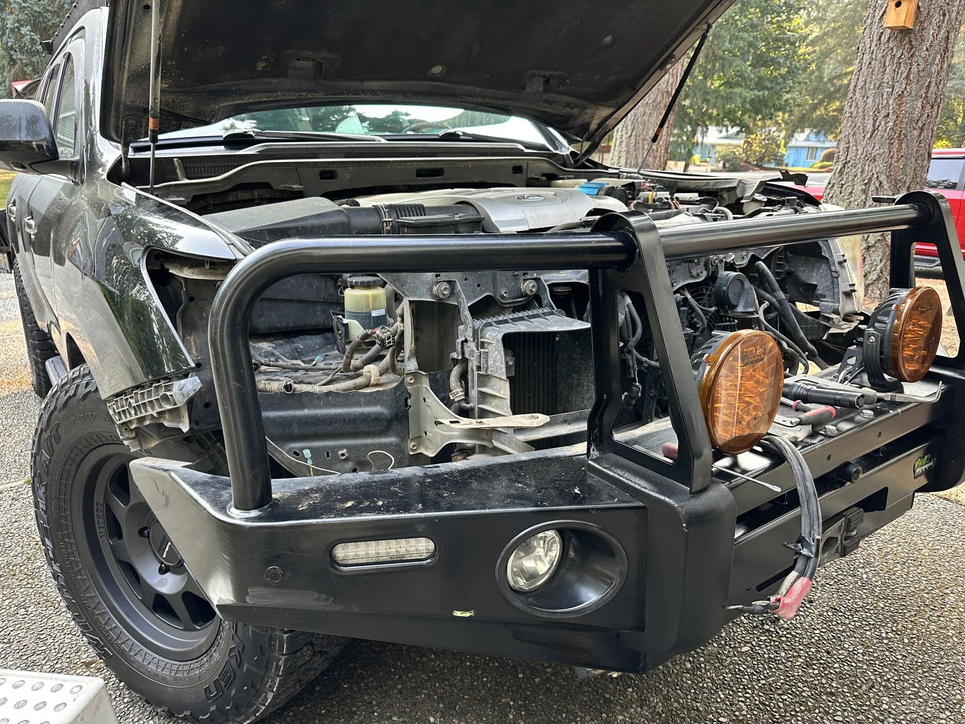

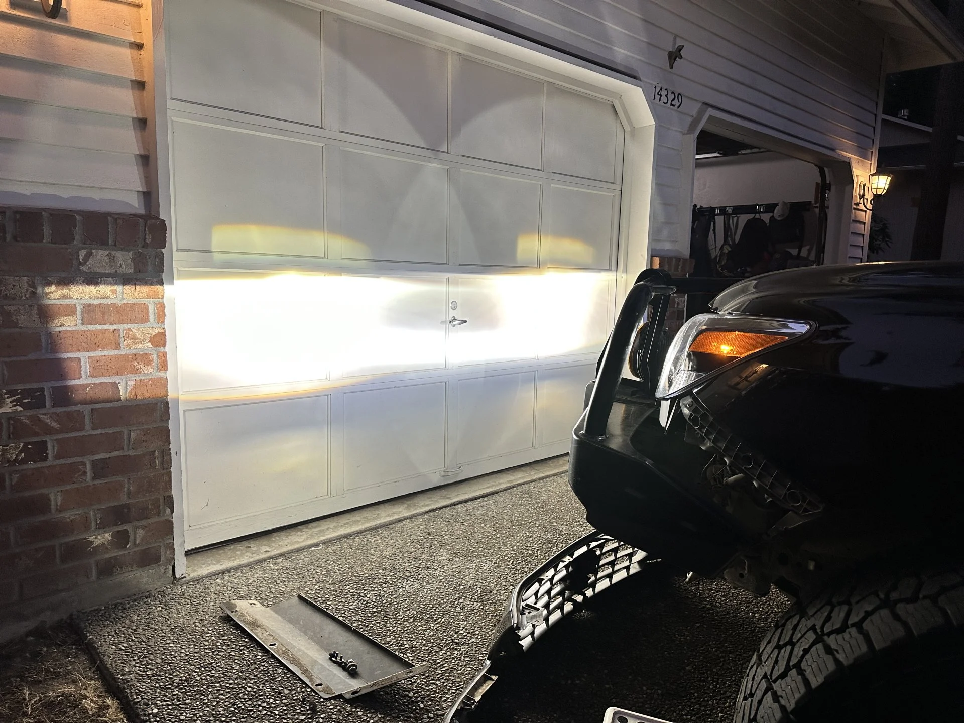

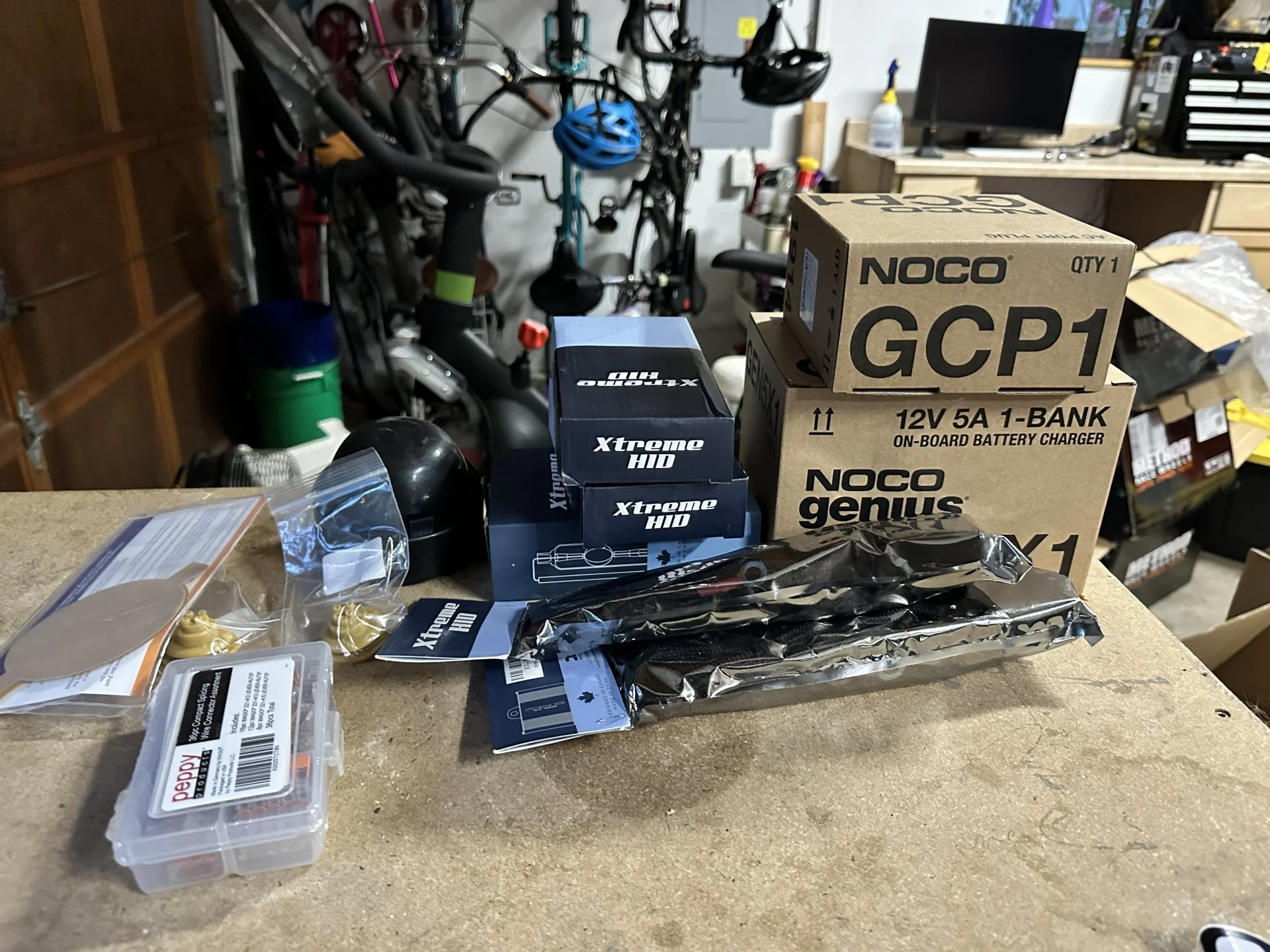

While I was in there, I removed my Hikari H11 low beams and did an HID retrofit. I ordered the 35w Xenon Depot XD kit with Philips bulbs. Install was straight forward.
The output on these is so much better, and more importantly, even. The Hikari's were super bright in front and then trailed off quickly.
Nothing super interesting of note for installation except that I had to pull off basically everything up front including my winch pack. Having a bullbar made it both easier in harder if that makes sense.
The kit comes with a grommet for the pass through and I just drilled a 1" hole through the dust cap and liberally siliconed it. The ballasts and igniters are double-sided taped where I could fit them, however I did learn after the fact there this is a spot on the bottom of the light assembly for a ballast. Would have been tidy but I ain't pulling them out.

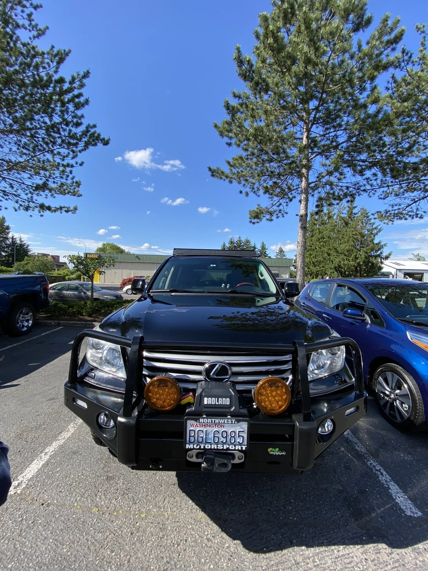

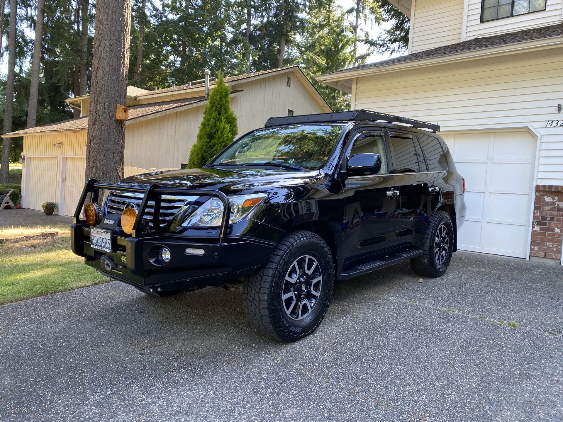

Last thing, I was thinking about @CharlieS 's post about yellow / amber fog lights and decided to give LaminX film a try. This stuff is super easy and forgiving if you do a wet install. I dont think I'll get rich yellow like my baja squadrons, but it will be nice to have warmer light that's closer to my HIDs.
Here is the whole facelift after a wash and opti-seal on the lights:
