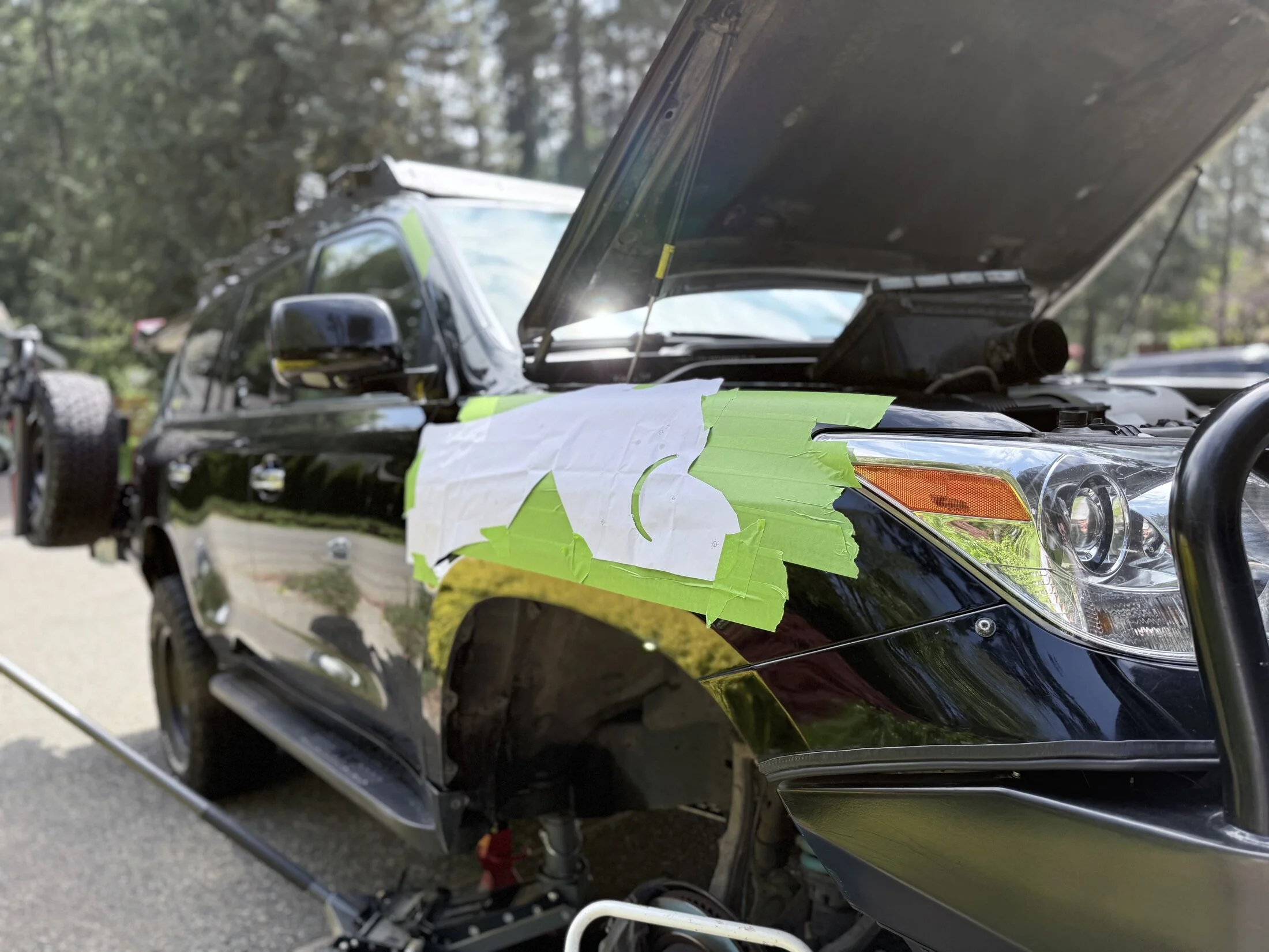

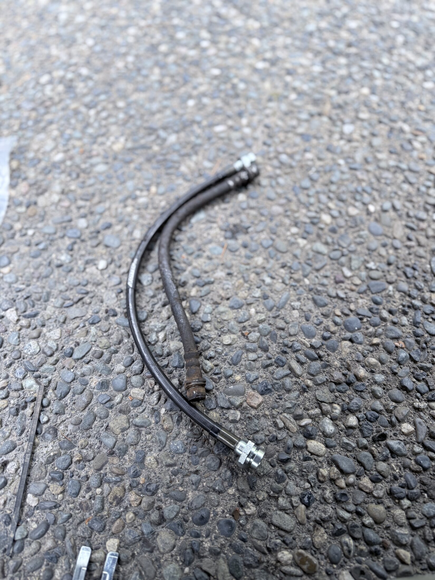

I finally got around to installing the extended rear brake lines I’ve had on my shelf for about 18 months. I fully intended on going rear long travel but never got around to it.

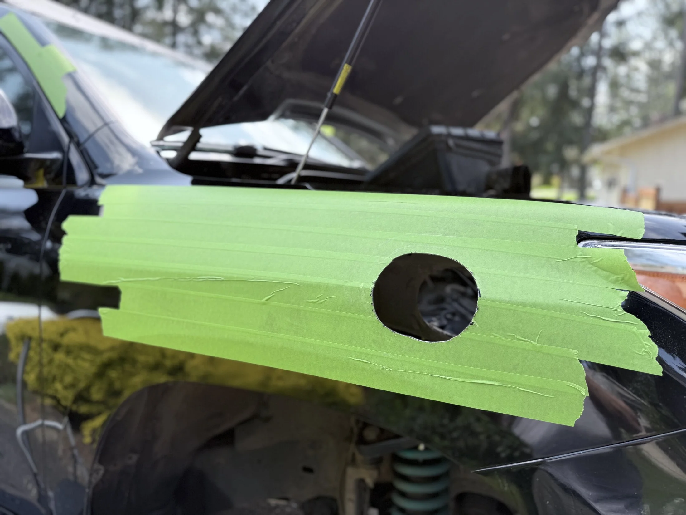

I also made some pretty big holes in my fender.
Fitment is 7 out of 10
This is not hard but took me 4 solid hours and a couple trips to Lowe’s. You’ll need:
  • Deburring tool
  • 4.5” hole saw
  • Touch up paint
  • Rivet gun (although I suppose you could use rivnuts)
  • Thread locker
  • Round file
  • Heat gun
No perceptible extra noise or whistling 🤷‍♂️

looks sick, where did you get those extended rear brake lines ?

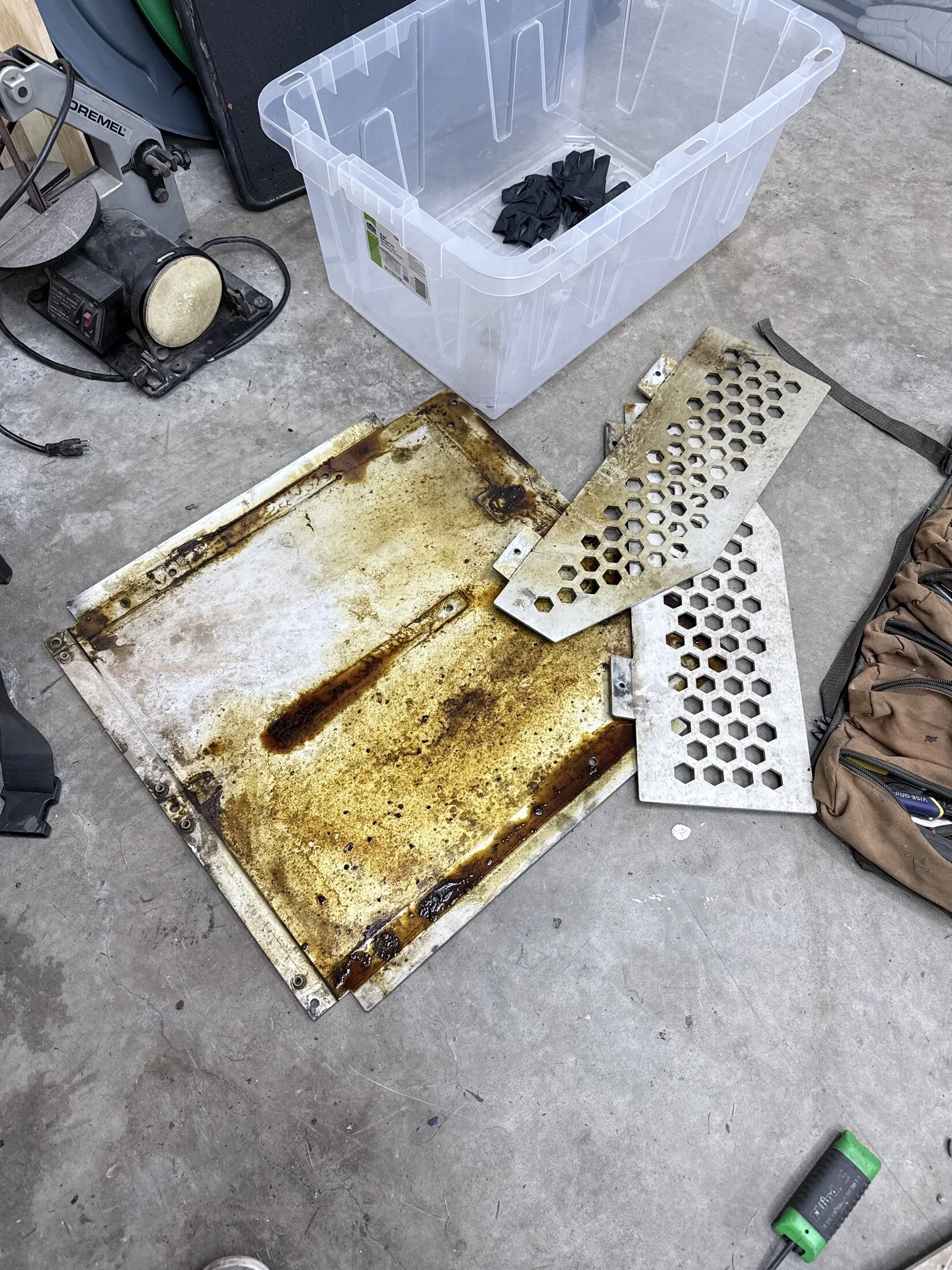

I was due for an oil change the second I pulled in from my trip. I noticed the skids looked a little...grimey so I pulled them off and found this horror show:
Every skid from the bottom of the engine back was like this. I couldn't believe it. I've had a slow passenger side cam tower leak for, well, since I've owned the truck. This was the driver's side. It dripped enough bumping and climbing in moab to make it's way to the prop shaft and oil migrated everywhere.

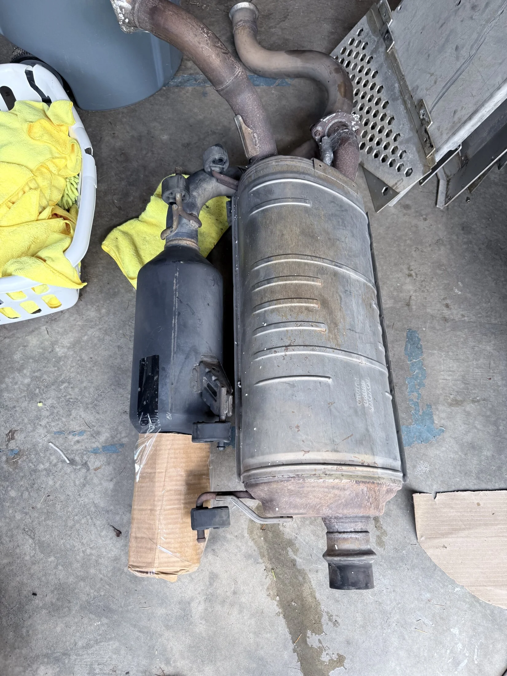

Rather than kick the can some more, I made an appointment at Torfab to get both banks re-sealed. In the meantime, I swallowed my pride and went back to stock muffler. I found a low mile one on ebay and bought new gaskets and hardware and agreed with my wife that I"m a moron. Lesson learned.

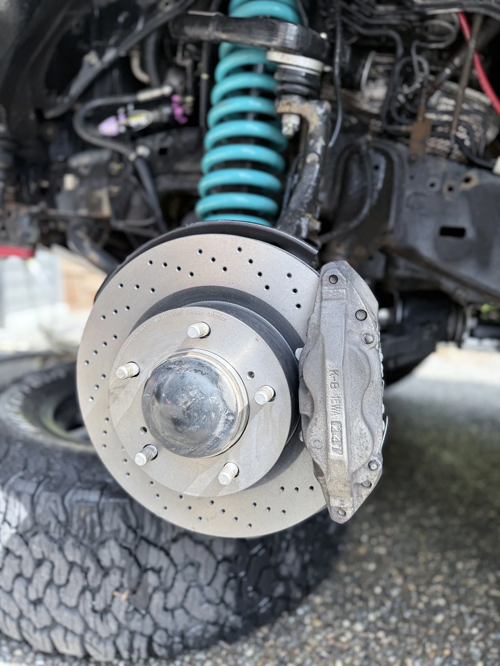

I also built a sick bike rack for my dissent rear bumper, and did Brembo pads and rotors all around. The holes add horsepower:

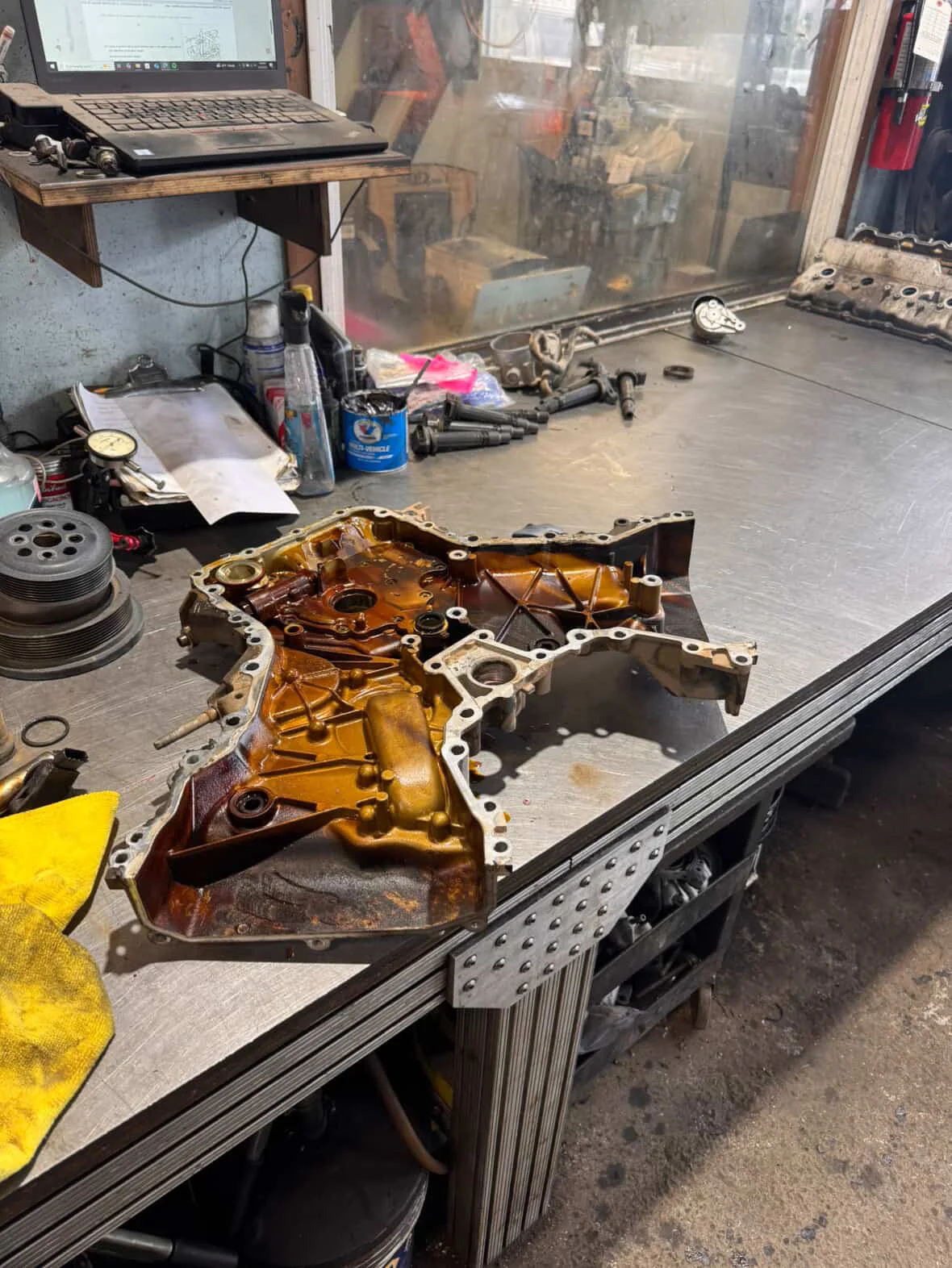

Okay fast forward to a month later, I dropped my truck off at Torfab and they got to work on the cam tower reseals. The photos confirmed that this is not a DIY job, at least at my skill level:
The while they where in there list includes a bunch of o-rings, both chain tensioners, dampers, and crank shaft seal. They also found some issues with my spark plug tubes—one was full of oil and the other was totally seized in and had an unhappy coil back, so those where replaced. I also had leaking heater tees, so those got swapped too. Oh, and rear upper links for good measure.

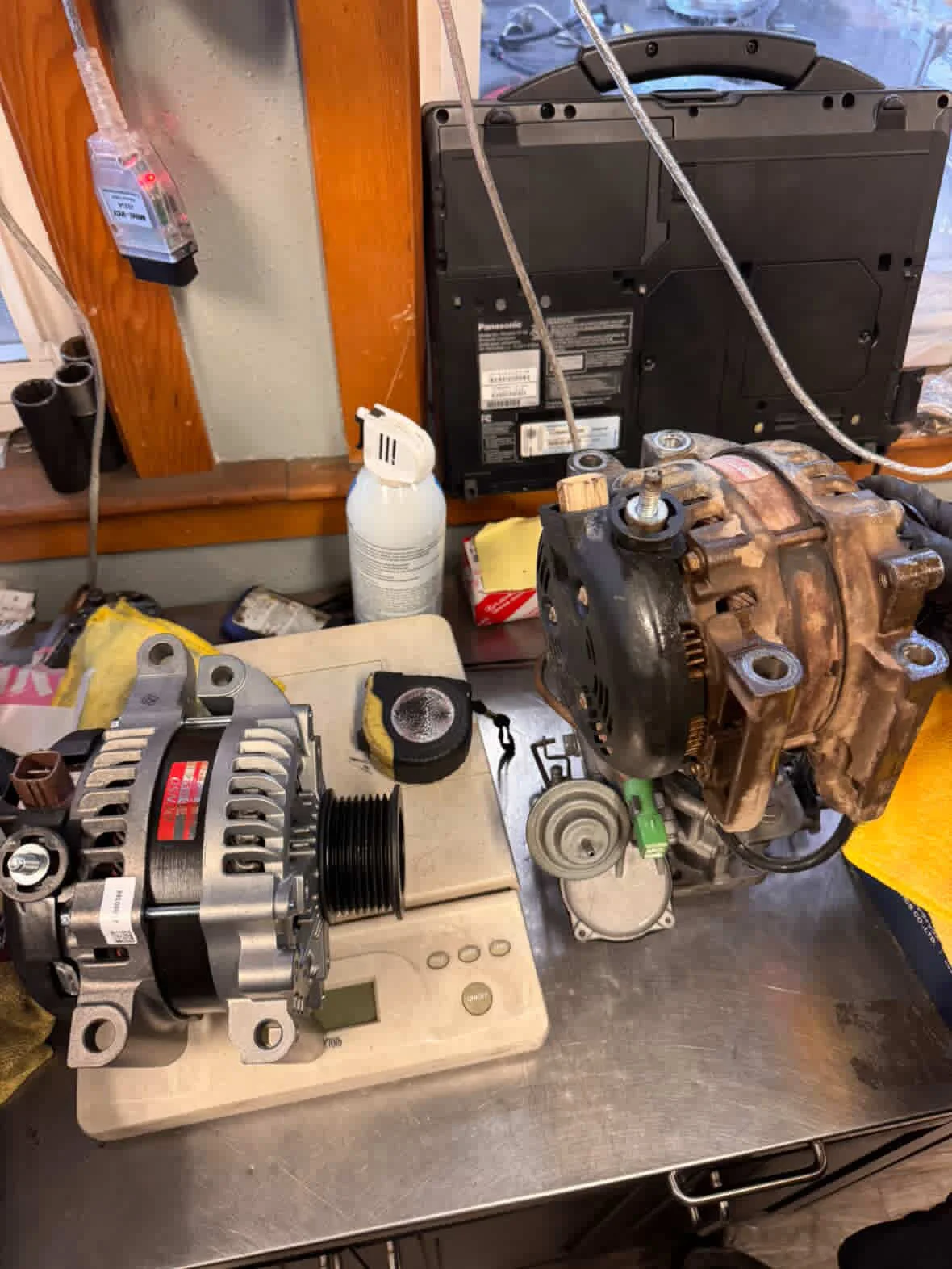

I picked the truck up and on my way home, I started seeing a flickering charge light on the dash and the voltage was bouncing like crazy. I started monitoring it my DC charger (which was off) and could see voltage dropping to 11.7 and then bouncing up again. I initially thought either loose battery cable, or maybe the alternator had to come out with timing cover. I checked the cables, all good—and the tech confirmed the alternator stays on, just the belt comes off.
By the time I got home the truck was unhappy and running like garbage. Thankfully Torfab answered my messages after hours and had a new Denso alternator shipped overnight so I wasn't out of luck for the long holiday weekend. They went above and beyond and got me in the next day, and had it done by the afternoon.
I'm not sure what happened, this alternator is about 3 years old, but it's absolutely cooked. It's discolored from being hot (old one on the right):
There was some oil on the back from what I assume was long term oil drip from the passenger side leak. But beyond that, I have no theories.
Do you know how many amps you have in accessory loads?
I thought about that too. I’ve got a 150amp blue sea safety hub with my switch pro, ARB, and spot lights but those are only intermittent use. I have a 30 amp Victron charger, set to most conservative settings for voltage lockout, timeout etc. I drive the truck enough that it’s mostly bulk charging at < 10amps
I did Brembo pads and rotors all around. The holes add horsepower:
“The holes will crack and your rotors will explode, I only use OEM”
-Half of Mud 😜
Yea wait until they find out I use Kirkland oil sometimes 🫣
Wow, cooked is right!?$#
The electrical setup looks reasonable based on the schematic you posted.
If I had to guess, I'd agree that the oil was the primary culprit. As it got into the internals and windings, it could reduce heat transfer causing overheating. With contaminants it probably started short circuiting internally as well. Overtime and cycles...glad you sorted things out before it turned into a potential fire underhood.
