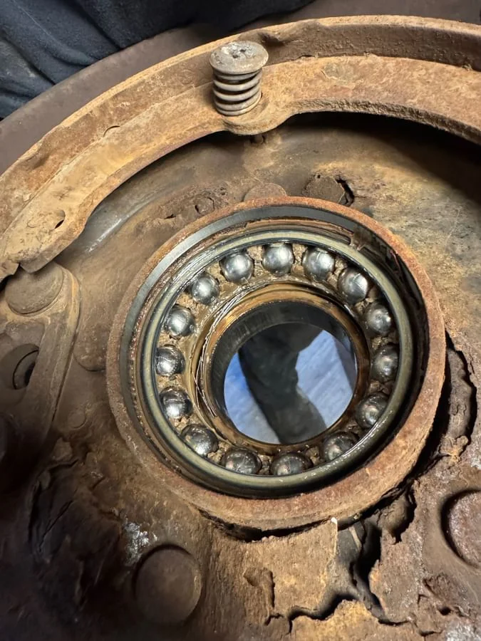

Just picked her up from Torfab in Everett WA for some rear diff maintenance:
  • Pinion seal
  • Output seals
  • Wheel bearings
  • Backing plates
Additionally my diff breathers where clogged which is why bearings where roached. I assume they were pushing oil out through the axle seals.

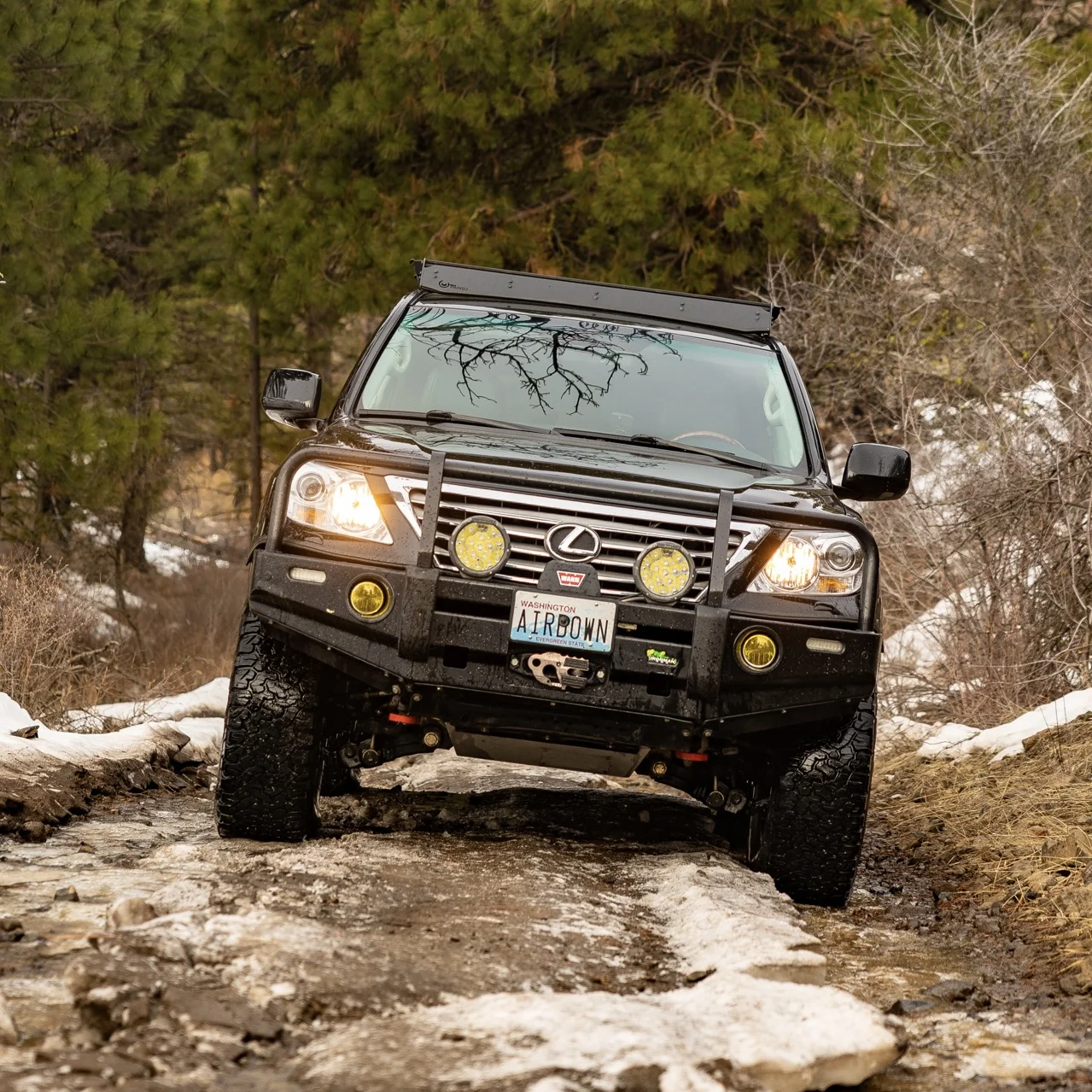

Dropped some yellow direct replacement leds in the fog lights. I suspect I found the part on a thread here. Driving here in the city is chaotic most of time and I drive with headlights and fog on during the day to make sure other see me. I have become more cautious/defensive in my driving and will add any advantage my mitigate accidents. Had a few accidents and close calls with drivers not paying attention…lost my 80 to a distracted driver.
Driving at night, it seems the yellow drowns out the halogen lights. I haven’t put the new headlights in yet and wonder if that will make a difference. Having said that, are the yellow fog lights a plus/minus/neutral add to the visibility?
Keeping this topic here since I follow @tbisaacs build closely…
My headlight situation as evolved quite a bit over time and I’m currently running Morimoto 50w HID low beams and integrated LED fog lights in my Iron Man bumper with Lamin-x amber film and I absolutely love it.
With stock halogen bulbs and LED bulbs in a halogen housing for fogs, your headlights are likely getting drowned out. Those drop in LEDs tend to put out a huge sphere of light close to front of truck vs a long cone.
If you like the yellow for contrast, Hella makes an amber halogen bulb that will fit fog lights that I really liked.
The LEDs I used were by a company called Auxito. Super bright but like you mentioned the yellow light sprays over the halogen. Saw the threads on the bd and diode direct fit replacements but couldn’t find anything on the Hellas. Is that a just a build at complete light?

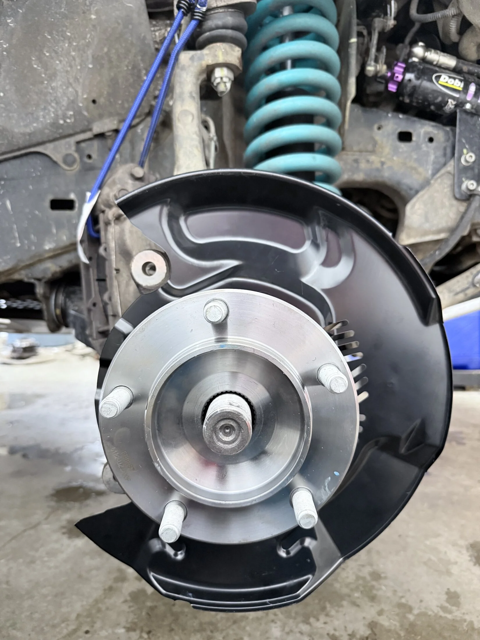

Wheel bearings
This weekend I replaced the front hubs and wheel bearings with new complete assemblies from Cruiser Outfitters. The kit also comes with required O-ring and seal for the knuckle.
As far as I know they were original—171k miles. I had been hearing a sound from the front of the truck with the windows down that sounding like a grinding sound—but not harsh like metal on metal, but more of a gritty, rubbing sound. I initially chalked it up to my EE off-road skid plates wiggling a little bit but I can now confirm the sound I was hearing was completely gone.
Because I didn’t need to split and press in bearings this job is very straightforward. You will need a torque wrench capable of 250 lb/ft though.
1. Remove the dust cap and locking pin
2. Remove hub nut with 39mm 12-point socket
3. Remove brake caliper and hang it out of way
4. Remove rotor
5. Remove 4 hub bolts
Install / removal notes
  • Getting the hub socket off can be a challenge because torque is very high and hub wants to rotate. I wedged a pry bar into the brake rotor and against my wheel laying on the ground to keep it still. You can also do this against the brake caliper.
  • Both seals in the knuckles of my truck looked really good so I didn’t bother. I knew for a fact one was new. If you need to do this you have to disconnect the knuckle and punch the axle and seal out through the back.
  • I didn’t remove wheel speed sensors. No issues with nicking them.
  • I also installed new backing plates.
Also bonus peace of mind having new wheel studs.
Between all the new suspension, bearings and bushings the truck feels very dialed it.

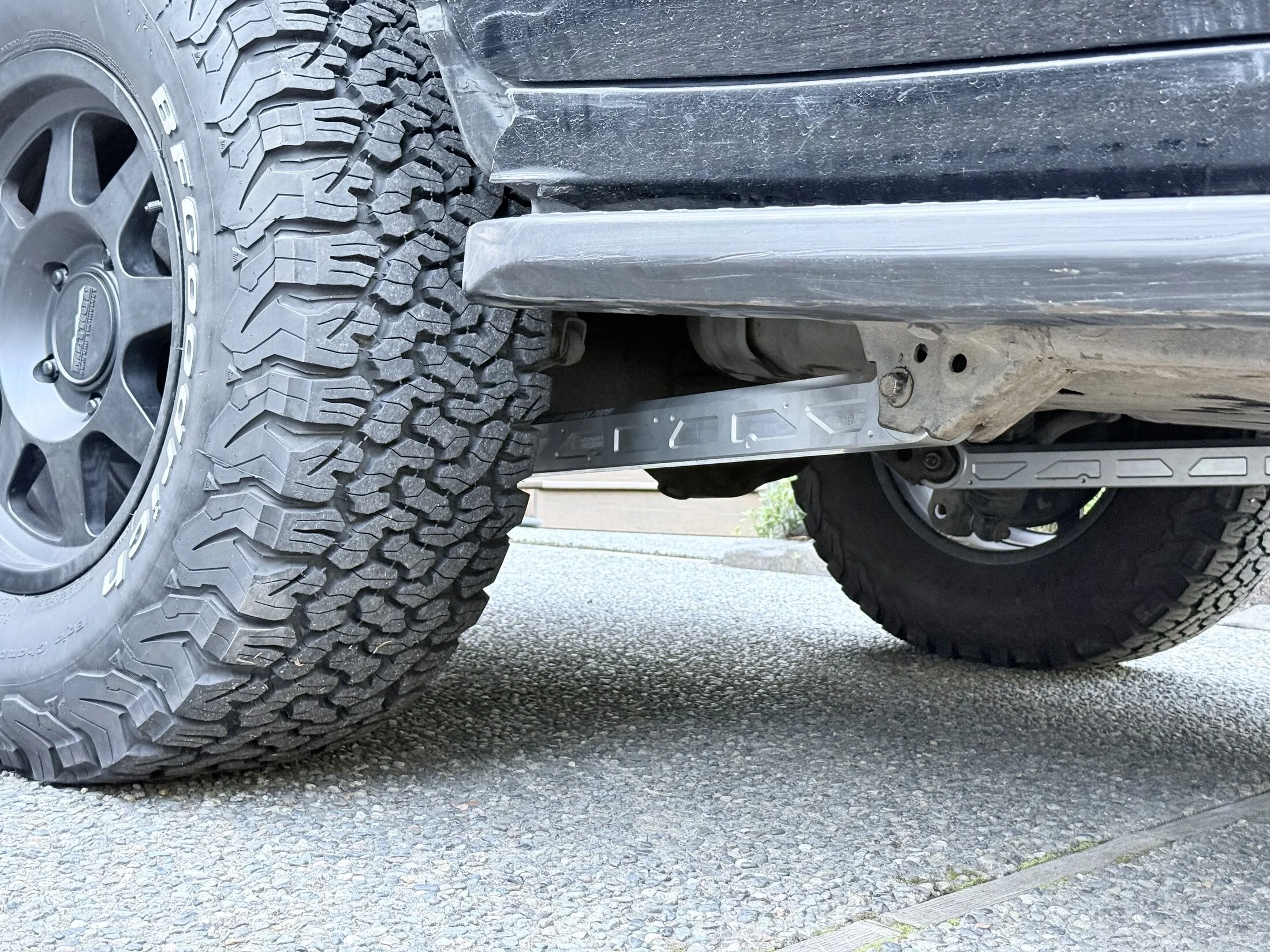

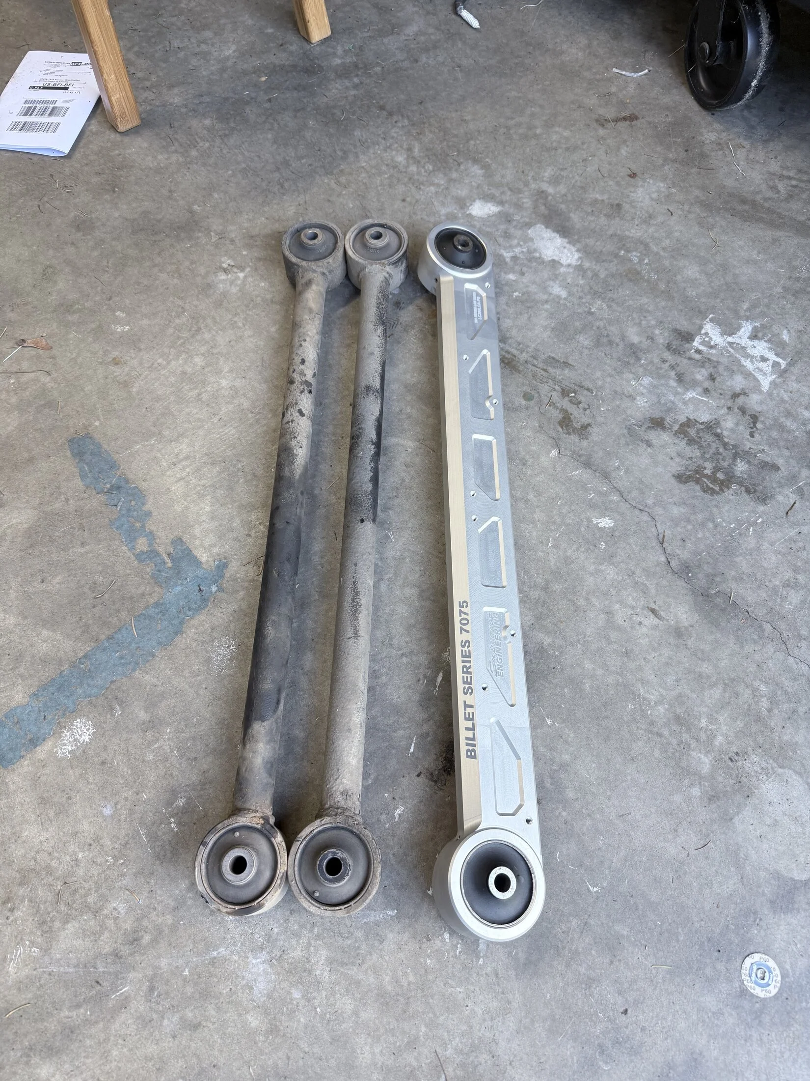

Rear links

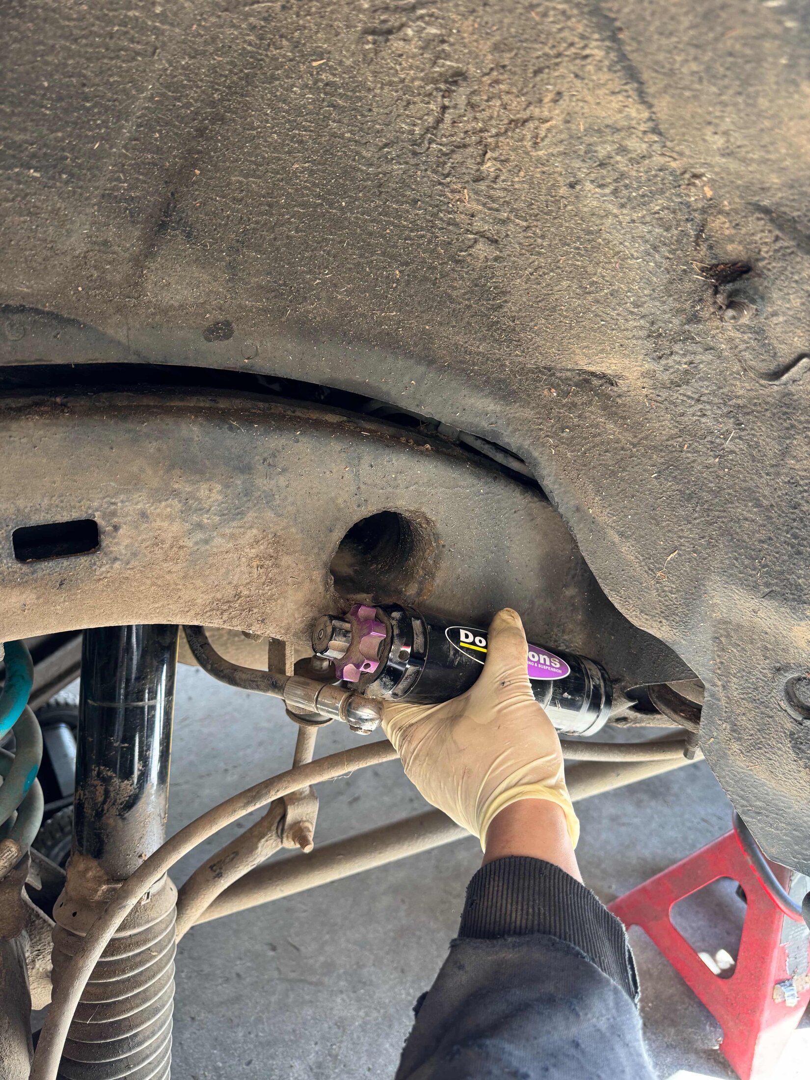

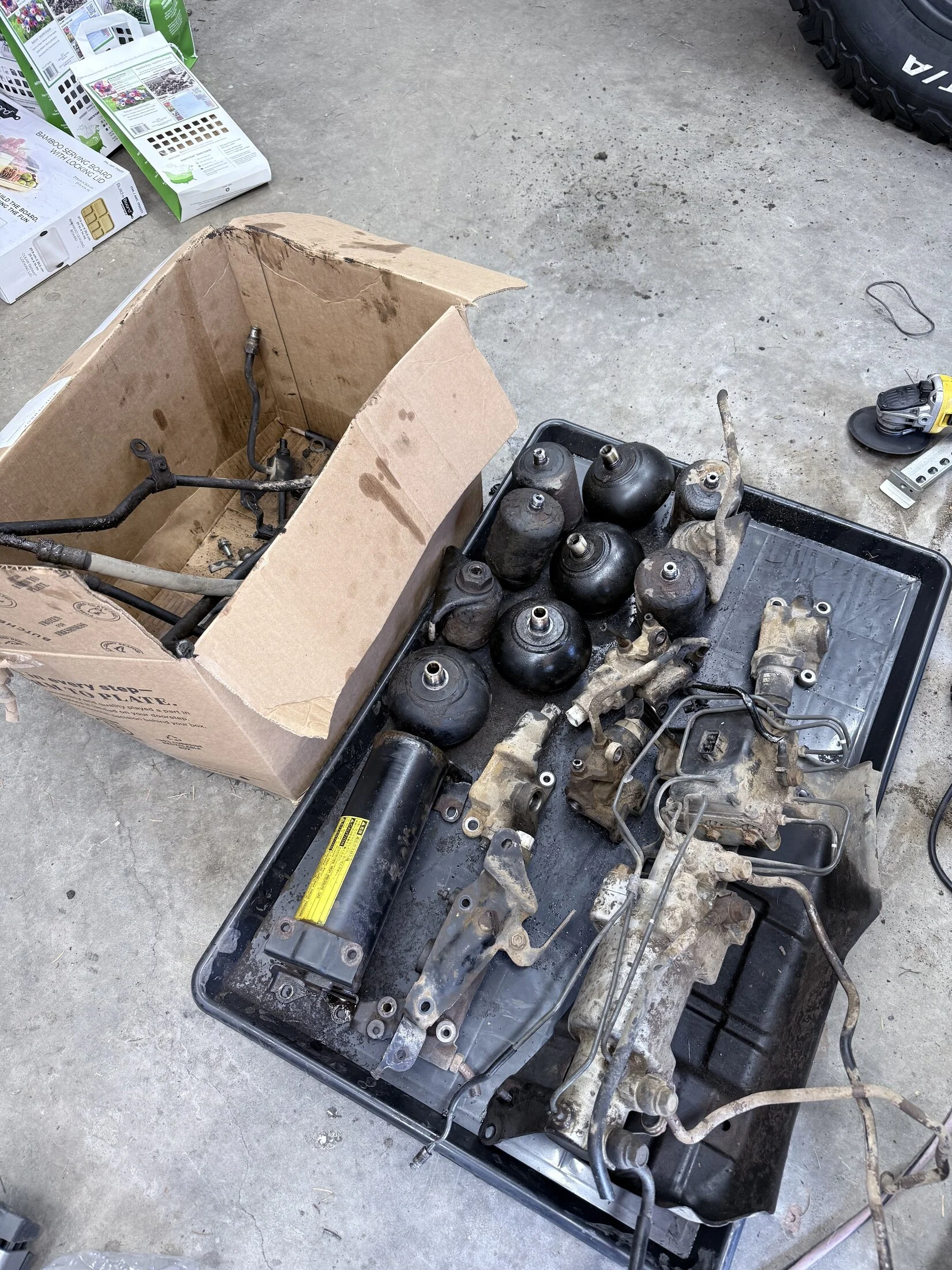

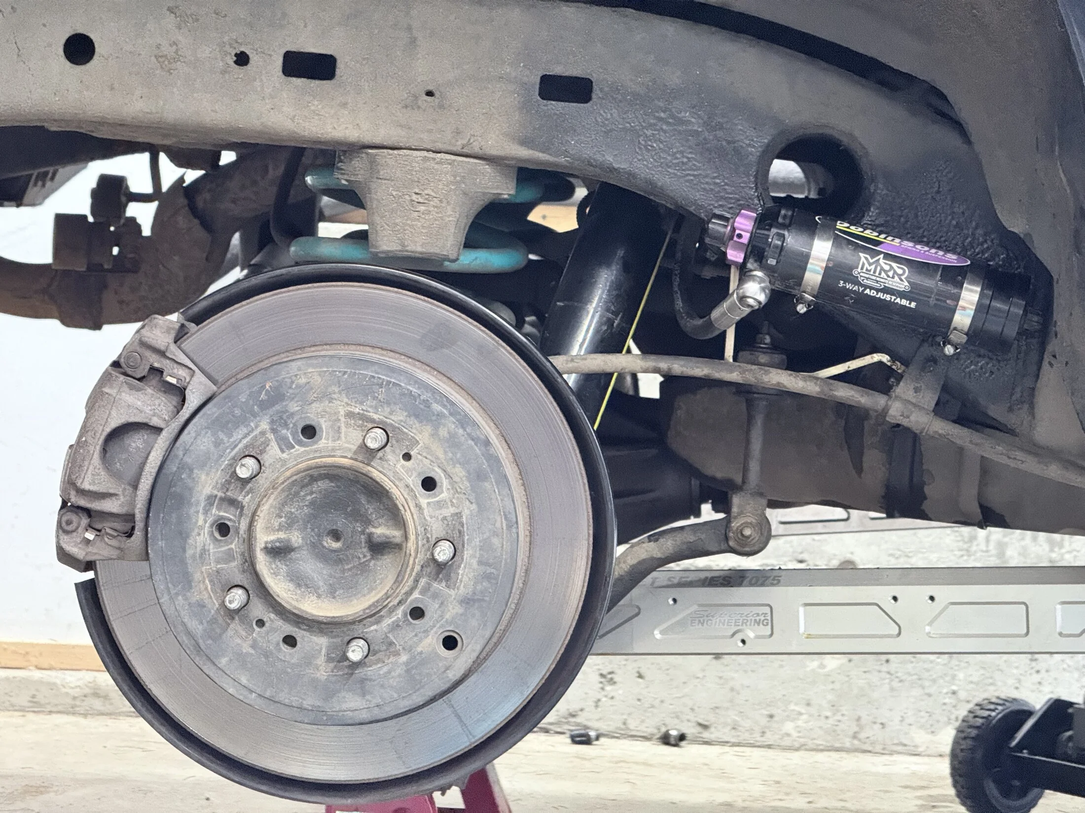

I’ve spent the last few weekends slowly decommissioning the AHC components. I’ve got everything but the pump and some long lines off. This is a dirty, oily, frustrating job.
For the driver side I pulled my slider off but in hindsight this wasn’t totally necessary and I ended up snapping a mounting bolt. On passenger side I did everything with sliders in place.
What worked well was dripping the globes and disconnecting as many of the 17mm banjo fittings as possible, and then start unbolting components from the frame.
Removal is impossible without cutting some lines and even still then you gotta be really mental to try to 100% fish everything out. I will do pump but just avoiding it because pulling the rear bumper wing is annoying.

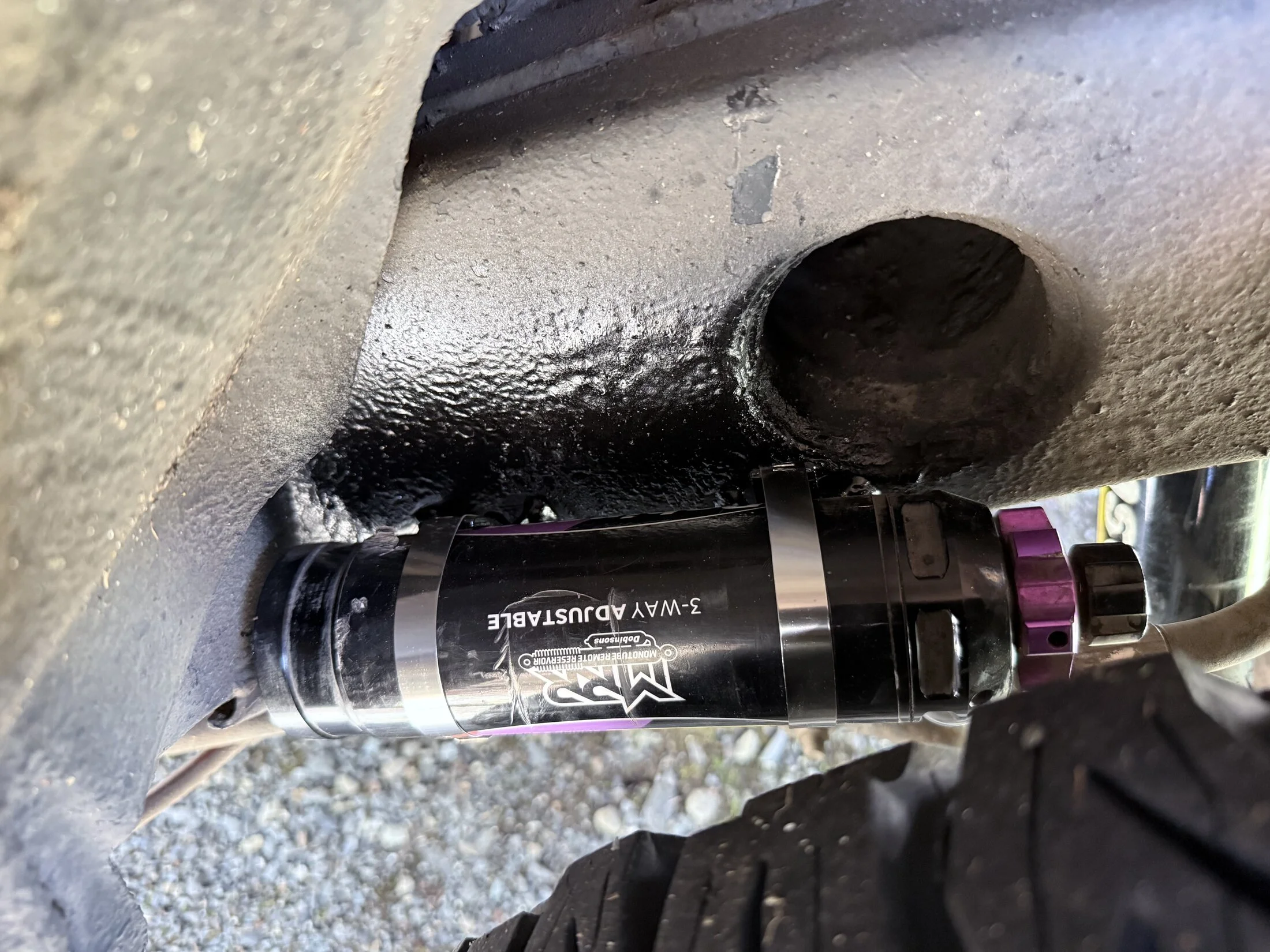

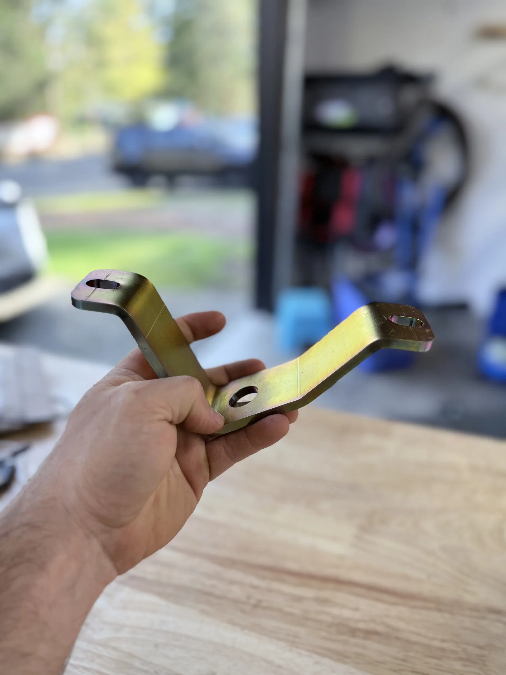

Next I had a local fabricator weld some tabs to relocate my remote reservoirs to get them out of harms way from the sway bar at full droop. Bonus is that they are easier to adjust.

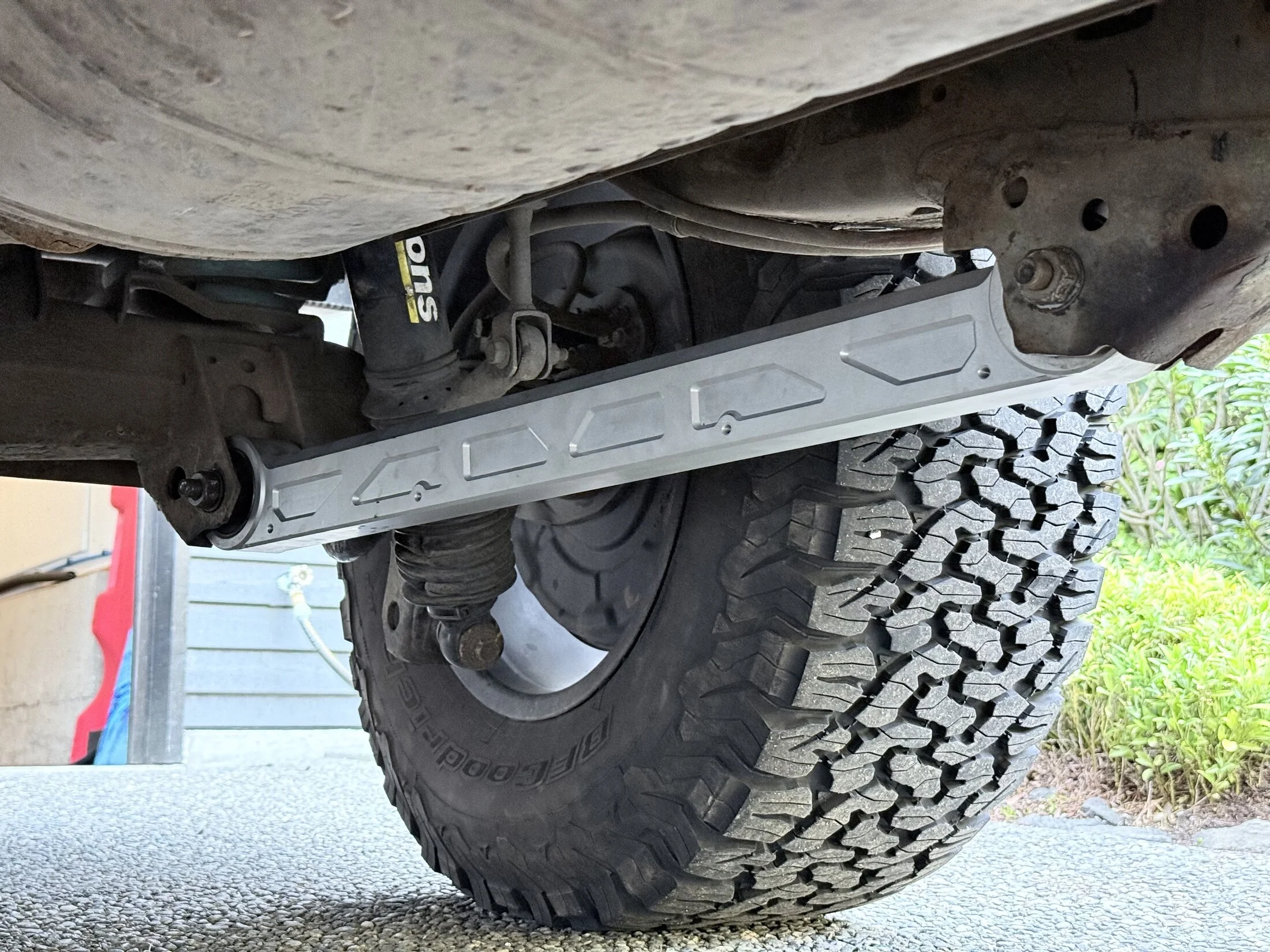

I also replaced my lower links with these seriously heavy billet ones from Superior Engineering. These are strong, light, and use OEM bushings. No brainer in my book.
I swear the ride was immediately more compliant. The bushings looked okay, the passenger side had a tiny kink in it. Feels so good now. To do: OEM upper rear links.
Next I installed some drop brackets for the rear sway bar to level it out at right height.
Here is the rear all buttoned up. Super happy with it all.

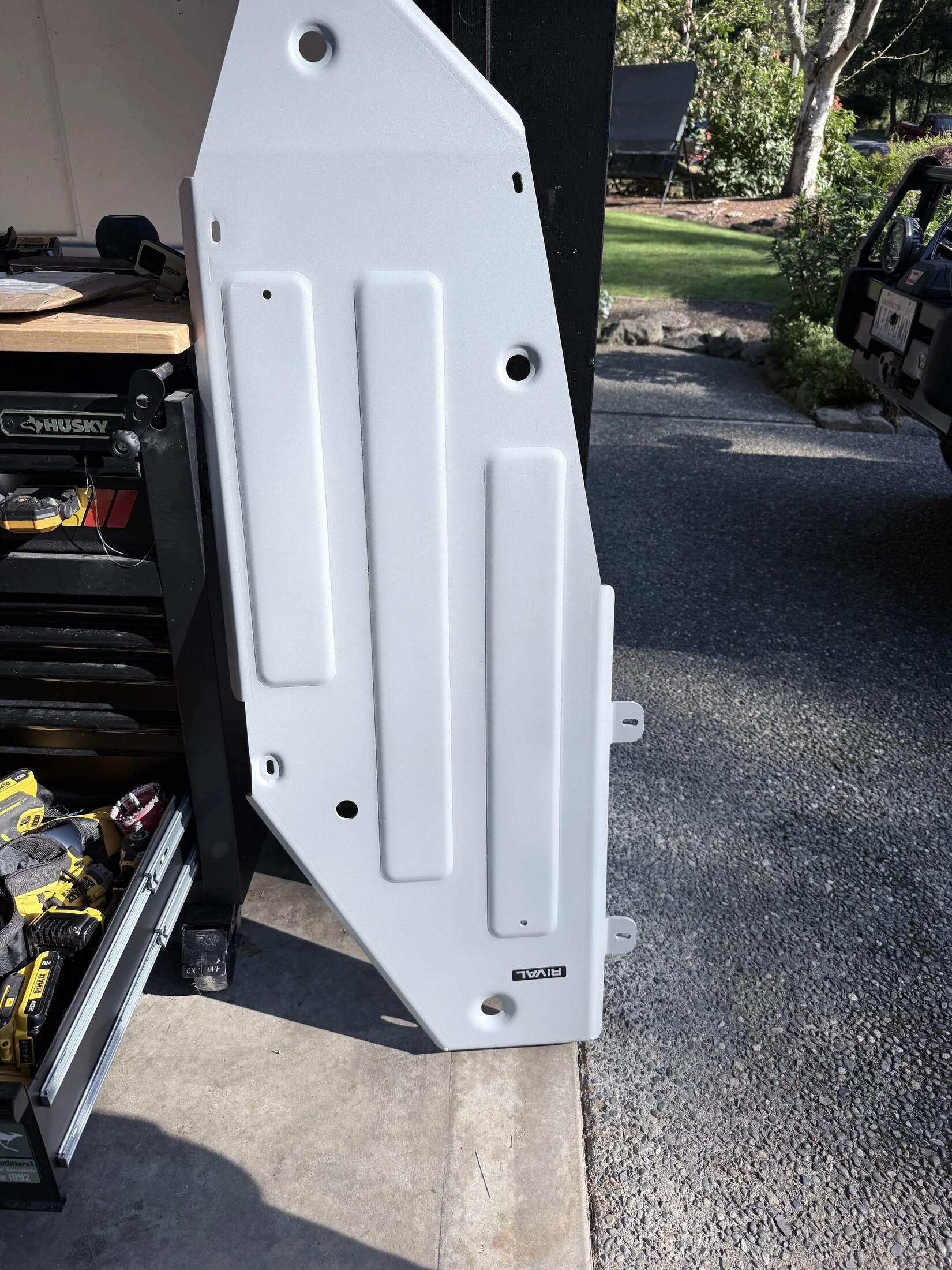

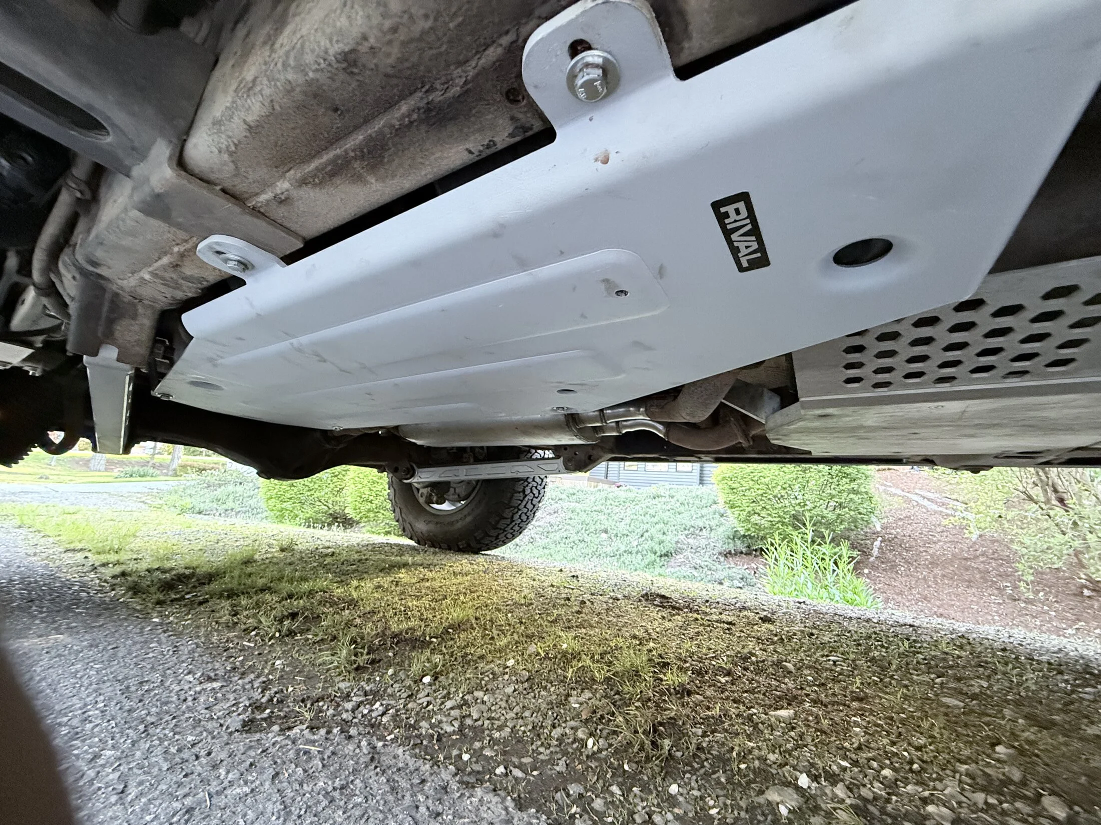

Working down a punch list on this sucker. This weekend I installed a Rival4x4 fuel tank skid. I wish it were bare aluminum but can’t beat the price and it shipped quickly from California.
While I was under there I tracked down a rattle that had been driving me nuts, it’s the foil heat shield above the exhaust. So of course the natural thing to do was to get a dual in single out 20” muffler installed for happy v8 noises.

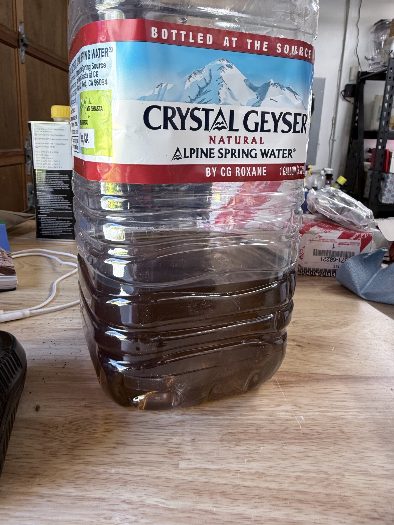

I also ran a full quart and a half of dot3 brake fluid through, the old stuff looked like forbidden kombucha. My brakes feel primo again.

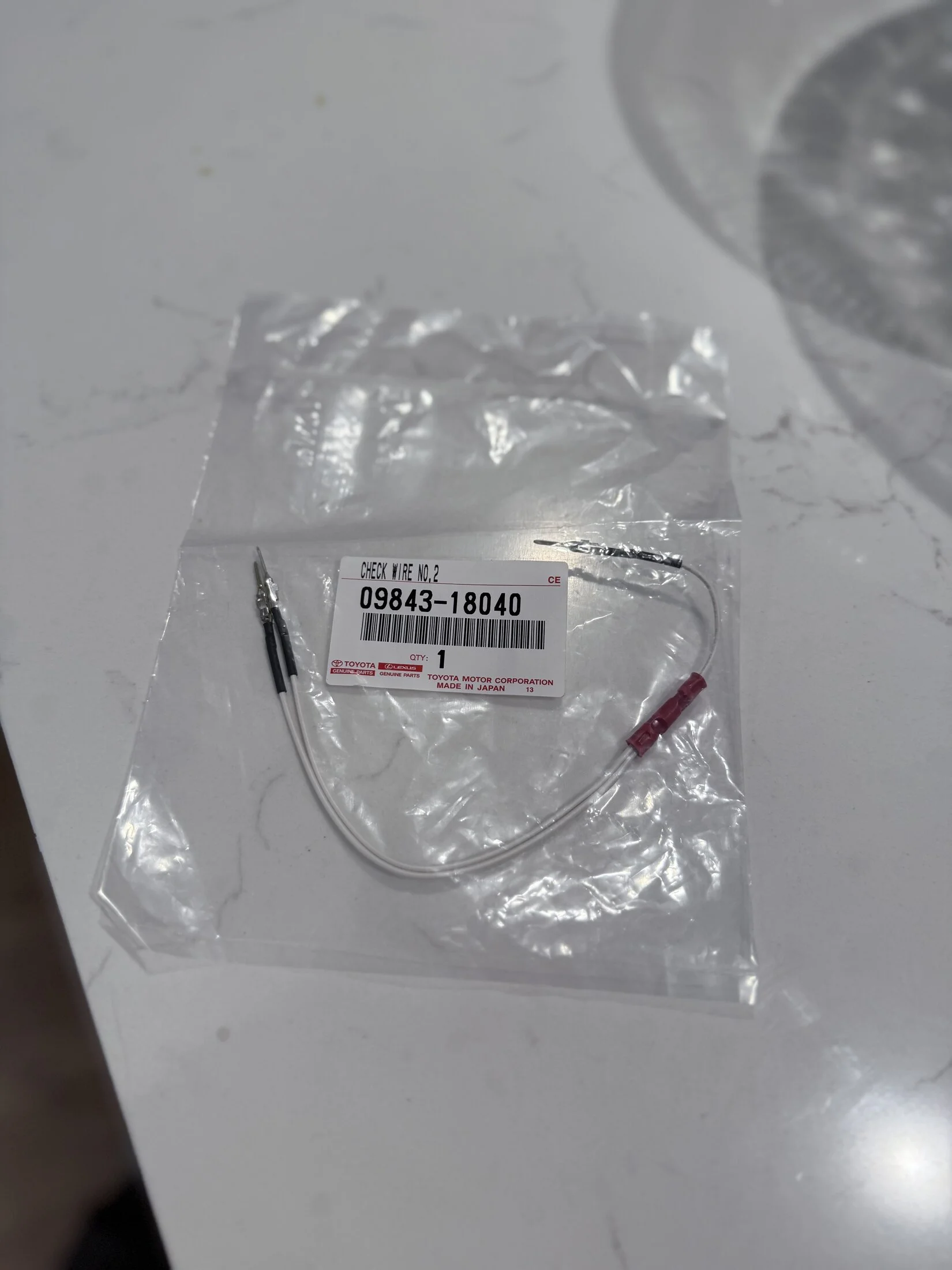

Lastly I did a zero point calibration using the wire tester SST thing. Hard to say but stability control seems much happier.
