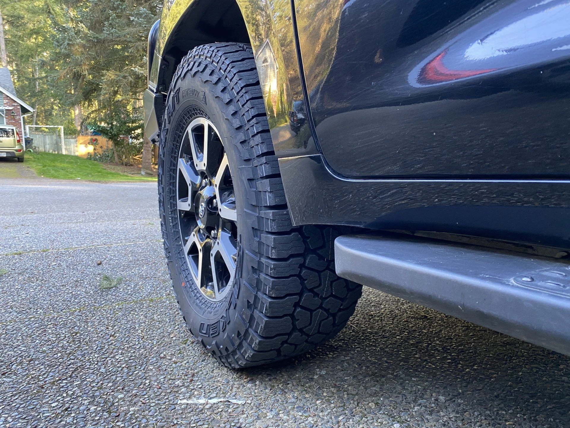

After nearly 15k miles running 275/70/18 Cooper STT Pros — I've concluded that I'm not a mud terrain kind of person. But that's another story. Today I installed (5) 295/70/18 Falken Wildpeak AT3W's on my LX and they fit like a glove.
Seriously, I don't know why this size isn't more popular. There are so many brands at this size vs 285/70/18.
Mounted the Falken's measure right at 33 3/4" tall and just over 11.5" wide. I have zero rubbing and they are oh-so-quiet compared to the mud terrains.
It took some work - but this size will fit underneath with millimeters to spare:

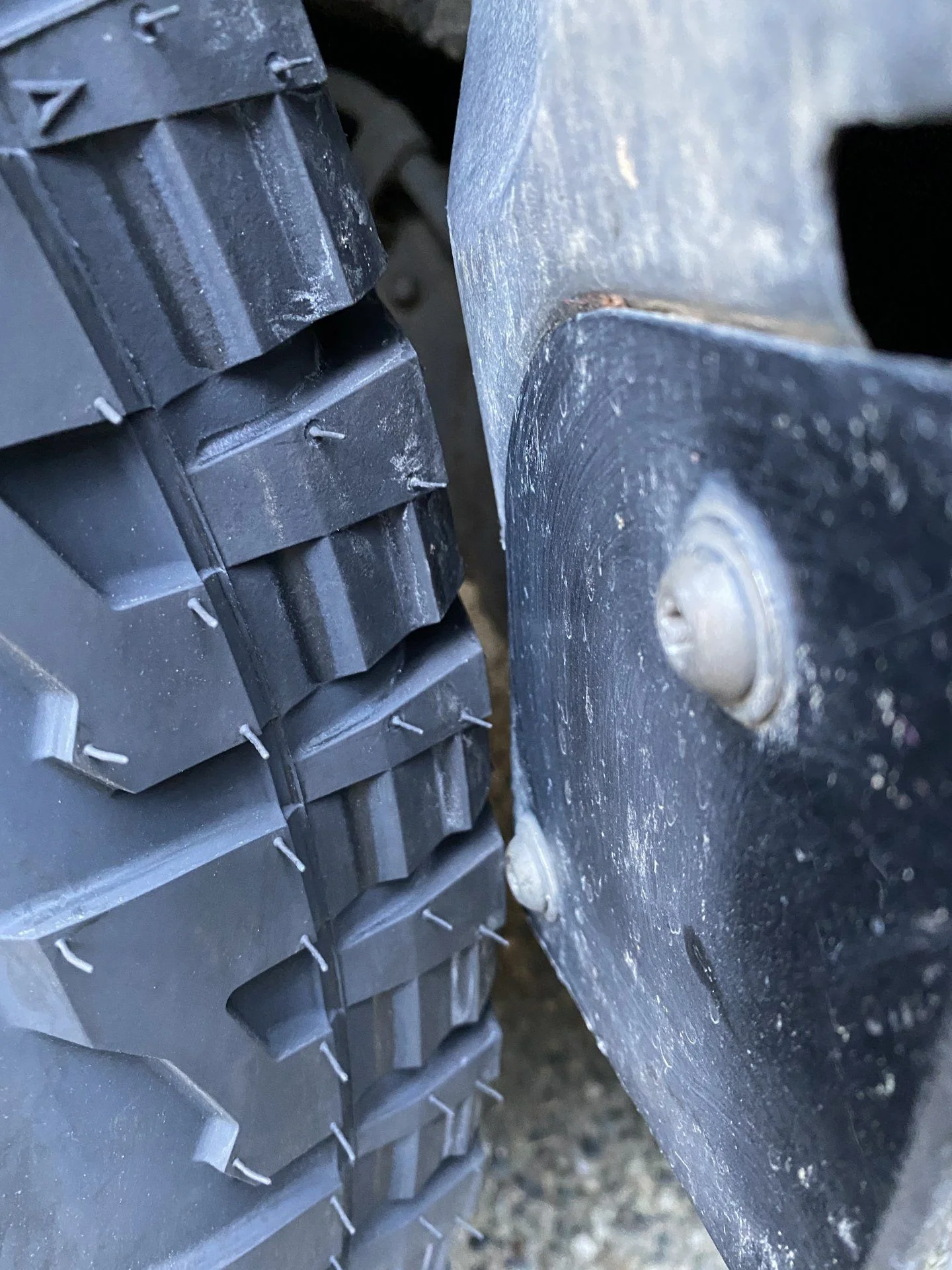

This size in the Toyo AT3 is a full inch taller and 10 lbs heavier than the 275/70R18. And I already have rubbing. Maybe not an issue without the KDSS bar?

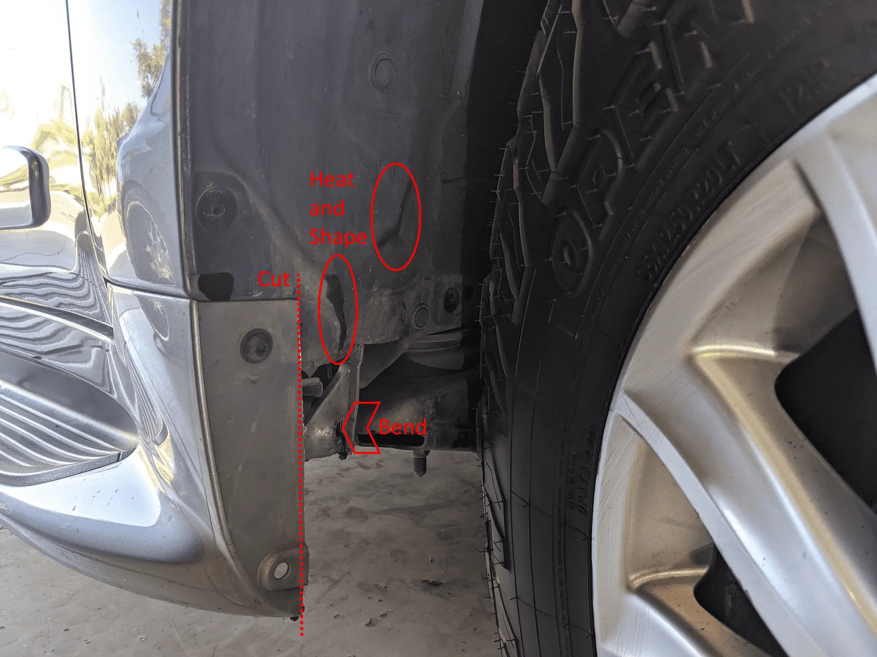

You may need to do some plastic cutting at the inner rocker. You'll find that on hard braking with some steering dialed in, that it'll want to get deeper into that rocker. You won't have to do as much as I did here but should be the general idea.
I tried this size for a test fit on the 16 LC, and it rubbed so badly on the KDSS I immediately went down to 285/70/18. The LX is definitely more tolerant of the larger sizes for sure!
Yep—35mm.
I was just chatting with @radman about this. I used a multi-tool to zip the plastic back but need to take care of the bracket next.
