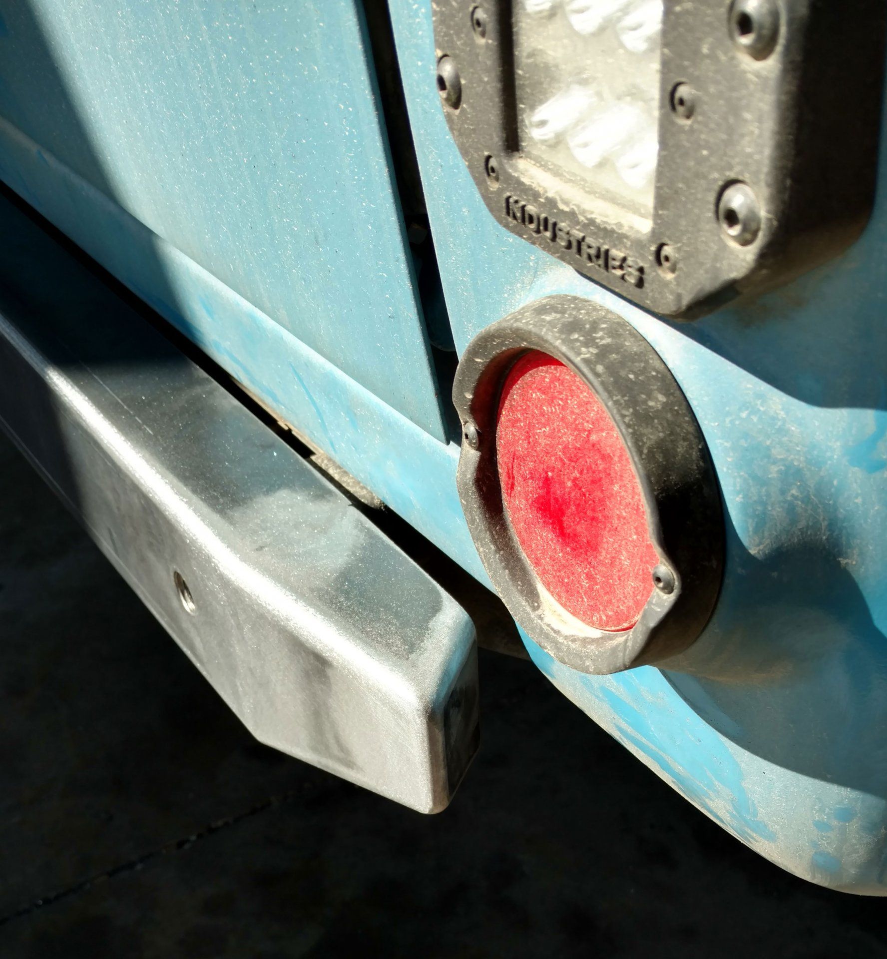

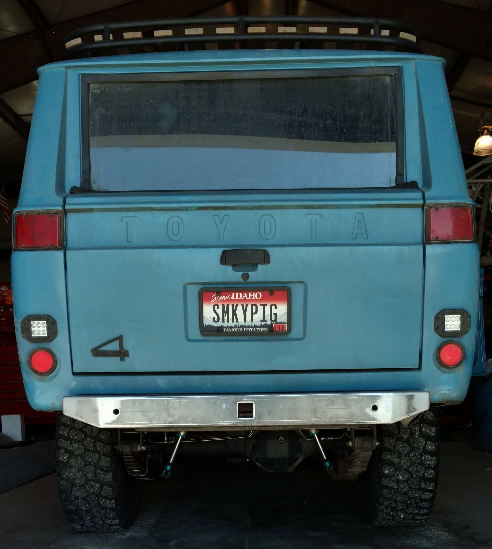

I was able to get out to the shop for a few hours yesterday and work on the rear bumper, the plan is to keep it compact and out of the way of the branches that ripped my factory bumper ends off.
The plan when time permits is to build a spare tire carrier to use a combo of receiver and recovery bolts holes so it can be easily removed.
So after trying a few combos I settled on this, basically it just covers the new rear cross member with the recovery points and receiver and has some minimal wings to hide the rear body opening out to the rear body mounts.
Lifting eyes screw into pads welded to the frame.
I wanted to have a receiver plug and some sort of shackle attachment point and couldn’t find what I wanted so I made my own. I still need to ¼ round all the edges but I’m content for now.
Cut a little long and scribe a line flush with the bumper.
Then machine to the scribe line, this is how it will be stored and act as a flush receiver plug.
Flip it around and screw one of the lifting eyes into the end and I have my shackle attachment point without carrying a bunch of extra crap in my recovery bag.
