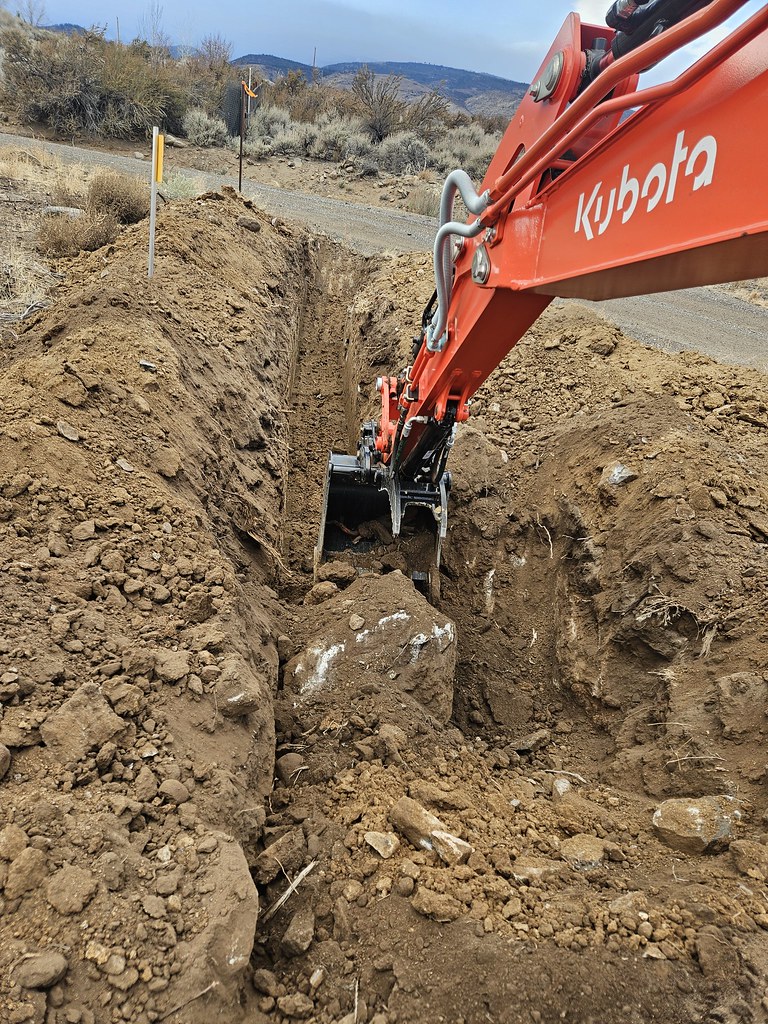

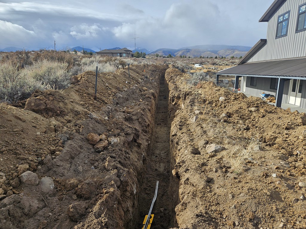

Trial by fire with the mini ex. After a few hours of messing around with grubbing, it was on to trenching. In theory its a fairly repetitive process, except when you encounter boulders bigger than your trench. The worst is when you have a giant boulder 2-3" into your 24" trench. The smart thing to do would be to grab the 12" trench bucket and make a 20" trench past the obstacle, but the stubbornness in me leads to digging a 60" wide section just to get the rock out. It's frustrating yet satisfying at the same time. Took about 8 hours to do 100' at 5' deep. The last 20' feet or so have been especially difficult. I really hope it's just an isolated boulder field. It is really impressive what the mini ex can lift. Some of those boulders must be 1000# +.
My son is 4', so as long as he is a bit below the top of the trench, I'm good.

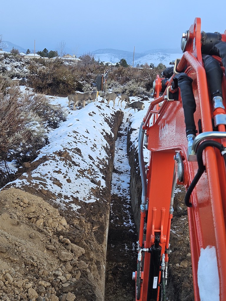

These deer were curious as to what I was doing. Definitely suburban deer as they did not seem to mind me working at all.

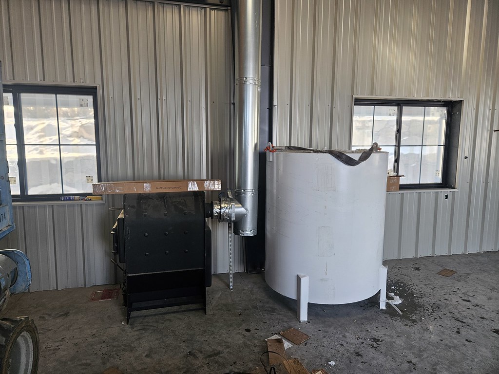

Got the flue installed for the wood boiler, and just dropped the 500g thermal storage tank in place. Plumber is supposed to get the last of the hydronic system hooked up next weekend so hopefully we can get the shop heated enough to proceed with drywall mud/tape.

I feel your pain- just did about 200’ for my gas line. Only needed to be 18” deep. The first 150’ went by as planned. The last 50’ were a different story, 2 boulders and probably the foundation to the original cabin that was near where the house sits.

The boulder field I encountered was only 30' long. Back to semi easy digging. 150' down, 650' to go.

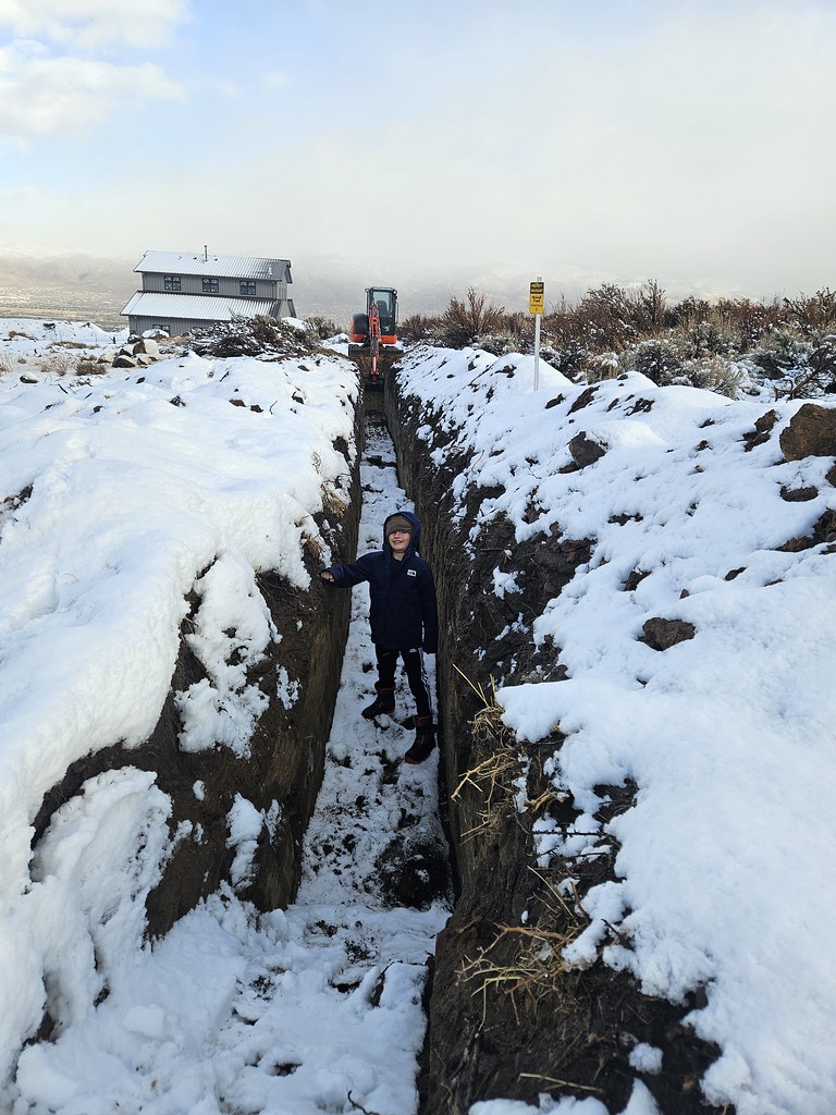

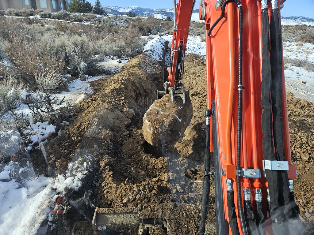

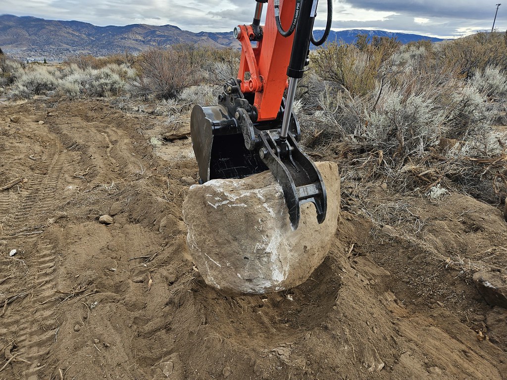

Halfway there. 400' to go. Excavator now has 45 hours on it. I probably spent 10 of those grubbing, and my first 10 hours trenching were not all that efficient, but now it kind of looks like I know what I am doing. After the boulder field, I hit this monster that was the size of the mini ex. I thought about getting an impact hammer attachment, or going up the street and offering the guys running a full size excavator on a nearby job a few hundred $$ to pluck it out, but decided doing a slight "S" curve around it made the most sense. Mercifully, as soon as I passed it, the soil changed from a really hard packed material to a much softer sandy loam that was really easy to dig. It would be interesting to have a geologist on site during the trenching, but I'm guessing the end of the boulder field corresponded with some underlying geological change.
I now see why most long term equipment operators have bad knees. The constant jumping in and out of the machine, and jumping into the trench to check depth really beats you up. Some type of laser range finder attached to the bucket would be awesome. :hmm:
Ironically the agency that has been the absolute most difficult to work with on access and power easements (USFS) has these markers that are perfect depth gauges. The top of the first yellow sign is exactly 60".
Do you really live on a street? And then, do that many people on this street have that many excavators that you could randomly hire someone to pull this boulder? Of course I’m kidding but wow….ypu have some trench going on….im truly impressed especially that you’re going on only 45 hours
Best guess is you are moving through the interfingering layers of a prograding (growing) alluvial fan. How far from the mountain front are you? Usually the rock size gets smaller the farther away you are. You’ve found some big boys so far.
3 miles from what I would consider the base. Reading the geotech report from our property, they did mention the whole area was part of an alluvial fan. We are on some type of "bench", that then slopes quickly downward to a creek at the east property line. The grading contractor mentioned that our property had much less large rock than they usually see in the area. The jobsite 1/3 mile away has pulled some pretty serious rocks out of the ground.
The surface rocks at the east end of the property line do get bigger, but we don't have to do any digging there.

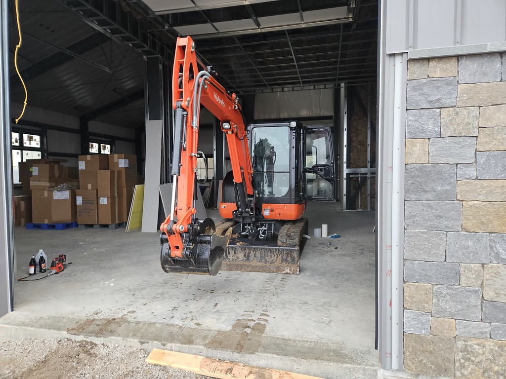

First maintenance on the mini (50hr). I was going to do it outside but it started snowing. Then I realized I could pull it in the shop. Radiant system is not hooked up yet but just being out of the elements and on flat concrete made this job easy. Drive motor oil change, drain water from water separator, and a ton of grease on the turntable. Battery grease gun is a must. FSM doesn't call for an oil change until 500 hours but I felt better doing one early.

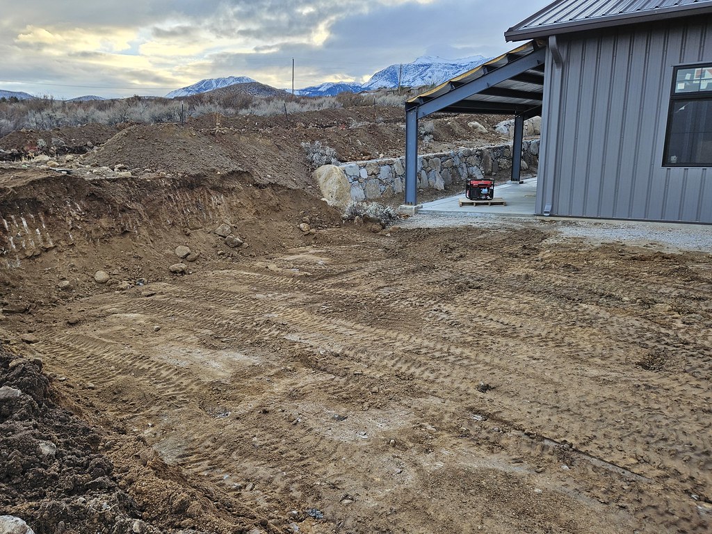

Cut quite a bit of this bank out. Plan is to extend the rock wall another 50-60 feet. Wife wants a chunk of lawn right where the remaining rock pile is. I'm getting good at moving rocks. I need to dig a spot for the vault transformer and trench the secondary wire run to the house. We plan on a decent sized solar system (60kw) so it probably makes sense to trench the conduit/wire going out to that too.
