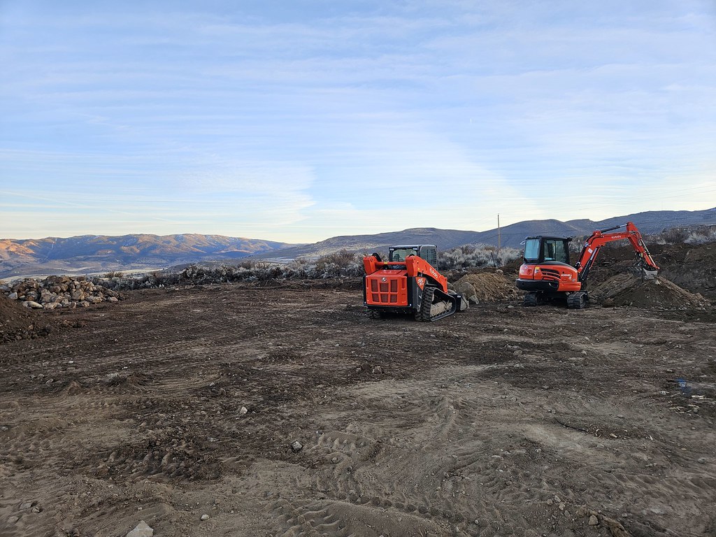

Finished clearing the extended parking area and future lawn spot. Luckily I have a slight slope to the property so I can push excess dirt downhill, and a neighbor took 75 yards of dirt for some fill.

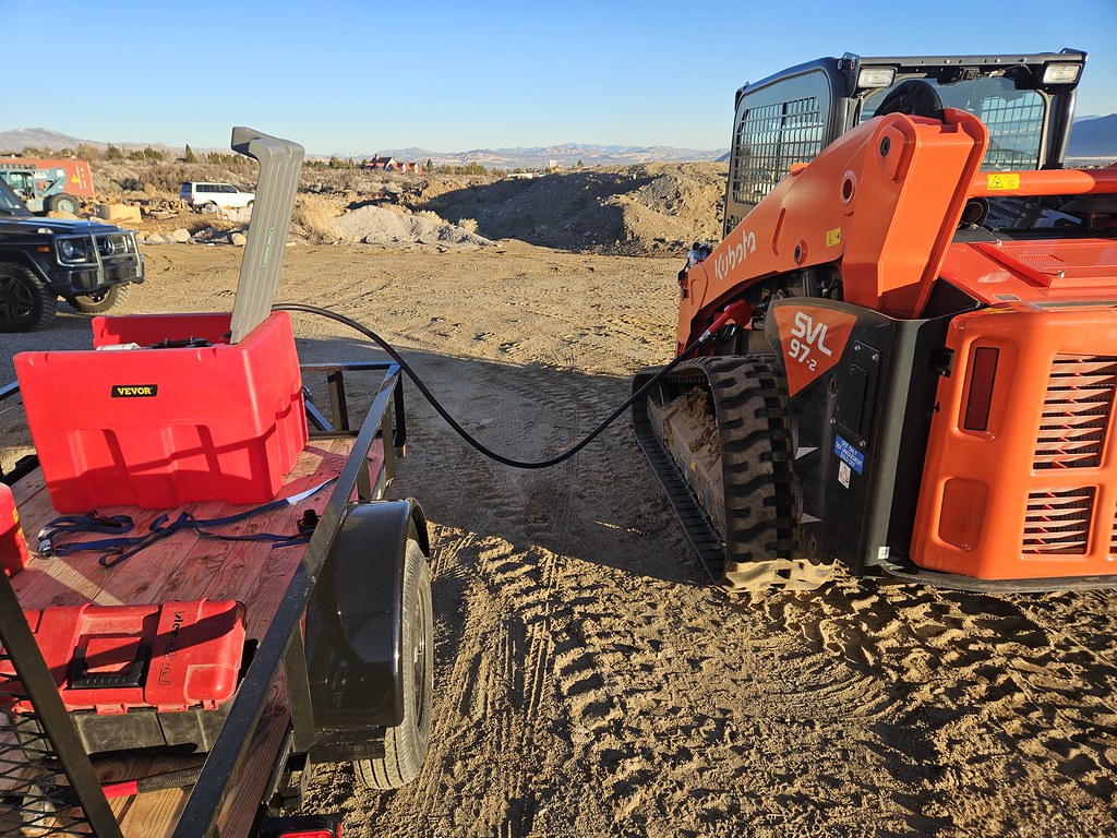

Got this for a temporary fuel fix. 68 gallon fuel tank with filter and 12v pump. Works great! So much faster and less messy than dealing with hand pouring 5g jerry cans.

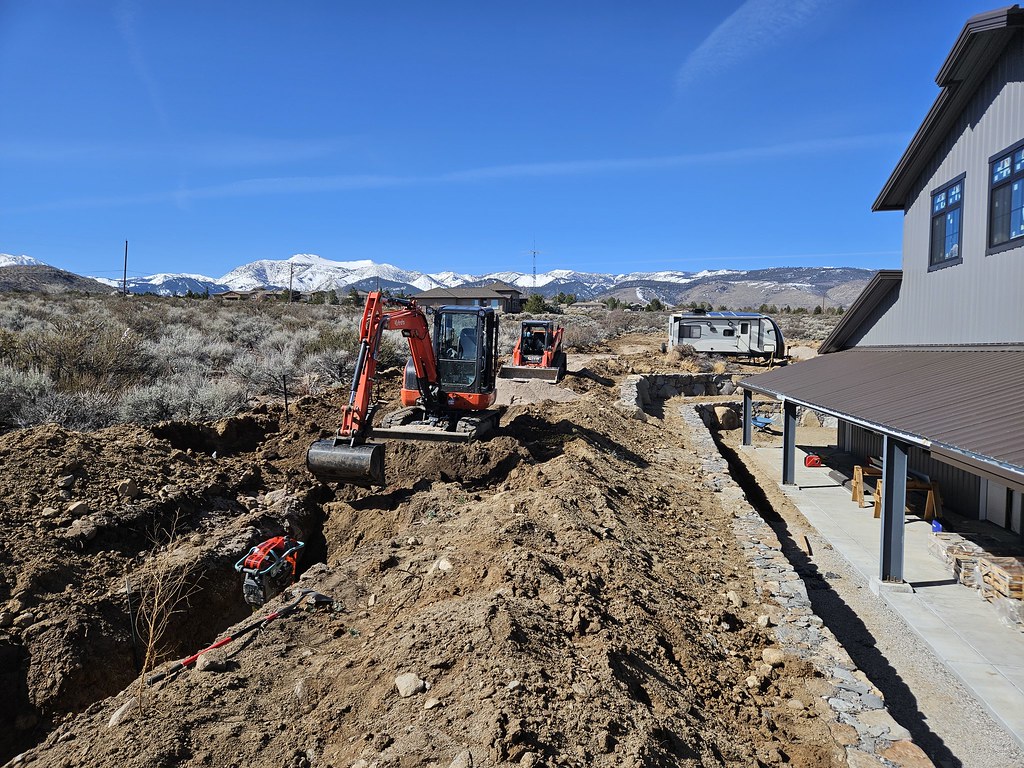

Almost done with the trenching too. Still waiting on the local power company to coordinate hiring an archeologist with the USFS so they can observe me digging for 10' on the USFS easement. You cannot make this stuff up.
Always fun when you hit a big boulder, then try to dig around it and find one right next to it. I've noticed that decomposed granite means a big boulder is lurking in the next scoop or two.

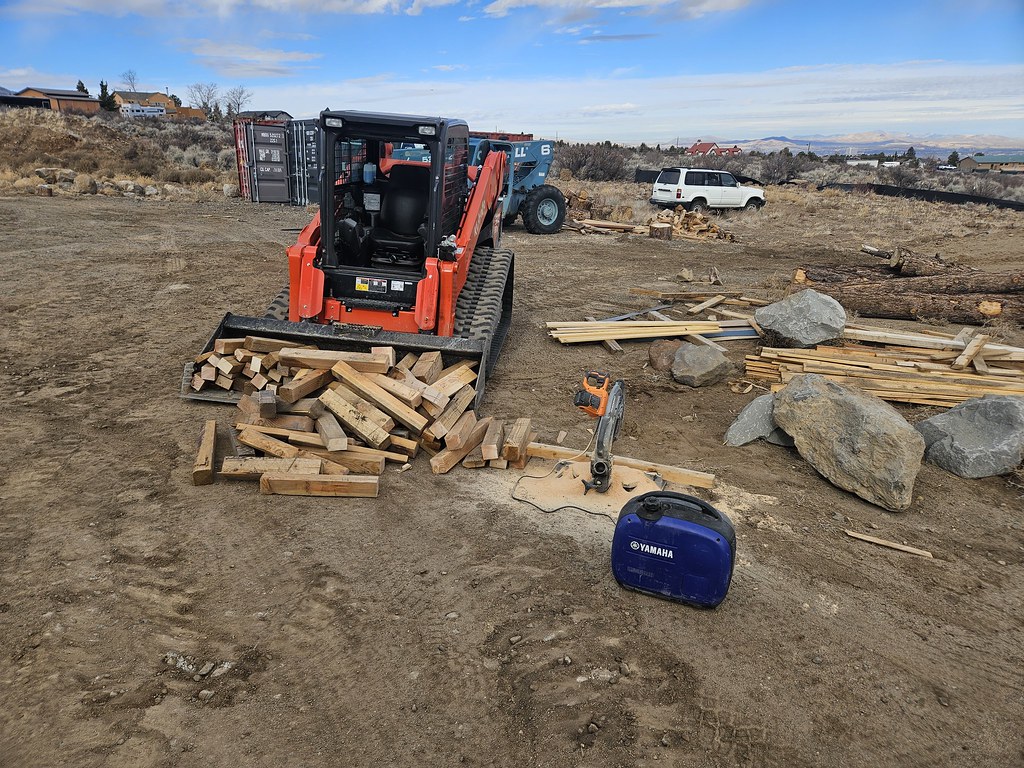

All of the wood blocks that the metal building kit came on turned out to be oak! I quickly turned those into firewood. Having the skid steer to move wood around is nice too. I can dump it inside right next to the boiler, where it promptly disappears.

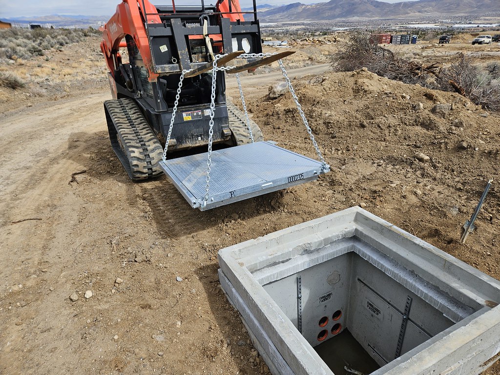

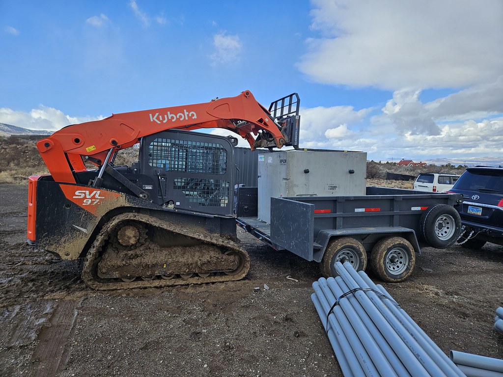

Finally got USFS approval for the power easement on their 20'. Since the power run is 800', the utility required this monstrous vault box. Putting both the 200 and SVL 97 to work.

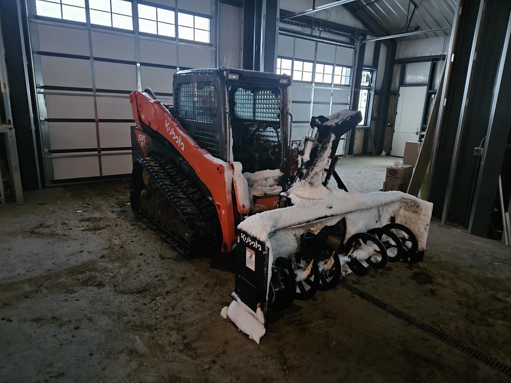

Of course the weekend after I got USFS approval, it snowed 12". Got to use the blower and it cleared my 1000' dirt driveway in 10 minutes with me in pajamas and slippers. I was pretty impressed. Later, the snow turned to rain and I had to dig this 10' section under archaeologist supervision and with their scheduling, I couldn't wait for a better time. Trench is 5' deep, power pole is 6' deep. Trench was a muddy mess but the inspector wanted me to cover up the first 10' before we got 40mph winds that evening. I did not want to be responsible for taking out power for the entire neighborhood.

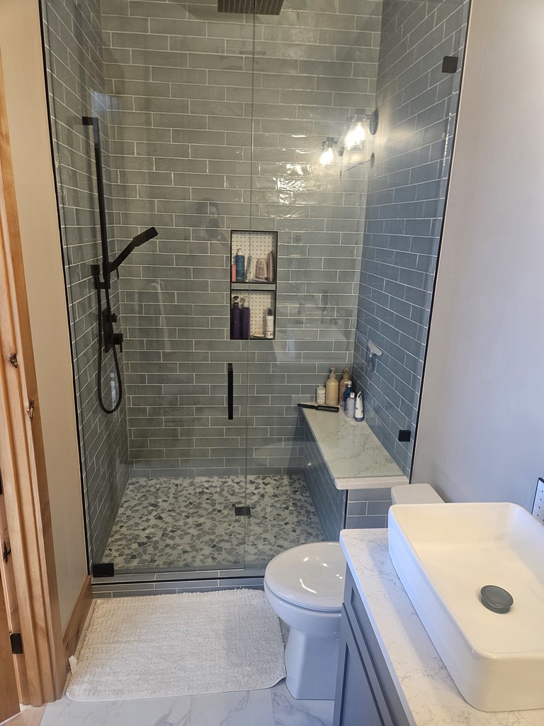

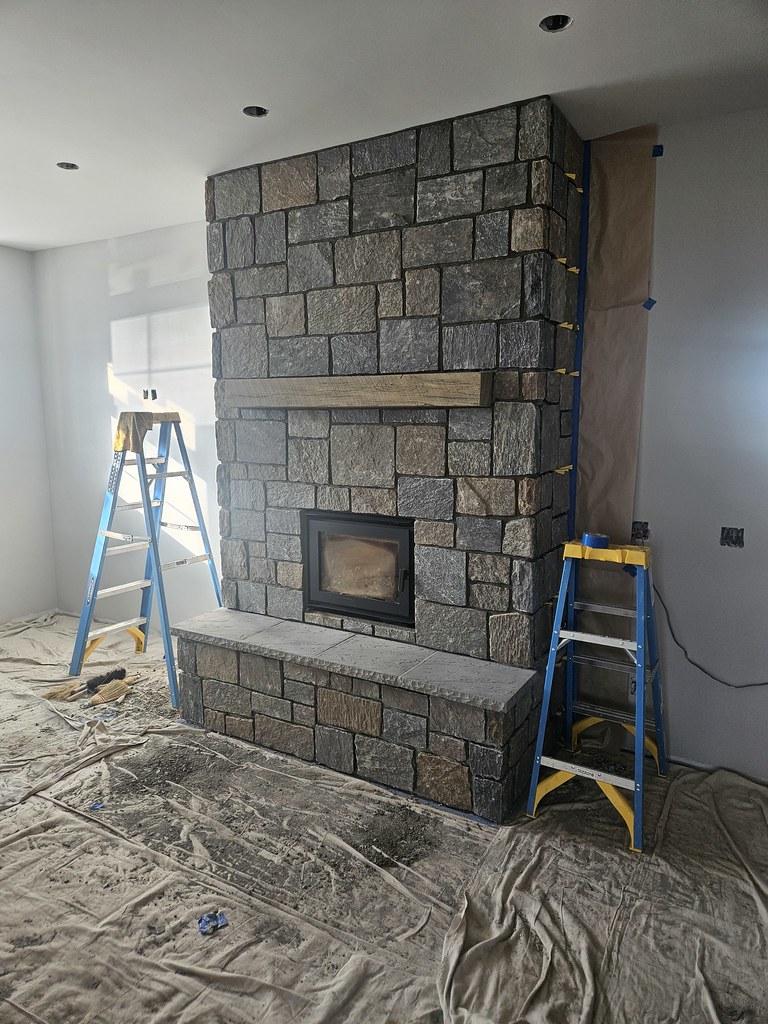

Definitely a lot going on upstairs. Had the floors installed, then the mason did the stone on the fireplace and tile crew started too. Moved all cabinets upstairs (those furniture moving straps are awesome) and staged them for install. Garage door contractor installed the openers. I was not impressed with Liftmaster's current offerings and ended up with these commercial spec Micanans. They should outlast the doors.

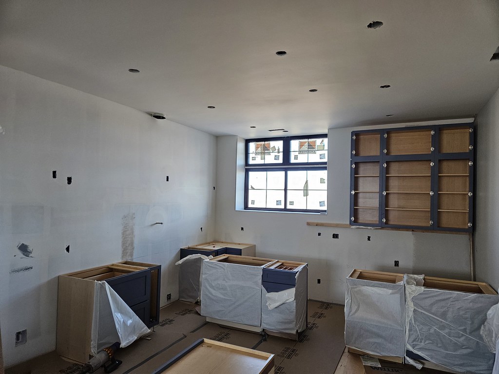

Started install of cabinets. Tile crew finished the kids bathroom and are working on the master bath. Tile work is pretty messy but I was able to put some RamBoard and tarps down on all the floors.

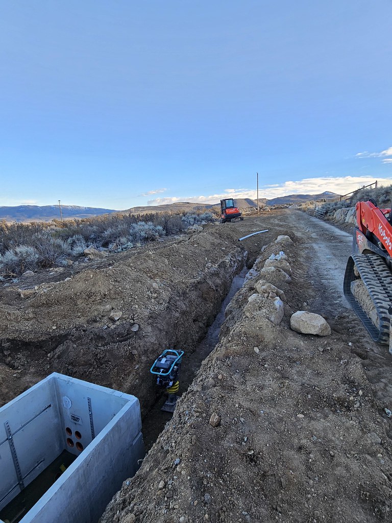

Getting closer with power, probably 1/3rd done with conduit. That pole in the background is 280' away. Getting the pull box into place was a little difficult, but luckily I had a friend help with that part. I now see why the bid for the electrical service was so high. There is a lot that goes into not just digging the trench, but trucking in sand, setting conduit, more sand, compacting, and backfilling. Wrestling with a 150# jumping jack compactor is a workout. 8 hours of that and I'm almost too tired to move, but it is a very satisfying kind of tired. I'm hoping to have power to the meter/panel in another 3 weekends.

Agree completely; this was one of the most satisfying things to do on my build, though I had the power co-op bring poles 1/2 mile or so and I only had to do the underground part from the last pole about a 150' total. A ton of work, but think how much you saved doing it yourself, and you know it's done right.
This is probably the more stressful part of the entire build as your mind sees it finished but your body is demanding to keep pushing to get it done. I love the job you’re doing and the amazing site work. Gotta be super satisfying.

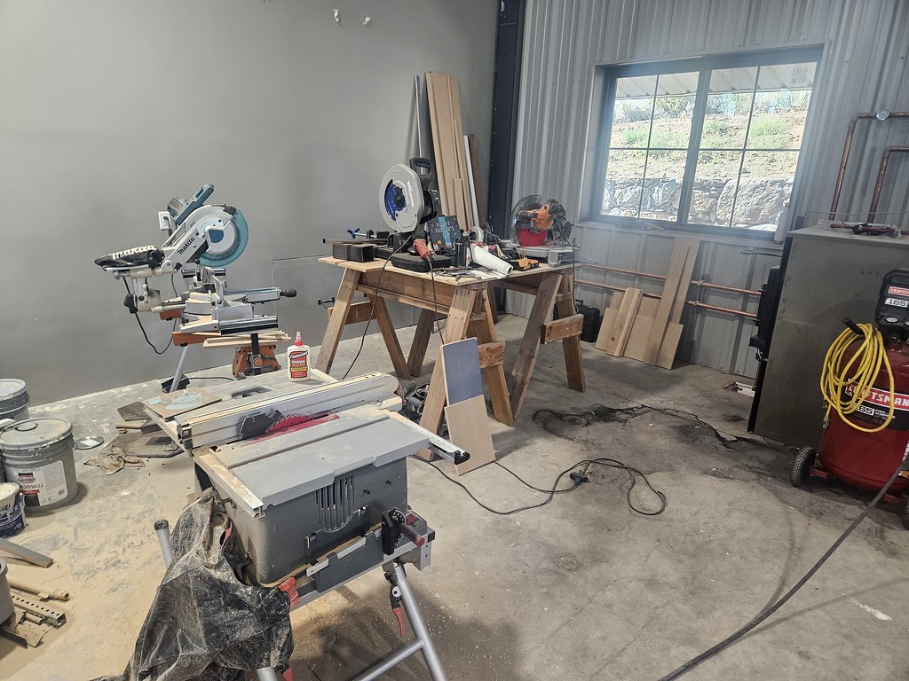

I realized yesterday that I am 98%finished at our house and spent several hours with the FJ40 cleaning up the mess from table saw and DeWalt compound saw. It was 30+ miters that made a Bigger mess than the table saw cuts to flooring planks
For me, that’s happy
You should be “tickled pink’ as they say 👏

Close but not there yet. I think we are about 4 weeks out from a COO. There is still a fair amount of finish work, and we still don't have electricity. I did complete the trench/conduit and the power company was able to pull a 3" mandrel through (meaning no crushed sections) so we could pull mule tape and get on their schedule for the transformer/meter/primary wire/secondary wire install. I'm hoping this isn't more than a few weeks out. Its amazing how fast half a shopping bag tied to some twine will move through conduit with a shop vac is sucking on the other end. Hand pulling the mule tape with the twine was quite a bit slower.

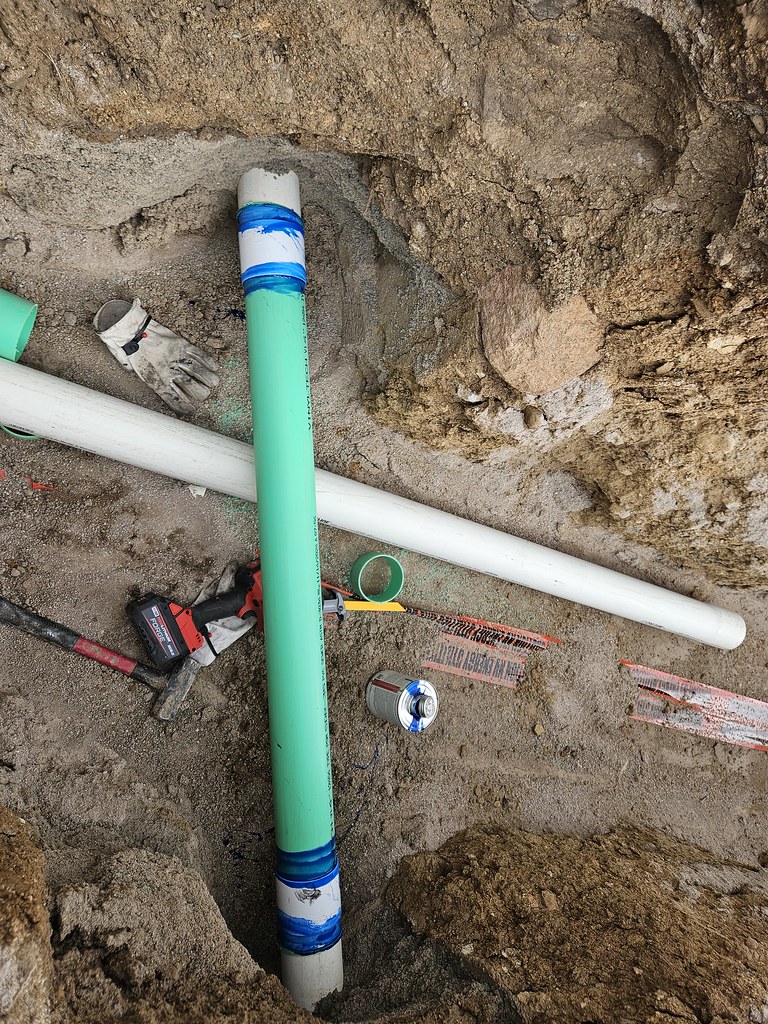

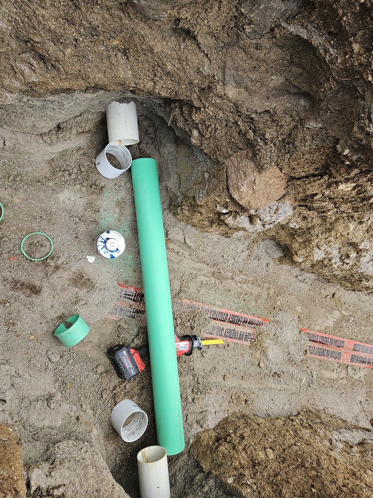

Learned how to easily repair PVC pipe after hitting my septic line trenching the secondary wire run. Luckily it was not in service yet. All you need to do is dremel out the center stop of a coupler and now it will slide past the joint. Cut pipe to fit exactly inside the splice and glue/slide coupler and you are done.

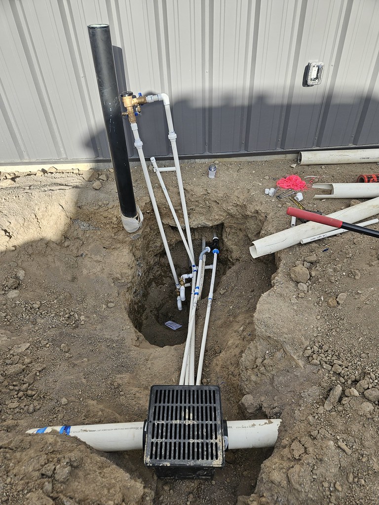

I don't want any water or snow melt going under the slab so every downspout has a drain box that goes to a dedicated 4" drain line that exits below grade.

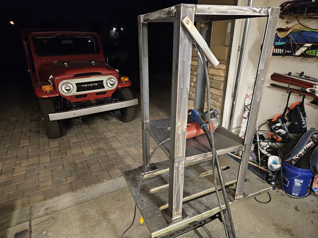

Got to do a quick welding project for a stand for the booster pump.

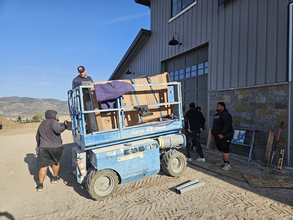

Moving the 42" SubZero upstairs. We tried the stairs, and it didn't clear by 2". We thought about removing the top mount compressor, but the second story window route looked like less effort. It wasn't too bad but I don't want to have to do that again.

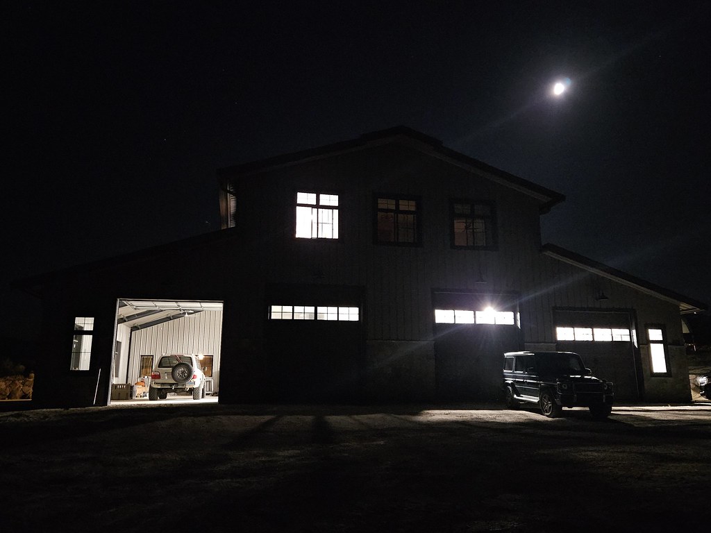

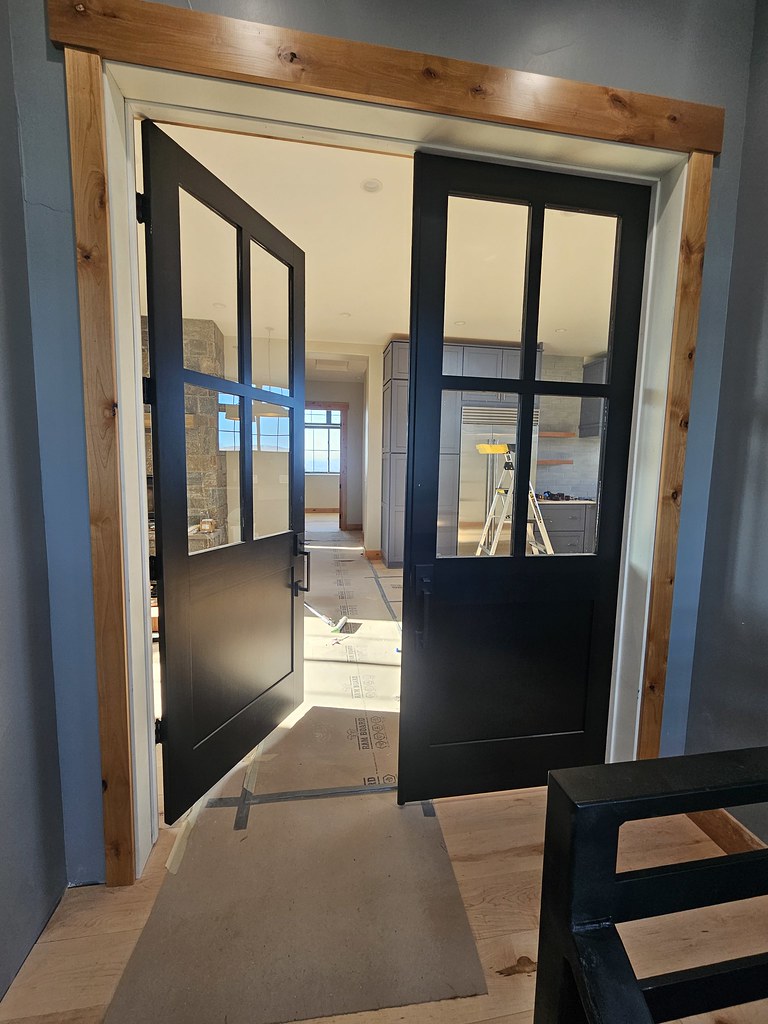

All done and moved in! I forgot how miserable moving is. There is still some light finish work that I am slowly completing (stair trim, cabinet detail, additional shelves in kitchen, pull handles, casing on windows) but we are 99% there. We are really happy with how things turned out. It already feels like home.

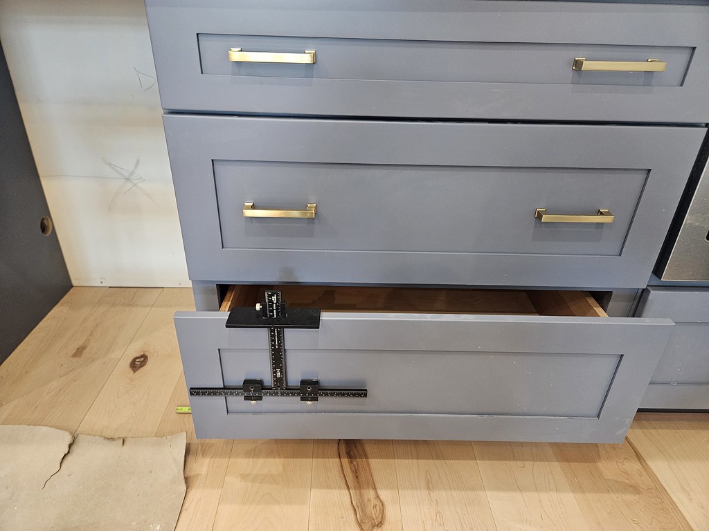

I had a finish carpenter helping but he could only do a few hours a week so I had to learn how to do everything from hanging/casing doors to baseboard outside corners, closet shelving, cabinet install, etc. Probably not bad skills to acquire, and that justified buying some additional tools. Cordless finish nailer and oscilatting multi tool are two of my new favorites.
A good pull handle jig is well worth it!

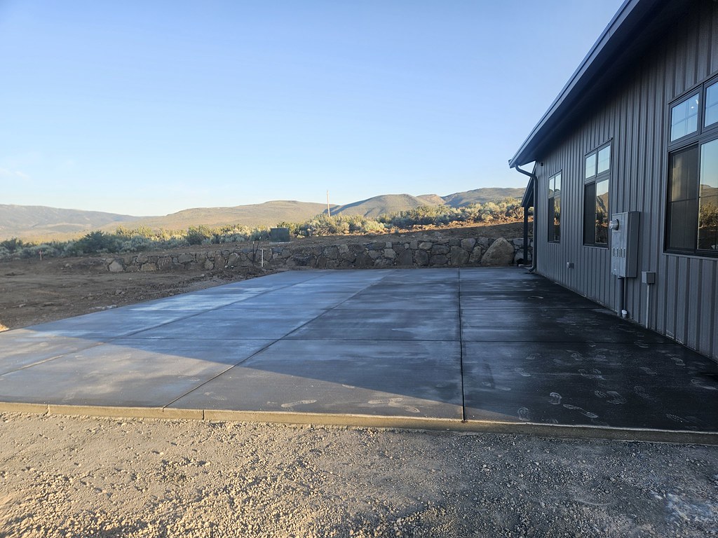

Added a slab on the side for parking and equipment washing..with a hot/cold hose bib
