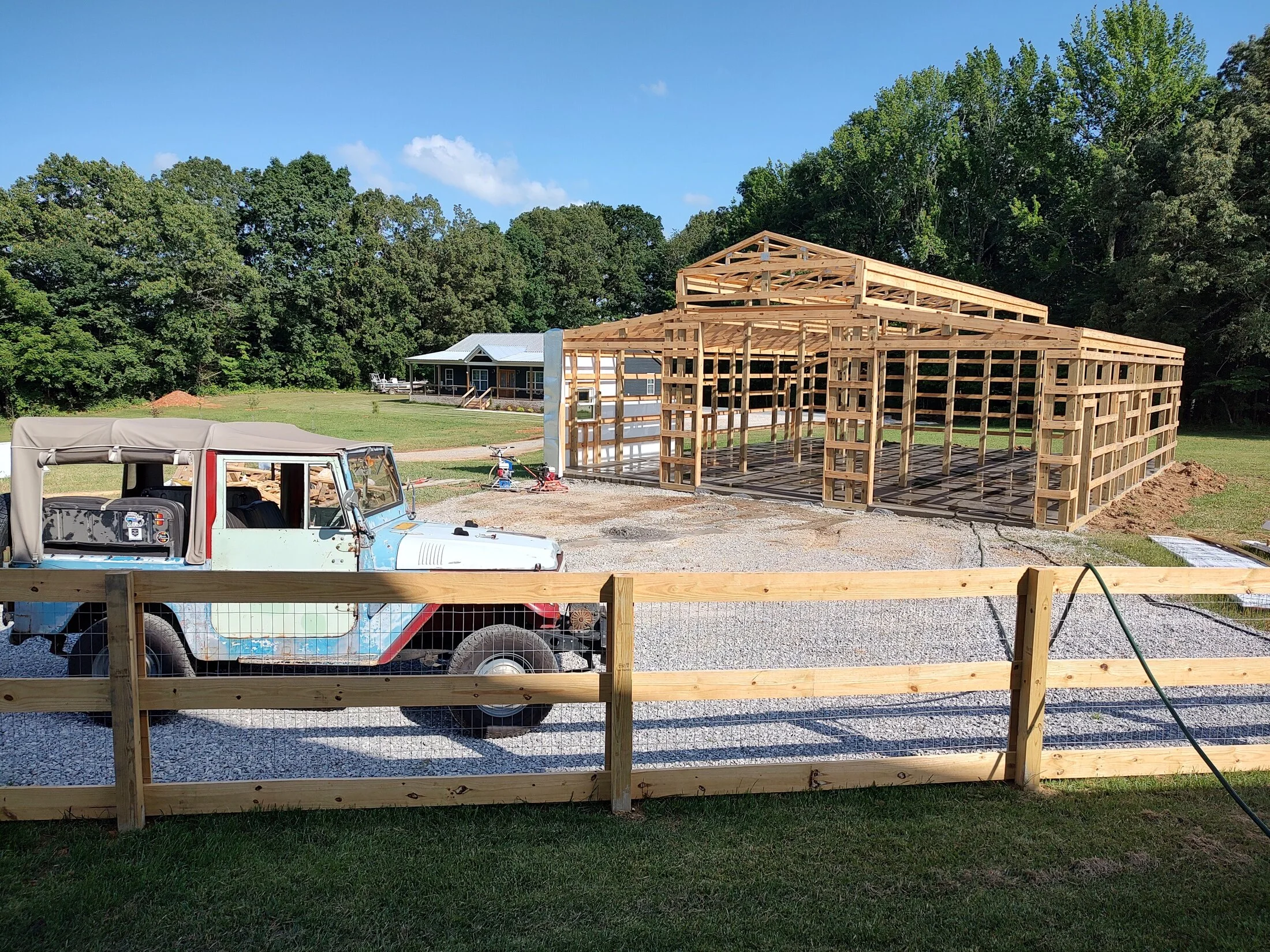

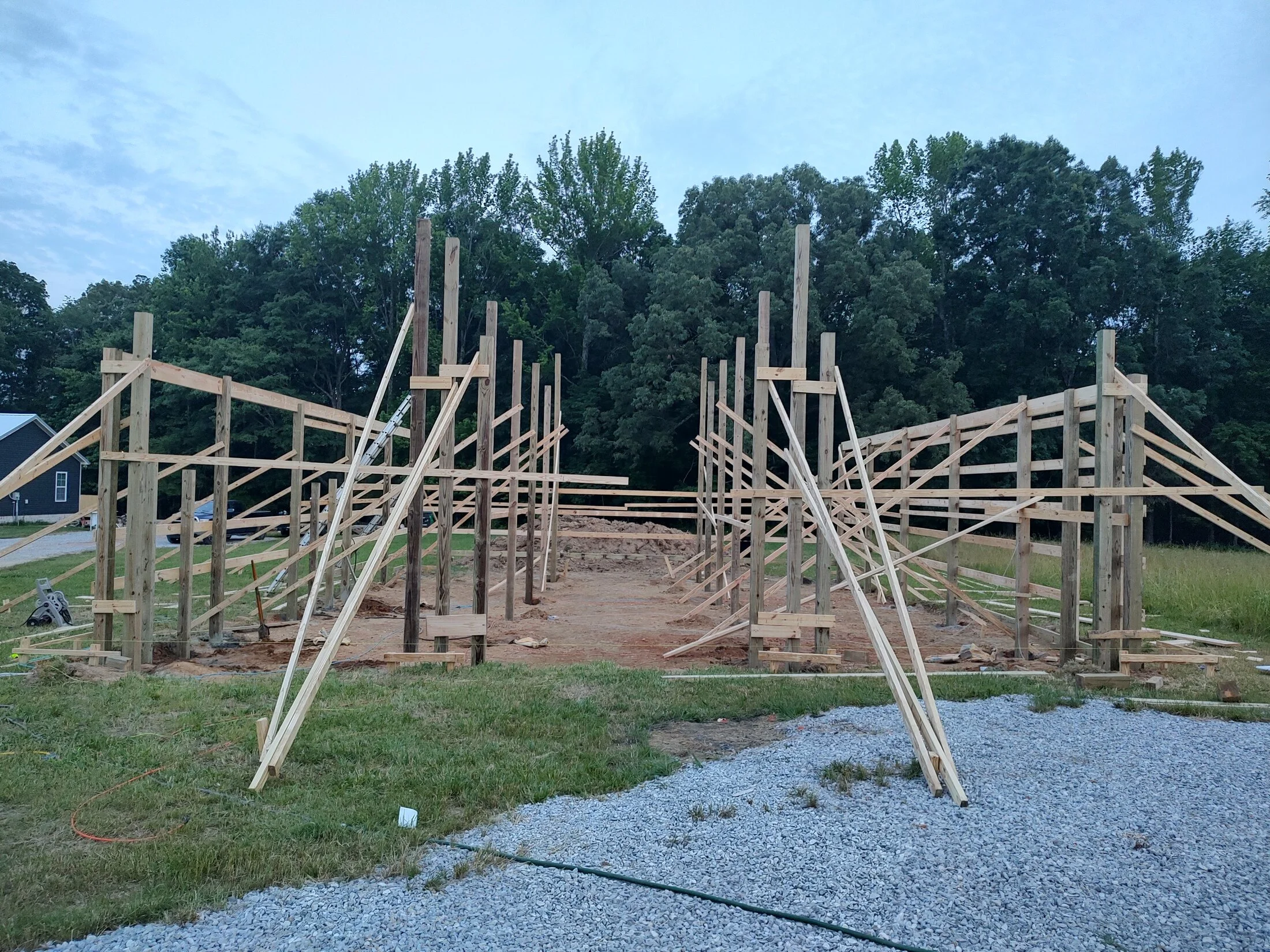

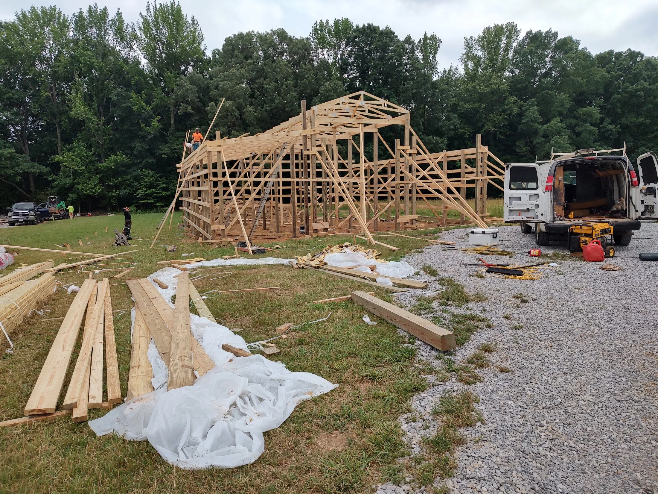

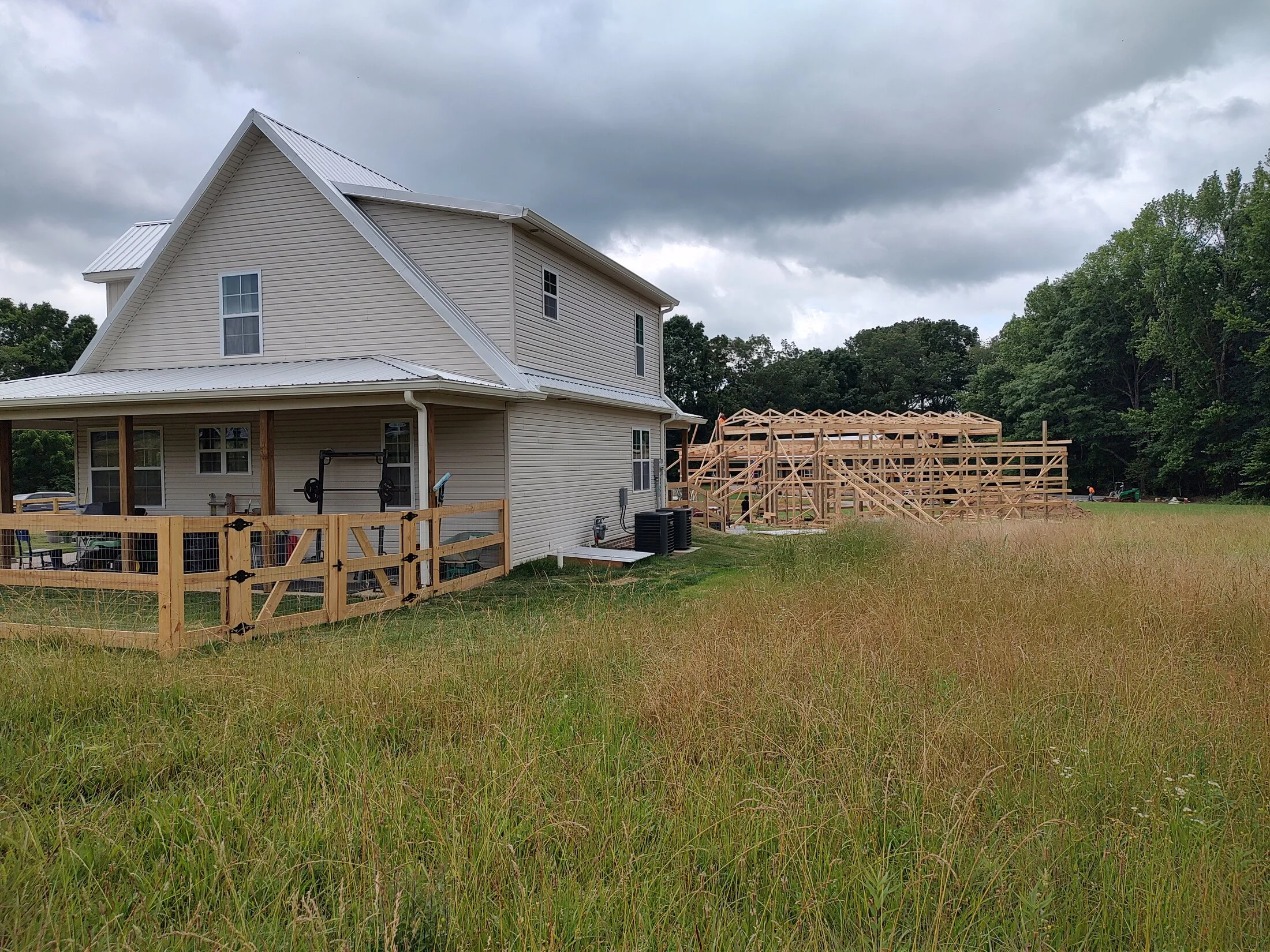

Fast forward to today and we are building a 40 x 50 barn for the purpose of rescuing dogs and working on old cars.

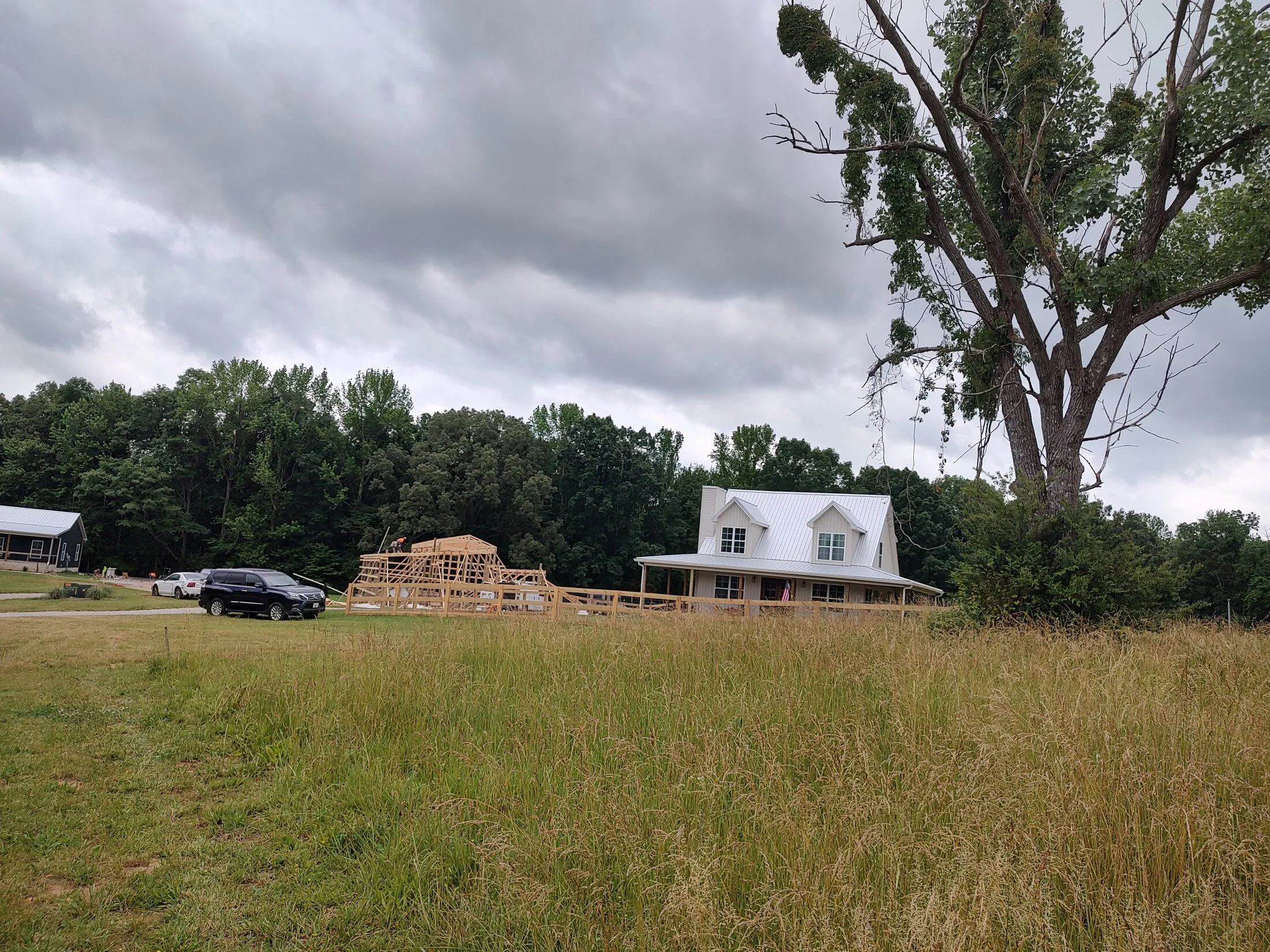

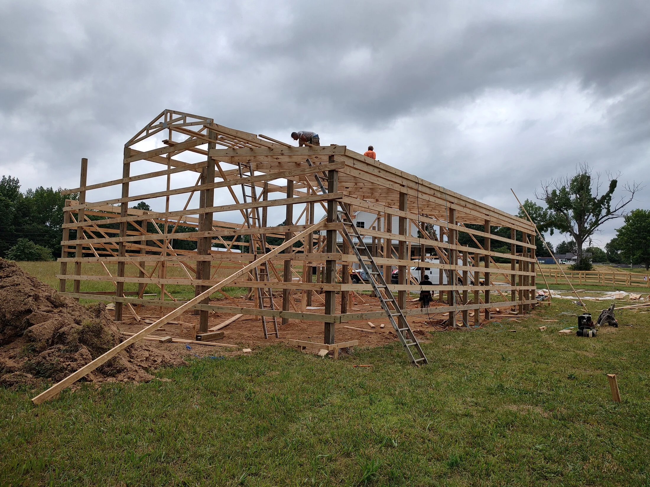

Framing done.
As far as drawings, we've been doing this one off the cuff. 3 parking spots in the first 1/3 of the building with a loft and dog kennels in the back 2/3.
The loft will be a combination storage/ playhouse.
The great thing about this style of construction is that you can configure it as you go.

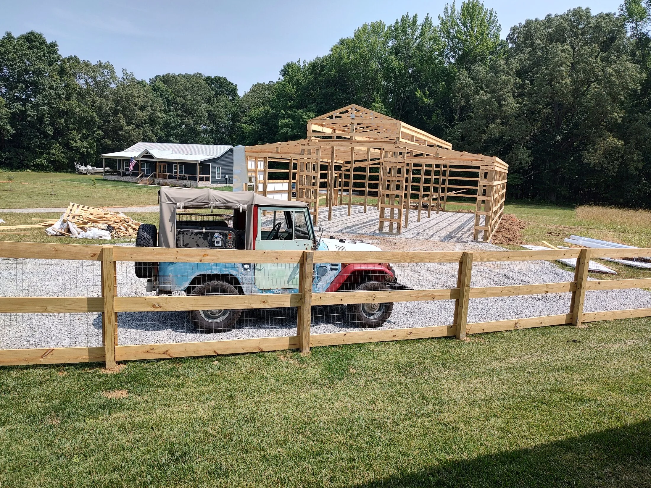

Waiting for cement so they can side and insulate.
I typically specify to side and roof before concrete to better control the concrete curing in shade.
Not really sure. General contractor is on top of that and I didn't know I needed one.
You don't need one if you aren't concerned about what you are getting. At a minimum I would want to know concrete psi, thickness (in the middle and on the edges), whether or not there is welded wire (should be), rebar around the thickened edge (should be), finish spec, and cure plan.

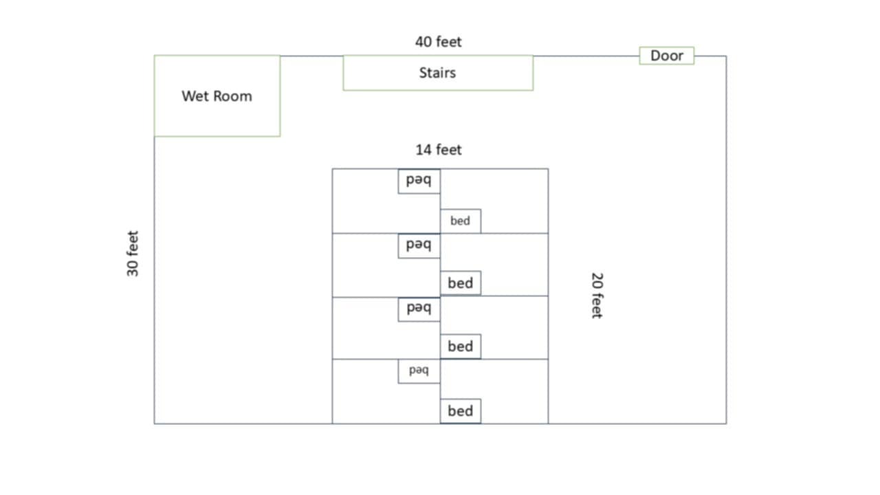

We've settled on an interior plan. The great thing about pole buildings is their flexibility. This is a picture of the 2/3 of the barn dedicated to rescuing dogs. 8 permanent stalls in the center with a loft for activities above. This maximizes head room in the loft and minimizes the amount of space that needs heated/cooled 24/7.
We can add more temporary kennels along the outside walls as necessary
