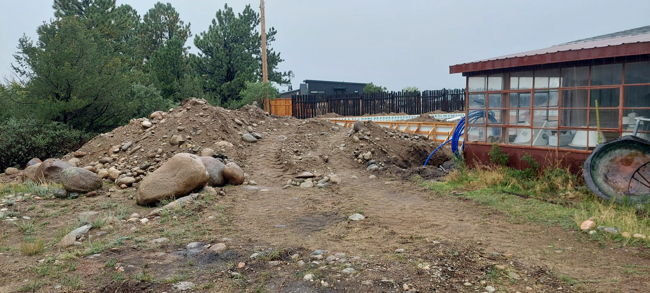

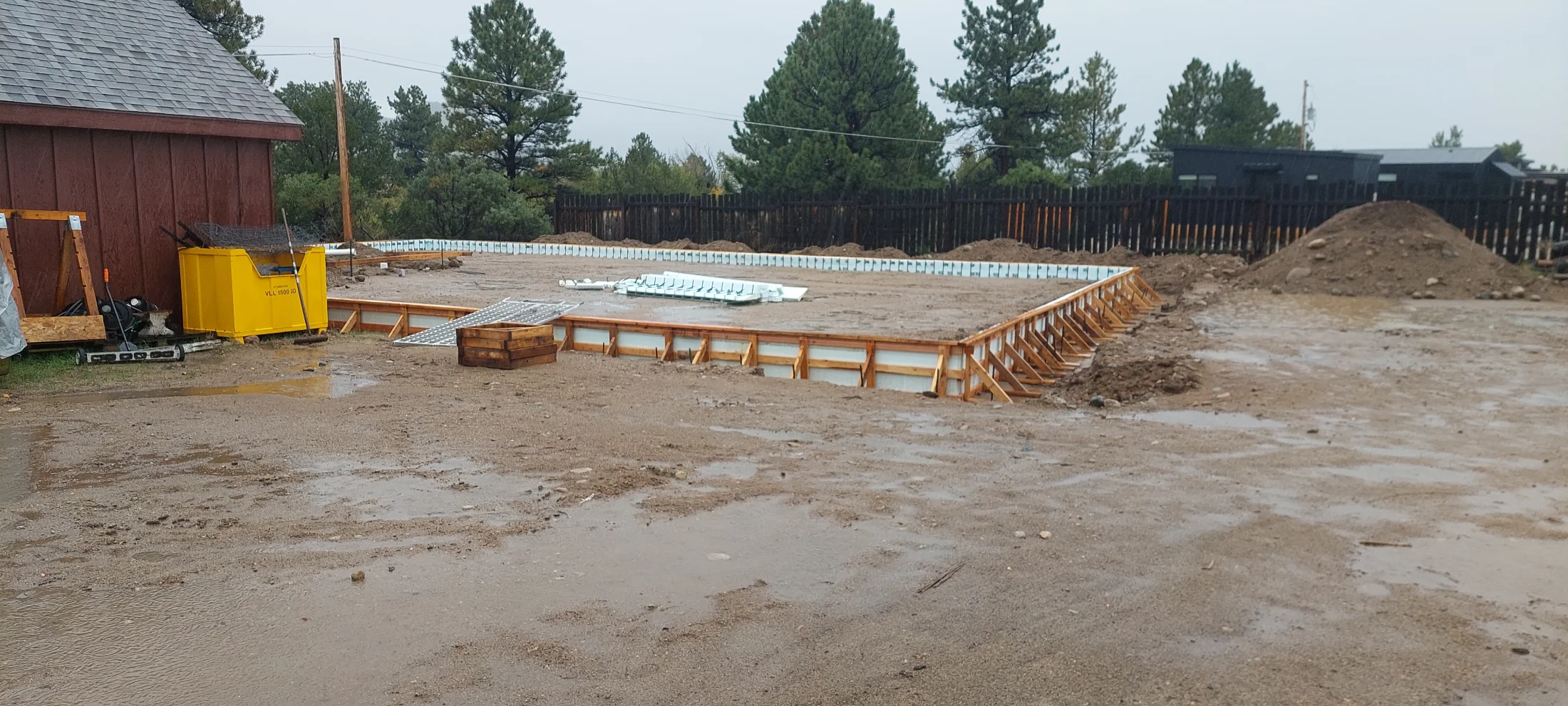

New 42 x 60 steel building at my Dad's for a new shop. I need more space to fit all my tools and keep working on stuff on my free time.
Its a frost protected monopour, so only needed to go down 16".

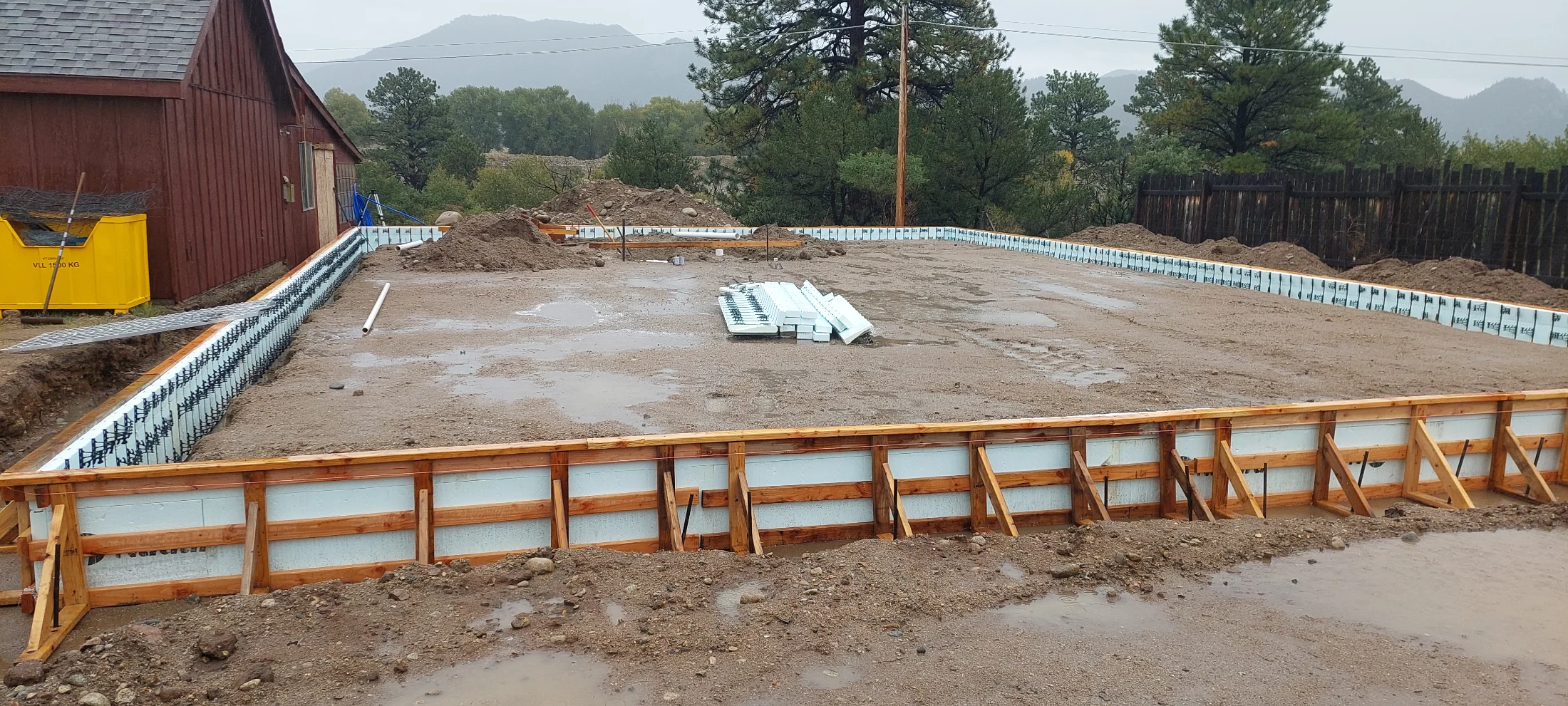

I over cut and brought in clean fill to get rid of the massive amounts of river rock around here. 16 loads of structural fill in the pad and stem wall trench.

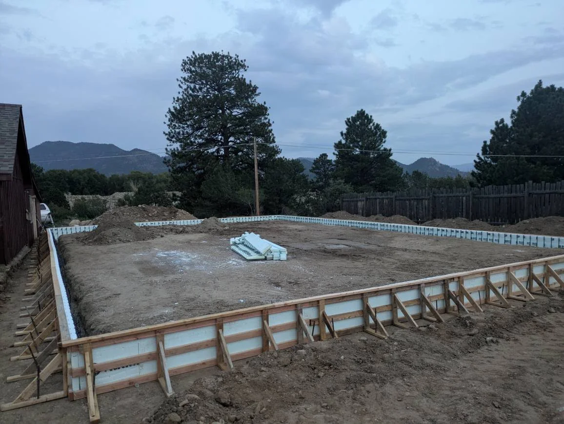

ICF wall blocks up.

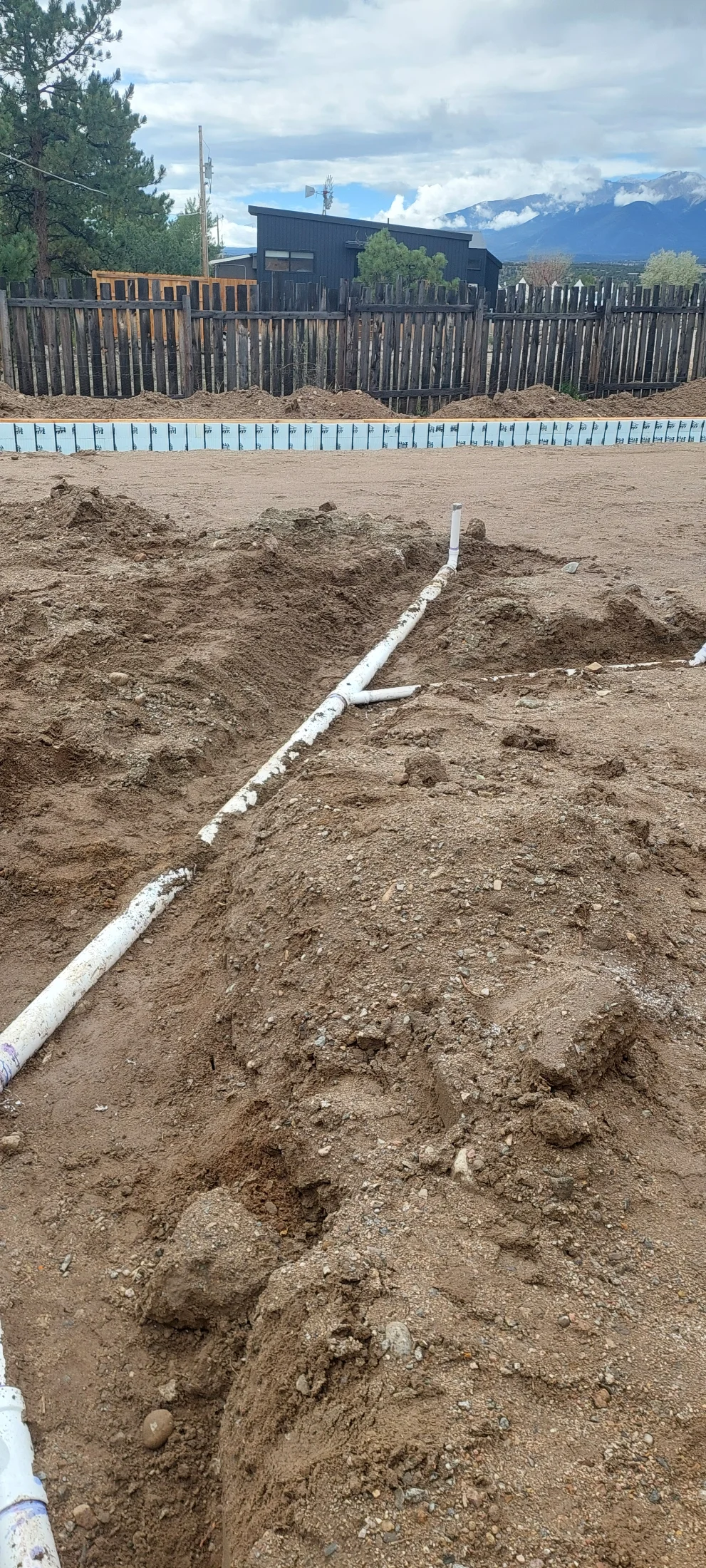

Underslab plumbing for bathroom, shop sink, and infloor heat.
Need to get the infloor in and get rebar done, but pour is scheduled for Oct. 10th.
More updates to come!

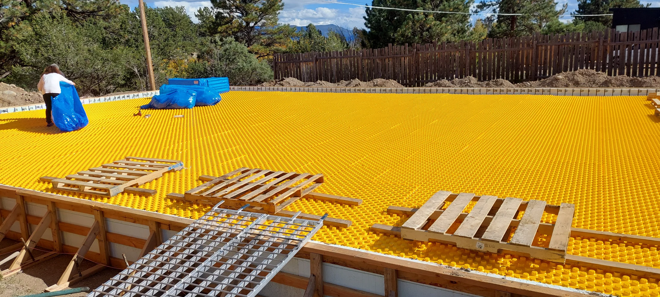

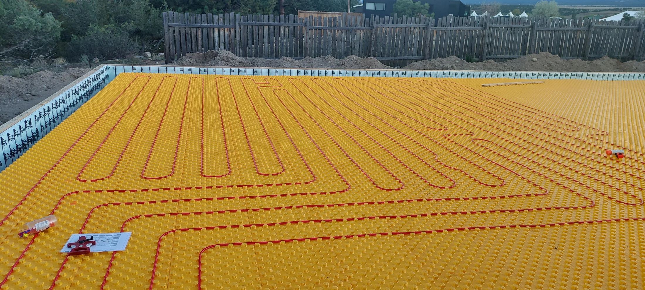

All the infloor foam showed up, and I got it down this weekend. Very easy install, and laying the pex is a breeze. It took my dad and I about 4 hours to get the foam down.
3 / 8 runs of pex done. Maybe 30 minutes a piece, with no stapling or tieing required, which is very nice on the back.
Warm floor will be awsome of your out there often enough to warrant keeping it warm 👍🏻
Given how much I tend to be in a shop, it'll get used a lot. I couldn't imagine not having heat out there in the winters.
