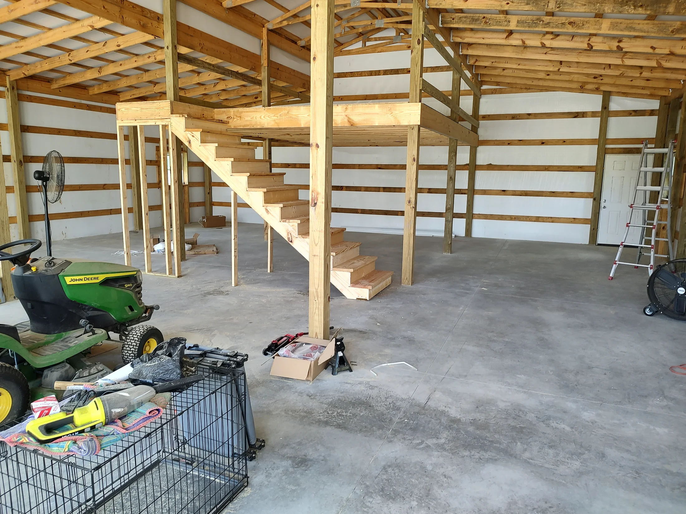

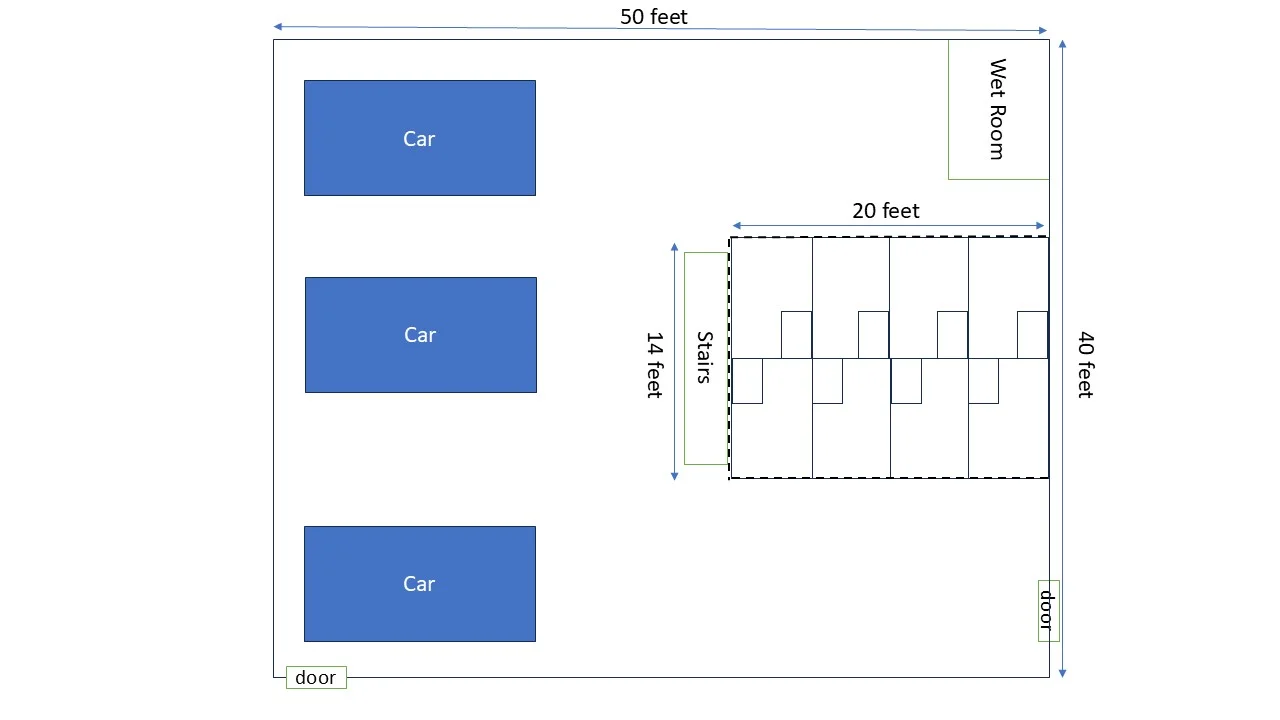

I modified my plans a touch. Reduced the size of the loft to 20' x 14' and put the stairs on the car side, rather than the back wall.
The back wall ladder is really a space killer and is a highly inefficient use of material. A front wall stairs will double as the roof to a dog kennel, which gives me room for 9 permament kennels and a lot more flexibility. I could park 5 cars in this if I wanted, or have 17 kennels. And various configurations of shop.

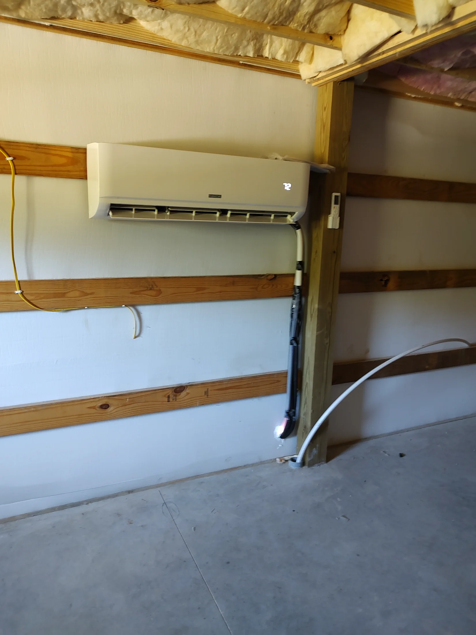

It's going to have full HVAC, so the windows/vents are not needed for that purpose.
What the monitor design does is allow a small loft while cutting down on cubic feet I need to heat or cool. Or at least that's the idea.

Sorry if I missed it. What's the square footage and ceiling height of the mezzanine? Looks like maybe 12' x 15' or so? Looks great.
It's currently 20 x 14 feet with a 16 foot ceiling.
That nets me 7.5 feet above and below.
Builder really wants to extend it the entire width of the barn though, and I am inclined to go that way
