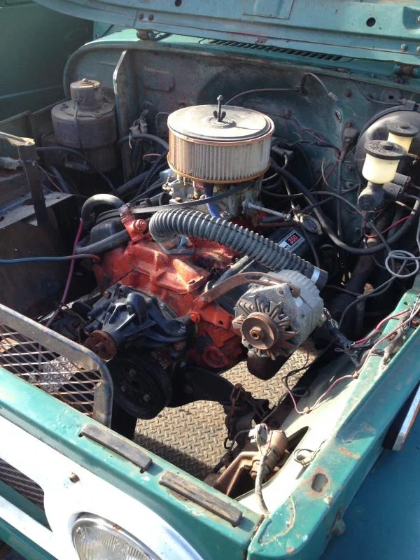

I just picked up this 1972 40 from WV. Took a chance and it turned out pretty clean. Going to be removing the SBC and going back to stock F engine. I have a running engine sitting in my 73 that needs a complete frame off that I will borrow as this will be quicker to put on the road.

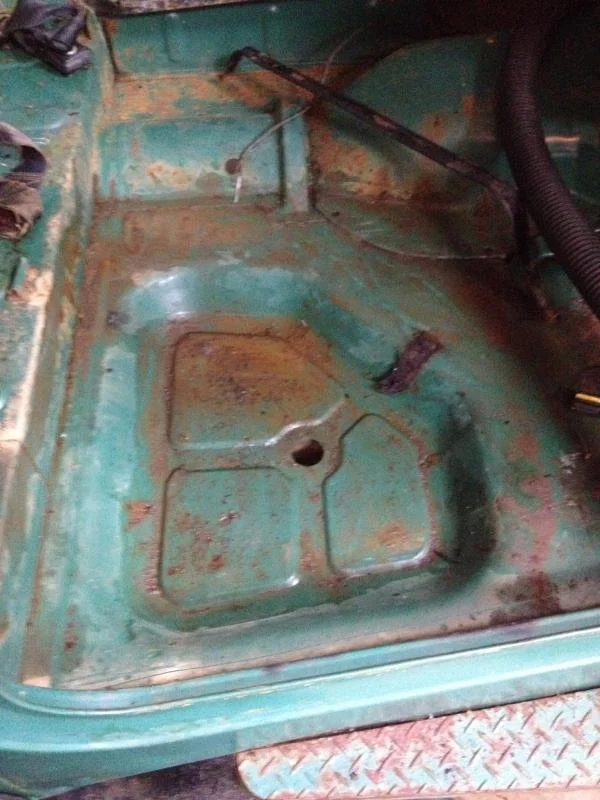

Tonight I pulled the gas tank to see what was underneath and it looks good. Also took the shopvac to the squirrel condos. Game plan is to pull the 350, get it cleaned up, reinstall the stock drivetrain and get it running/driving/stopping. Then focus on rust and making it look better.
Good for you! I don't think I've ever seen one going that way. Usually someone installing a V8, and I gotta admit, I'm not a big fan of those. Just doesn't seem right, taking the guts out of a Cruiser. My opinion anyway, though I know a lot of people do like that. Either way, good luck with your swap.
The Saddle mount across the front of the SBC was an OK way to do the conversion, the main draw back was that it interfered with Saginaw steering conversions. Being done that way will make it easier for you to return it to stock form.

As of right now, I a trying to figure out seats. It has stock seat base but no seats. I do like the idea of going to buckets but if I can find the bench at the right price that's what I will do. Not to worried about it as the F reinstall is first priority. The stock frame side motor mounts are there but they are welded and it looks like they might have been moved compared to my 73.

I removed a 350 for my 2F.
My non-toyota friends don't understand why I didn't want the HP. The low RPM torque more than makes up for the lack of HP.
Sure, just like personality makes up for looks at high school prom. My 2F is great for short wheeling trips. I too ADHD for patience
Tonite I got the passenger side fender off and everything unhooked from the engine. It doesn't look like it is the tub that sagged but maybe the fender and apron were hit.
It looks like the frame side motor mounts were moved back. I need to pull a measurement from my 73 to make sure.
Got the transmission tunnel removed. Also found a custom milk jug/duct tape mod for the heater duct. If anyone wants me to do a seperate write up let me know.
I am pretty disappointed that they cut the firewall to make room for the bellhousing but I have another cowl to cut a patch from.

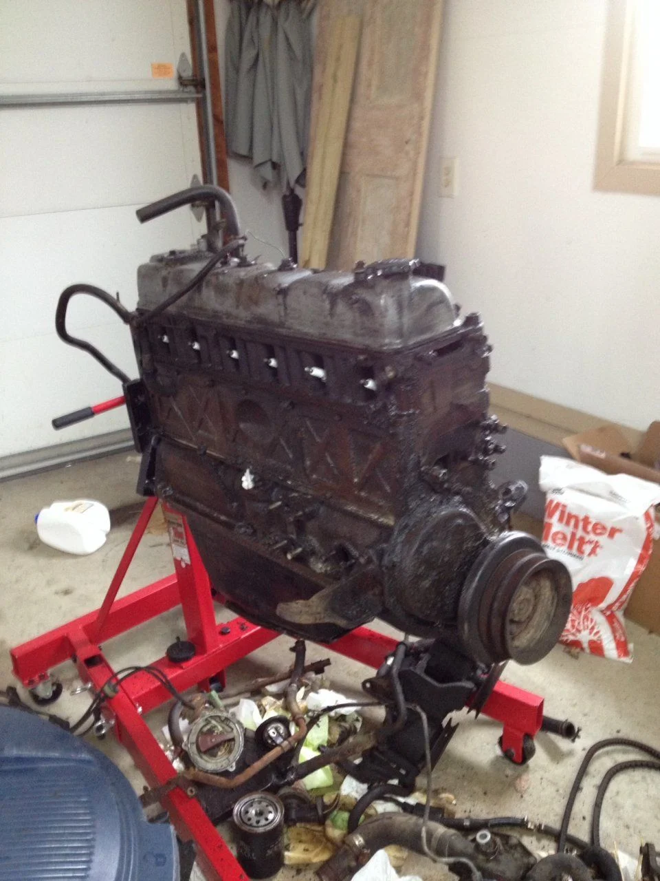

2f is being stripped to get mocked into the engine compartment so we can square away motor mounts. I am currently waiting for the USPS to figure out which PO floor my clutch parts and frame mounts are laying on.
This engine came from an early 80s FJ60 but there isn't a serial number on the passenger side plate. Was this a replacement engine?

Quick update. The 40 is in the speed shop getting the firewall/ tranny hump repaired. I lucked out and had a junk cowl that had all the necessary patches. They are repairing the main beam where it was rotten as well. While dealing with the crazy lack of spring temperatures I have been degreasing drivetrain and accumulating parts. The yard pics were taken yesterday less than 6 hours apart.
