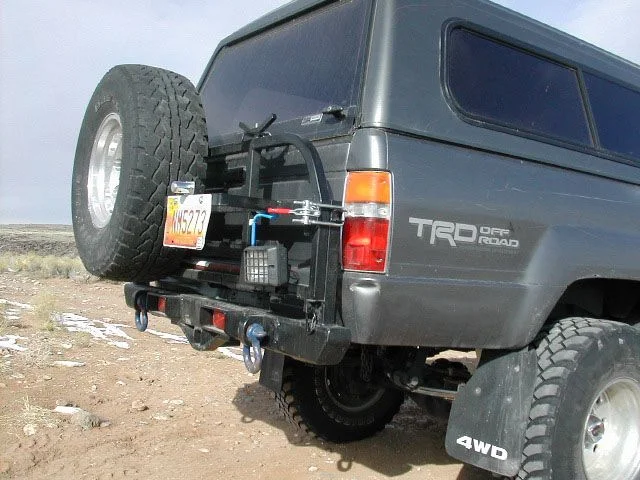

Is that a Stout rear bumper? Would you mind putting up a couple of photos if it? I plan to make a similar bumper for my 4Runner.
It is a Stout. I'll take some pics after the sun comes up tomorrow. While I really like the bumper the only change I would do is the pivot for the rack. I think the "trailer" spindles are a cleaner design. If Grant's welds ever break I'll modify the rack this way. Problem is, Grant's welds don't break. I'll explain tomorrow with the pics, but I recently modified the rack.
I also have the Stout rear bumper, but my swing out is different. Instead of seperate hoops for spare tire and gas can, my swing out just has a third bar going all the way across. I am recycling my 85 and hope the bumper and brackets fit on my 95.
Like this? I owned this truck for a few years and this is the bumper I had on it.
Exactly. I am suddenly inspired to rip the OEM stuff off my 95 and get this installed. Bumper is off my 85, but brackets are still on the frame. This bumper was one of the best things I ever purchased for a truck.
