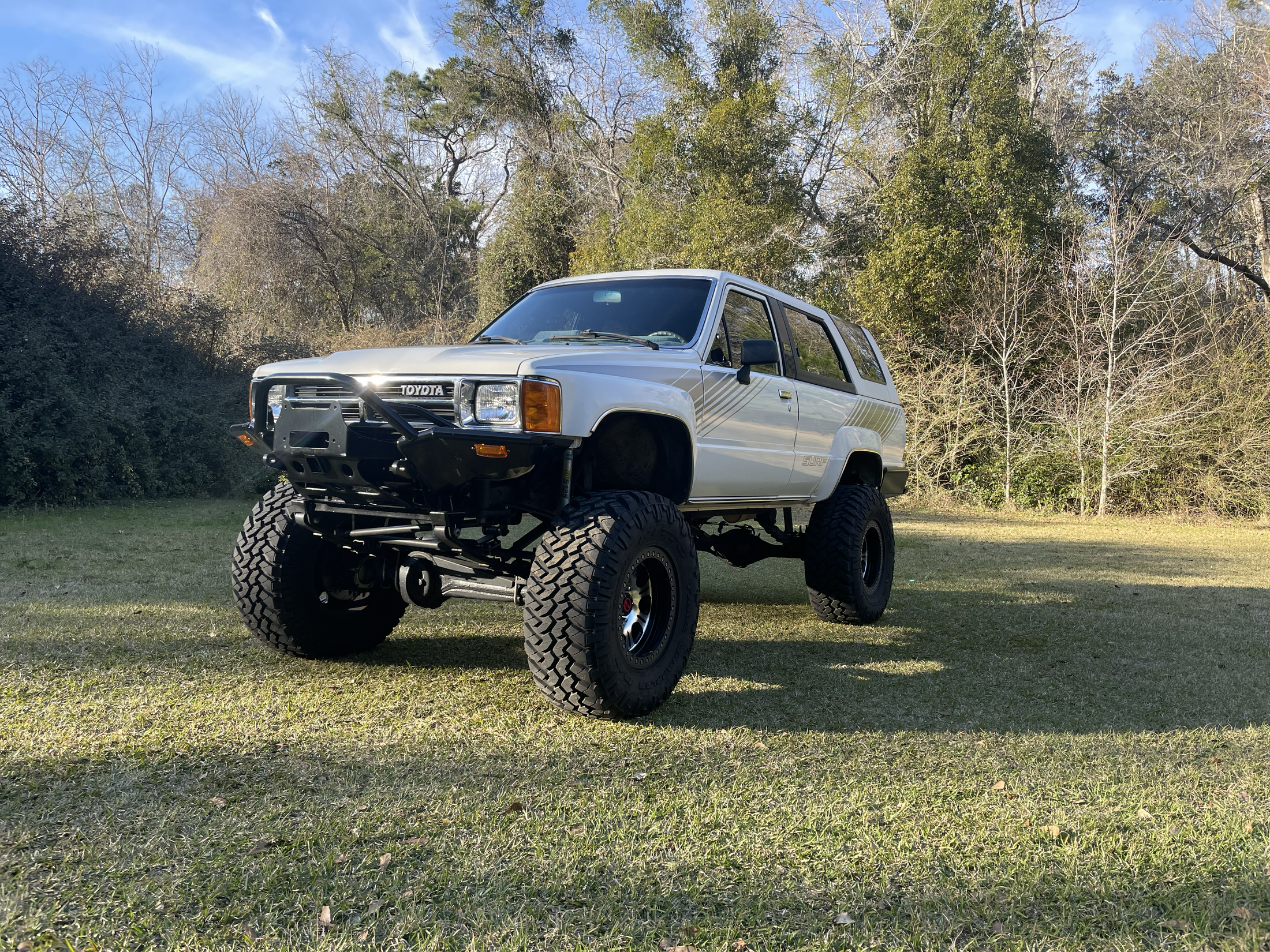

Needing to replace my leaf spring bushings after a year (TG bushings are junk).
While i'm in there, wanting to lower the vehicle a bit in the front. Currently ~2" high in the front over the rear.
Front: 3" Standard TG Leaf pack (4x4 labs front bumper, future will have a 8274)
Rear: 4" Standard TG Leaf Pack (4x4 labs rear bumper + spare 35, no future changes planned).
I'm happy with the ride quality overall, driving it 90 miles roundtrip a day, so looking to lower without negatively hurting the drivability.
Options I'm considering (possibly in some combination of both) but want feedback.
    • Replace 5" shackles w/ 4" Shackles, I assume this would net a 1/2" drop. Only concern is any clearance issues at rear of body mount while flexed. Think it's fine but curious if anyone else running a similar set up has done this.
    • Remove lowest overload leaf (assume another 1/2" drop or so), however unsure of best leaf to necessarily remove. Seen some mention the one below the overload leaf, however hesitant that I'll end up too low or soft and have to deal with taking apart leaf packs twice.
      • I do have my OEM rear leaf packs if doing a hybrid pack of some sort.
