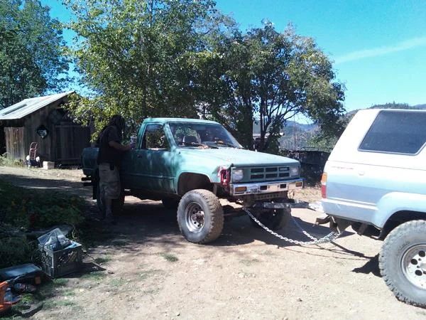

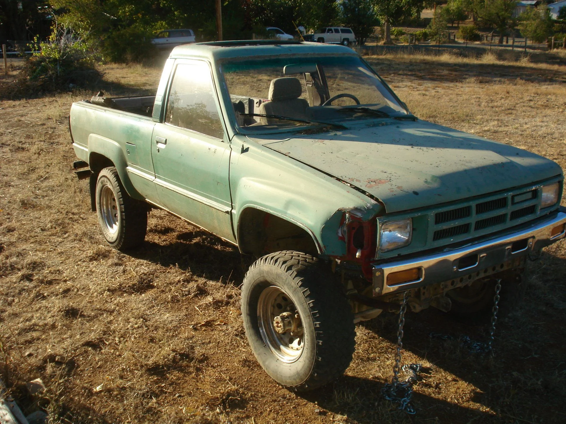

Here's a few pics for those interested.

I fixed half a dozen wiring issues today, and I had to cut out a large pile of aftermarket wires... but the stock wiring is surprisingly unmolested, I'm happy! I got the half top bolted down, and one of the side windows installed today.
I drained the tank a few days ago (about 4 gallons came out, and I put 5 gallons of clean gas in), and today I was going to use the pump to clear the lines out by removing the cold start injector, but instead I just jumped the fuel pump and let it recirculate back into the tank for a few minutes before trying to start it....
None of the 3 batteries that came with it would take a charge.... oddly... :D So I ended up putting my battery in, and after 20-30 seconds of cranking, it started to sputter!!! Then it reluctantly fired up, and I say fired as in, it ran enough to know that the engine wasn't total junk... I later found out that one of the plug gaps was closed up with carbon, and the other three were not in great shape.... The plug wires had been chewed on by mice, so it got new plugs and wires and it's much happier now! It has a couple coolant leaks, and one slight oil drip from a pan bolt...
