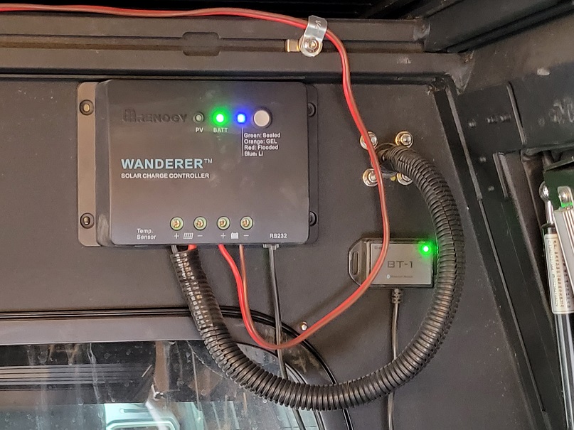

Renogy 30A controller, with bluetooth.

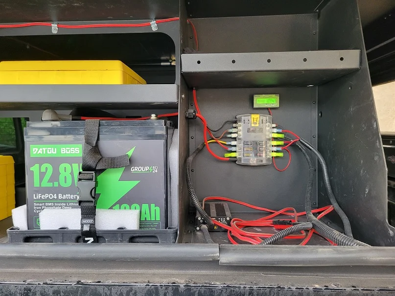

100Ah battery in camper.

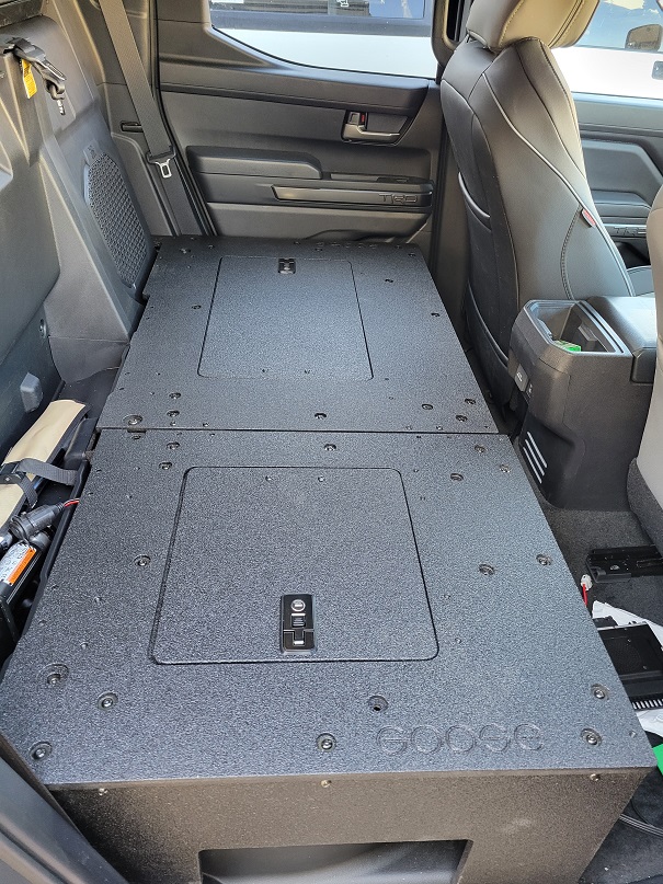

Goosegear rear seat delete. Back seat delete houses a 50Ah battery that runs the fridge, and ham radio.

Fuse block for the interior lighting and outlets on the camper, water pump, input for future backup 8A DC-DC charger, and solar input.
I don't have a picture, but the fridge is mounted on the rear seat delete. I started out with the fridge on a slider, but the silly thing rattled, so I pulled it.
