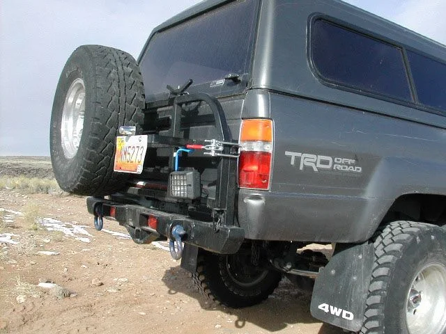

  • Stout Equipment rear bumper with tire/fuel carrier, slightly modified

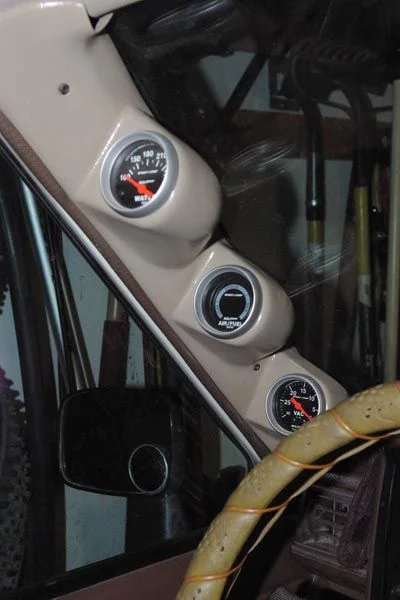

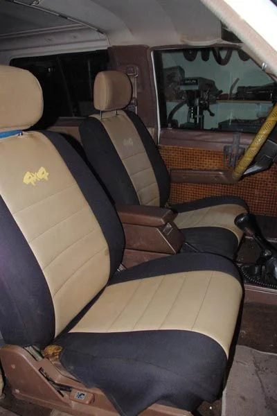

  1. Front seats are original and in near perfect condition. They are currently covered with Okole seat covers. Driver's side has been replaced with a MasterCraft Baja RS.
  2. Pillar gauges include temp, air/fuel, and vacuum.

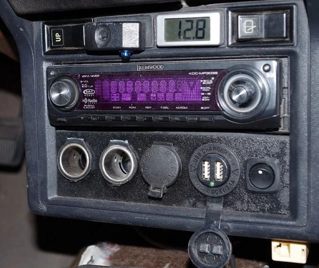

  3. I made the panel with the aux outlets.

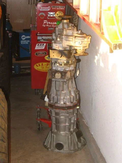

The only improvements/modifications I would like to do is install real sliders, and install the R151F with dual 23-spline transfer cases I have in the garage. (installed)

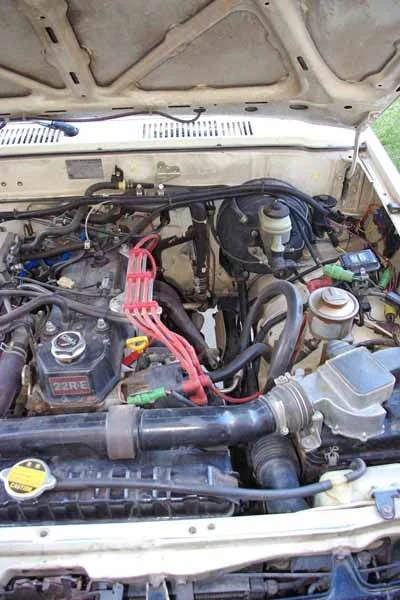

Patience my boy. Don't want to overwhelm everybody at once. I'll post up pics from under the hood tonight, and maybe more of the filthy interior. If there is something you would like to see up close let me know.

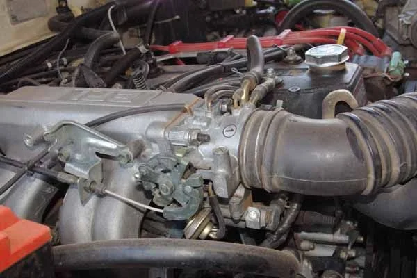

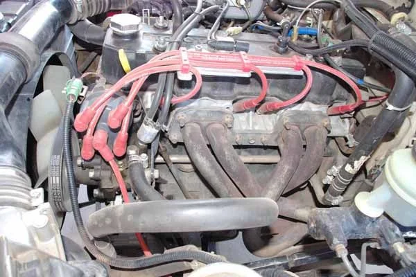

On to what's under the hood.
  • Engine: DOA Racing 22RE, balanced, ported, polished. DOA engine replaced with rebuilt engine using balance DOA internals, but "new" block.
  • Cylinder head: LC Engineering Pro (ported, larger valves)
  • Cam: DOA C270 LC Engineering EFI Pro
  • Header: Doug Thorley tri-y
  • Exhaust: 2.25" pipe into Flowmaster cat, Flowmaster 50 SUV muffler
  • Late model plenum conversion, gasket matched porting.
  • LC Engineering spark plug wire loom kit.
  • TRD oil fill cap.
  • Radiator: 3-row Modine 2041. Replaced with an extra large 2-row.
  • V6 brake booster and 1" master cylinder.
  • V6 brake calipers and LC vented rotors.
HAM radio is now a Yaesu FT8800. Accessory outlets now include three 12 volt outlets from a Tacoma, and a Blue Sea dual USB socket. I also removed the CB.

In addition this truck came from Japan without a rear seat. Once it arrive here an aftermarket seat was installed, but it was a full bench. Recently I found a split bench at the boneyard and installed it, or at least the back part. The bottom bench is in the closet. The new boneyard seat was blue while the truck was brown. Matching Okole seat covers fixed that.
Is that a digital readout on the A/F gauge? Does it show you an actual ratio?
It's actually a series of lights that sweep left to right as the Ox Sensor sends the pulses. No numbers, it's all relative.
