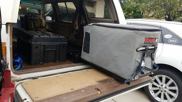

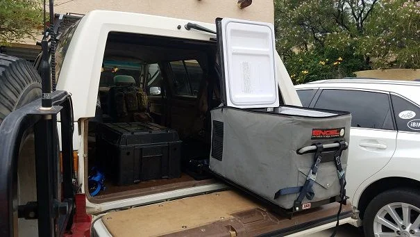

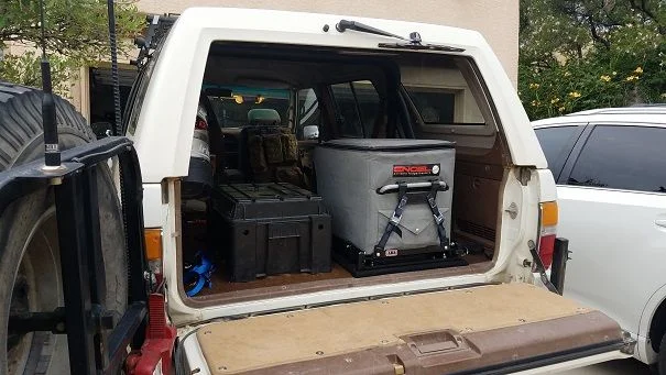

My latest project was a fridge slide. There was a guy over at Expo Portal selling a NIB ARB fridge slide and I couldn't pass it up. I've just spent the last week tinkering with getting it installed in the 4Runner. Of course, my traditional location for the fridge was behind the passenger seat, so there will be a learning curve next time I go to pack the truck.
I didn't want to drill my bed, so the fridge is bolted to a piece of 1/2" MDX using t-nuts. The board is covered in black speaker fabric and is bolted to existing locations formally used to bolt down the seats. I just finished this project, so I have no idea how it's going to work for my style of camping. This slide was an extended version, which I didn't know ARB made until I picked up the slide. I'm kinda diggin' it because it extends out the back far enough that I can open the lid all the way. Pics.

I keep my fridge there in my fj62, but have a lift gate which probably makes life easier than the roll down glass. I do access the fridge frequently via lift gate, and find I do not use the slide often. Sure looks convenient if you were cooking on the tailgate tho.
The nice thing about J60's and J80's is they are taller in the back. I borrowed a buddy's (FZJ80 owner) fridge long time ago when I was on the fence. His was the Engel 45, and it was too tall. I couldn't open the fridge lid in the back of the 4R. My Engel 35 was not a problem with the fridge behind the seat and I could get inside through the side window. Right now I can't open the lid all the way at the back of the truck without opening the gate and sliding it out. I can get it open enough for quick access without dropping the tailgate.
Jon, there are hinge relocation kits to convert to side hinges.

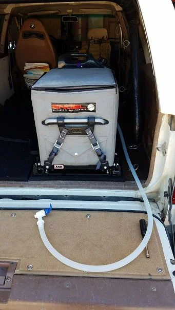

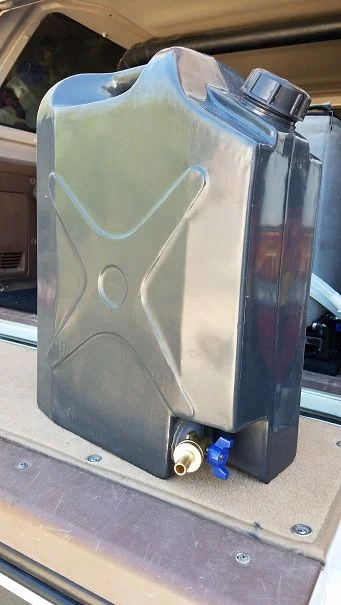

As I said this fridge slide was the extended version. It has this spot behind the fridge that can hold what ever you want, but it's the perfect size for a Scepter water can. So, I had a thought. I bought the 20L container from Front Runner that has the spout on the bottom. I removed the cheezy spout, and installed a brass 1/4 turn boiler valve. I then bought some silicone tubing and a hose end to barb fitting and ran the hose to the tailgate. Now I can access water without having to dig out the containers from the back.
View attachment 1791615 View attachment 1791617 View attachment 1791616
Have the same jug and cheesy valve. Where did you pick up the brass boiler valve? And does it just thread in? Thanks for any info.
Lowes. Off the shelf. 3/4".
