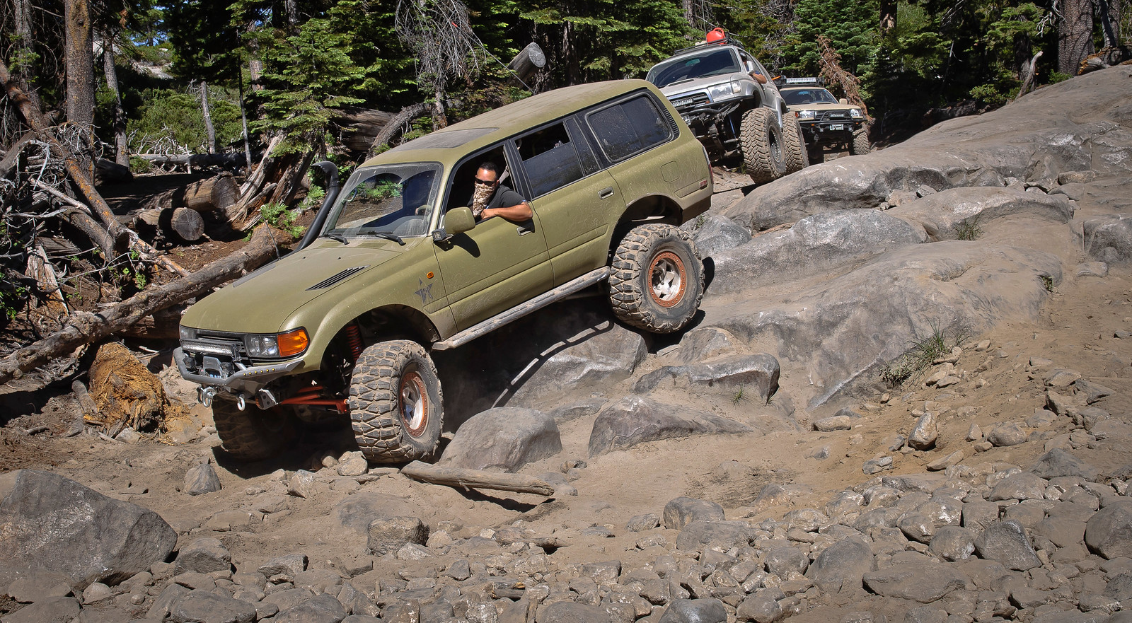

37s are the new 35s. The setup works well if you respect the gas pedal. I wouldn't say I wheel my truck "hard", but I do take it on the tougher trails and have yet to have any issues.
- 37s on 17" beadlocks
- 4WU 3 link front, 14" Radflo coilovers, 200/350 PAC springs
- OME 5" comp coils & 2.5" Radflo emulsion shocks in rear w/ Ruffstuff sway bar
- Hellfire high-steer & hydro ram assist
- part time 4x4 w/ Aisin hubs & upgraded studs
- Chromoly birfs & shafts, rear OEM
- Cryo-treated Nitro 5.29 gears
- I have the 3.11 transfer gears, but have not installed them yet
