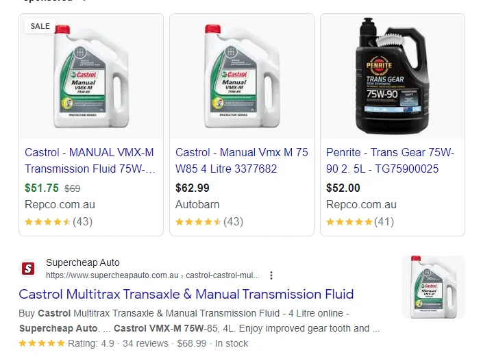

Ive been using the Penrite one on the right for as long as I can remember in my Xfer case with no probs
