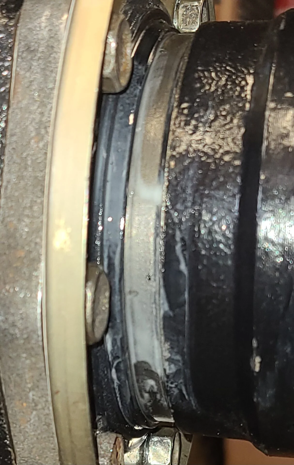

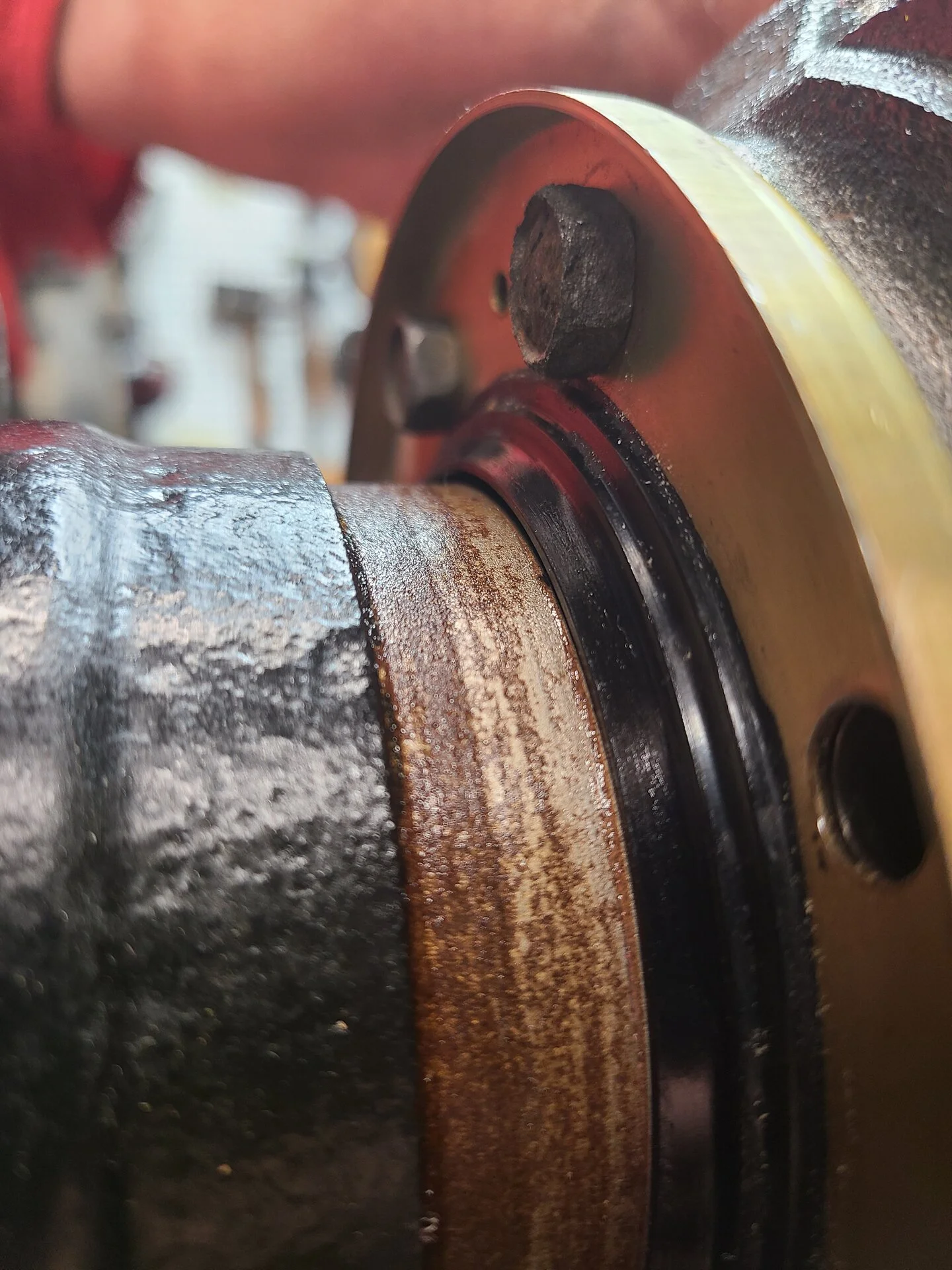

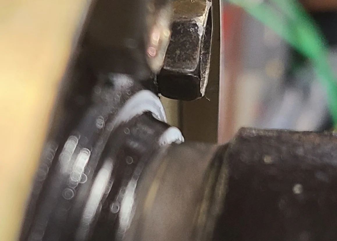

We got the hub kit from trail-gear mainly for the felt outer seals, which are great. However, I've come across a problem when installing the hub. The seal isn't centered on the bolt circle.
I've only done one side so far. And will probably drill our the holes in the other side to allow it to float a bit before tightening it down
The seal is about 1/32 high, I believe.
You can see how square it is on the bottom, where it meets the hub. I actually had to use an o-ring pick to keep it from being pushed in.
How long would someone expect this to last?
This project won't be on the road for a while, but thinking of picking up a set of oem seals.
Thoughts on enlarging the holes to let it self center on the hub?

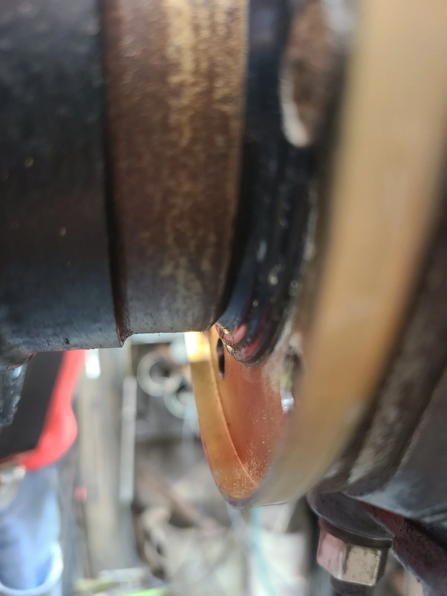

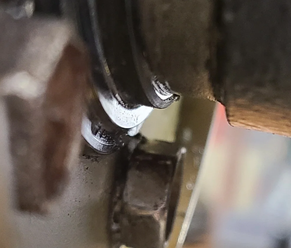

This is the other side - ignore the rust stains as this was just a trial fit and it needs cleaned up.
If you don't need it back in the road immediately, I'd say replace them.
If you drill out the holes, what's going to locate the seal correctly?
The od of the hub.
