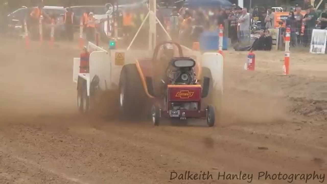

Nitro sponsored some gears for open mini class tractor pulls here with a tractor one of our employees ran with a blown KB big block.
It ran a cruiser rear diff, and 42" tractor tyres and went from changing the gear set every 2-3 meetings to running a full season the one gearset when we set it up the same way we do them with solid spacer and more preload.
That tractor also won the Aus championship in open mini.
That diff then went into another tractor untouched for the next season.
Just further proof for us, who has seen, responded to, and worked around the problems we acknowledge, and look at fixing.

Couldnt find a pic yesterday, But Tractor Pull Cruiser diff for you @nukegoat
