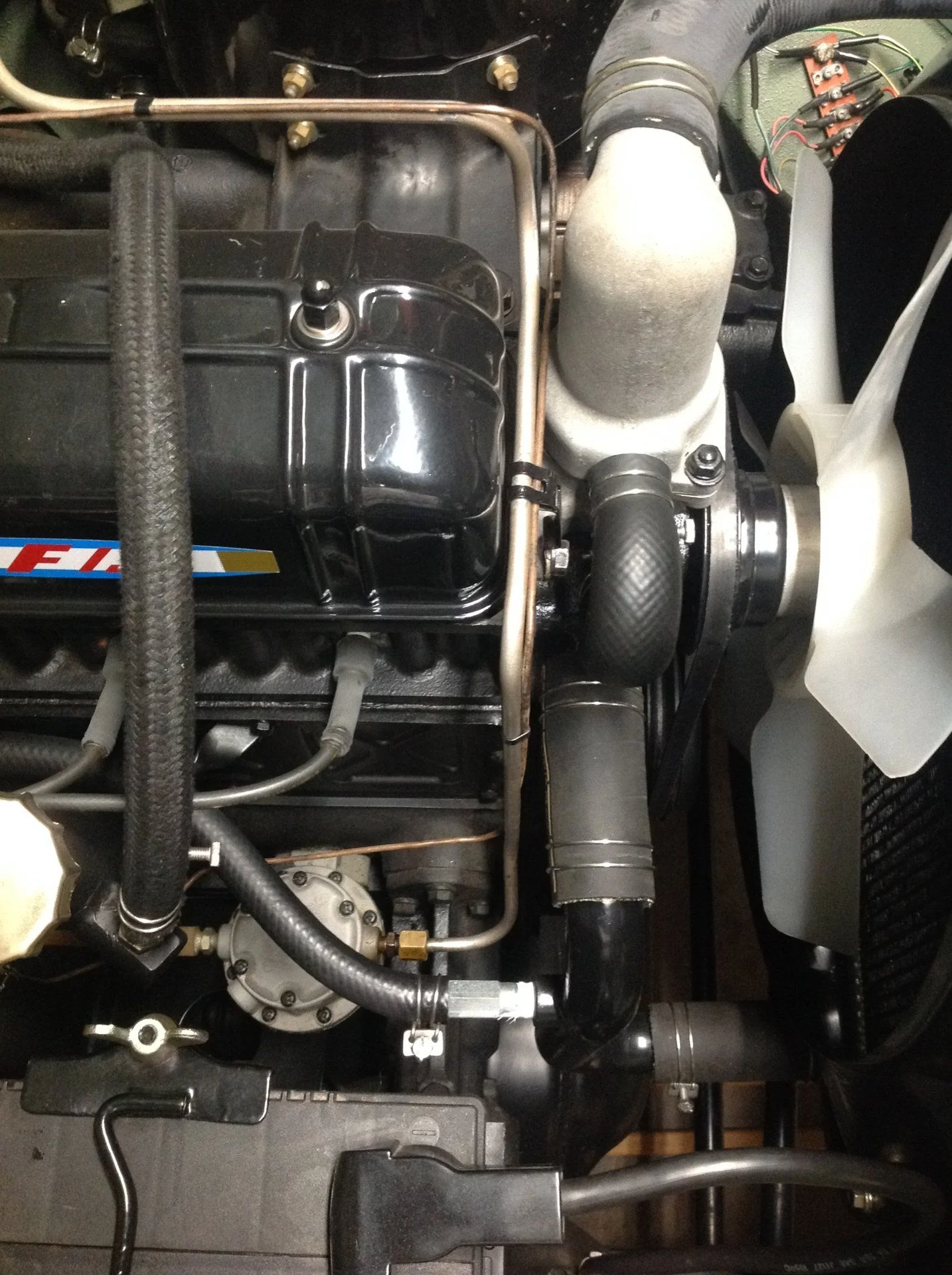

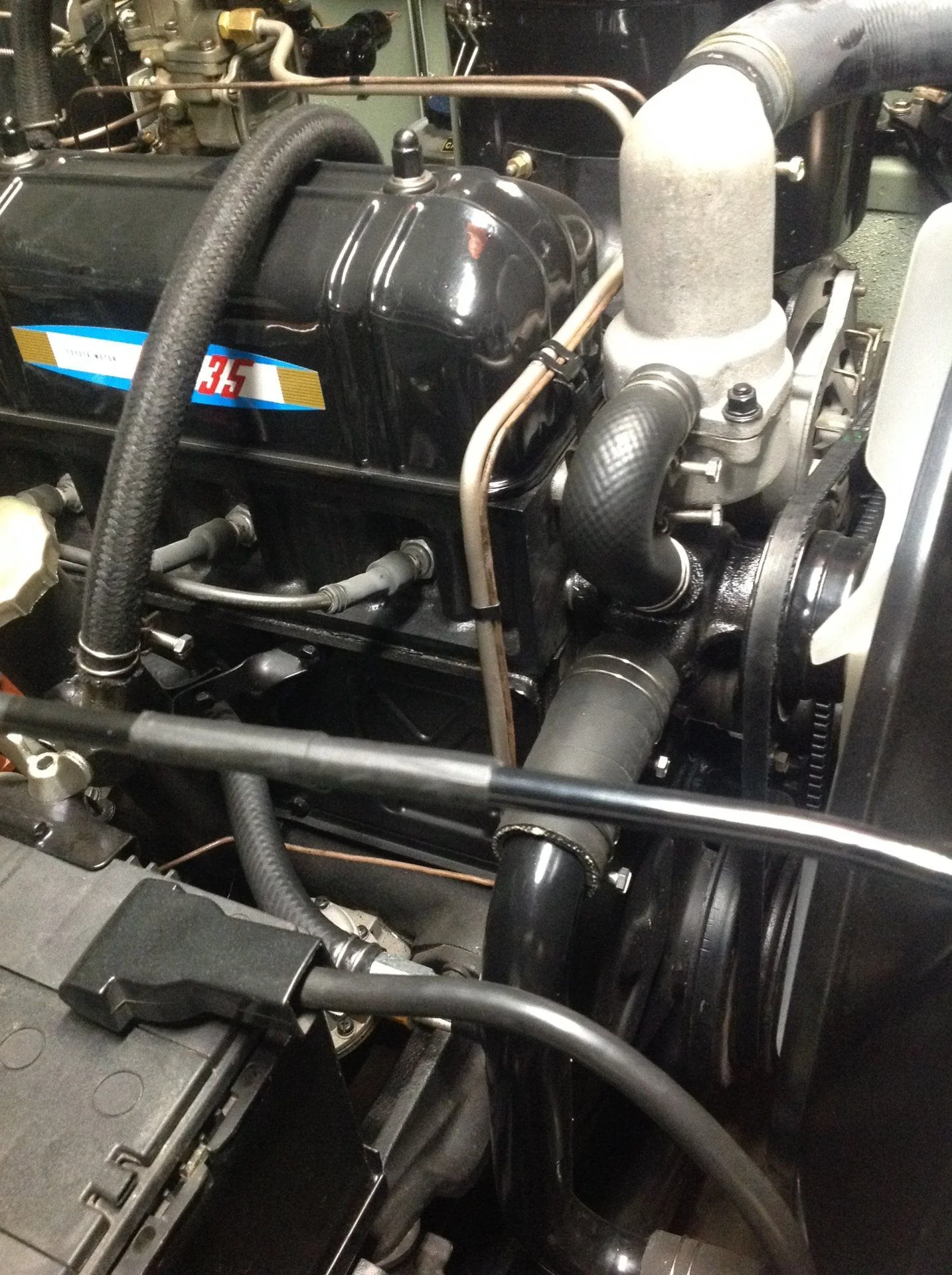

Can someone take a picture of the hoses coming off the bottom of the water pump to the heater and radiator for me?
Mine is not right
Posts #170 and #171 show pictures of a variety of radiator/heater hose F-engine set ups: '62 FJ40 in the Netherlands
One quick observation is that your pump is the replacement angled inlet style, as opposed to the original straight inlet type. And consequently the corresponding original elbowed hard pipe was discarded on yours, replaced instead by that long, inelegant lower radiator hose. This commonly seen replacement pump is what screws everything up in terms of the correct angle of dangle, so to speak.

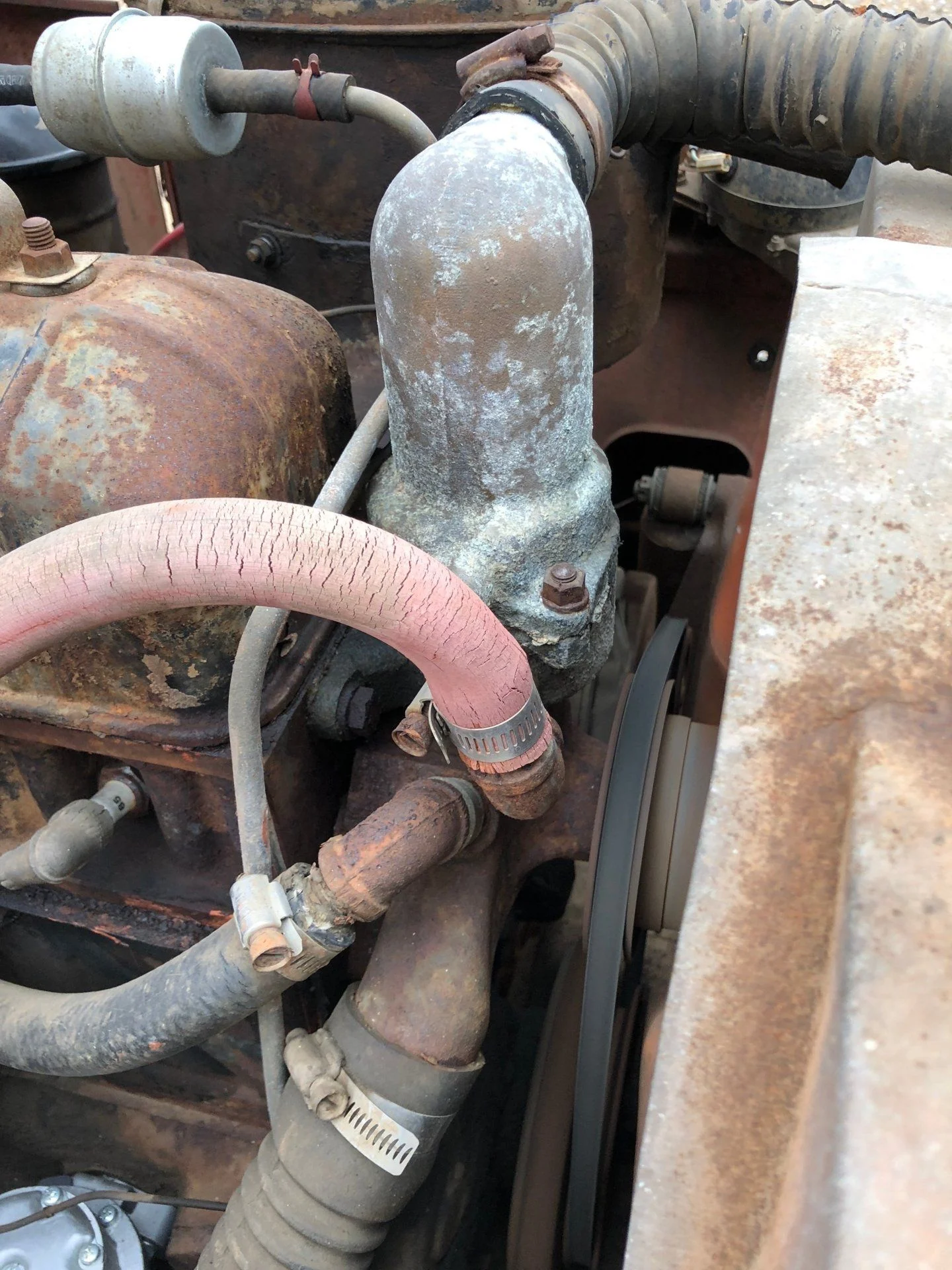

Here is my 65. It has the original rebuilt water pump and the s- metal pipe with the fitting coming off for the heater. Hope this helps. My 66 is the same.

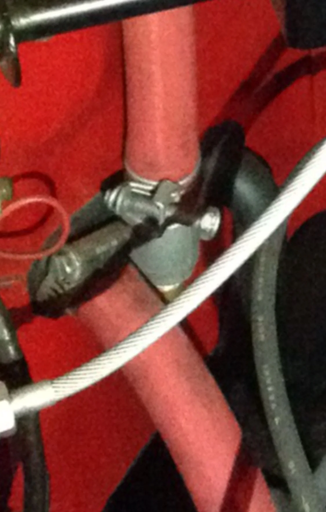

On my 66 I went without a heater valve. It's on all the time. My 66 has the stock one in the photo. The stock valves are hard to find and I would only buy one if it was new old stock. They are always bad.....
There have been others here that have used an aftermarket valve but I can't find the thread at the moment.
I also have a newer FJ40 Toyota heater valve from a middle 70's that I made work on one of the trucks. I used a cable like the original heater or vent cable to operate. I used the existing hole that's plugged in the heate control bracket. This valve works very well but you have to fab up a bracket and attach it someplace. I put it on the firewall.
Here's the later valve on my 66. The valve is still available from Toyota but I don't have the parts numbers handy. Works fantastic, not stock for the year but functional.
