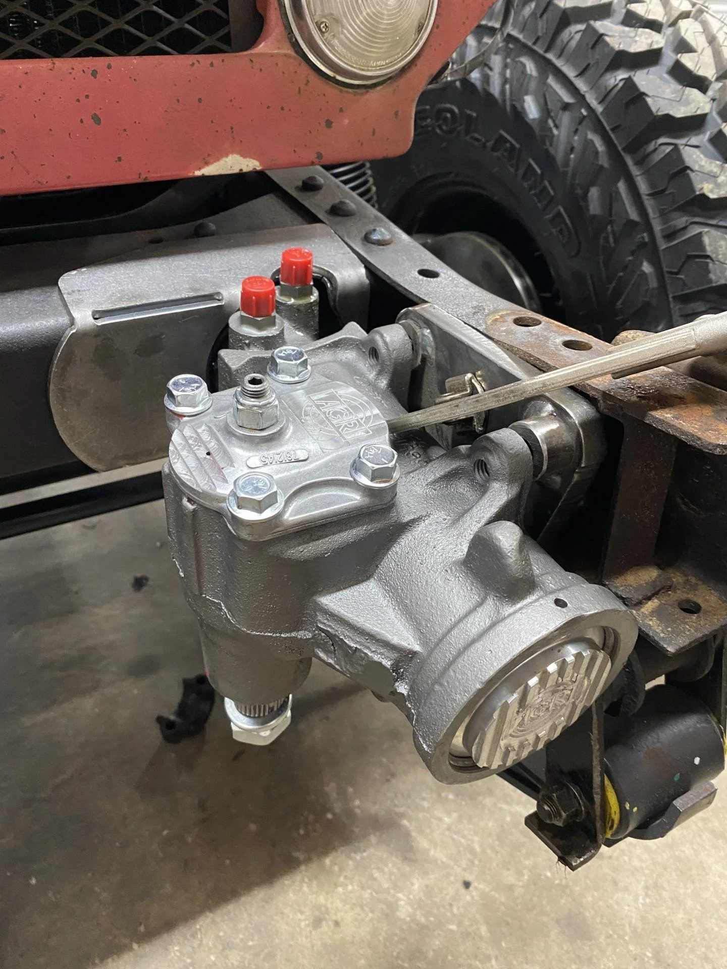

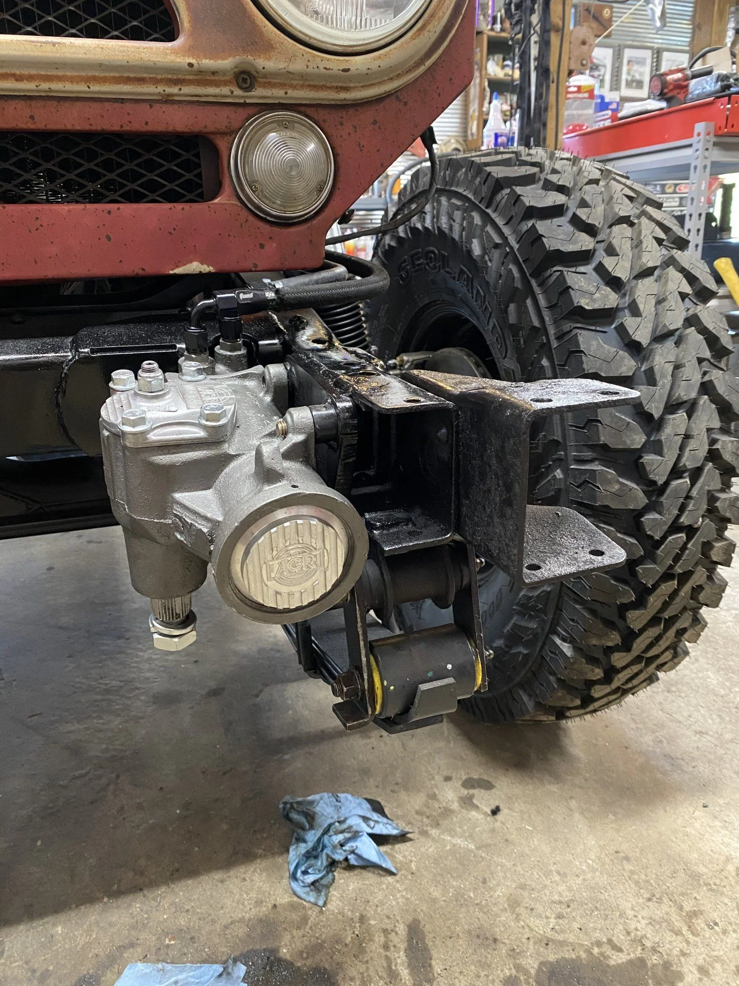

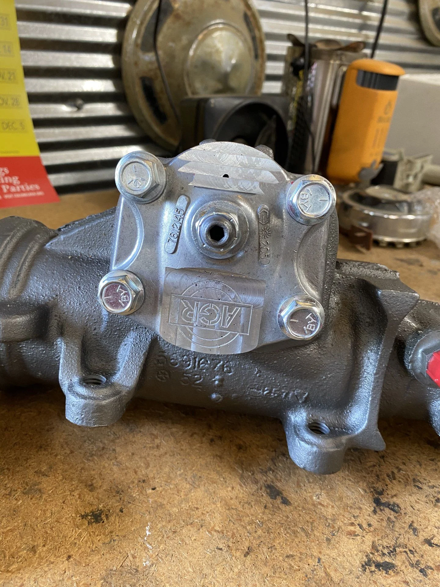

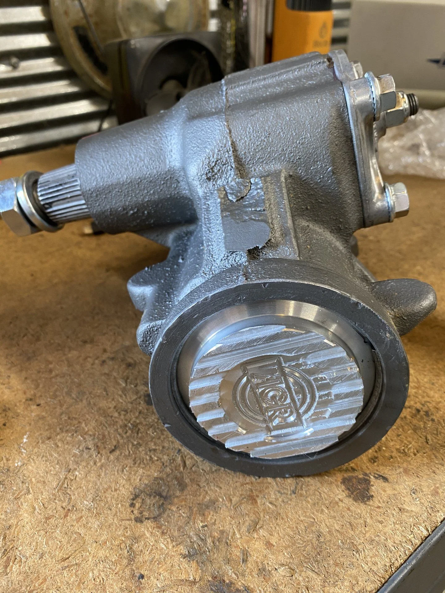

This time I’m doing it right with a bad ass AGR 4.25 Saginaw box and a 4 Plus Saginaw kit with some Cruiser Outfitter parts to make this thing all steer perfectly
@AGR Steering provides the beautiful box with beef

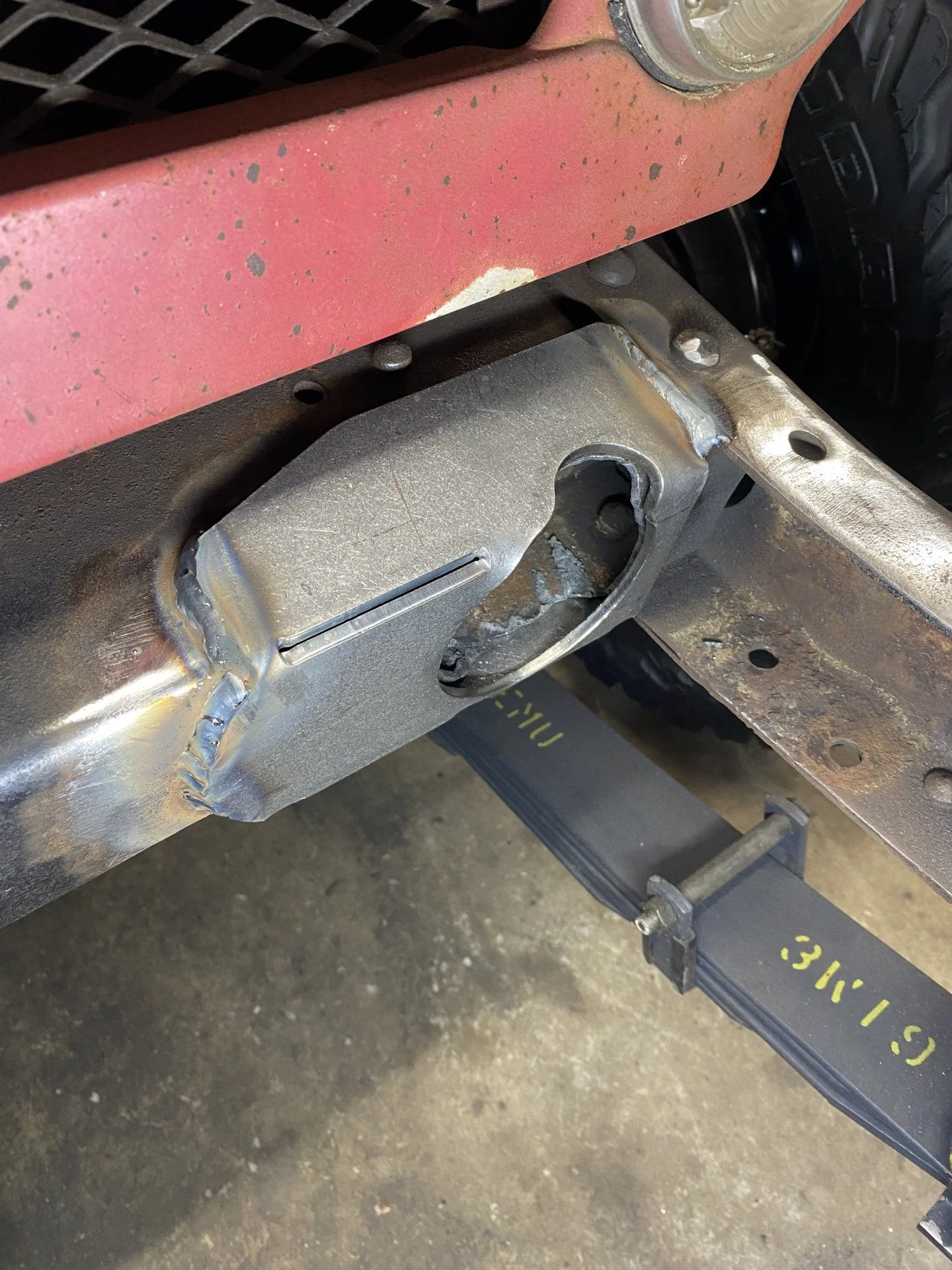

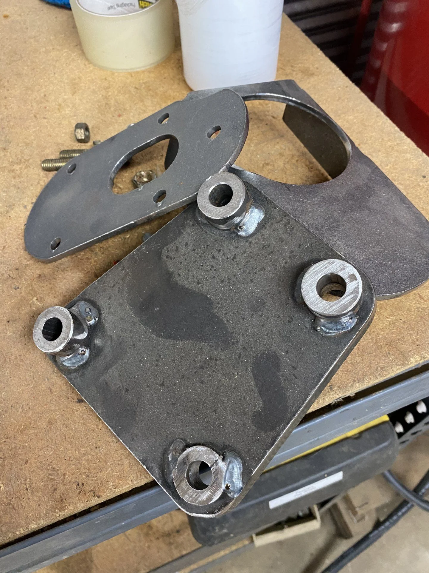

@lcwizard makes a super clean set of plates

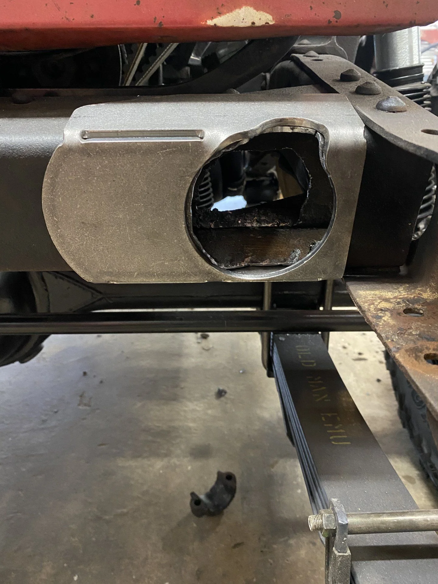

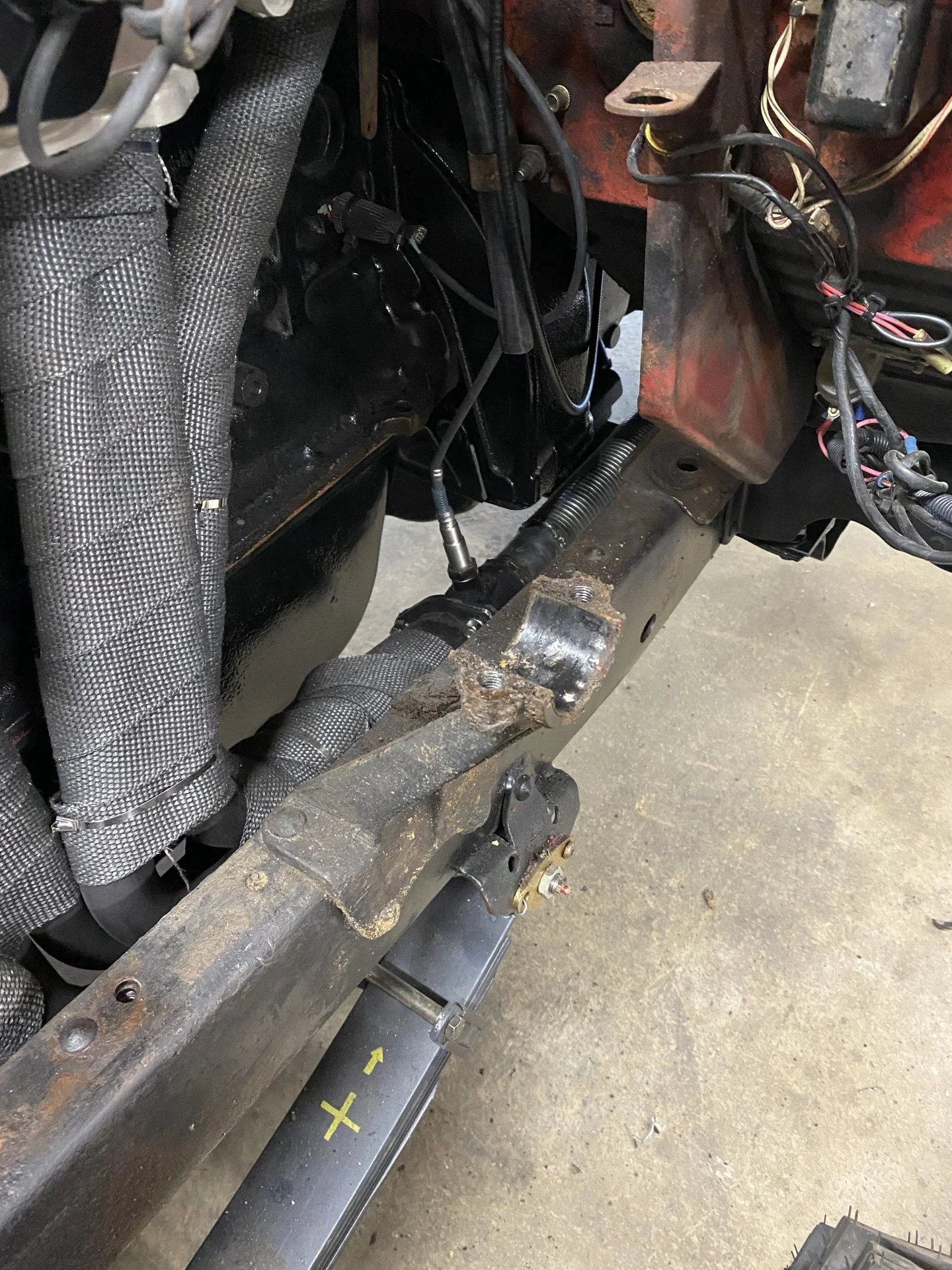

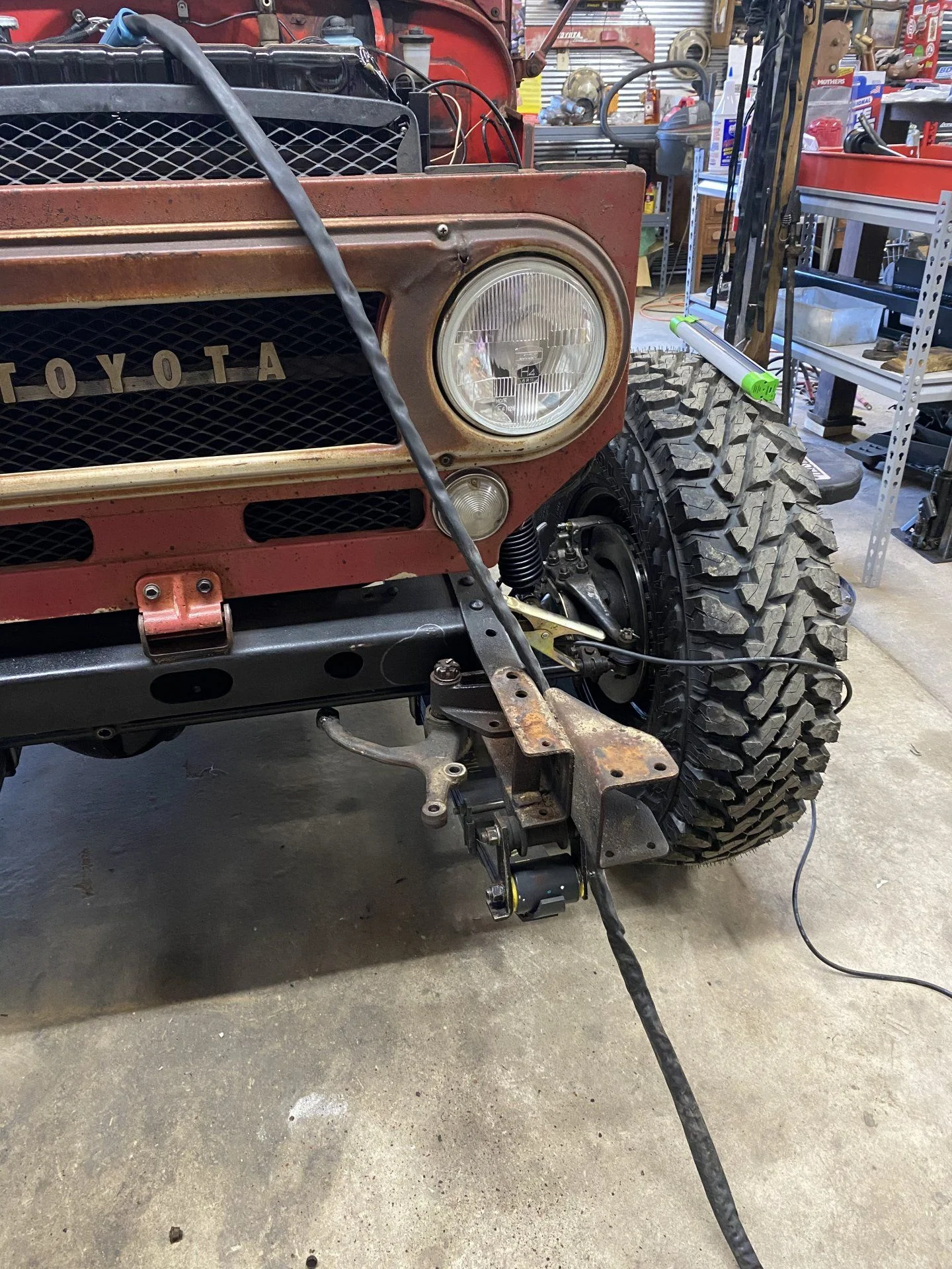

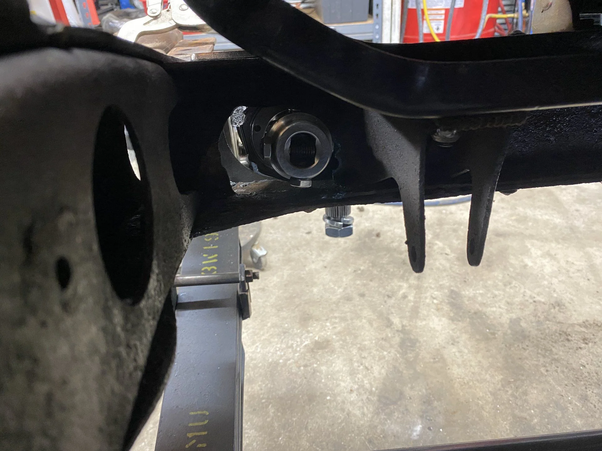

Next step is to plasma out the hole for the Saginaw to pass through the frame. Some use a hole saw but that sucks. I use a plasma and cut both sides of the frame out from the front.

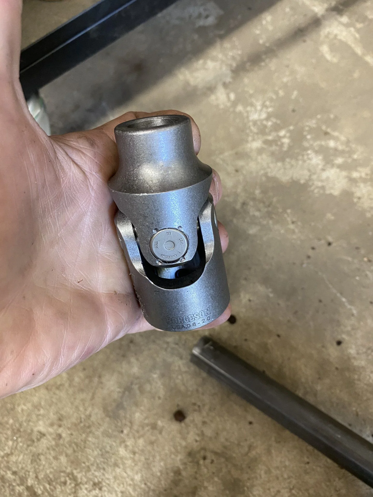

These smaller borgeson joints fit nicely into the inner part of the frame.
Next step is to clean it all up and burn it in.

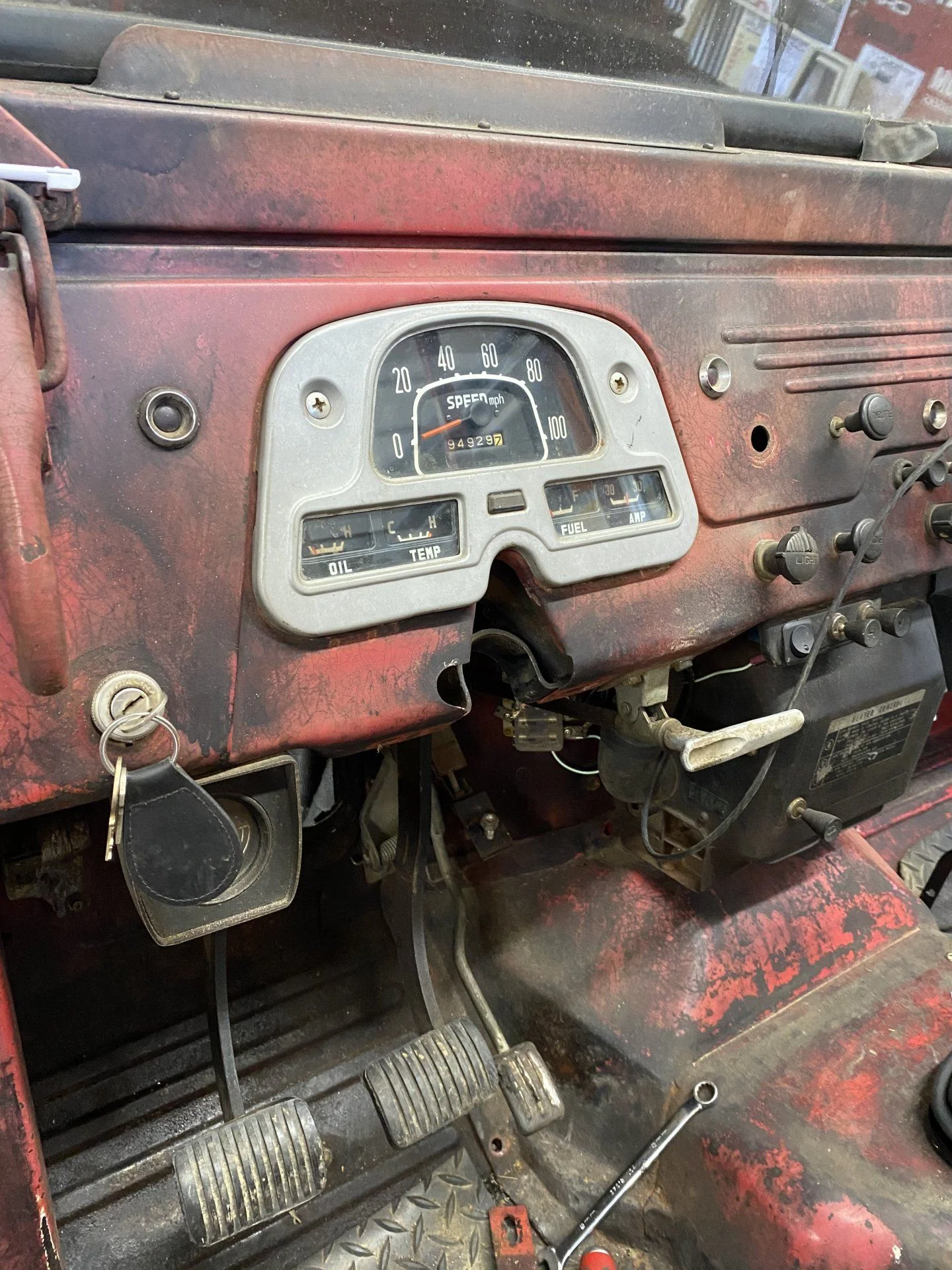

Got the column done and the geometry right

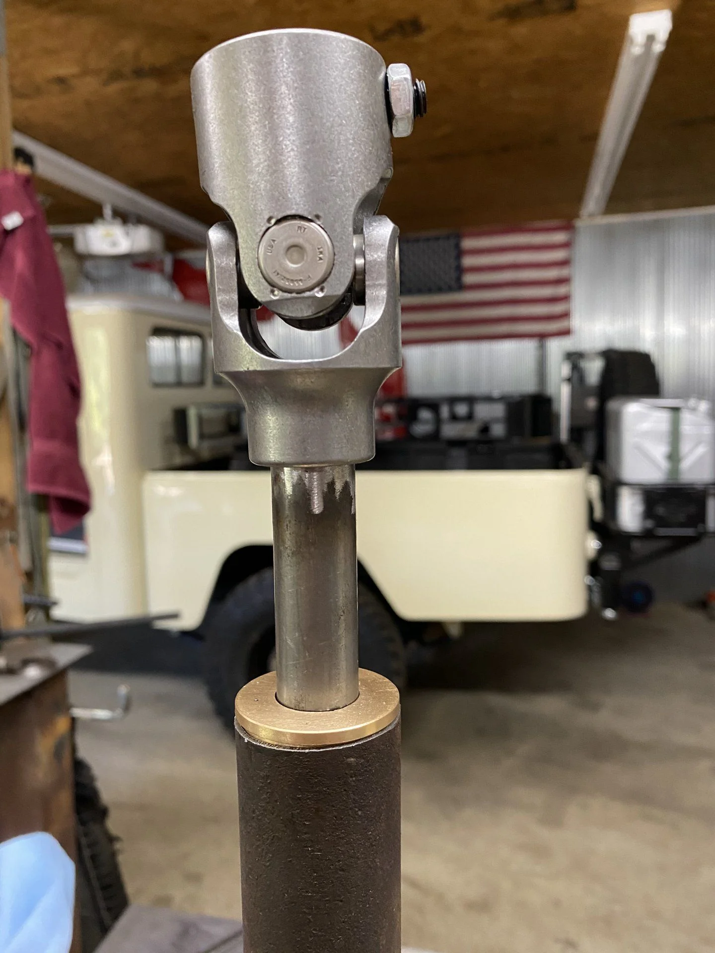

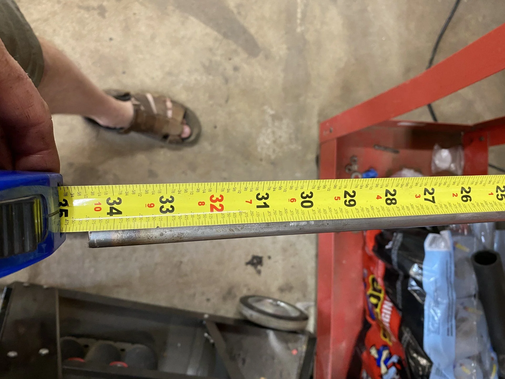

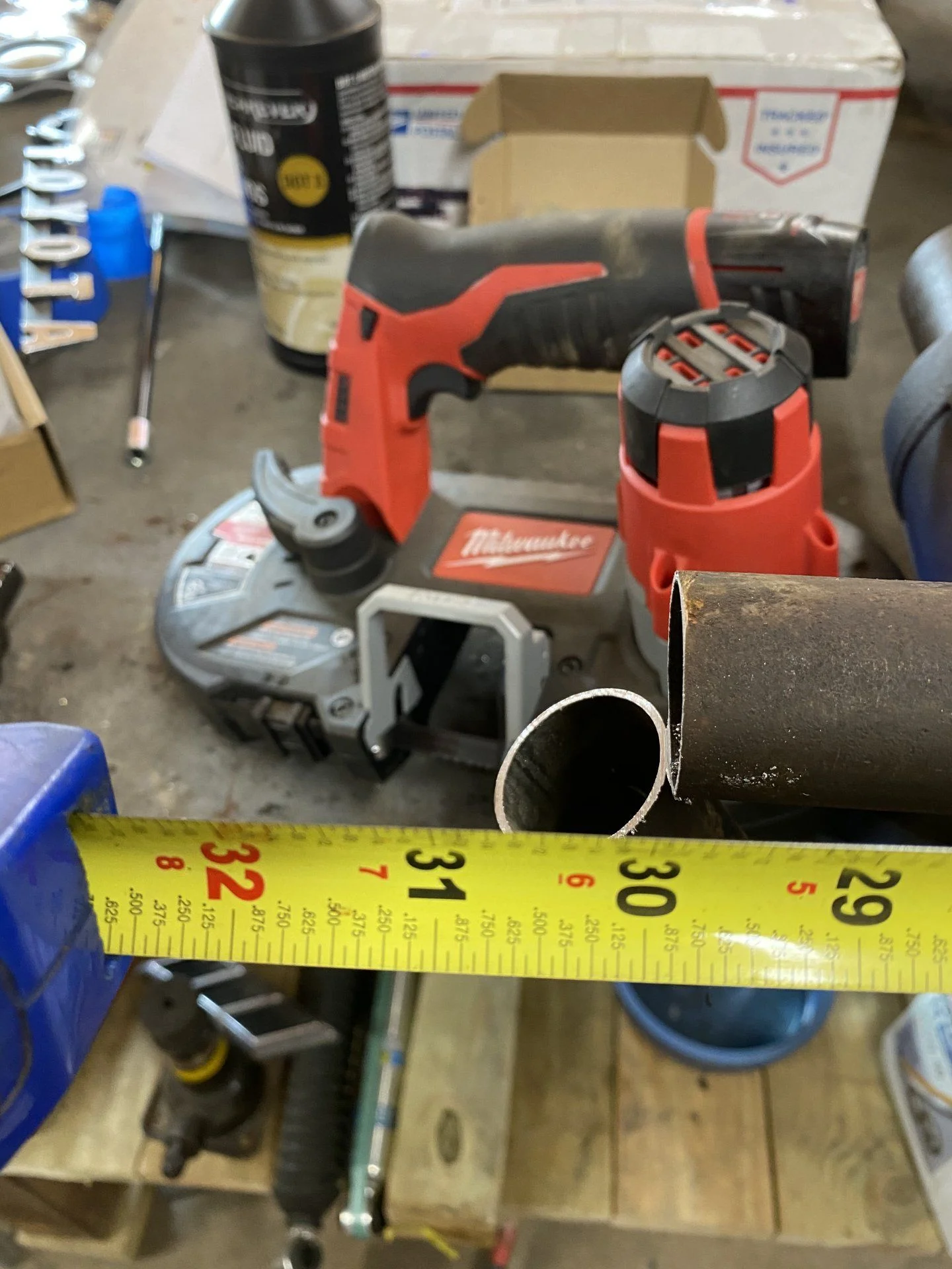

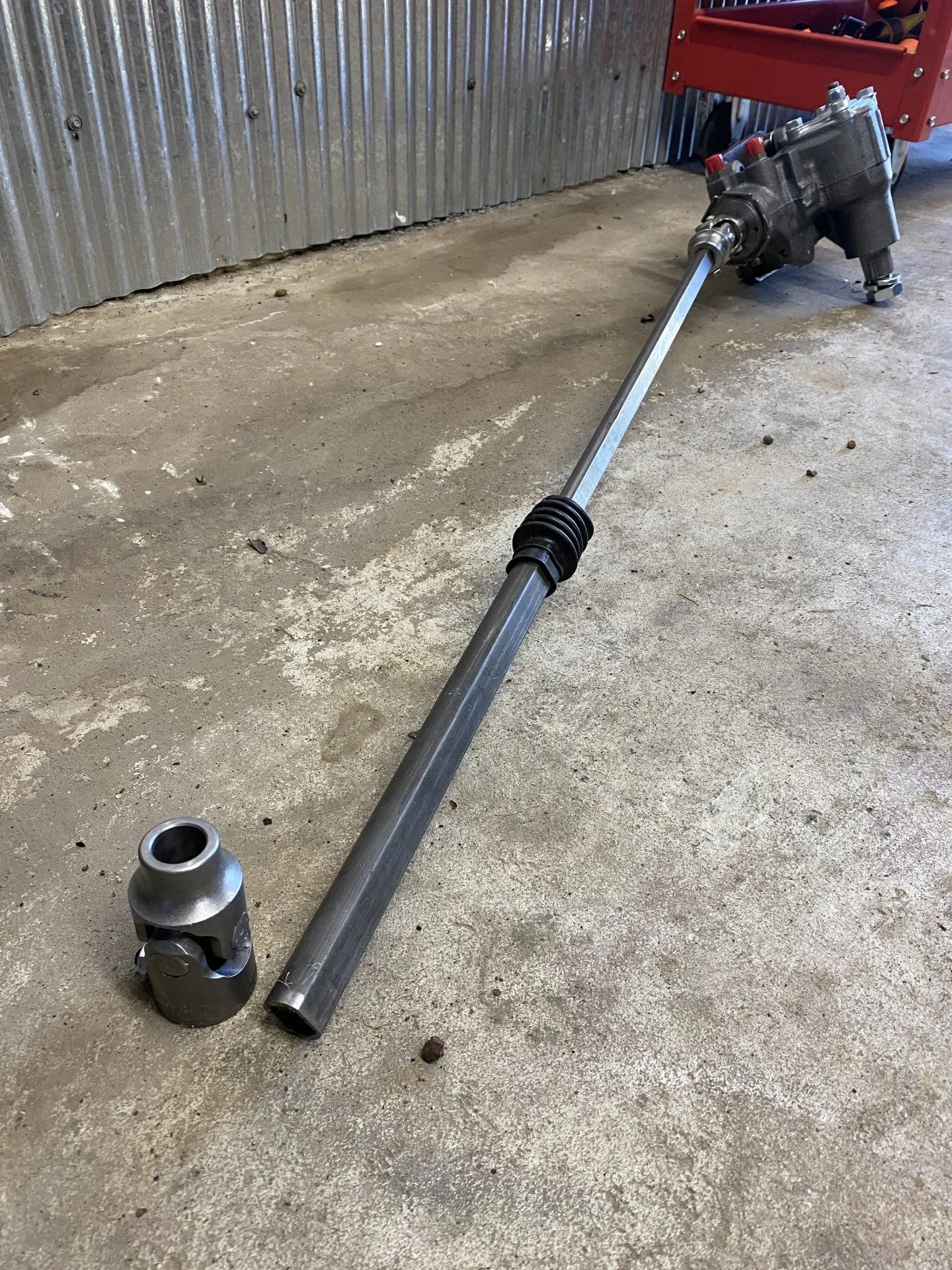

Cut your main shaft just above the old steering box. This is the length I cut them. It needs a cut off wheel. This shaft laughs at a porta band

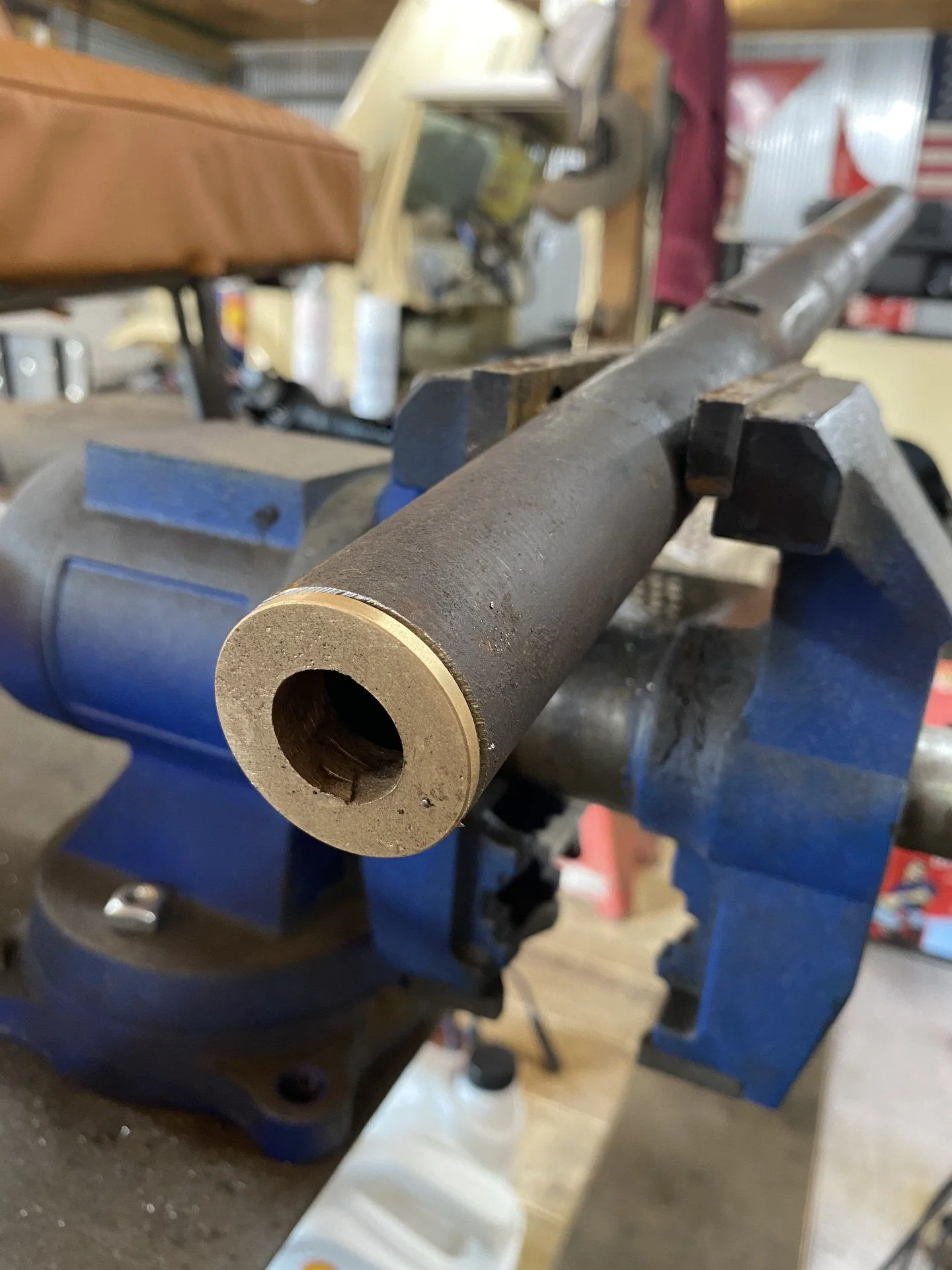

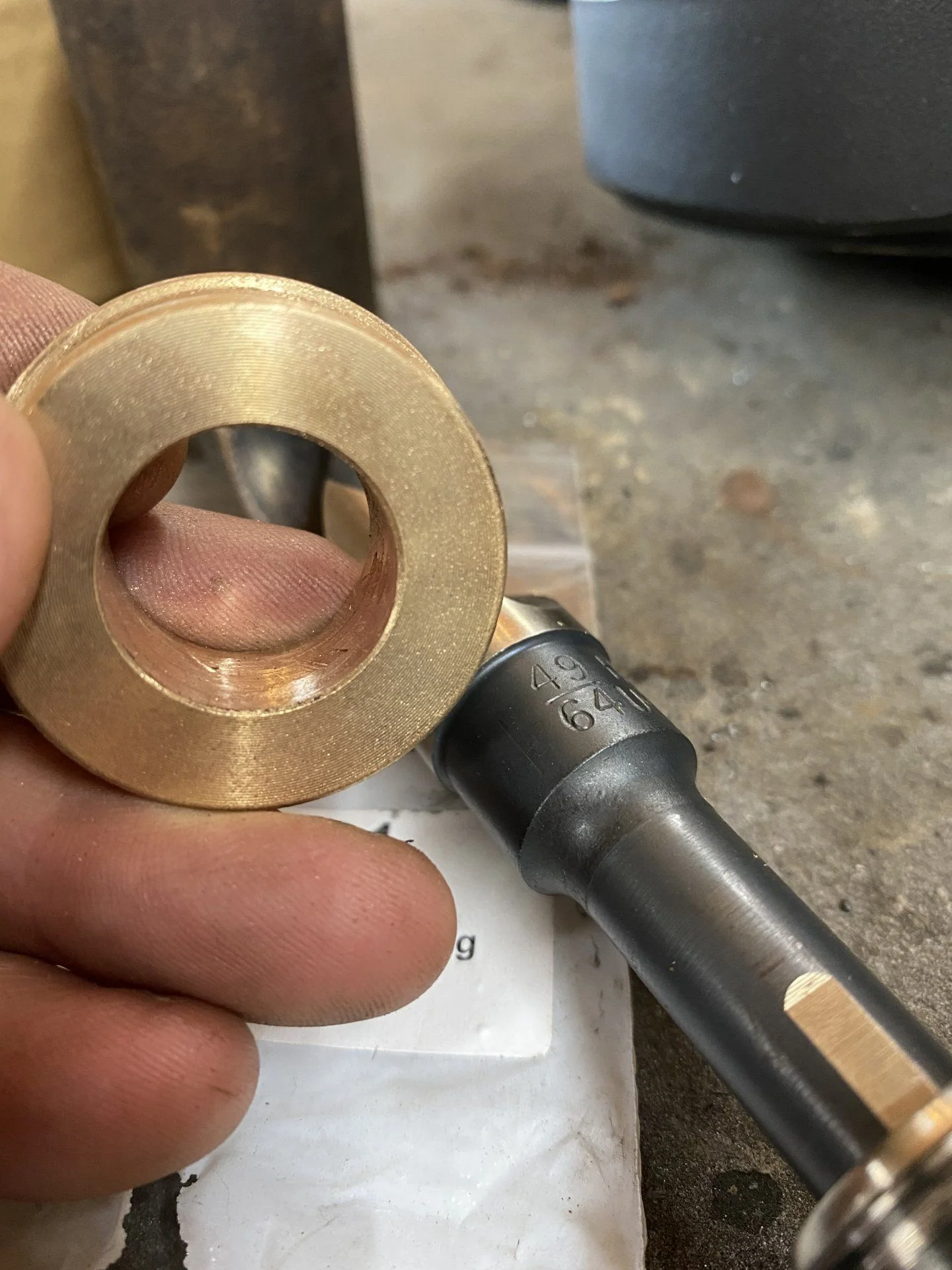

Next I drill out the center of this bushing and it makes the shaft much easier ti
Length of the outer tube

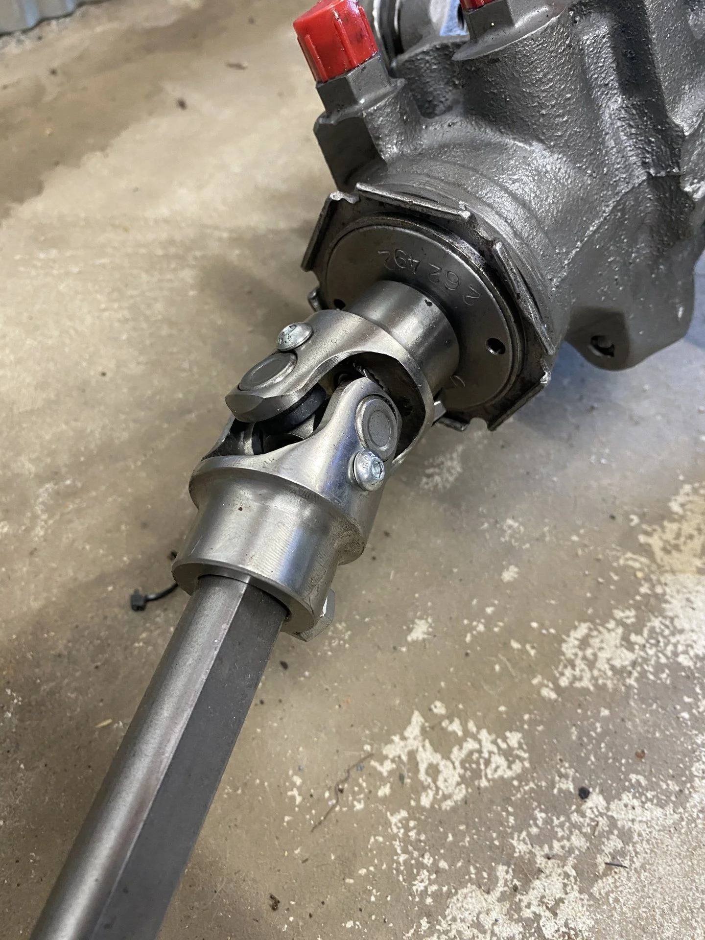

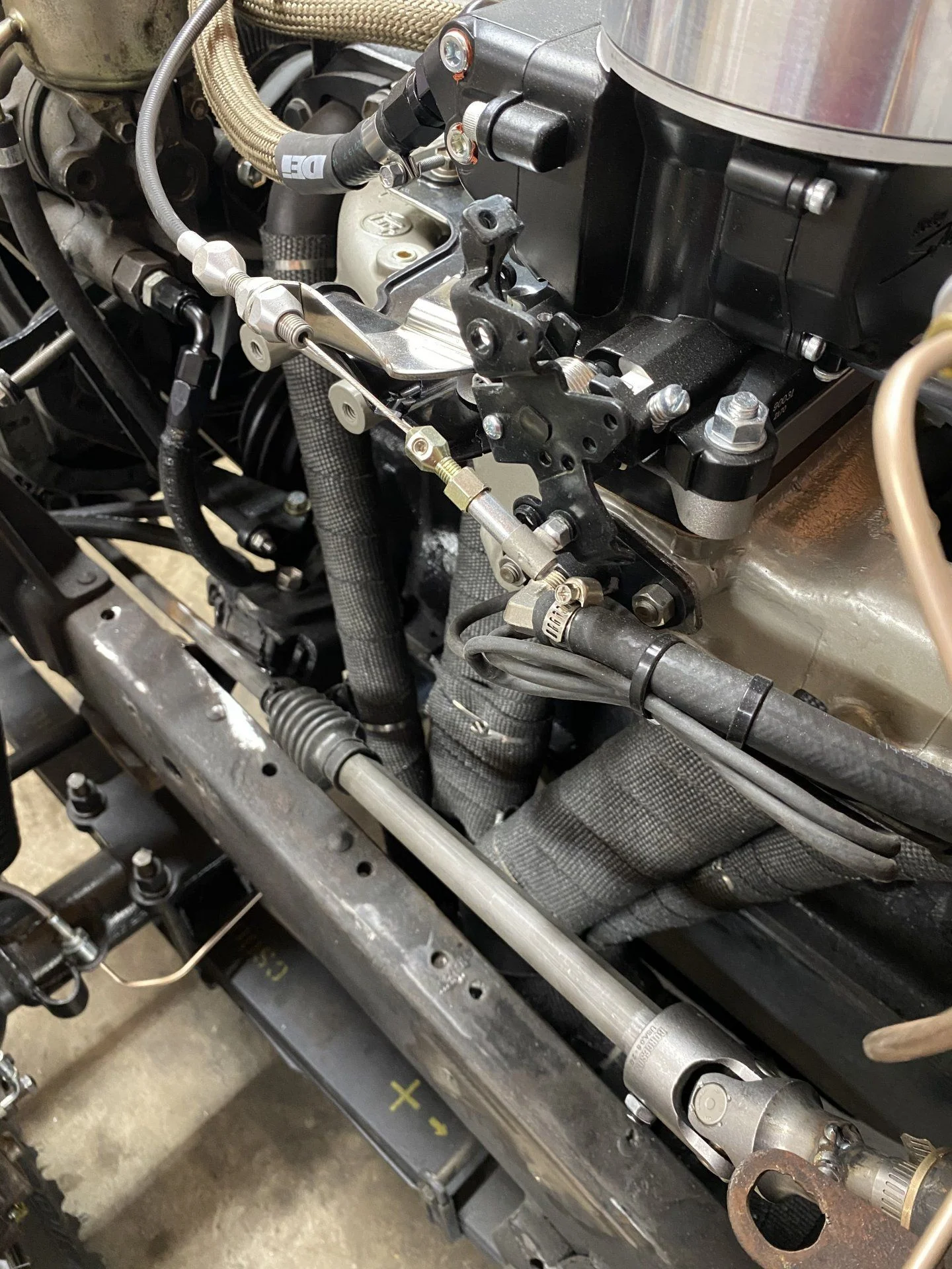

I attach the lower DD shaft into the splines on the box then feed it up and then adjust the upper DD tube and the main column until clearance is right.

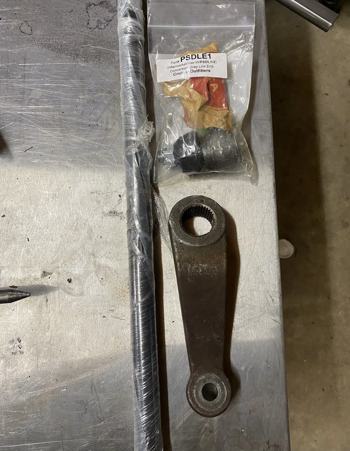

Last parts you will need are a conversion drag link and conversion rod end from Cruiser Outfitters and a 1.5-2” drop Pitman arm.

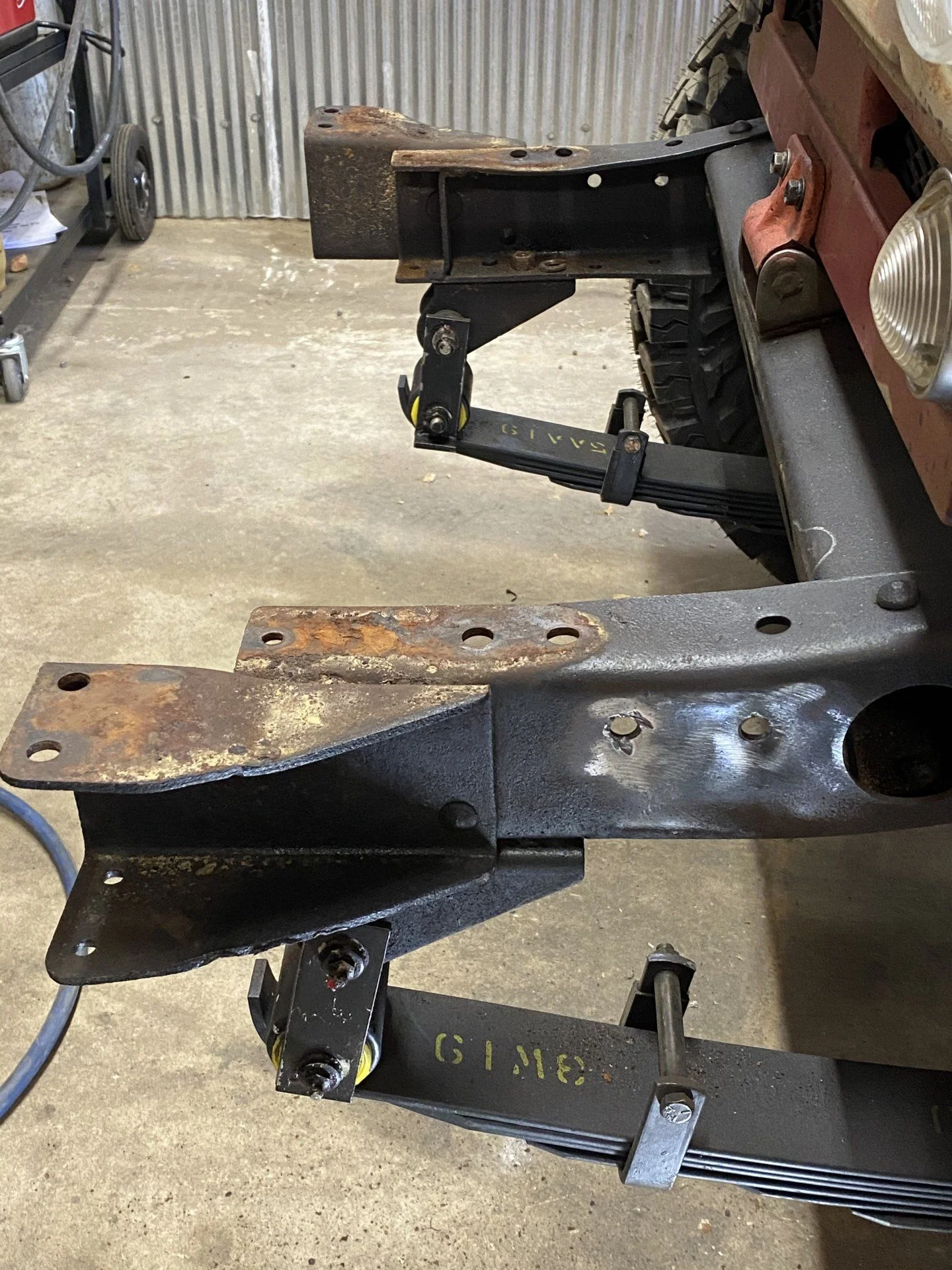

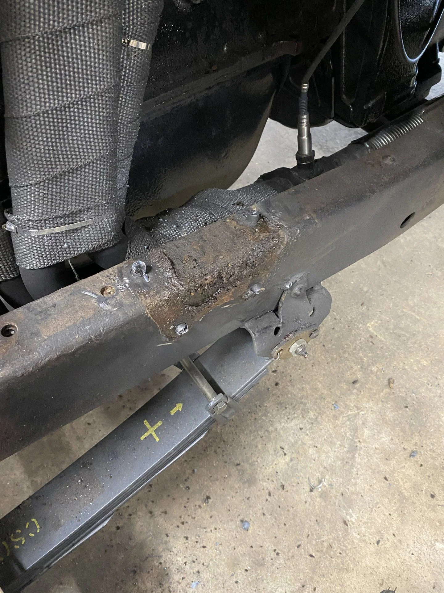

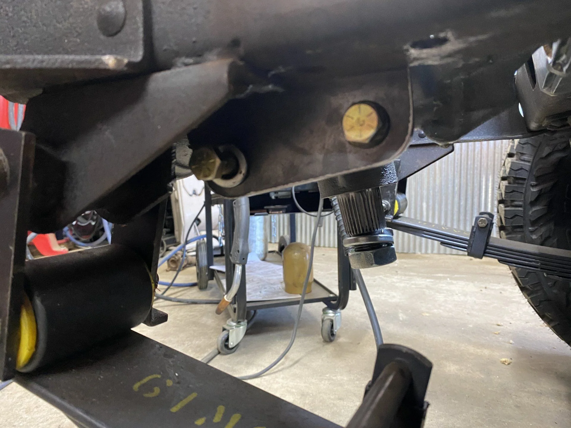

You need to clearance one side of the front spring hanger

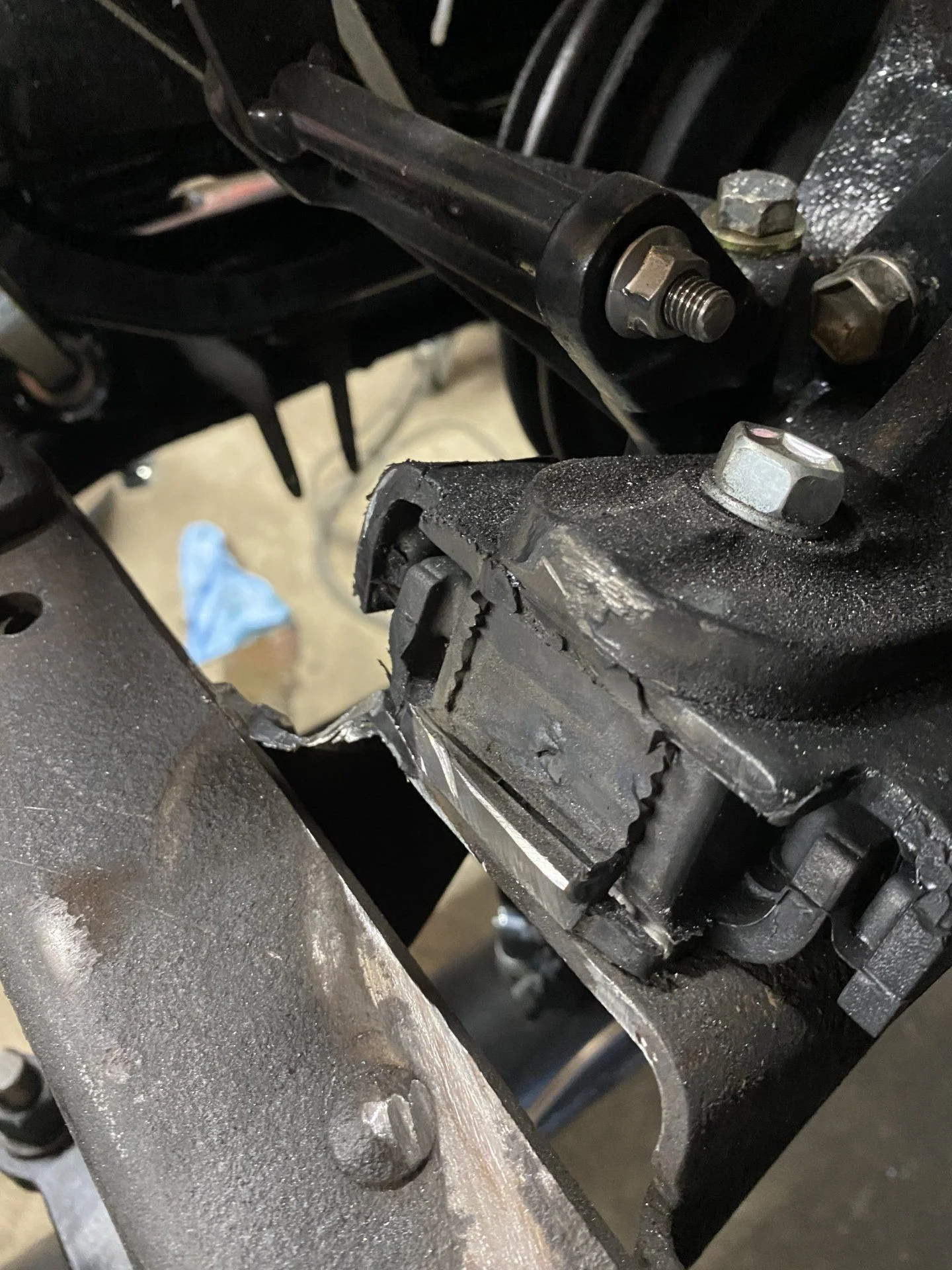

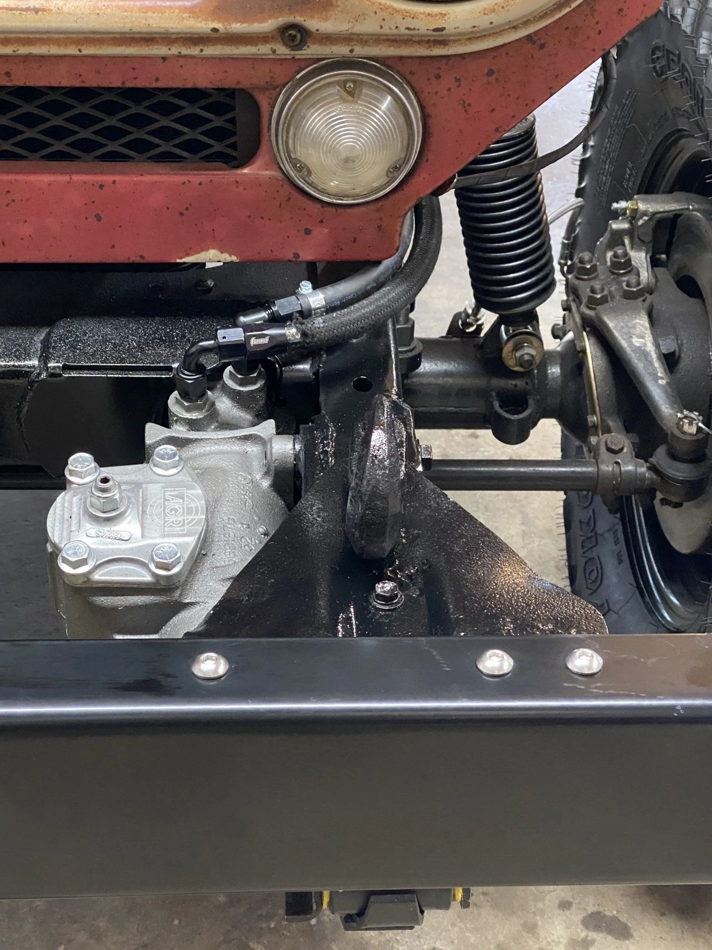

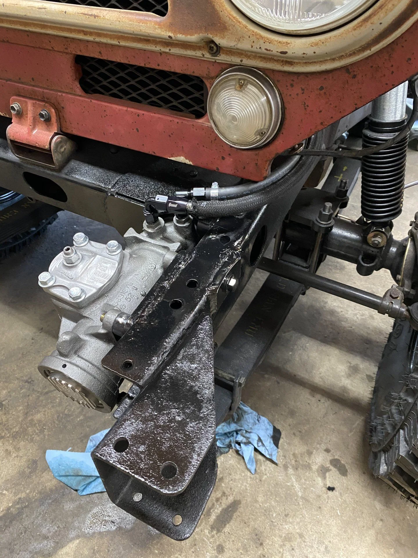

I was able to get this box more level than the last one because the seal on the output was smaller downside to that is that it was putting the small DD into the motor mount Instead of redoing all the front we decided to clearance the motor mount
Cleaned up and painted.

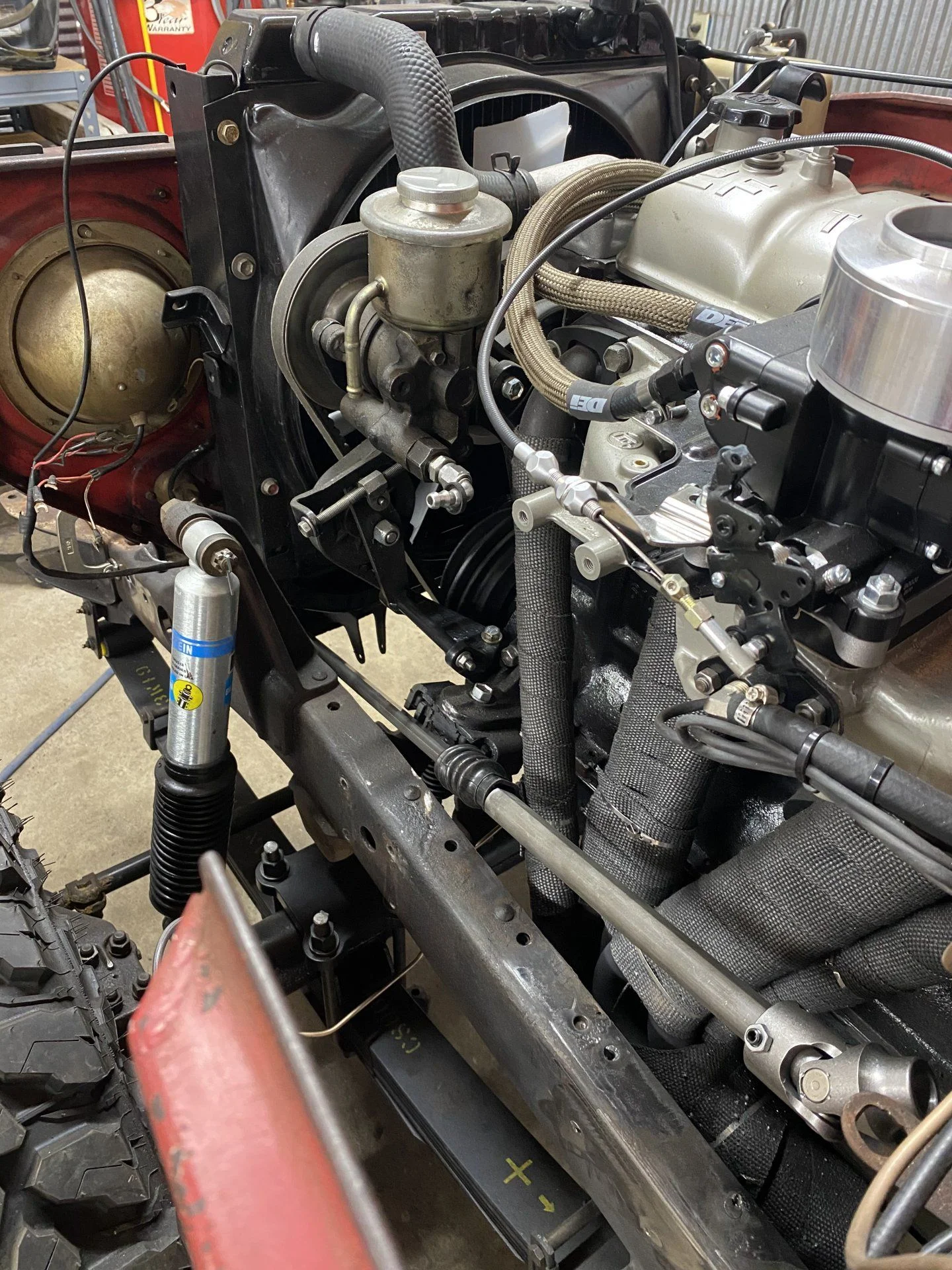

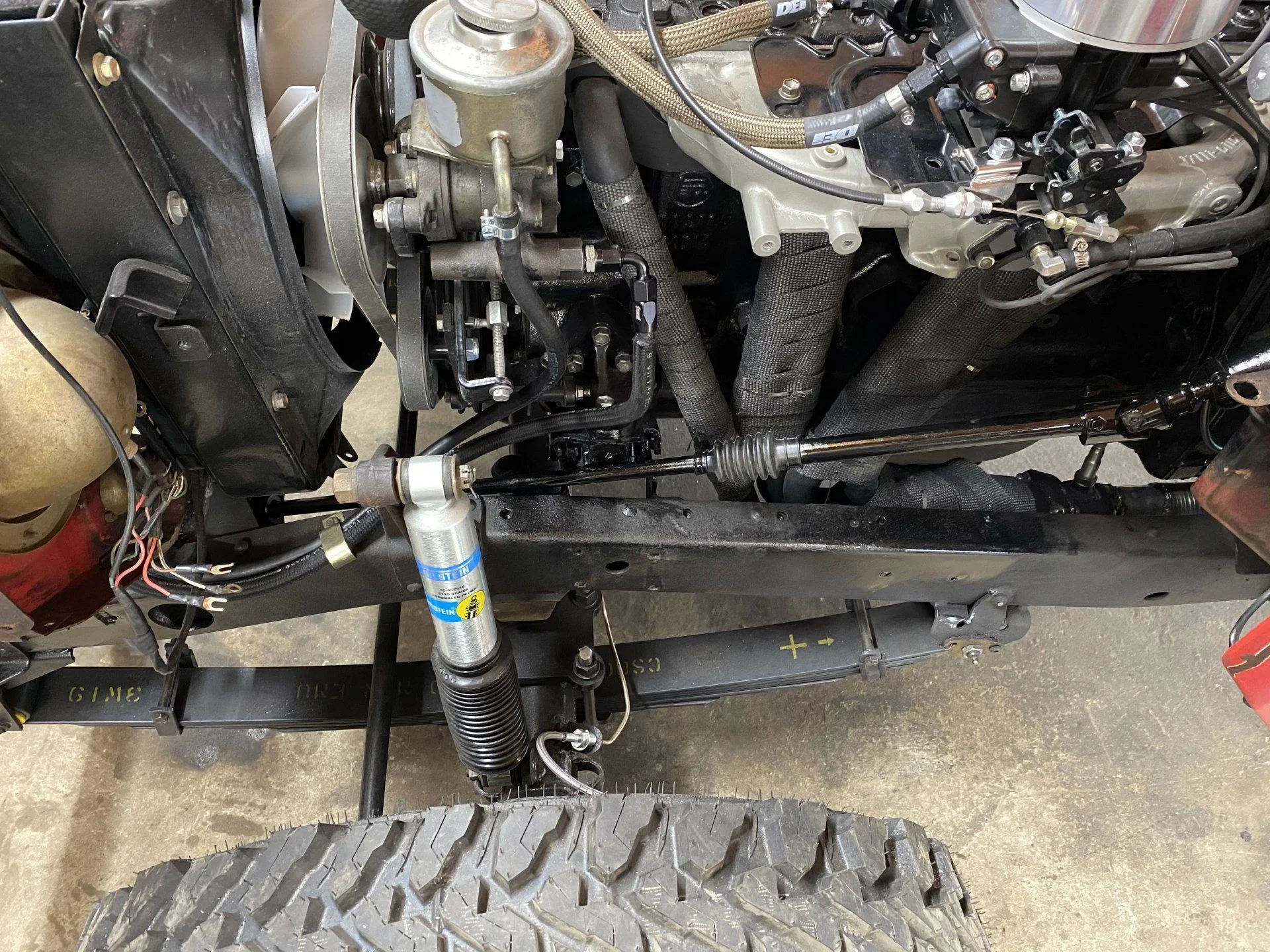

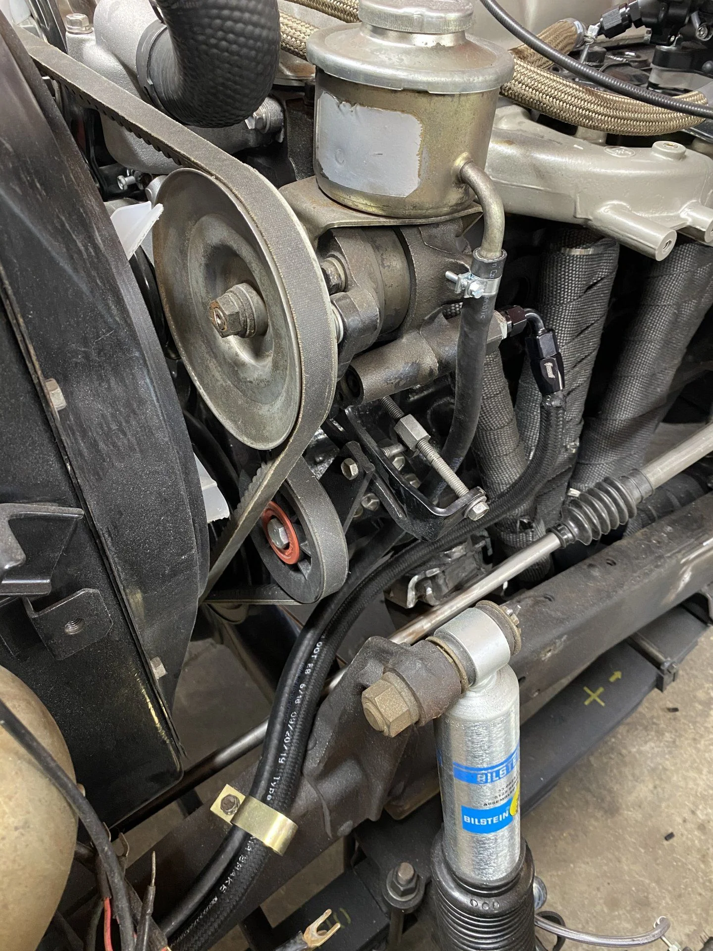

Ran the -an 6 lines to the Toyota pump

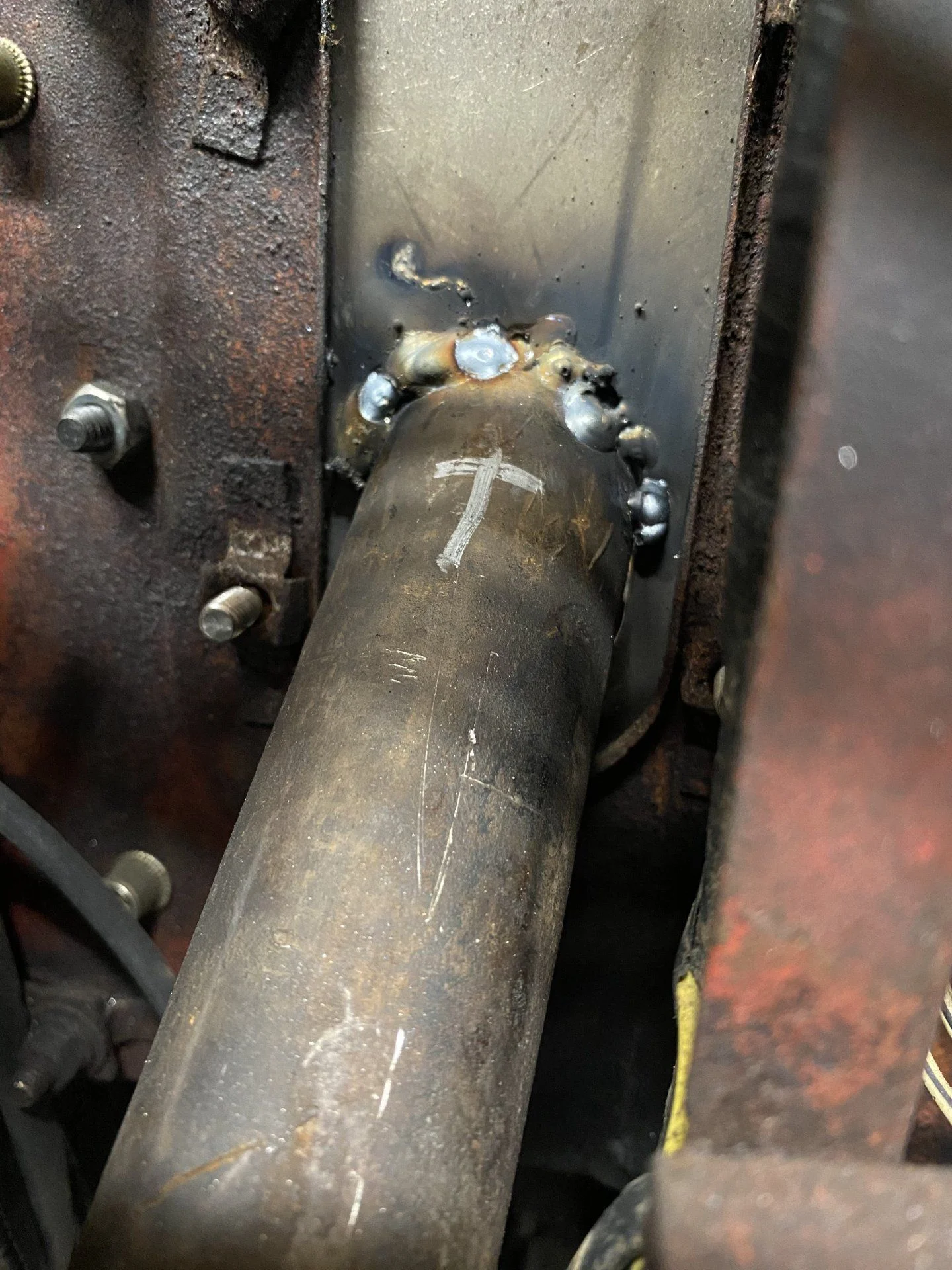

Upper joint welded in.
The 2” drop Pitman arm is too much for this one. Going to order a 1” drop Monday.

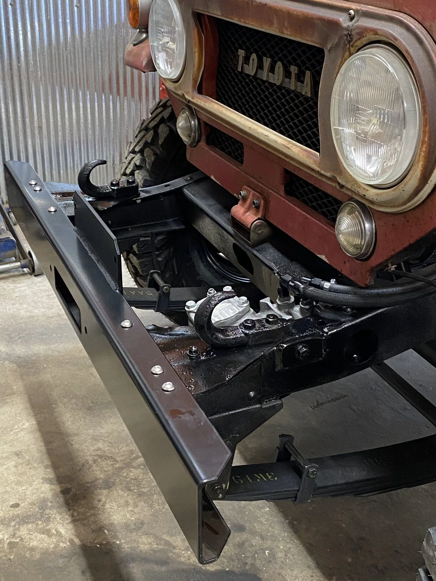

The system is all in. Plumbed and ready.

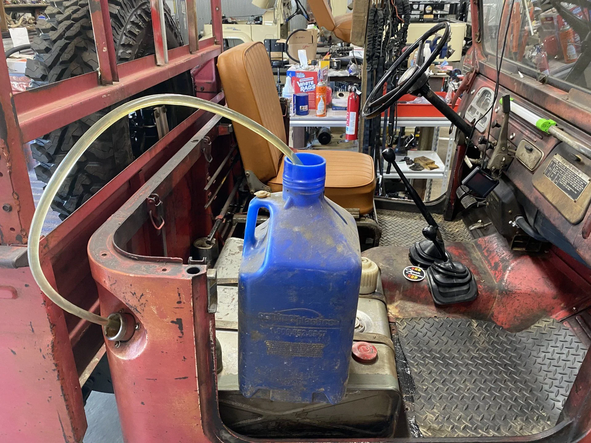

@AGR Steering recommends their brand, this one and a Delco. I used up all of the AGR I had on hand but I found this local

The only sketchy thing I’ve got going today is the -an 6 PS line. The barb going into the hose was the correct size but the Summit fitting I used would not go over the outer webbing.
I cut back the webbing and got down to the metal jacket and it worked fine. Of course I’ve not put the pressure to it.
Luckily I have enough Earl’s hose to make another one. I’ll order the right fittings next week from AGR when I get the pitman arm

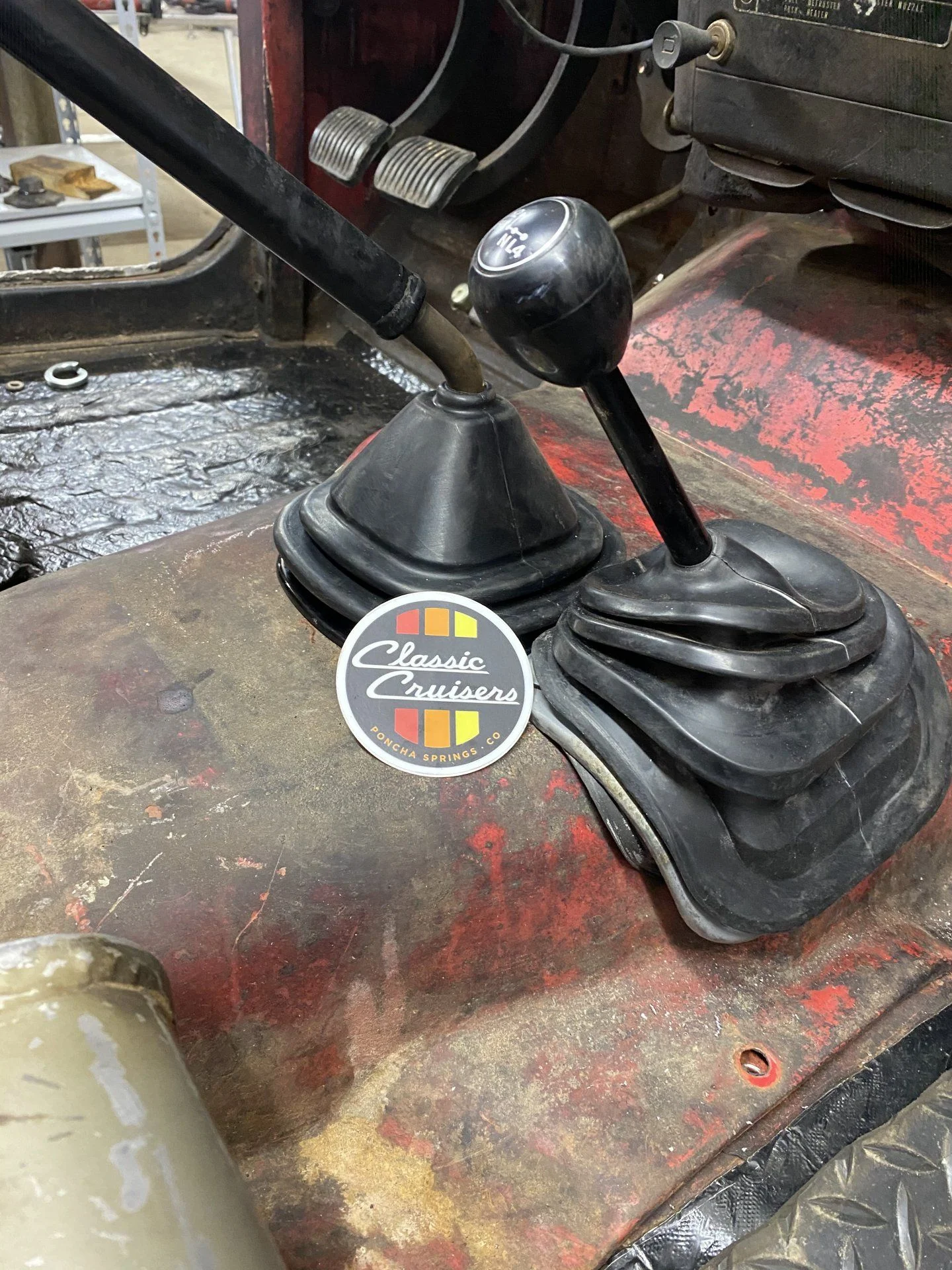

Spent the morning adding the Tcase shifter I got from Classic Cruisers as well as the boots and such.
Bolted in the hump.
Added 4 gallons.

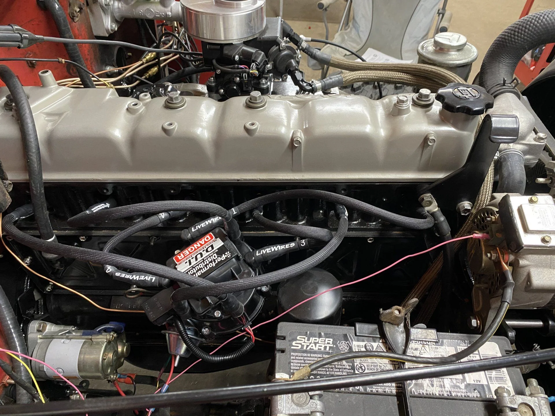

Stabbed the DUI and plugged the Live Wires.
Steering column in and up is a perfect mod to a 45. Adds a little breathing room. If you were taller I'd tell you to raise the seat.
I actually took padding out of my drivers seat back and it is just perfect now with the column up and forward. Even a big boy will fit in here now.
