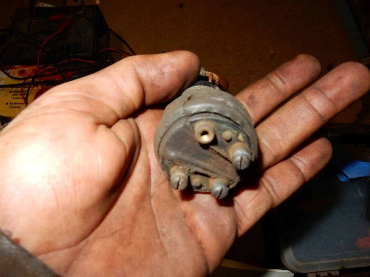

my ignition switch had terminals. can get pics over the weekend
forgot to add that this was a donor 1964 switch. original was missing but the wires look very oem round terminals. can check my 1960fj25 if needed; have never looked. away for few days but back late week.
this is the ignition we are talking about not the lights or wipers (both those are bare wire into the switch).

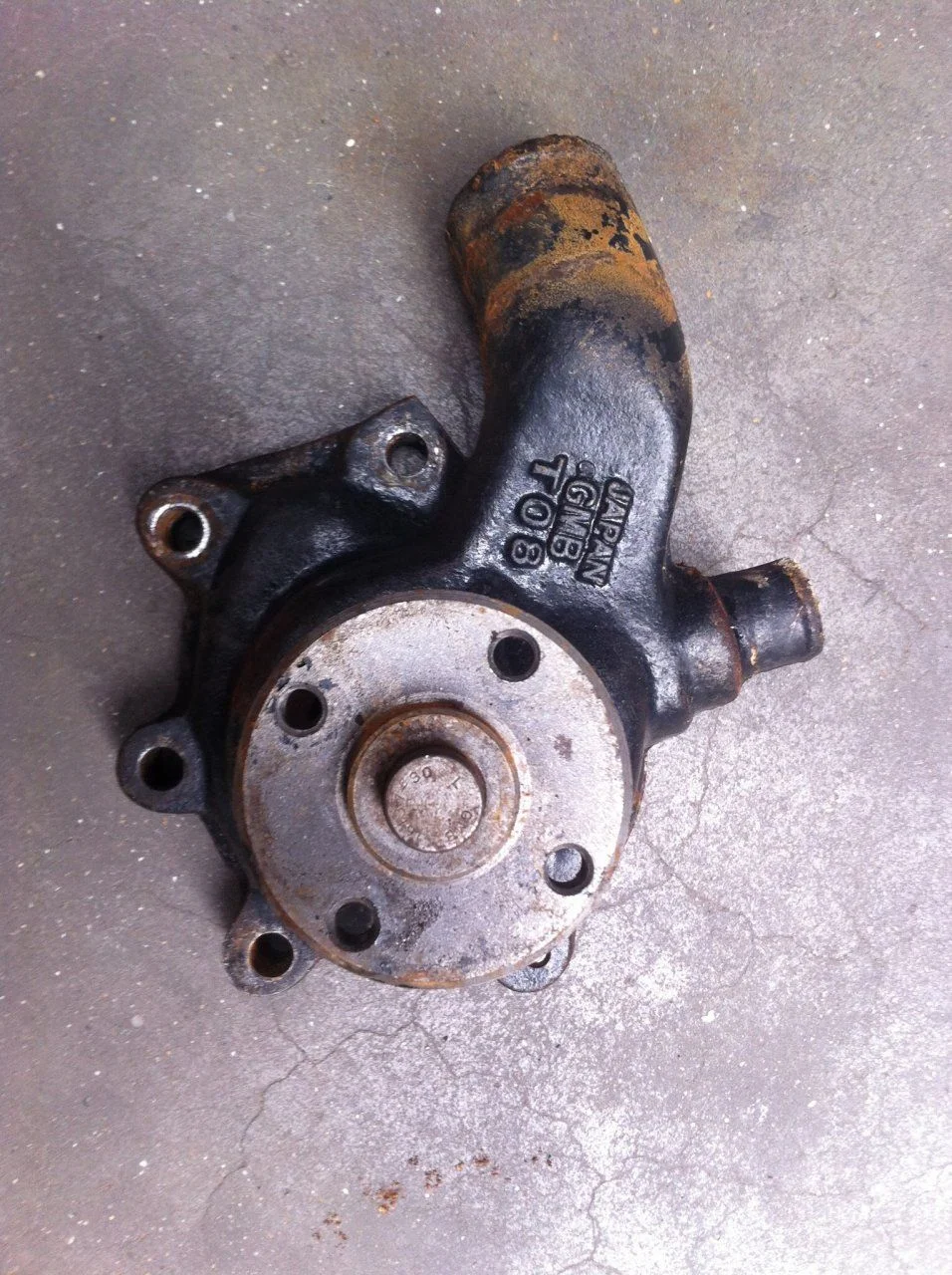

So this is my waterpump:
Is this correct for 1962?

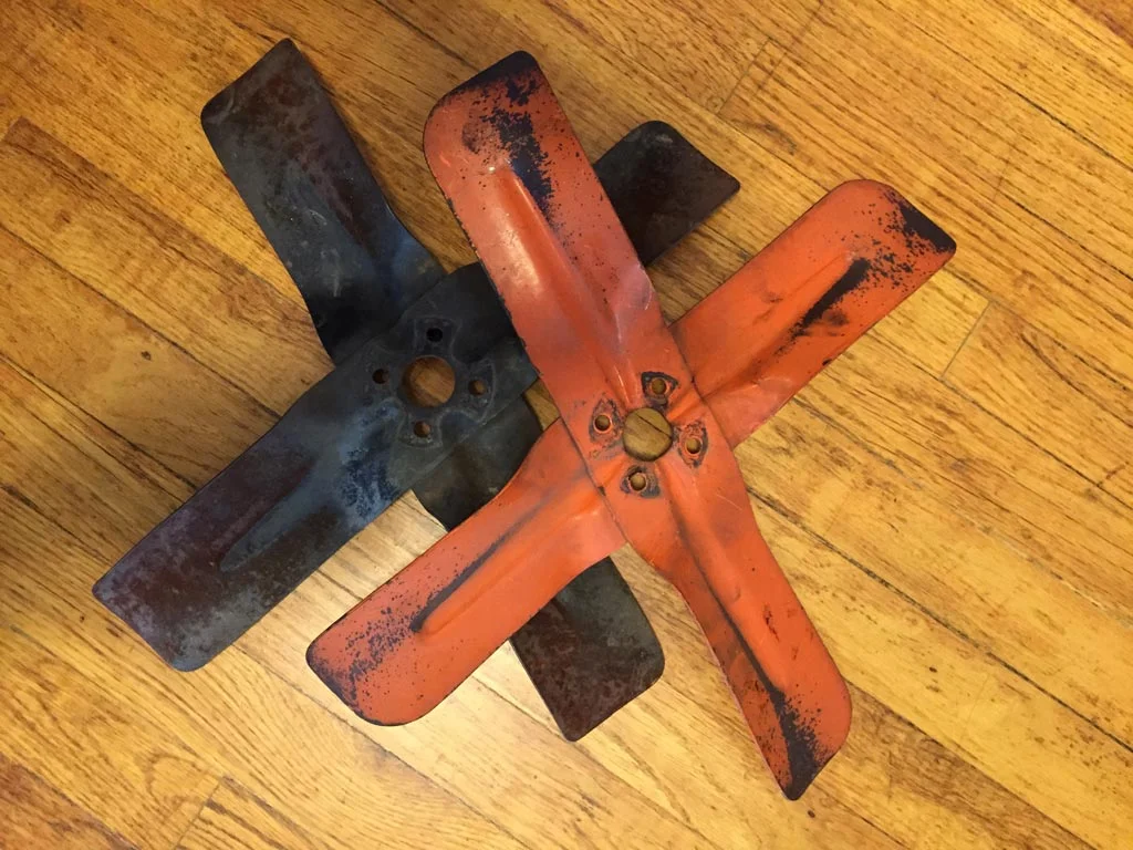

Our four blade steel radiator fan show some cracks. Is this still available? In our 65 parts book we found part number 16361-60010 is this right?
Looked at the black fans vs. the orange fans and I believe the black ones have sharper corners. We may be able to use this to determine what color the fan should be painted.
will have a look at a few fans tomorrow. believe there were a few early differences in the rib shape and way the two halves were riveted together but havnt made a study of this yet. is hard here because so much of y junk has had engine swaps over the years.
How did your ignition switch wires attach to the ignition switch? Were they attached with ring terminals? Or did the (bare) wire ends simply attach through holes in the sides of the switch terminal posts just as they would on a light switch and wiper switch? Any photos?
here a pic of my 64 ignition. my 60 fj25 one the same; ie terminals.
hmmm, I think not. Im quite sure mine was never painted and that it is the original one. I do not have the sharper corners and the center is like your orange one is. Like West Aussie said it looks like the rivets are different. Mine is connected with 2 rivets and 2 spot welds. Your orange one and the yellow one from platebasher look spot welded. But I see none of you have cracks (yet).
Some non scientific research (because I like corny stuff like this) :)
All are squared on the early but came in both orange and black so there goes that theory. My 1969 FJ40 has the rounded orange fan. Probably changed when they went from black to grey rims in '67. Earliest rim I have found with grey is 10/67.

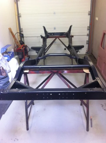

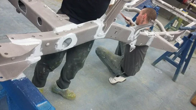

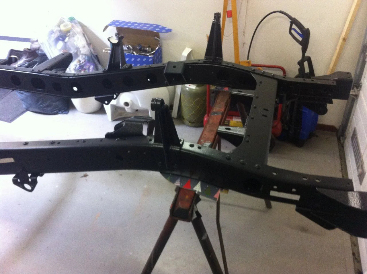

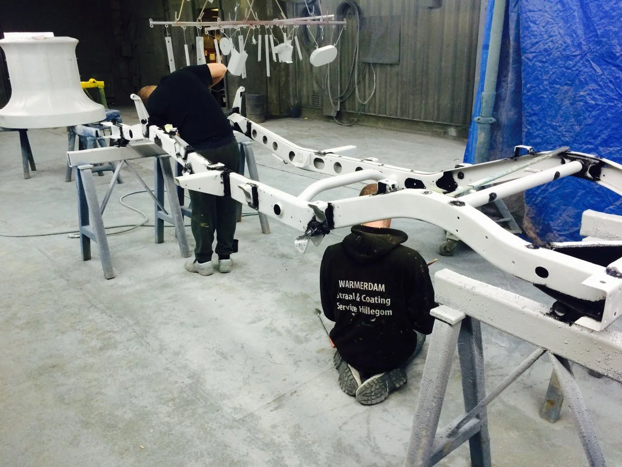

We completely stripped the frame. One of the front shock mounts and one of the body mounts were a little bit off. Probably by the tree that has once fallen on the front edge of the roof once (as Gary, the PO, told me). And the rear crossmember was a bit bent caused by a PO towbar. After fixing we took it to the local blast and coating service (Paul Warmerdam straal en coating service) who did a really nice job. Just a little rustpitting, nothing serious. They extra treated all the edges and corners, and did a nice paint job.

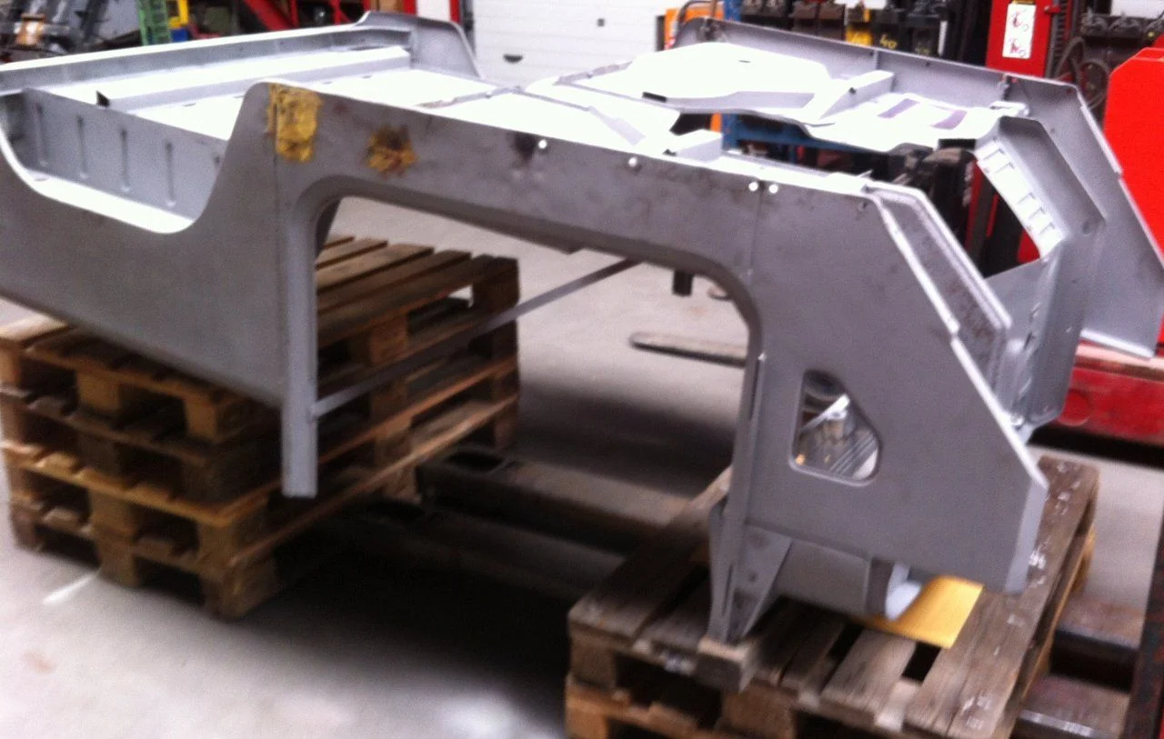

Meanwhile we have been working on the tub. Allthough there were no rust holes, on some places where the steel was double it was thicker caused by the rust in between. Fixed all those spots. Also filled the extra holes in the dashboard. And placed the brackets in the rear crossmember we forgot when we replaced that.
