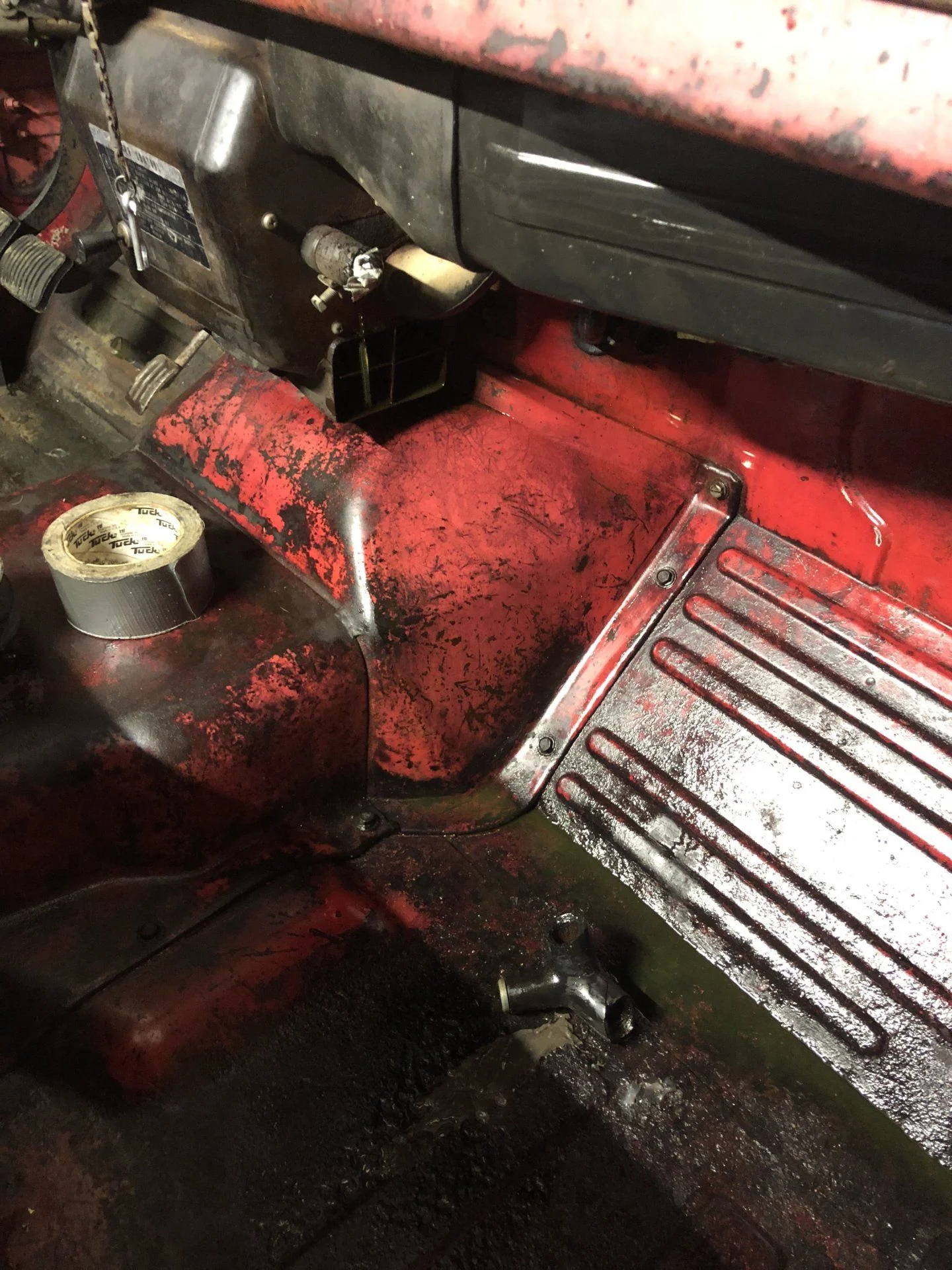

On the way home I felt a warm spray on my leg. I looked down and water was coming out of the heater.
Bummed, I decided to race (in a F135 truck this means just don’t stop) home and see it I could get there before it ran out of water
Turns out the ONE hose I didn’t replace busted. My failure.
Oh the joys of old vehicle ownership !

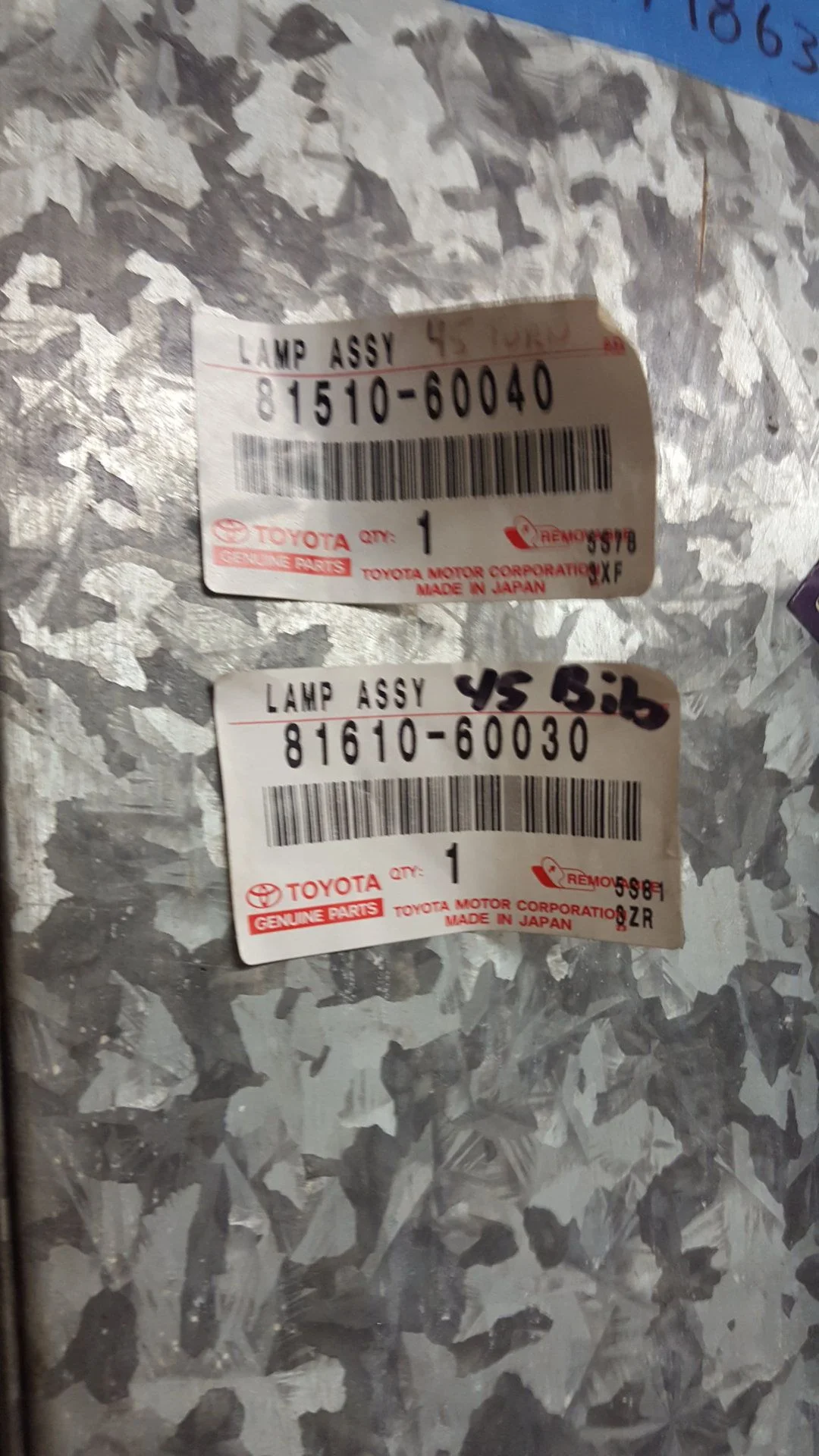

Pn for bib and turn

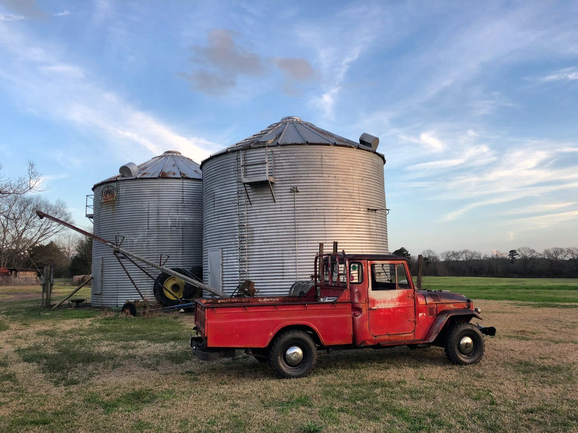

But I got a cool pic at the farm Down the road.

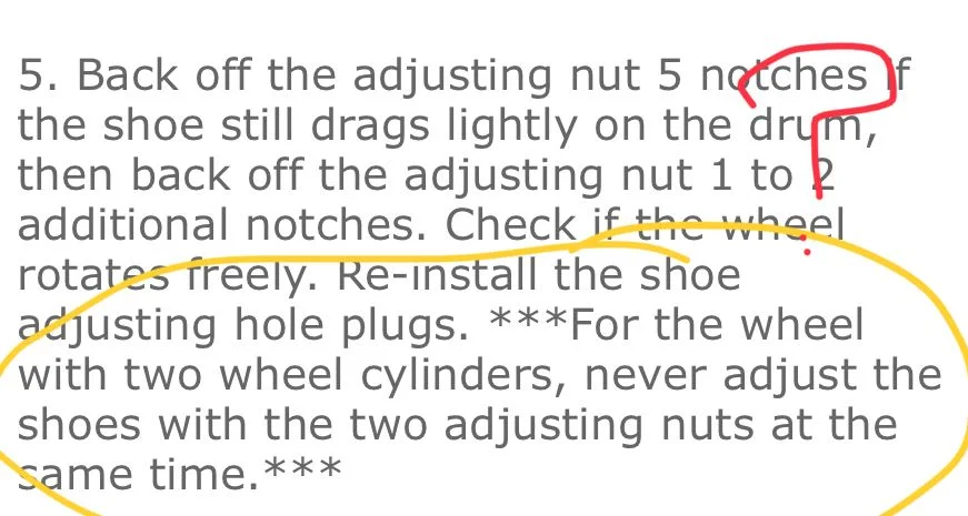

What are those instructions from?
In general, for me, the issue is getting the shoes to seat properly after they’ve been messed with. I leave them pretty tight (as mentioned earlier), drive a little with some hard breaking, then adjust down as necessary. “5 notches” is a lot especially from “drags lightly.” I’m guessing 5 clicks on each cylinder means 10 total per wheel which means no brakes.
Disclaimer: Where I drive with my 40 (and hopefully eventually 45) I don’t need disk-brake performance. And you’ve been in this cruiser world deeper than me, so YMMV for sure.

Heater hose is fixed
I guess I have to crawl under this damn thing and finish the Rust Converter treatment.
Nasty work.

I spent way more time fixing the one bad one with I see, the wrong lense color, to toss it at This point but great to know.
Just send me a total on the tail lenses I’ll send a PayPal. Thank you!!
You have mail :D
