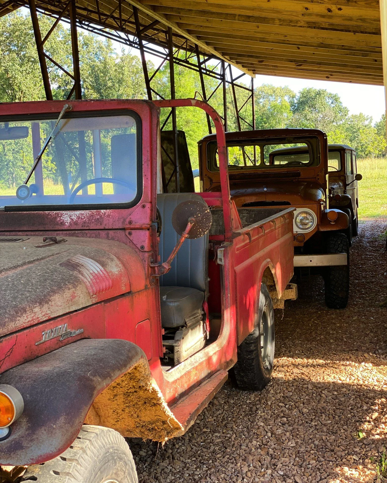

Did some horse trading with Lockwood with the 750-16’s on the Goat for a set of 255/85-16s. I’m getting anxious to get this guy out of the dusty equipment shed.
All the parts are collected, now I need to clear this 45 SWB project and get started on my old Goat.

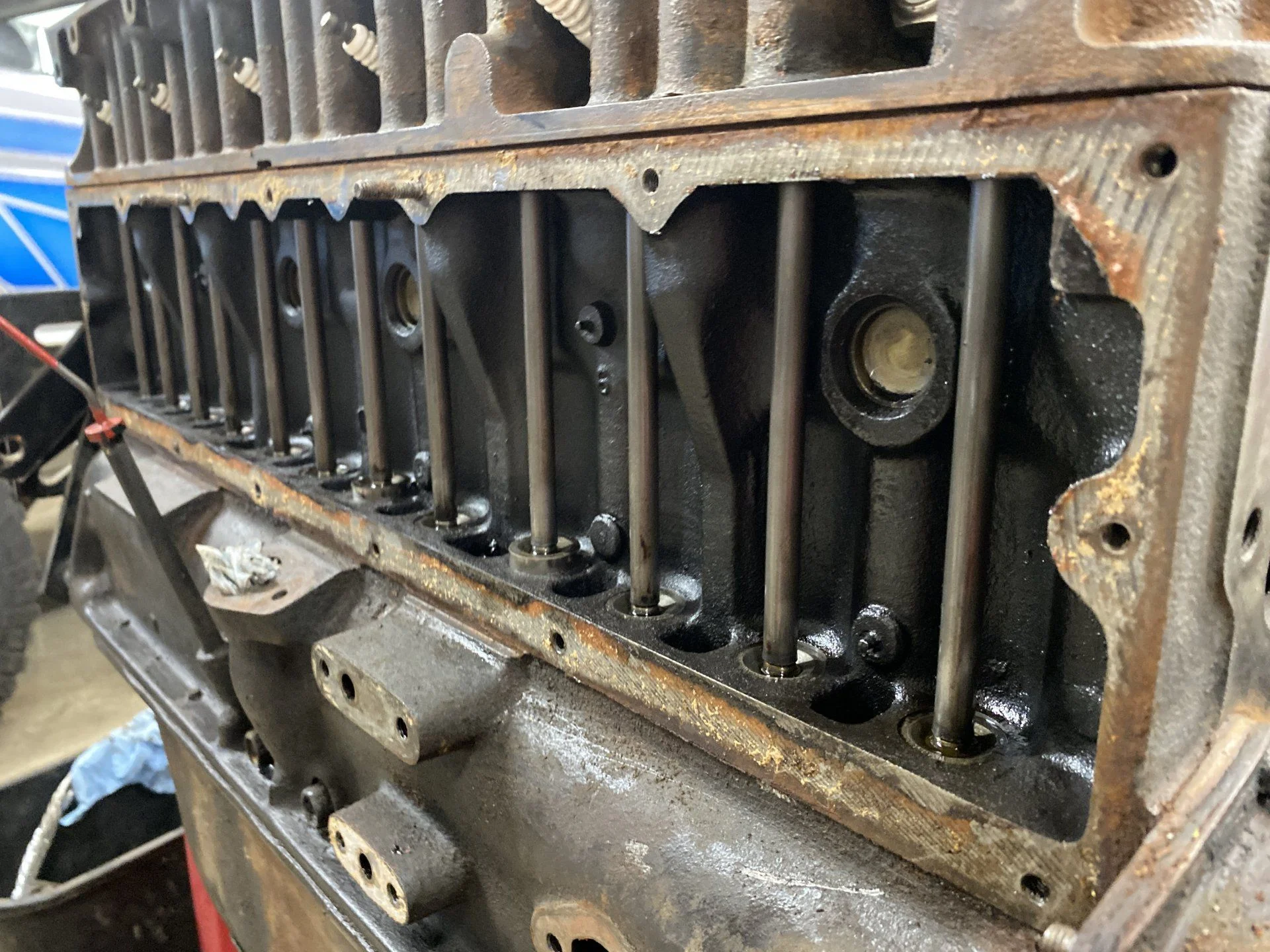

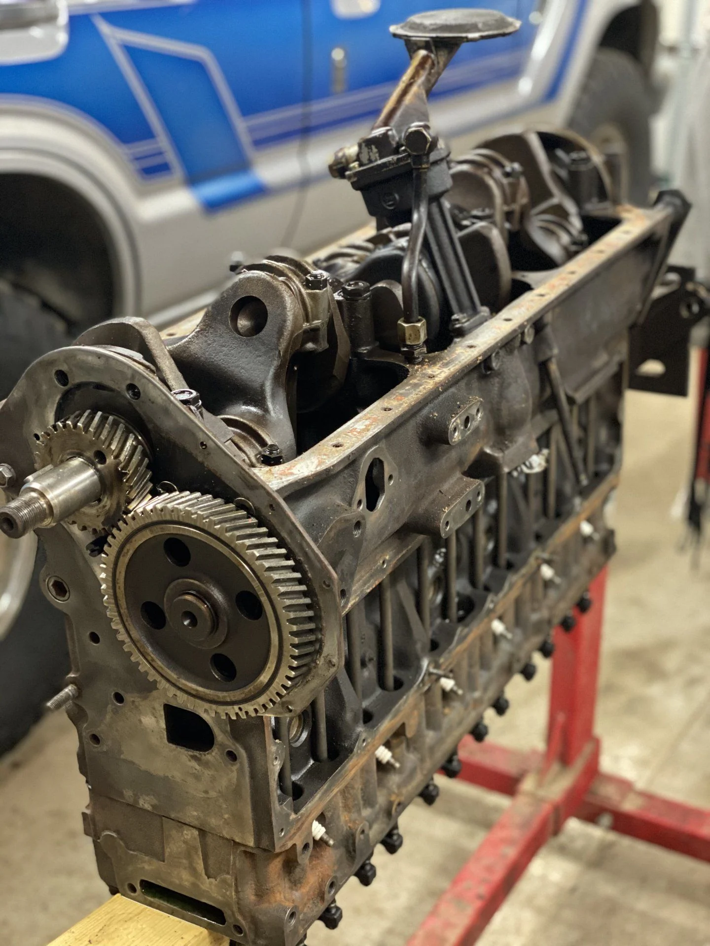

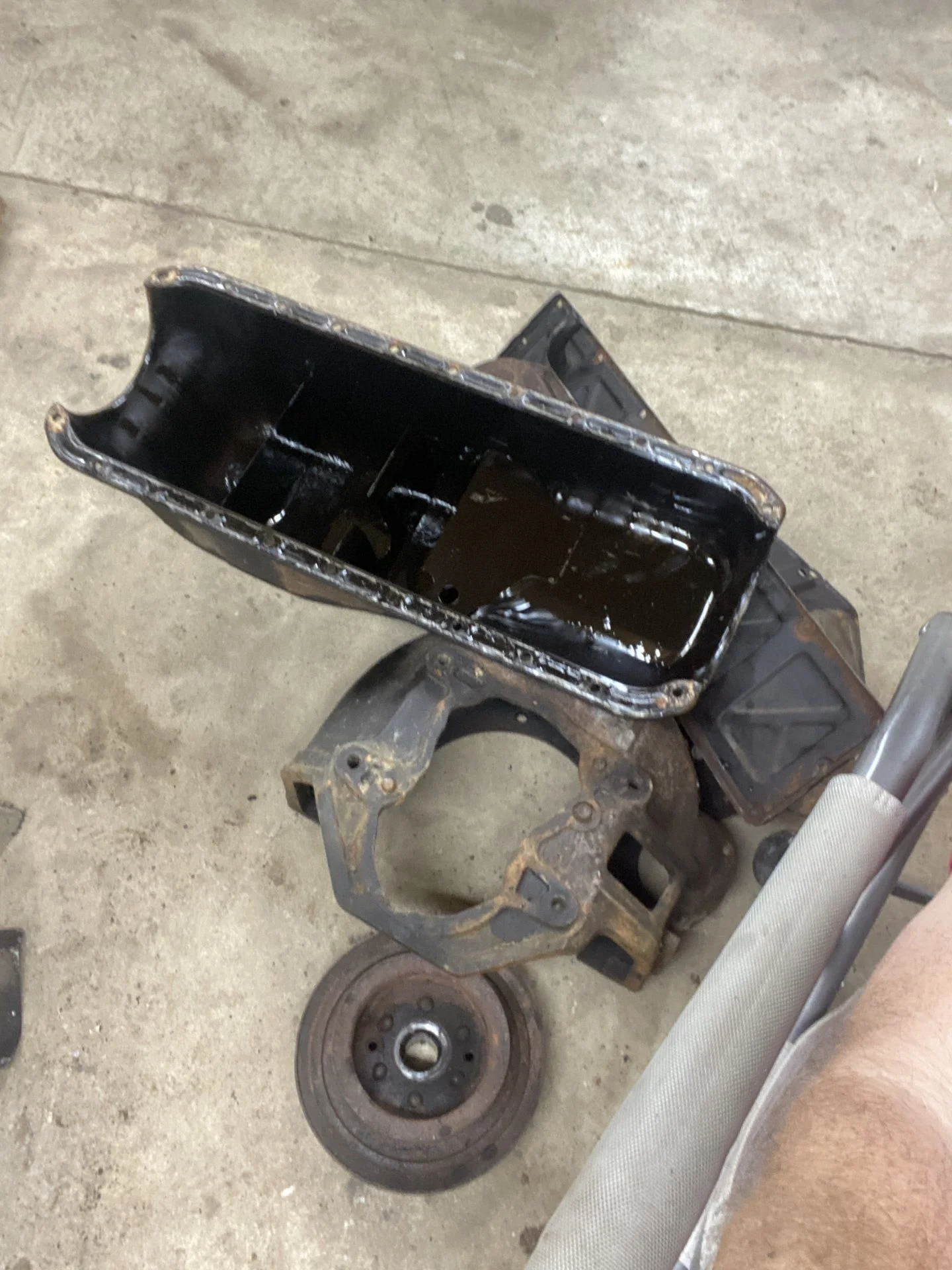

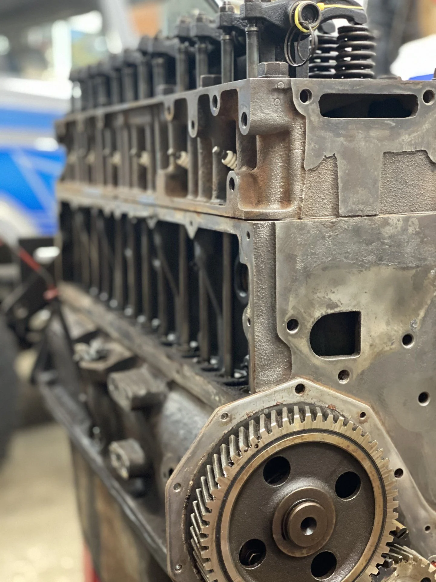

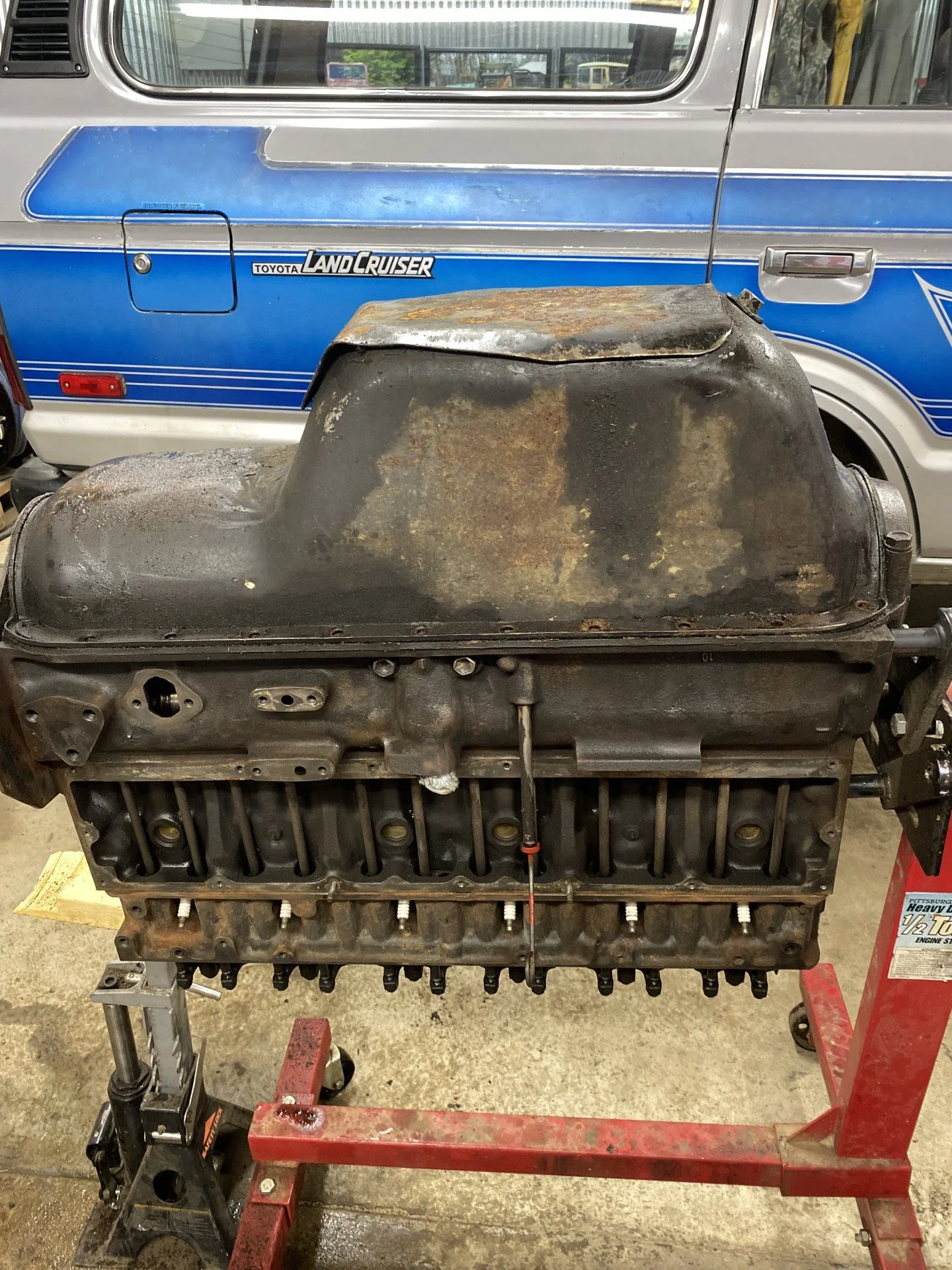

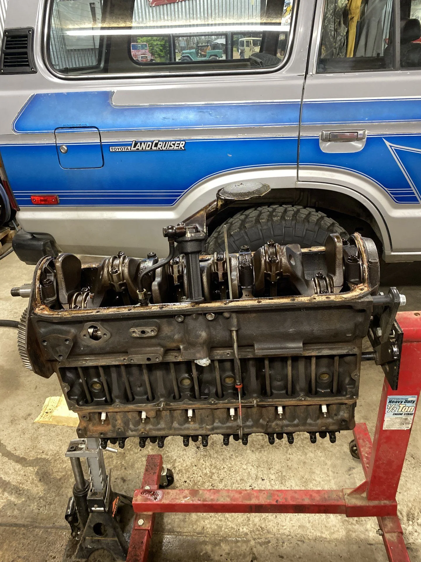

I purchased a very nice 84 2F from @Dustin Messina that he had bought for his now sold FJ55 project. The 2F has 170 compression across the board but since I had it out I figured I’d reseal it so if it leaks it’s my fault.
She’s dirty but that’s ok.

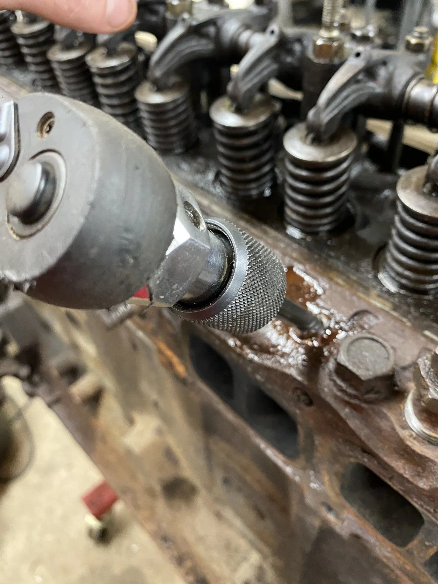

Dustin snapped off one of the air rail plugs but I managed to get it out without breaking the EZ

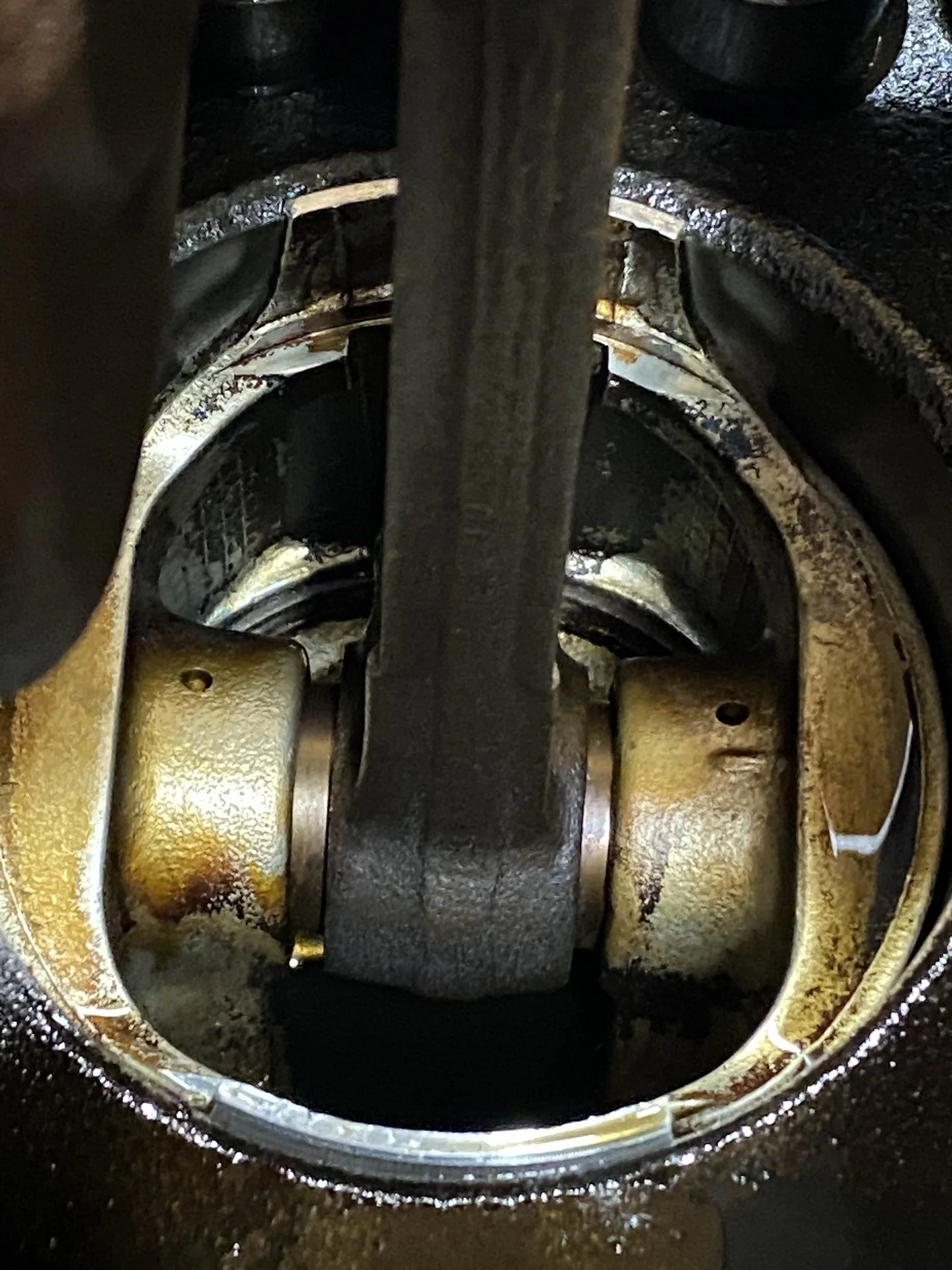

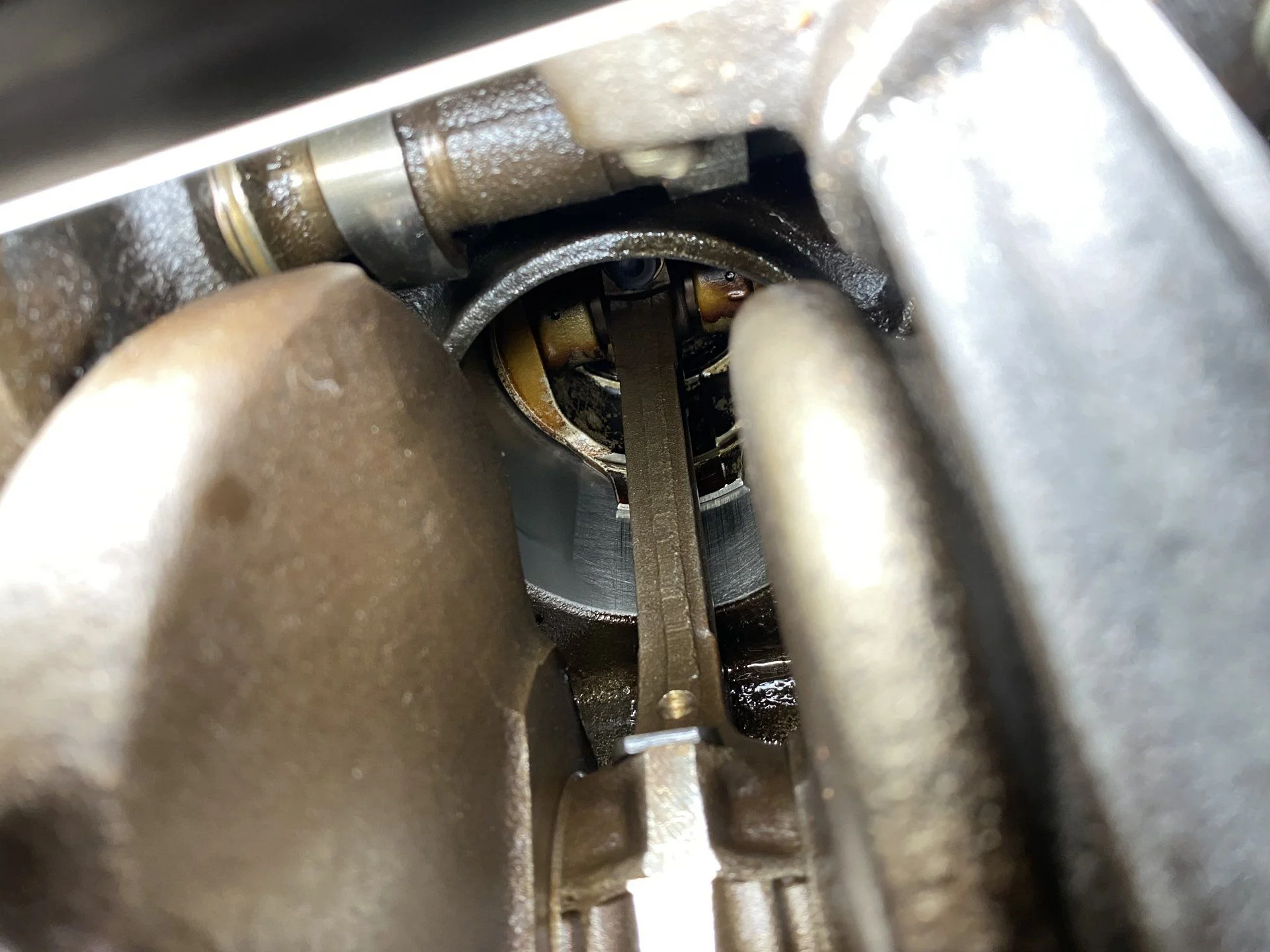

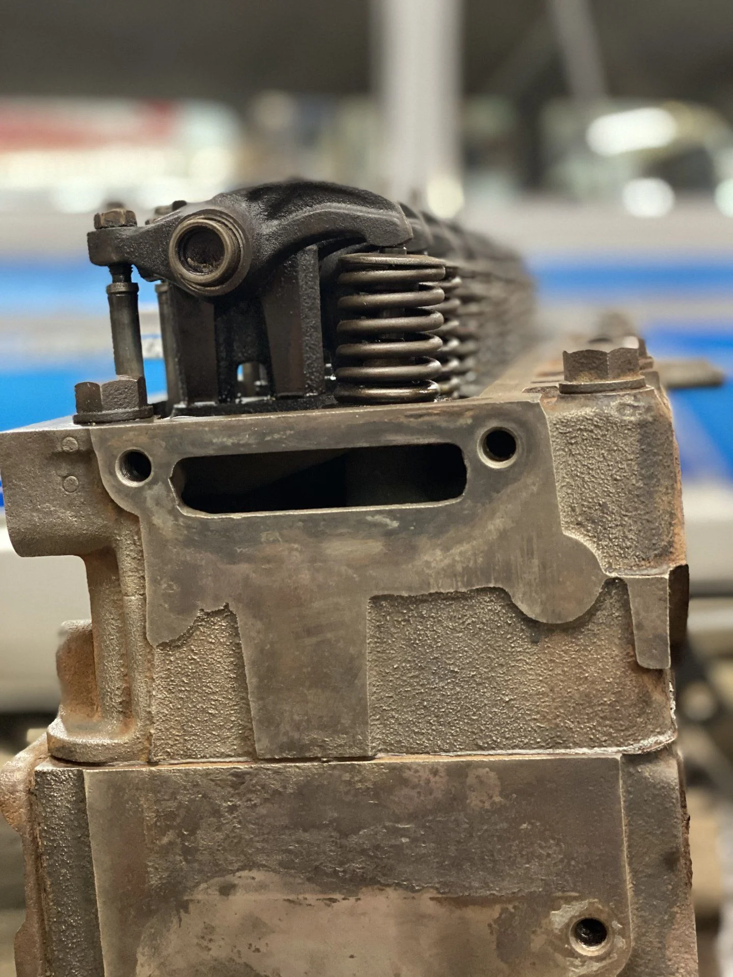

I tried to make myself stop at certain points but then I gave in and took it all apart (except for head gasket.....this is no 1FZ)
All signs point to a fresh rebuild so this process was probably moot. Good solid gaskets with no signs of leaking.

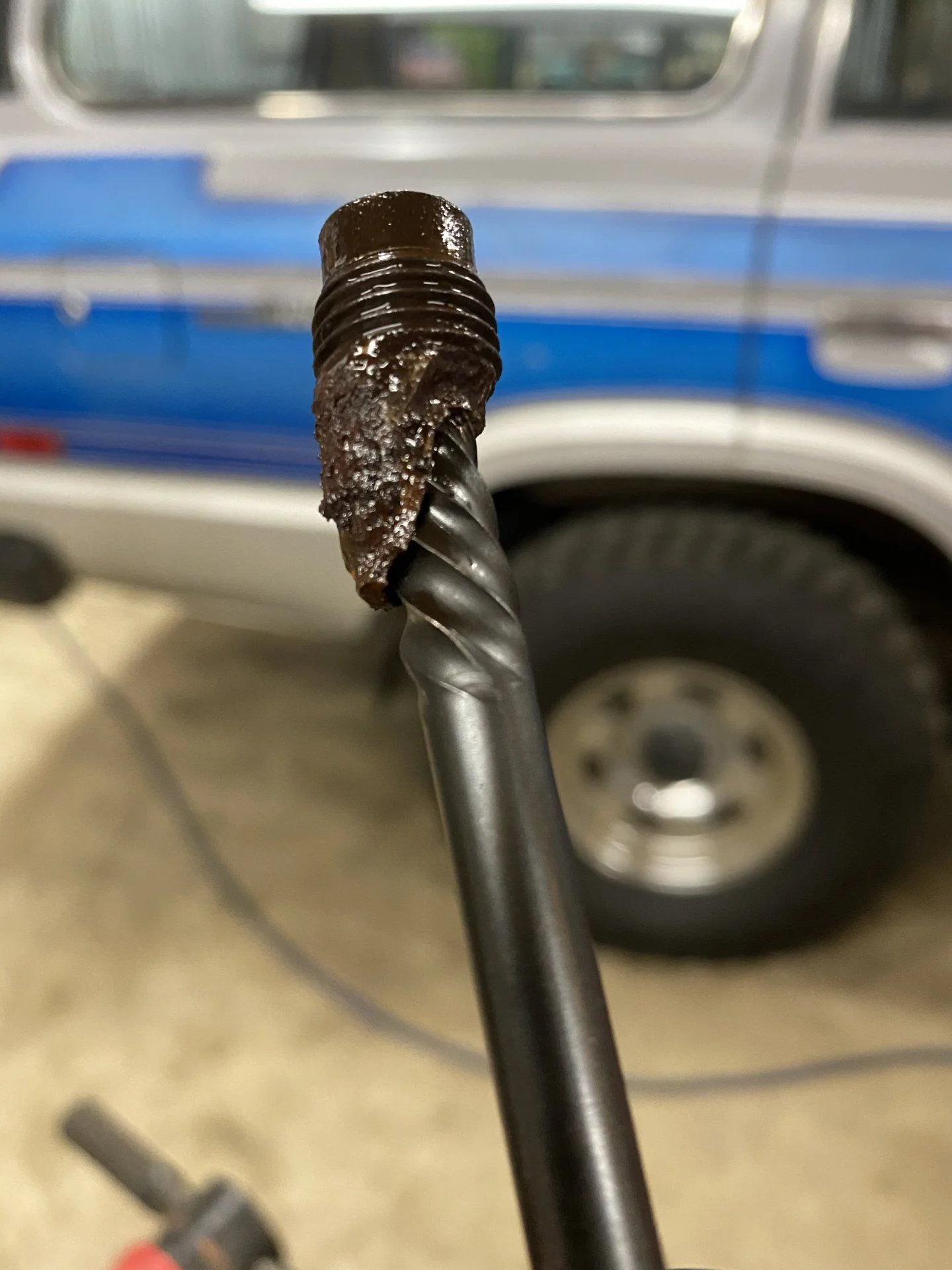

I fixed the oil galley plug since I recently lost one out of the blue on R2D260.....

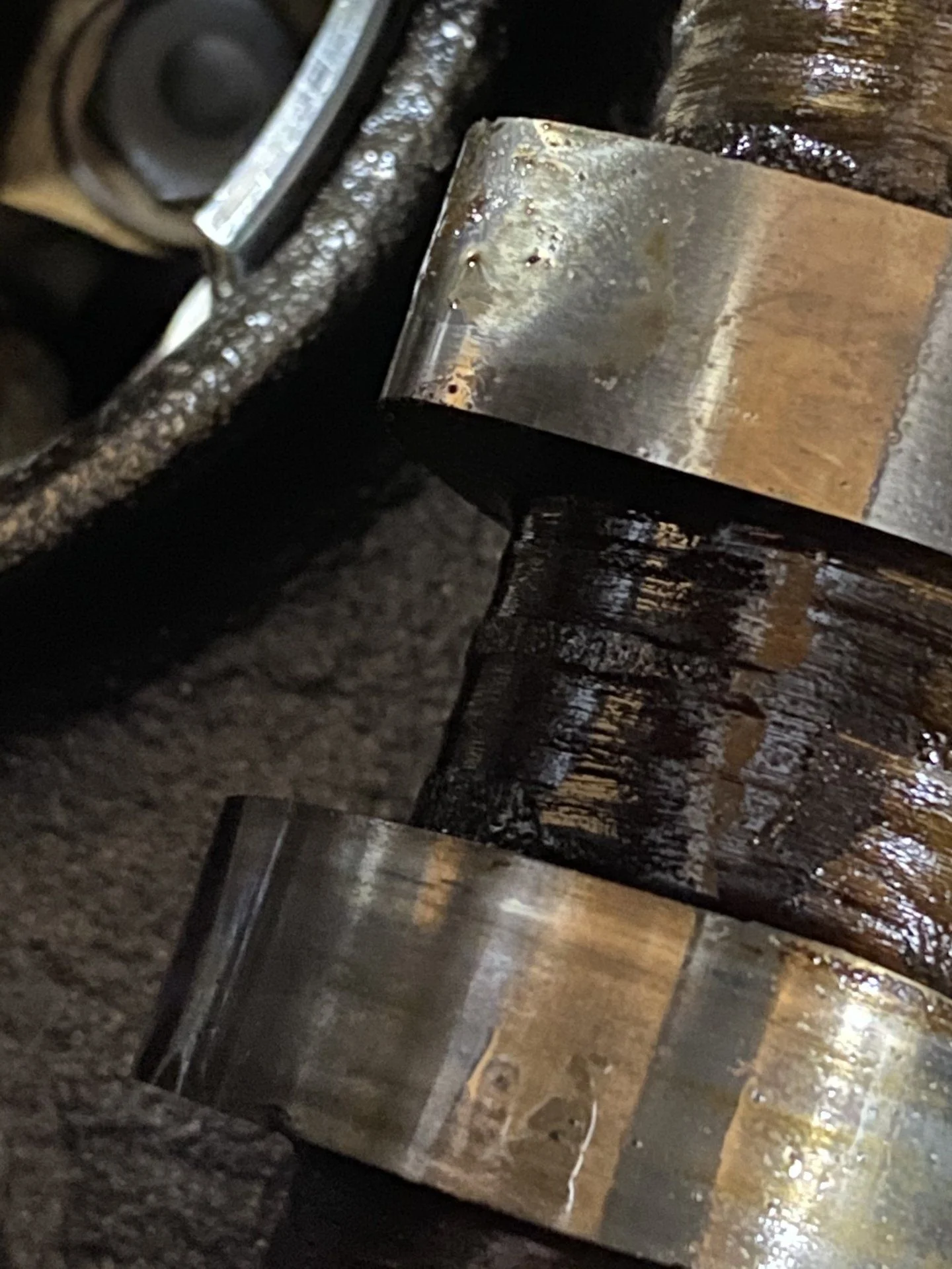

Cam looks good. Pistons look good. Cylinder walls look good. Compression tells that tale but it’s nice to know.
Bolts are in Zepp orange tonight then off to the media shaker
OEM gasket kit to install once this pile gets back from blasting and powder
