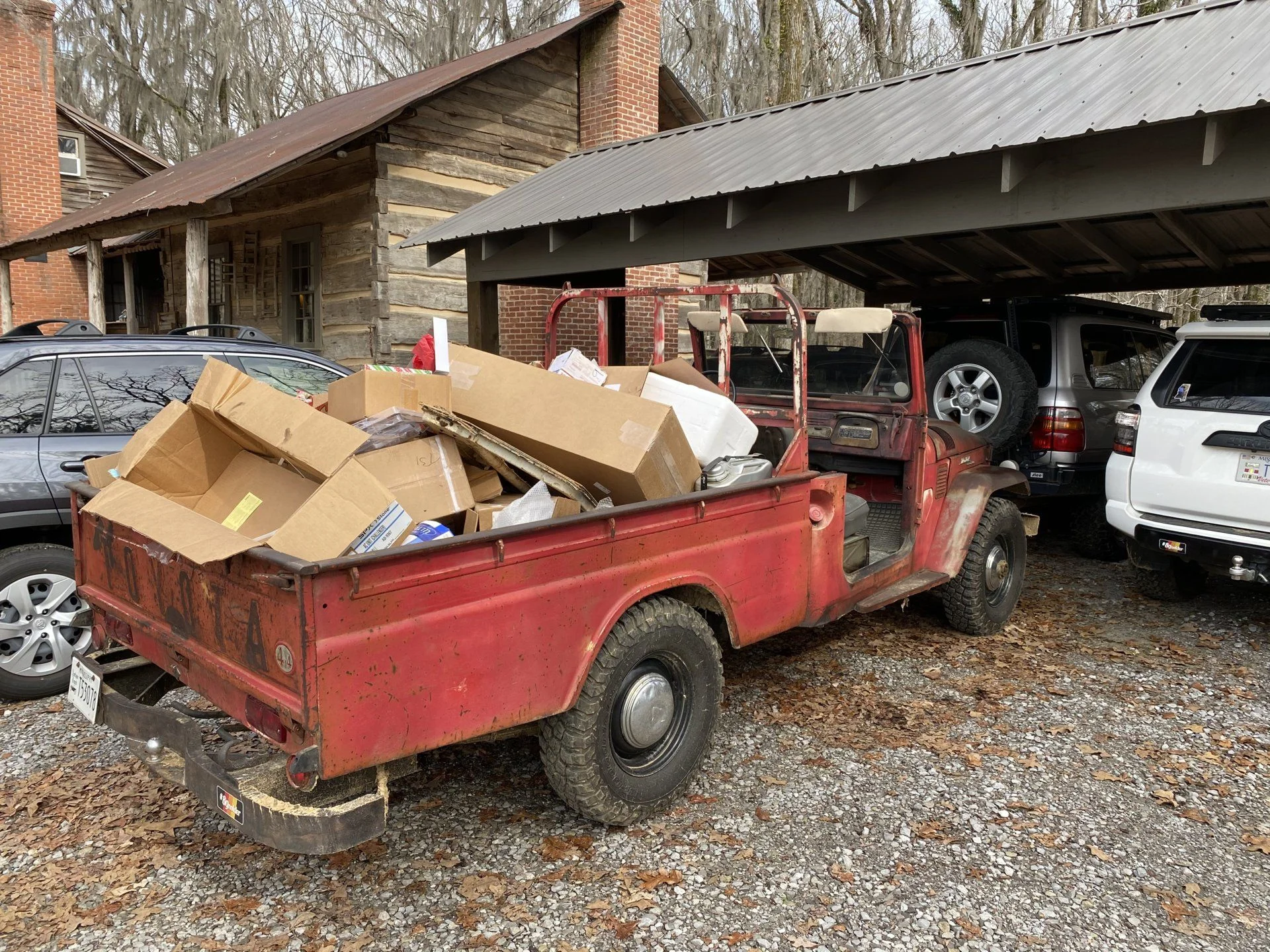

It’s a great Christmas at the Grogan house when it takes an LPB to haul off all the boxes to the “recycle” pit on the farm

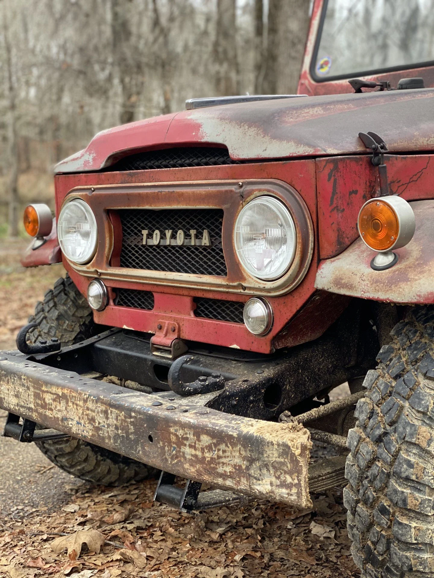

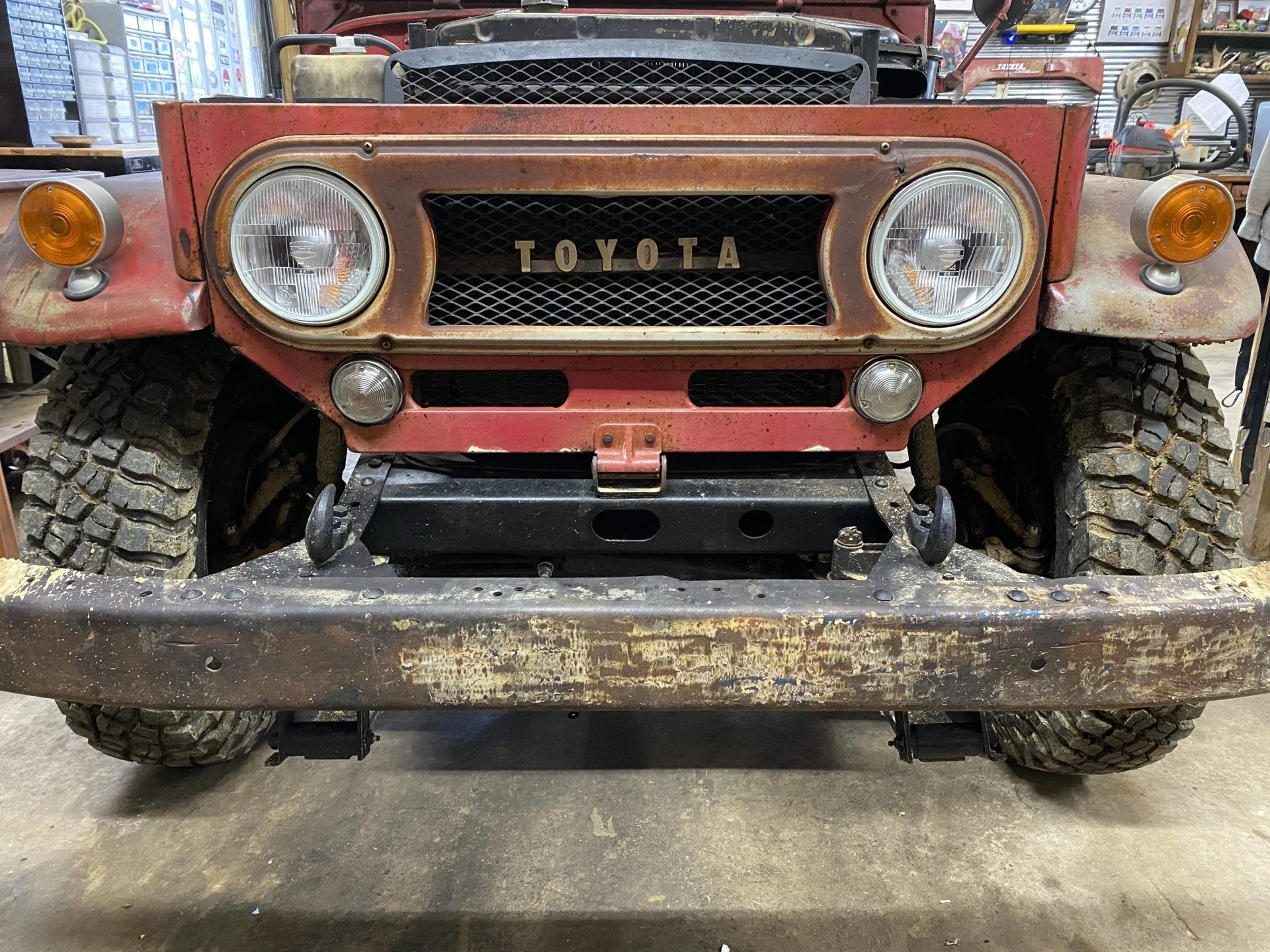

Happy re-birthday to the Goat.
Two years ago @cbmontgo and I went on a recon mission and picked this baby up.
As a birthday present I added some Koito H4 bulbs and some new bezel spacers.....drive it to the dump and all in all loved it.

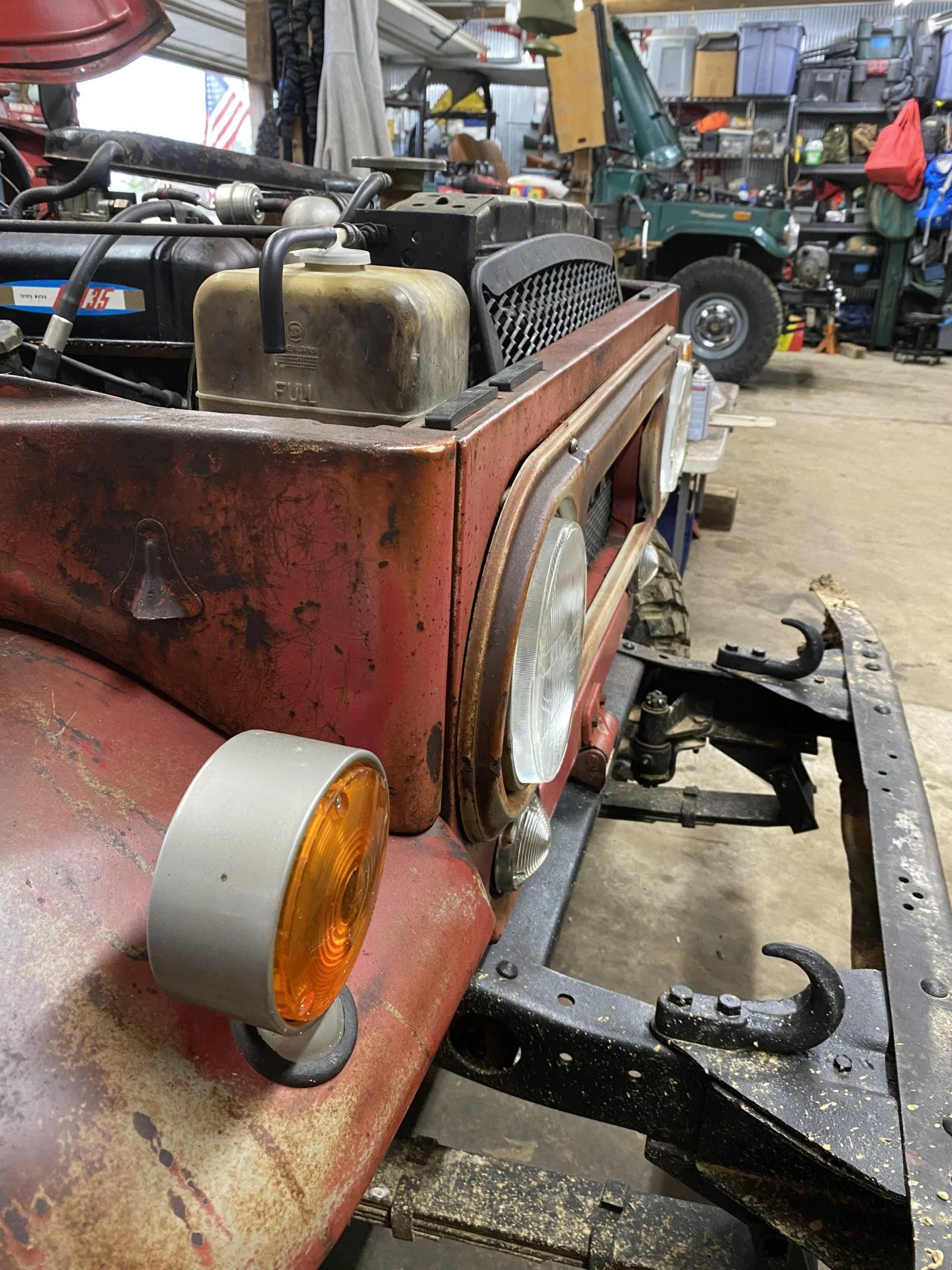

4 Wheel Disc Swap
Brakes.
F these drums. I’m about to get discs.
What’s the best NON booster setup for 4 wheel discs.
I know I’ll need the JTO firewall adapter. @JackA uses the non ABS master.
Any check valves??
My plan is Toyota front discs and CHebby rear.

I think JTO and others sell that adapter to put a dual circuit master on the firewall.
I remember trying it on my 68 and ended up putting a booster on. I won’t be doing that on the Goat. Manual all the way.
Do 4Runner calipers boot right on to a 60
Series knuckle? I have all the knuckle parts already. Sadly I have to pull a front axle out of a parts truck since this one is ball and claw.
I’m also putting in 3.70 gears while I’m
At it. This truck won’t ever be a trail machine.
