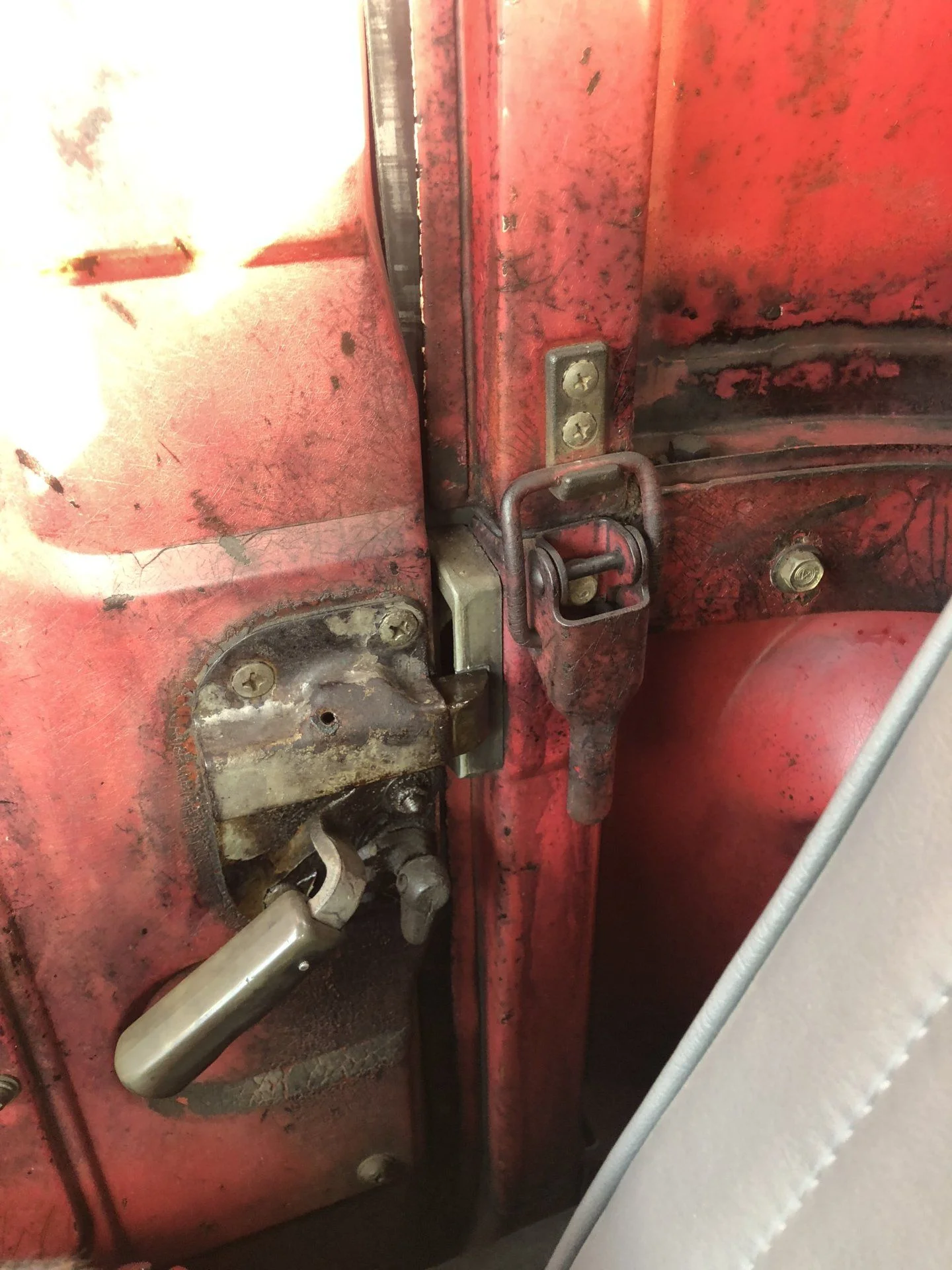

I got the other door seal on. The old Goat is nearly all sealed up now. One of my smoker windows has a bad gasket and I actually have one here. I bought 2 for Patina and almost burned the truck down trying to get it in there so I’m just going to try to ignore it. Horrible job.
