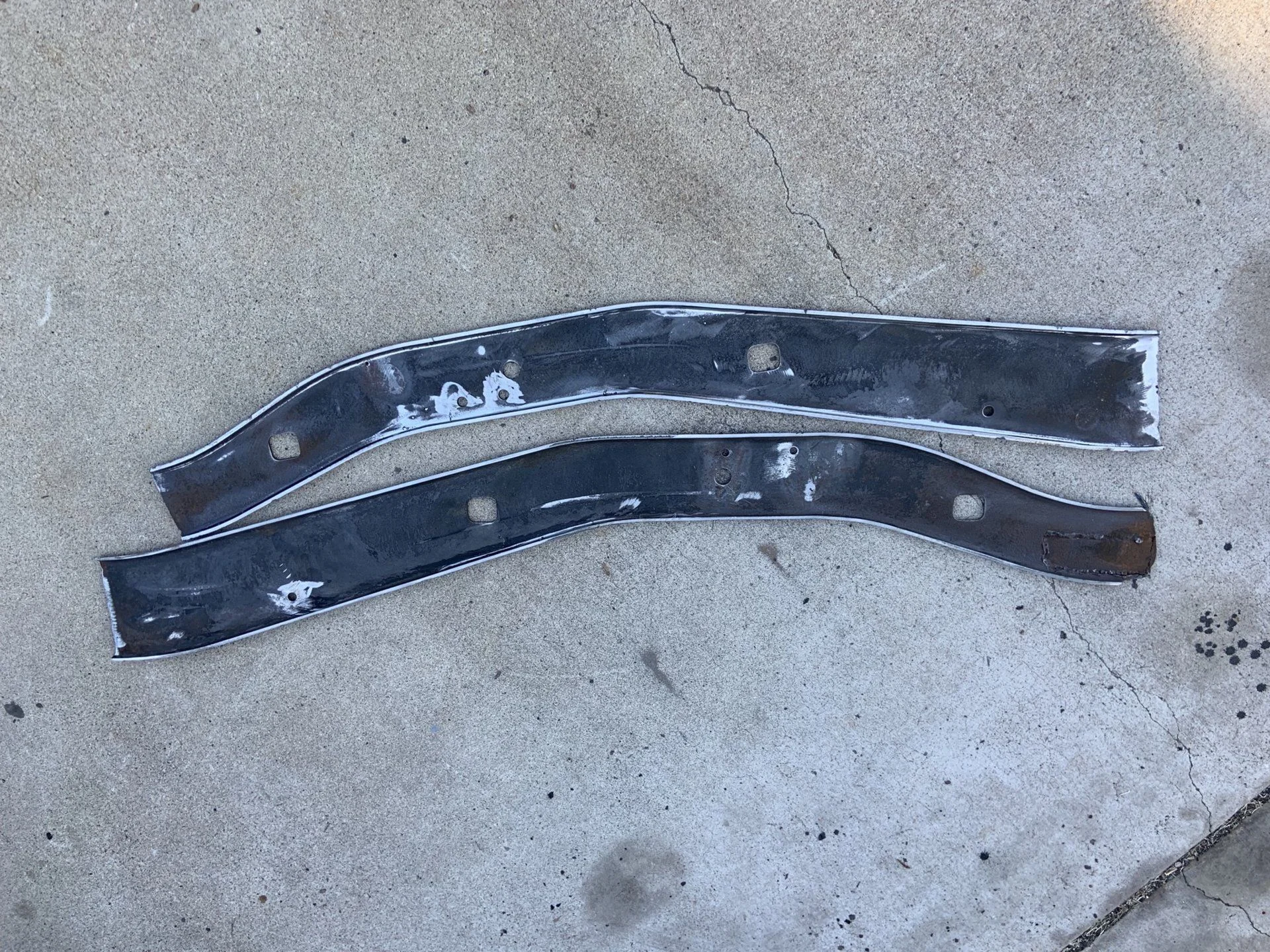

In a short break from the tub work, wanted to show some pics of what I’m planning to use to plate the inside front of the frame with. The front sections of frame were cannibalized from that 71 overseas frame I picked up back around March. The idea was/is to rip the outer plating of this frame tubing, and affix it to the inner plating of my frame.
Planning on plating from the rear of the front cross member, to just past the rear spring hanger of the front leaf spring.
This still won’t happen for a few months, just kind of staging puzzle pieces.
