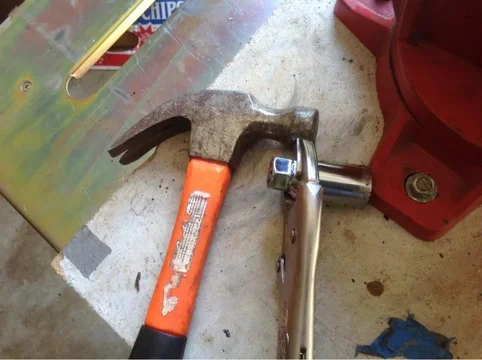

Pictured is the tool used in the twenty first century. 04371-60210 oem u-joint from Partsouq.com for 35 bucks + shipping.
