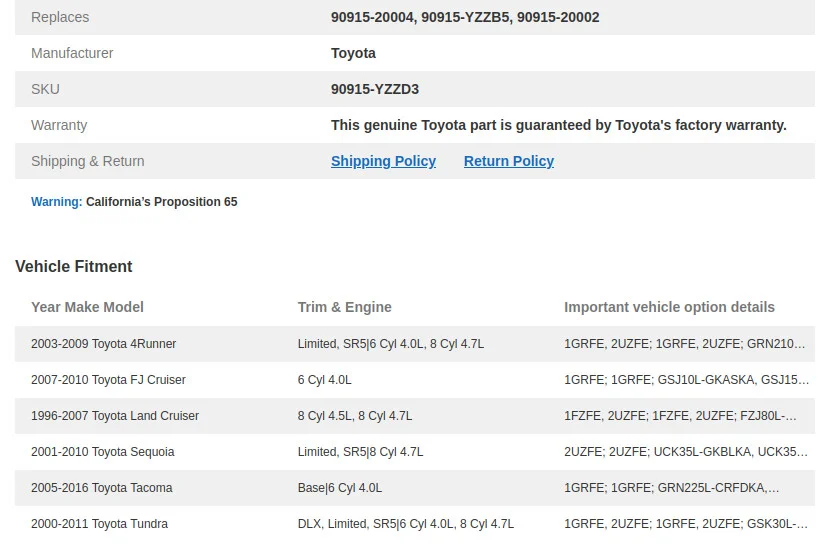

Left - not an original equipment oil filter. Denso lists no oil filter for the 2F
Right - aftermarket alternative, 25-micron filtration, it has an anti-drainback valve (unlike the AC Delco one I once used)

The YZ filter packs a high volume of filter material in that little can, and has a high quality anti-drain back valve which is really important at startup specially for any of us that drive our 40’s periodically. No issues for me with higher viscosity oil and that filter.
Word of caution from the 80 Section regarding Napa Gold/WIX filters, there are a number of dead 1FZ-FE motors using these filters due to anti-drain back valve failures that resulted in oil starvation. I ditched them a while back after hearing the woes from those owners.
I'd not expect issues with the Denso YZZD3, or any other filter, again the thread is about the best filter. The pressure relief valve should have a sensor to indicate when the filter is bypassed, if you are judging the performance merit of any set-up. The pressure relief valve, on all but the NAPA / WIX is at the other end of the filter, not where oil enters the can, but on the other side. That means that unfiltered oil will pass by the dirty side of the pleats of the filter, to the top of the filter (as installed on a 2F) where it is released back into the motor via the pressure relief valve. Maybe that is why the NAPA / Wix filter is ahead, in terms of design, as the pressure-relief valve is integral to the anti-backflow valve - it doesn't purge the filter-media of particulate when the pressure from the pump is greater than what can be worked thru the downstream oil galleries?
