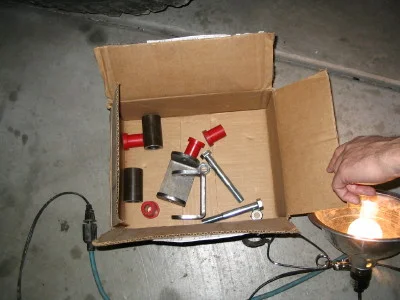

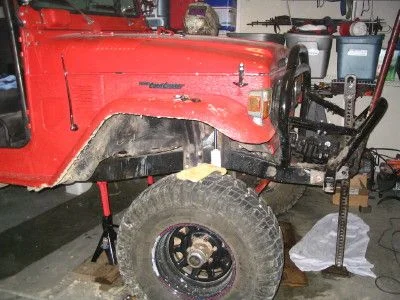

so i will post pics and briefly comment on each one.
first open box and look at parts

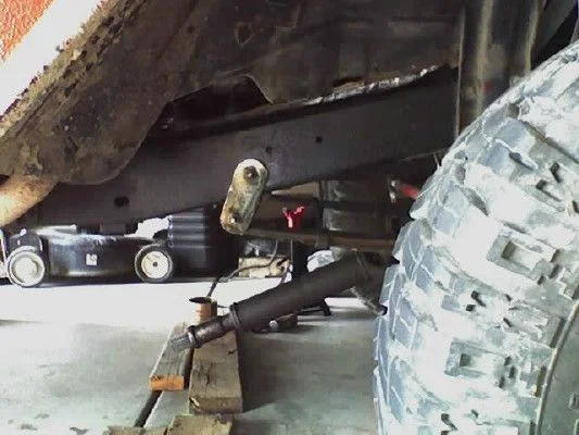

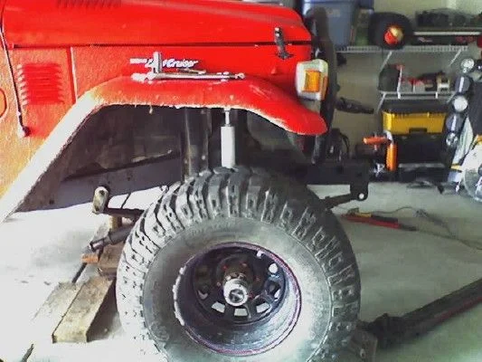

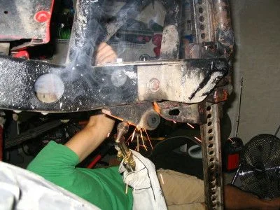

remove springs
then torch off the hangers

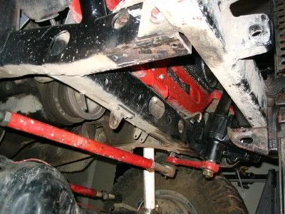

the only problem i ran into was th saginaw box was in the way of the driver side, some creativity and i got it off
the rear hangers came off super easy no problems there

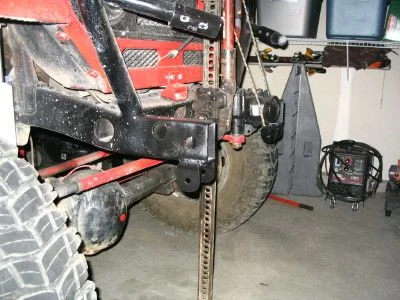

heres how it sits as of today, ran out of time last night and will be back at it tonight, i plan on getting the front hangers on and the holes drilled in the frame for the sleeve in the rear for the shackle.
i will be flipping the springs for extra wheel base.

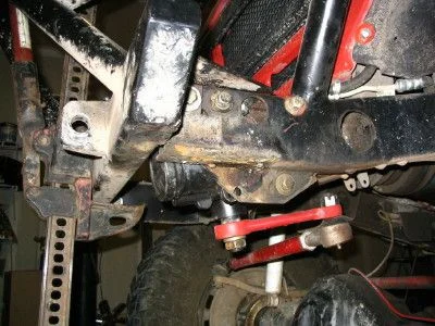

okay got some more work done,

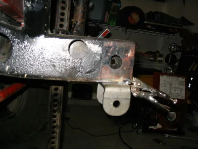

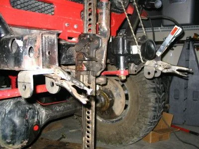

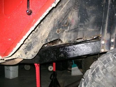

cleaned the area with a grinder to get good welds and tacked the hangers into place
once tacked remeasured to make sure things are right were i wanted them, then layed down some welds to permanantley attach them

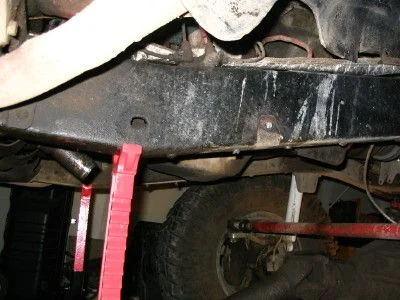

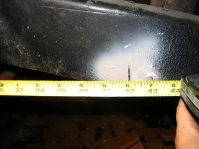

after welding the front spring hangers on i then measured 42 inches back from the middle of the spring hangers to the frame (as per proffitscruisers instrictions) and marked.

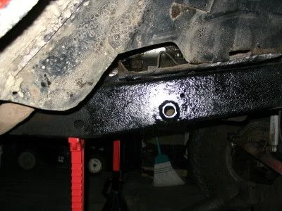

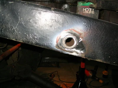

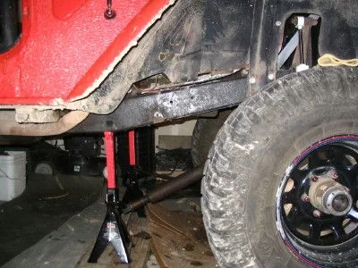

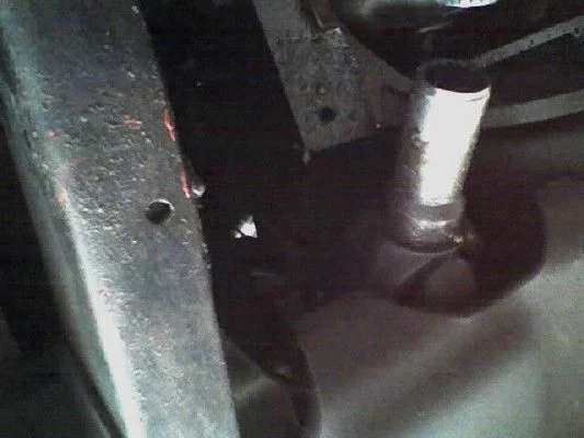

busted out the hole saw (1 1/2 inch) and drilled away. making sure that my holes were straight i drilled through the fram on both sides.

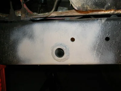

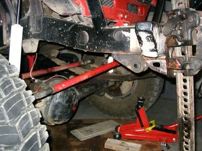

then inserted the supplied sleeve through the frame and welded it into place. hit it with some primer,
painted hangers and sleeves, next step put it all back together,
2badfjs said:
besides a hole saw, how did you make sure the hole in the frame is true?
was it just measuring on the inside of the frame rail like the outside?
nice work by the way :beer:
jim
thanks
yes,
and when i put the sleeve in i hung a level, and a shackle made sure it was all square.
