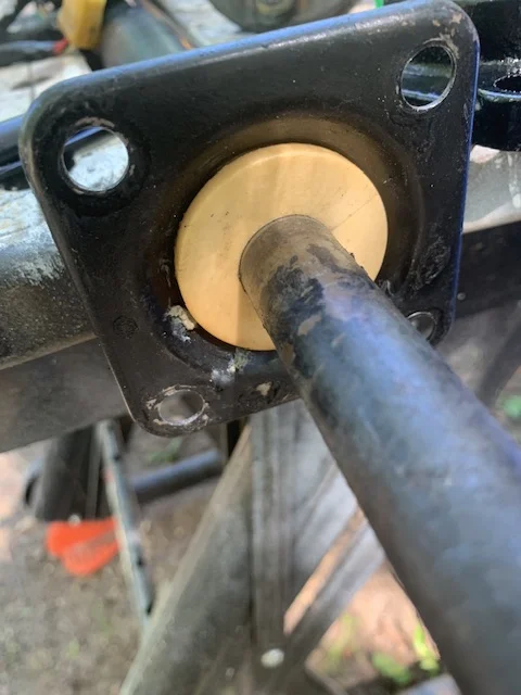

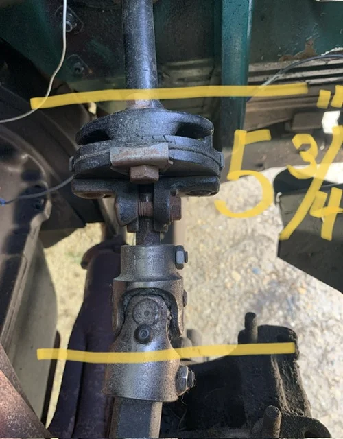

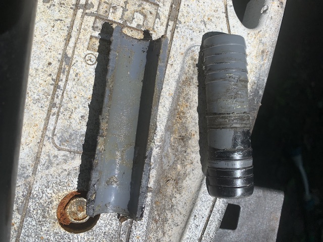

My power steering conversion was barely acceptable and had a few shorts cuts made during the conversion..simple corrections but not the kind of thing I would do had I done this. The spacer in the steering column was a 3/4” sprinkler hose barb split in two to fill the column gap. The entire shaft shook loosely and the radiator strut was rubbing the steering shaft to the gearbox….the guys here on mud told me to swap the shaft was well with a collapsing shaft to eliminate the ‘spear” potential in crash…did that too
Regardless, I enjoyed the ease of steering the vehicle at slower speeds but above 30mph, it’s a thrill ride. At my age , 60% of my drive is NJ paved highways and here in NJ, if you’re not doing 65, they’ll run you over. @Jdc1 took the system apart, reconfigured the drag link and the pitman arm and coupled with the 4* caster shims… my steering a AS GOOD AS my Chevy Silverado… I can’t tell you how much I love the way it tracks. My steering wheel is dead centered and does not drift where it requires light adjustments to keep it straight when driving. If you watch some BAT auction videos you can see several FJ40’s requiring light adjustments to the steering wheel positions while driving a straight line.
