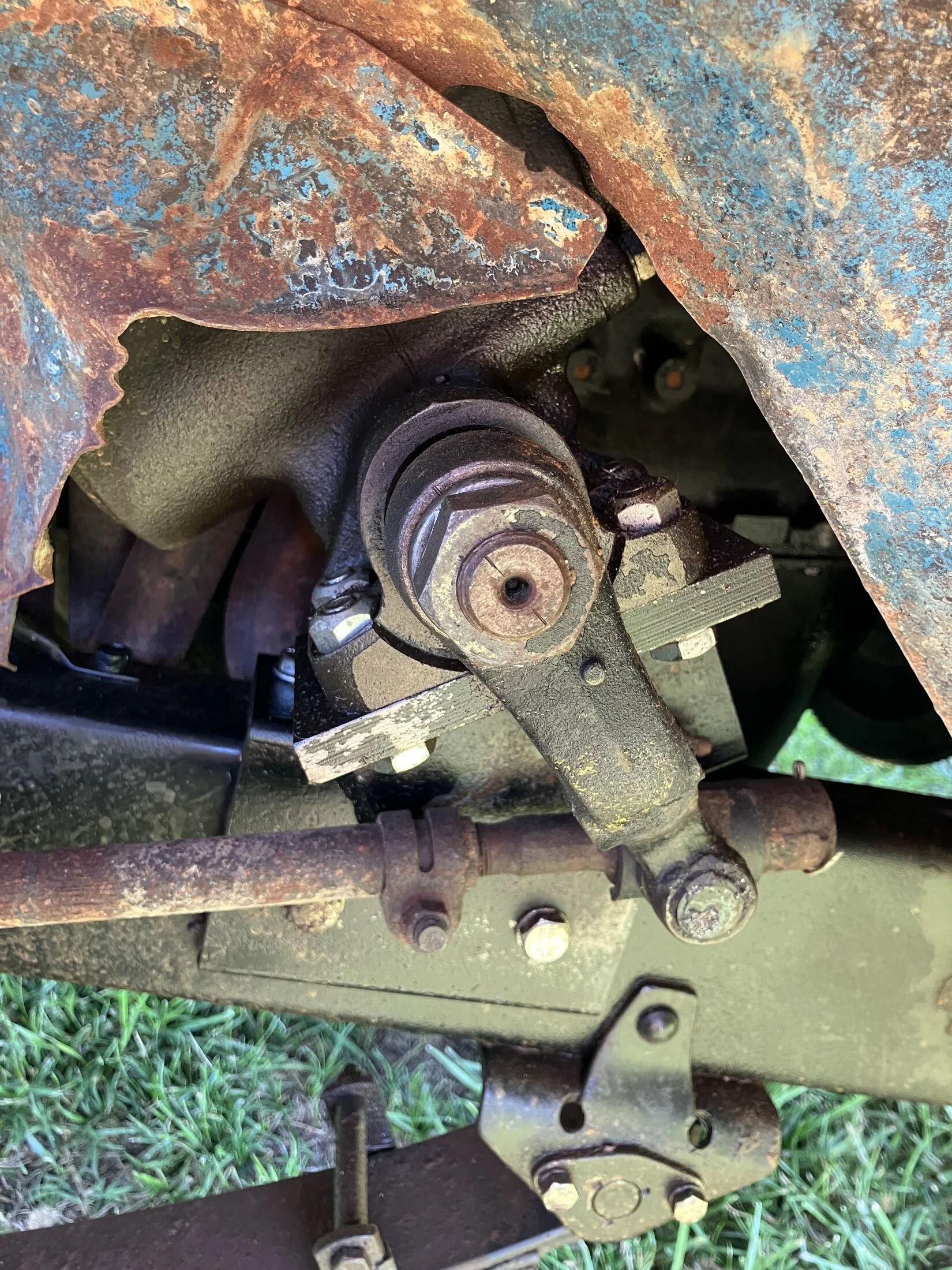

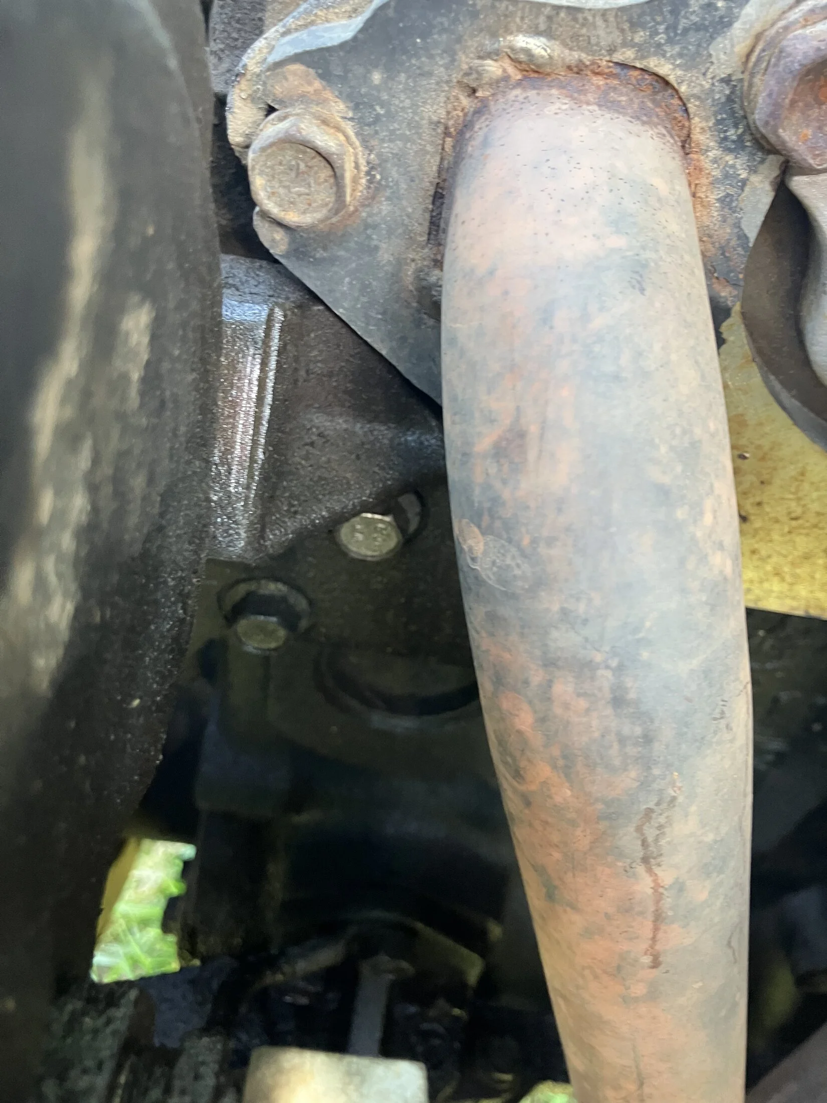

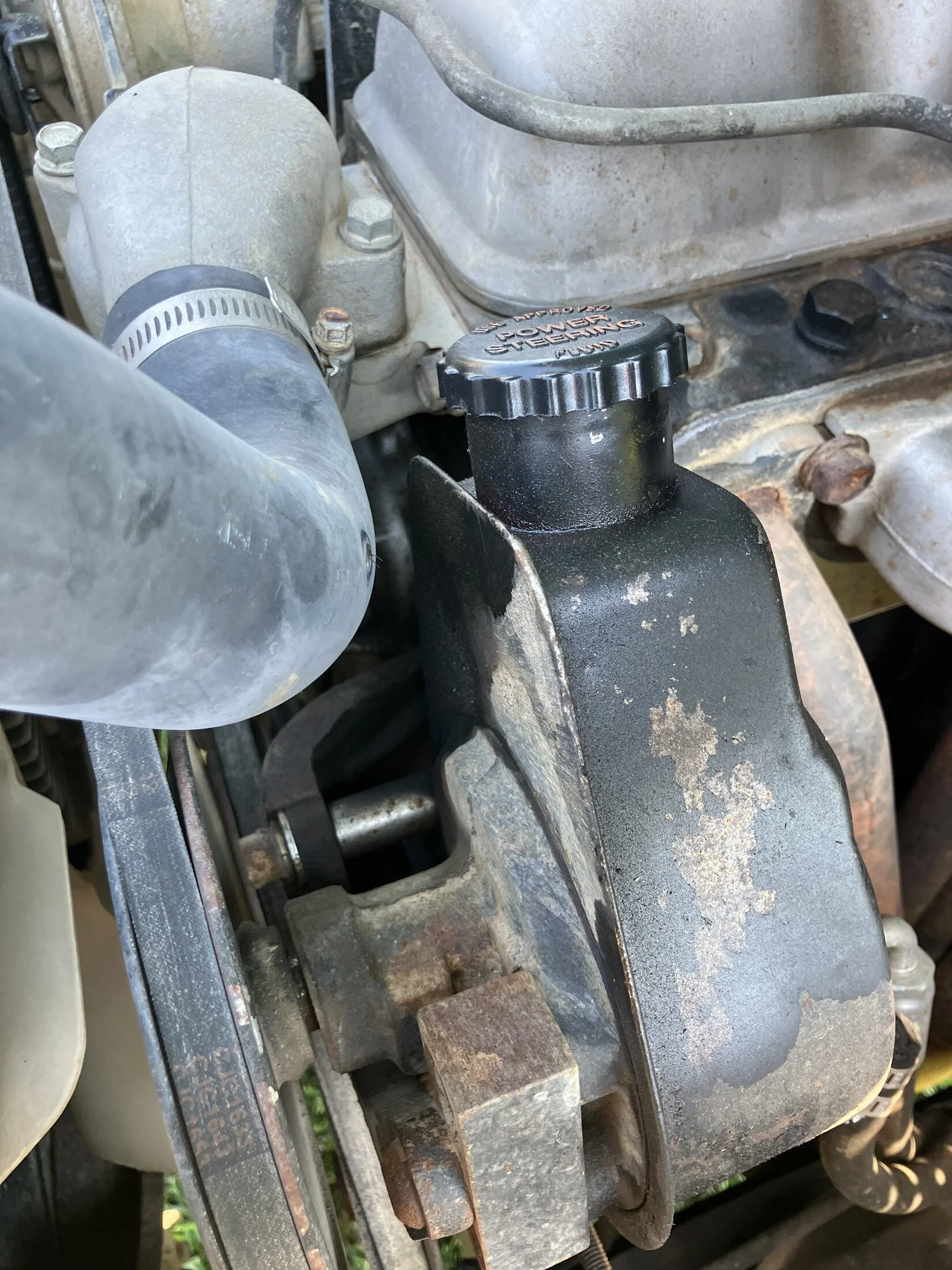

Which power steering conversion kit did you go with? Where / how did you mount the pump? I have a '71 (build date Dec '70) FJ40 and will be using a '78 2F which does not have a factory pump mount location.
Good point on the lights regarding the snow. I had not even thought about that. But now that I'm retired and in Florida, if it snows here then I will know that Hell has frozen over! :eek:
Mini truck. all I had to do was replace the PS mount on the frame with a mini truck box mount I would suggest having it rebuilt by west texas off road before you install as the ones out there probably are work and have shafts that will need some attention to clean them up and seal right.if you have a 78 block the PS mount should bolt right up on the left side.
