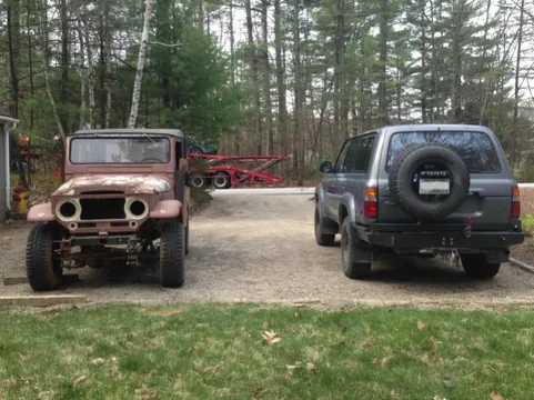

I had to give this thread a catchy name since everybody else does! That and because a few people laughed that I took a rust free Cali Cruiser and shipped it to NH.
Well, she arrived today! I wish they all could be California Cruisers! This thing is as rust free as they get (and will stay that way despite its new home!) She'll be getting a frame-off, nut and bolt restoration. I have another 1962 that will be cannibalized for parts due to its rusty tub and frame (blue one below).

I do not see blue one below...
How is the original paint under that primer?
The 'Cruiser Goddesses smile more on original color...

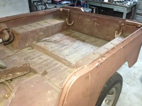

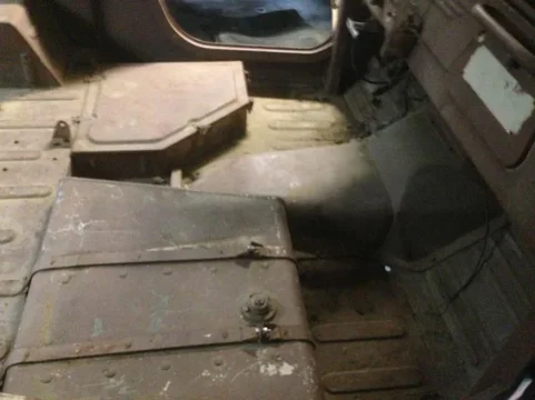

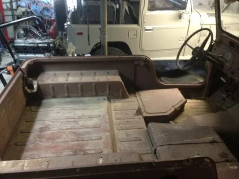

The paint under the primer looks decent in most areas. The hood is all sun burnt with fading and very light surface rust.
It looks like the inner fenders, firewall, frame/chassis, and bottom of the tub were all painted black from the factory on these early models. Was it a semi-gloss or gloss black that they used?

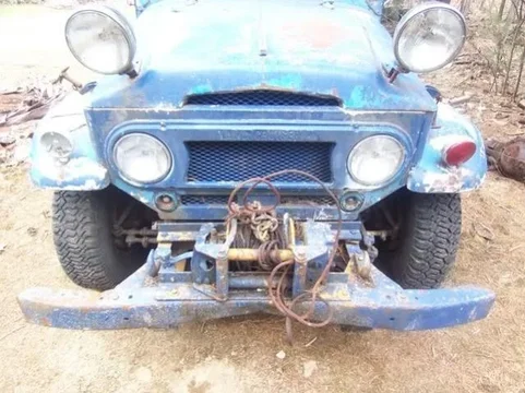

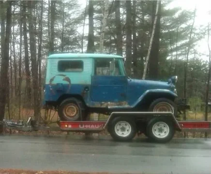

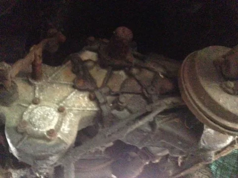

Curious did the blue hard top have the original transmission and transfer case? Only seen a few original equipped PTO winch early FJ40s surface and all have been hard tops.How about a few pictures of how the later FJ40 soft top fits around the B pillar bow. I currently have a old black Kayline top on one of my FJ25s and it is short of reaching the B pillar bow. Wonder if the PO owner of your new cruiser figured anything out.
Semi-gloss
Cool project BTW!

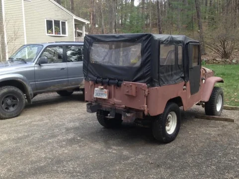

The soft top fits like yours does. No modifications were made to make it work. There was a 4" gap at the b pillar. It really looks like an easy enough fix for an upholstery shop to add a few inches of material there, but I'm going to sell this one (here comes the PM's) to help fund the project and will have a canvas top made.
Looks like the original drivetrain to me. It's weird that Toyota only seemed to put the pintle hooks on the FST models and the winches on the hard top models. You'd think that you would get both in a package.

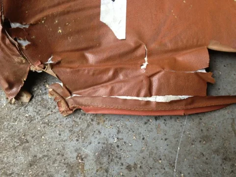

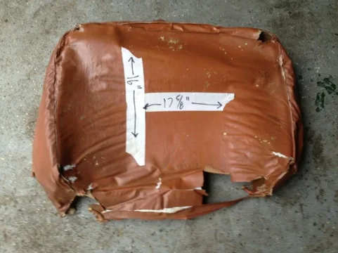

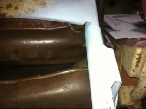

I'm going to bring these old covers down to my upholstery guy this week, but there seems to be a piece missing. Can anybody provide a picture and possibly a measurement of the missing piece along the bottom seam? You can see the clean strip of material where there must have been a small strip sewn in. This is the drivers side seat back.
not much is missing...the corner is open
I can see how the corner went together, but the way the bottom thread is stitched makes it look as though another panel of vinyl was attached. Can you fold down that seat and post a pic of how it looks at the bottom edge of the vinyl?
you'll have to see if treeroot can now...i took the covers off when we got annie redone and gave him the cushions for his 25
Shot some pics for you bit i'm affraid it doesn't really help you. BTW this isnt the factory upholstory but might be Toyota.
The rear part stops where part which bolts to the frame begins. If you need the size I can take measures for you.
