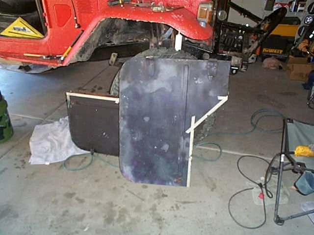

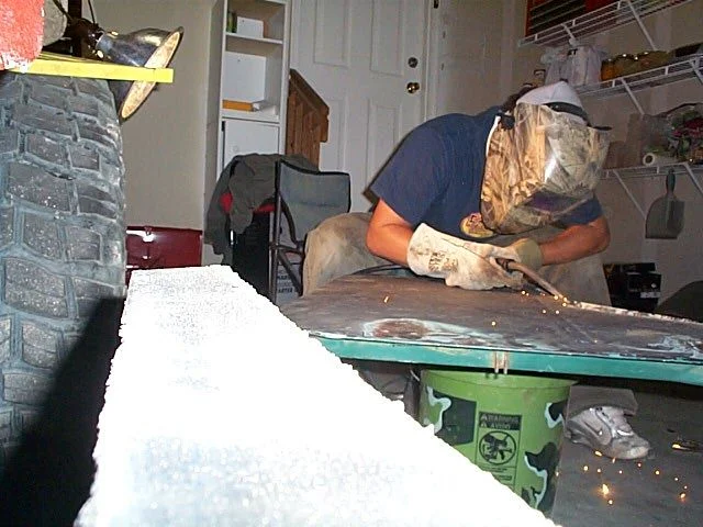

okay so i got bored waiting for my driveshaft to come back from high angle,
so i decided it was time to make some half doors for the summer.

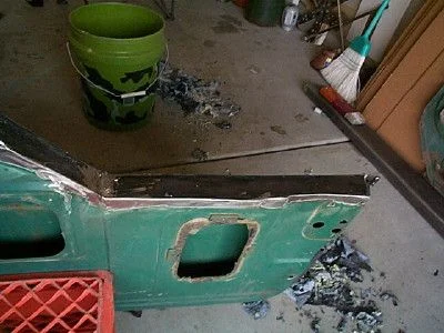

started with some donor doors, came off a 72, i installed them and figured where i would likethe cuts to be,
marked them and hacked away.

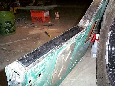

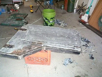

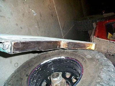

next i cleaned up the cuts ,made by the cut off wheel. then went to the local metal shop and got two 2 x 36 inch stips to cap the doors

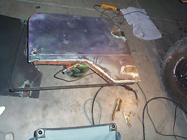

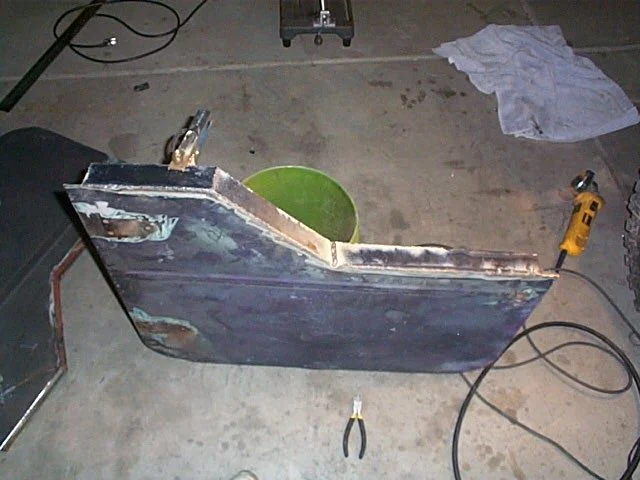

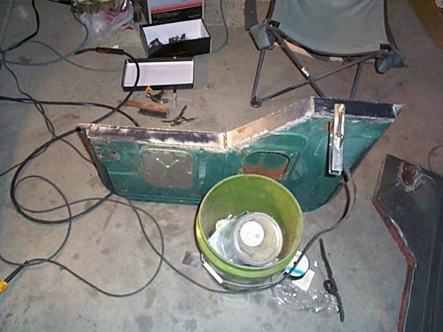

lined the strip up and start the task of welding them on.
this took a while but eventually got the doors all welded up.

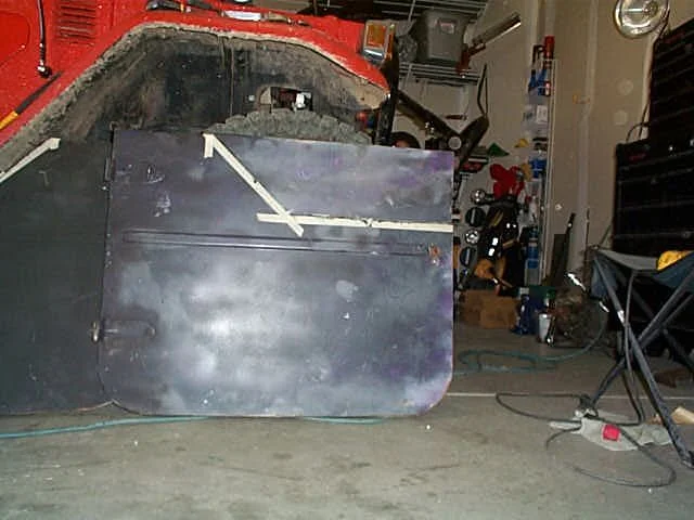

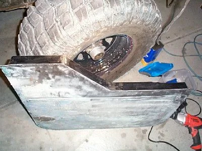

some in action photos, thanks to self timer.

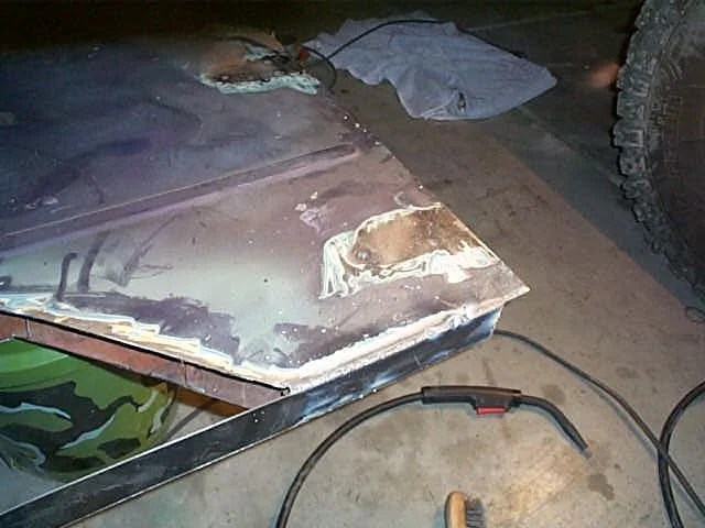

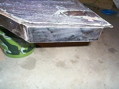

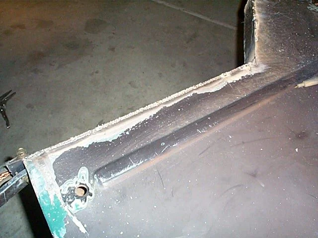

some close ups,
tonight ill bust out the grinder and sander and get the edges to the way i want them then ill primer.
ill get some photos of that up in the morning.

so did you cut out the section where the interior panel has those bends and then weld? or did you just leave the overlap, weld, and then grind off the excess?
i'm wondering this, lookin at this pic:
your whole write-up looks really similar to when i did mine, ha ha...i've got pics on my computer somewhere.
do you have any ideas for a nice finished edge?
for the early style doors, i don't really know how you could efficiently get away from that 90deg edge...
i've been thinkin abt it and am goin to try out some stuff in a month or so hopefully

for the overlap im just going to grind thm down to match the curves on the door.
youll see tonight the smooth finish. just made sure i had enough weld to grind down.

yes these doors are a little tricky, not being straight and all. heres some more pics of the finished metal work.

a few more
you can see im in the process of stripping the doors, preping for the paint and hurculiner
