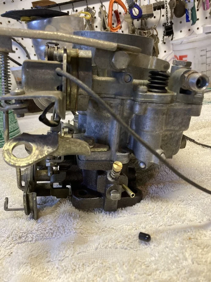

Happy to report, I finally got this back with the new vac port and a larger idle jet. Hoping I will be back driving again soon. :cool:

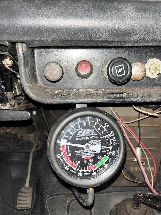

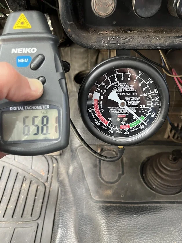

After some initial disappointment with my most recent carb adjustments, I was able to reach what I believe is the holy grail. A fully functioning carburetor. :p Weekend started with a super fun visit to the PPF w/ Dale, his bro and Pigeaten. Picked up a front seat (rear seat to follow) Heard some funny stories too. Eggs and Oranges and Mountain Lions oh my. 🤣
Today had the time to tinker with the carb again. Current issue was a tight accelerator cable causing high idle and fuel coming from the wrong(primary) port. Once that was corrected, I added some heavy bearing grease to the throttle shaft to see if that would help w to increase vac, which it did but the real reason was I had a installed a bigger idle jet (from a 50 to a 65). This was the result! I also found a spot for a fog light toggle switch. I'm am digging having the harbor freight vac gauge in the cab too... Ran outta day light so will have to finish that next week but overall, a great end to a spectacular weekend.

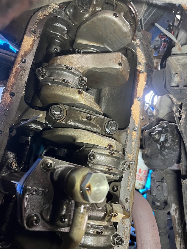

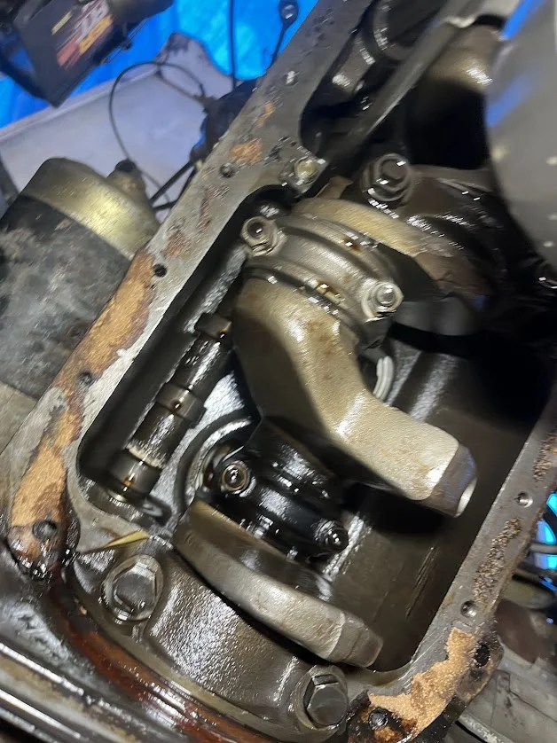

Finally got the oil pan off for inspection. Nothing looks too bad. I guess the next step is to undo the bearing caps and check for spun bearings? Hoping to identify the cause too. No clue on how to do that:confused: I am assuming I can change the rear main w/o taking the engine out too, at least I've read you can on a 60.
