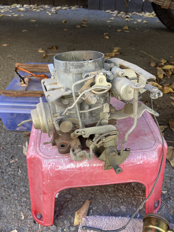

Got it running after replacng the fuel lines/hand cranking it/marvels mystery oil etc. and letting the fuel pump , pump out the old gas. Used a gas can w fresh gas/new filter to get it running but not idling that well. So rather than chase a potential vaccum leak other related carb issues and knowing that I'll end up having to rebuild the carb and remove the tank, I went ahead and removed both and plan on having the carb rebuilt and the tank boiled and sealed for starters. I picked up a MIkes carb rebuild kit but i'd rather have someone else take on that job although looks fairly simple (orig Aisan 2brl) I'd rather have someone do it right the 1st time... the tank vent hoses are usable but the ends where they were removed are toast so, I might need to replace a few. Am sure I'll have tons of quetions as I progress into these repairs. It Seems there is some really solid advice given on Ih8 forum(s) but finding it may be a challenge. Super stoked on finally finding one of these ol pigs!

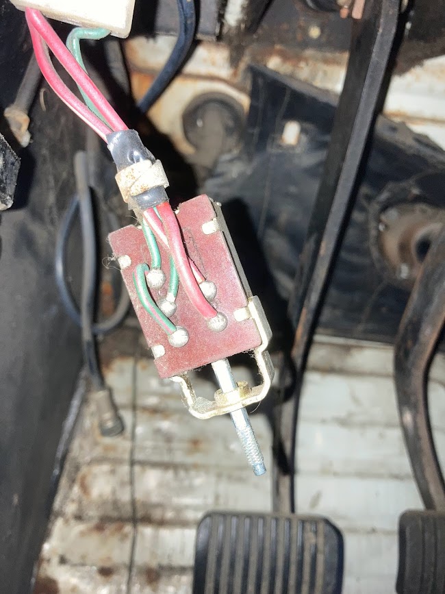

While I am waiting to have the carb and tank repaired thought I would dive into the electrical stuff.:oops:. for starters, I sanded the fuse block and replaced all the fuses. The dome light has power and the headlight come on but none of the running lights, dash lights or interior lights come on. I backed out the light switch , disconnected it and found only one of the red wires shows power but none of the other leads have power coming to them. My initial question is how can I chase down the source of why the power is not reaching the other red wire to the switch. maybe only one red is intended to have power and it's the switch? Any ideas?
