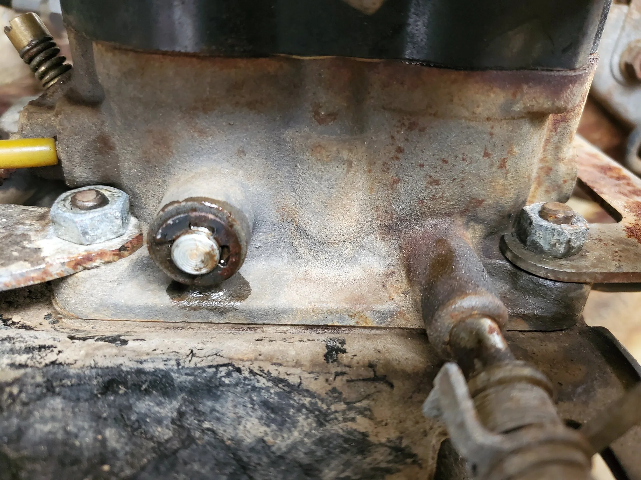

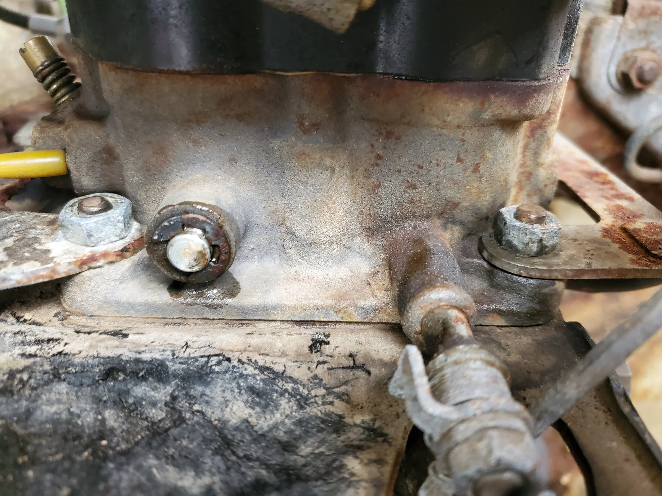

my leak is on the opposite side of where the linkage is on the right.

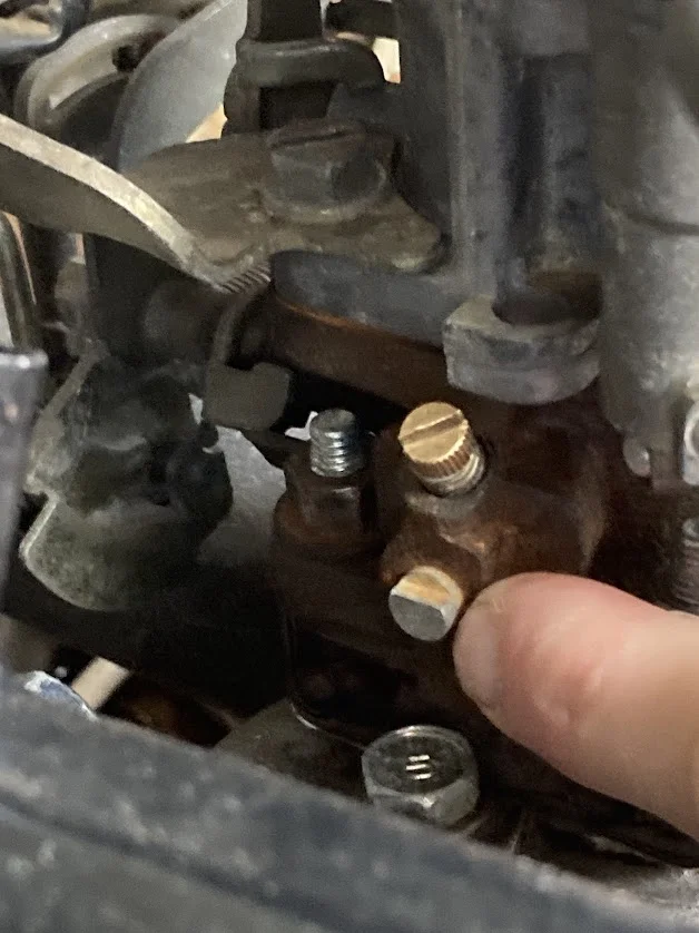

I'm thinking "NO". That plug looks to be to plug the passageway drilled for the mixture screw. The ported vacuum source you want has to be drilled in a very specific place at a very specific angle. Mark A. can do that.Is there a vac tube avail that I can attached myself to this hole above the mixture for my to be installed vac advance dizzy? Looks like it might be threaded in?
ok. Is that skinny hose your dizzy vac port?I'm thinking "NO". That plug looks to be to plug the passageway drilled for the mixture screw. The ported vacuum source you want has to be drilled in a very specific place at a very specific angle. Mark A. can do that.
Yup.ok. Is that skinny hose your dizzy vac port?
Have you hit the opening where the shaft passes through with some carb cleaner? Does it make a noticeable change?Decent advise. So, I took the air cleaner off and thought I would see if I could get a bit more granular in where the vac leak is coming from and it looks to me, the leak is not in fact the insulator but the back of the throttle linkage shaft is where the leak is and I've read that there are not bearings or sleeves avail to correct this or is there? Thoughts?

Yes, the link above to the video shows it but the sound didnt translate that great but, there is a noticeable increase in RPMs aka a leak.Have you hit the opening where the shaft passes through with some carb cleaner? Does it make a noticeable change?
