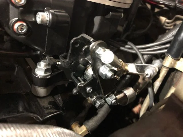

Here are pics as requested of the Holley Sniper bracket and lever extension. You will see I had to angle the bracket allowing the trotttle cable to clear the booster. I considered the Lokar bracket referenced above. Wonder if it would mount more square or allow easier clearance from the booster?
Thanks for the pics. Do you think it'll be a problem down the road with the cable hitting the edge where it exits the tube/sleeve/end? It looks like a wear point...

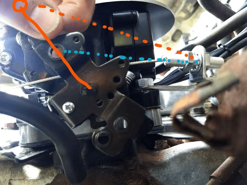

Is the solid orange line about what the extension bracket does? (this image from this thread)

Yes, the red dotted line would represent the angle of attack on my setup. I did have binding without using the spring that came with the 4001 Hollley bracket. Once I installed the spring that came with the bracket, throttle worked great. My first setup had the bracket on the front of the Holley attaching the cable to the bottom hole on the Sniper linkage. Throttle response was way too snappy especially from a stop. I then installed the 4001 bracket with the cable going in the hole shown with your blue line. Made a noticeable improvement. When I installed the Holley extension lever ($12), I got an even better throttle response. Softer, more controllable off the bottom and becomes more progressive mid to top.
