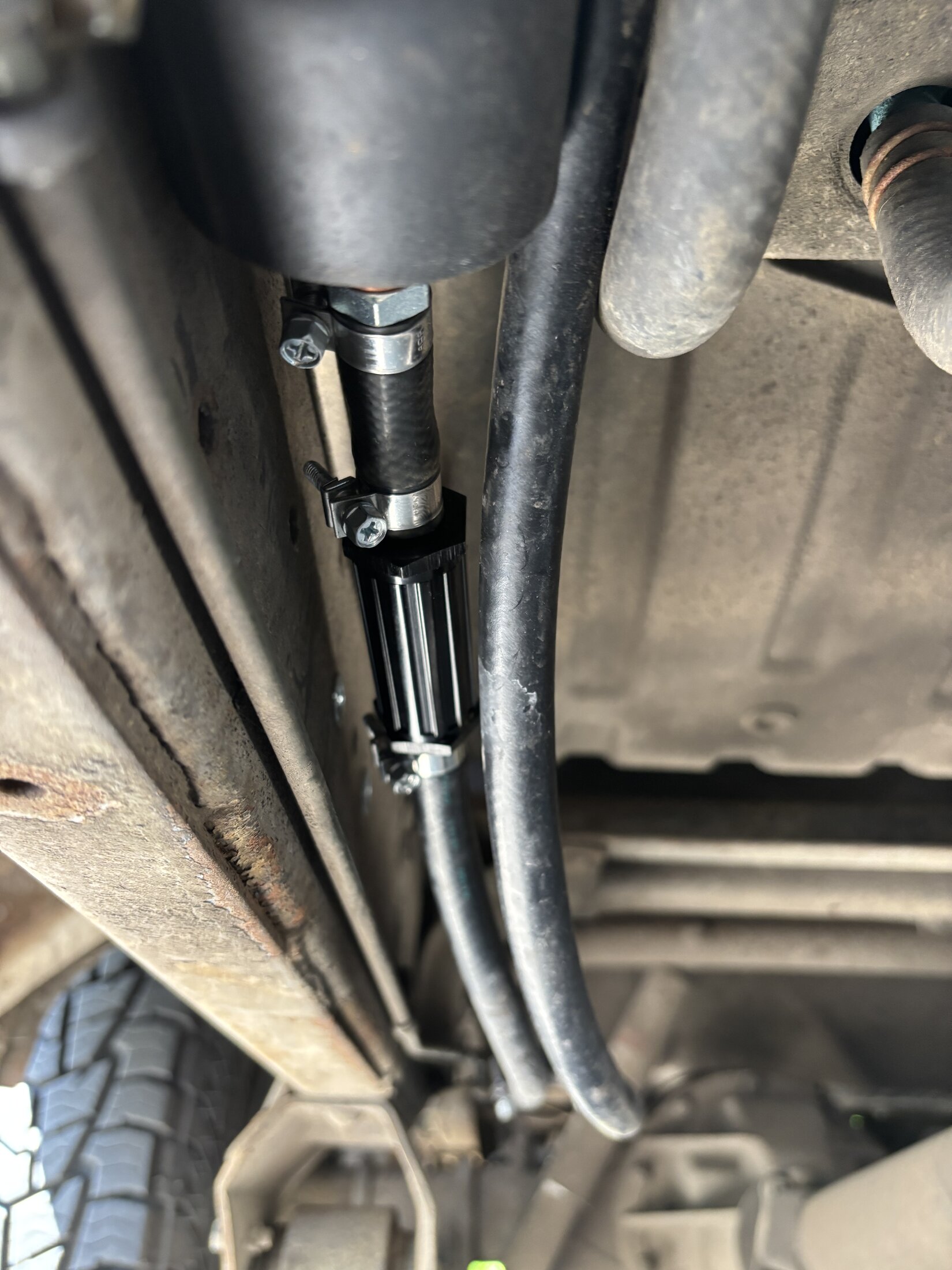

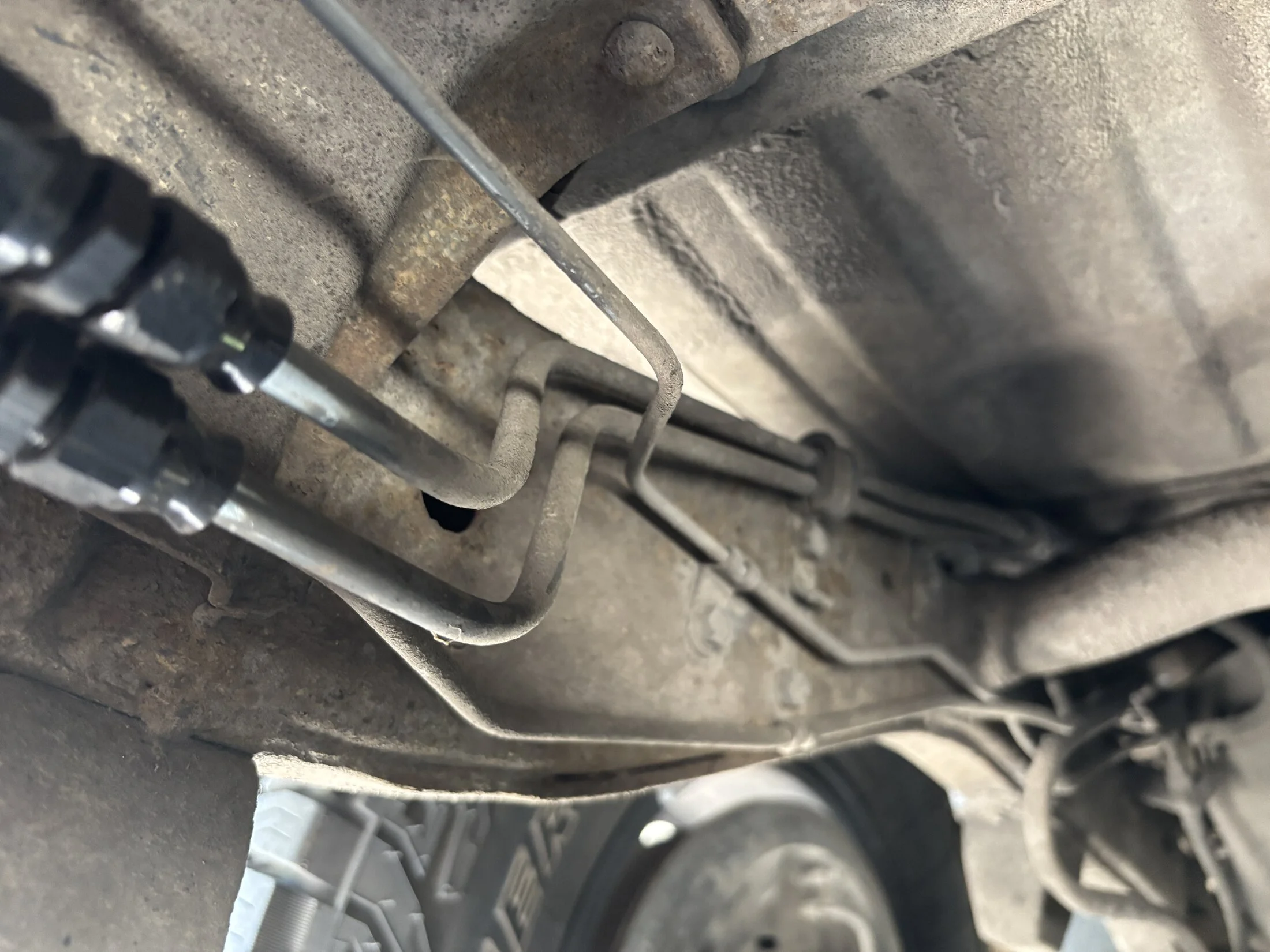

For my part It's installed correctly close to and below the fuel tank on the frame rails with a corvette type regulator, bottom fuel line feed top fuel line return.
Holley wants me to get a fuel pressure gauge inside my vehicle which is either very expensive or not safe/recommended. They also want me to drop the tank, they think the return is oxygenating the fuel and thereby creating this event.

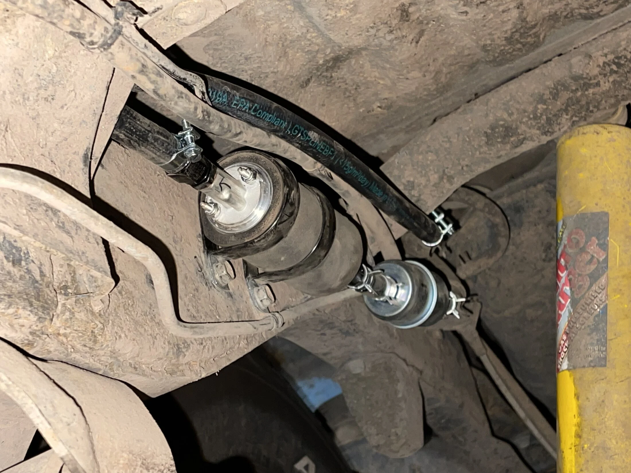

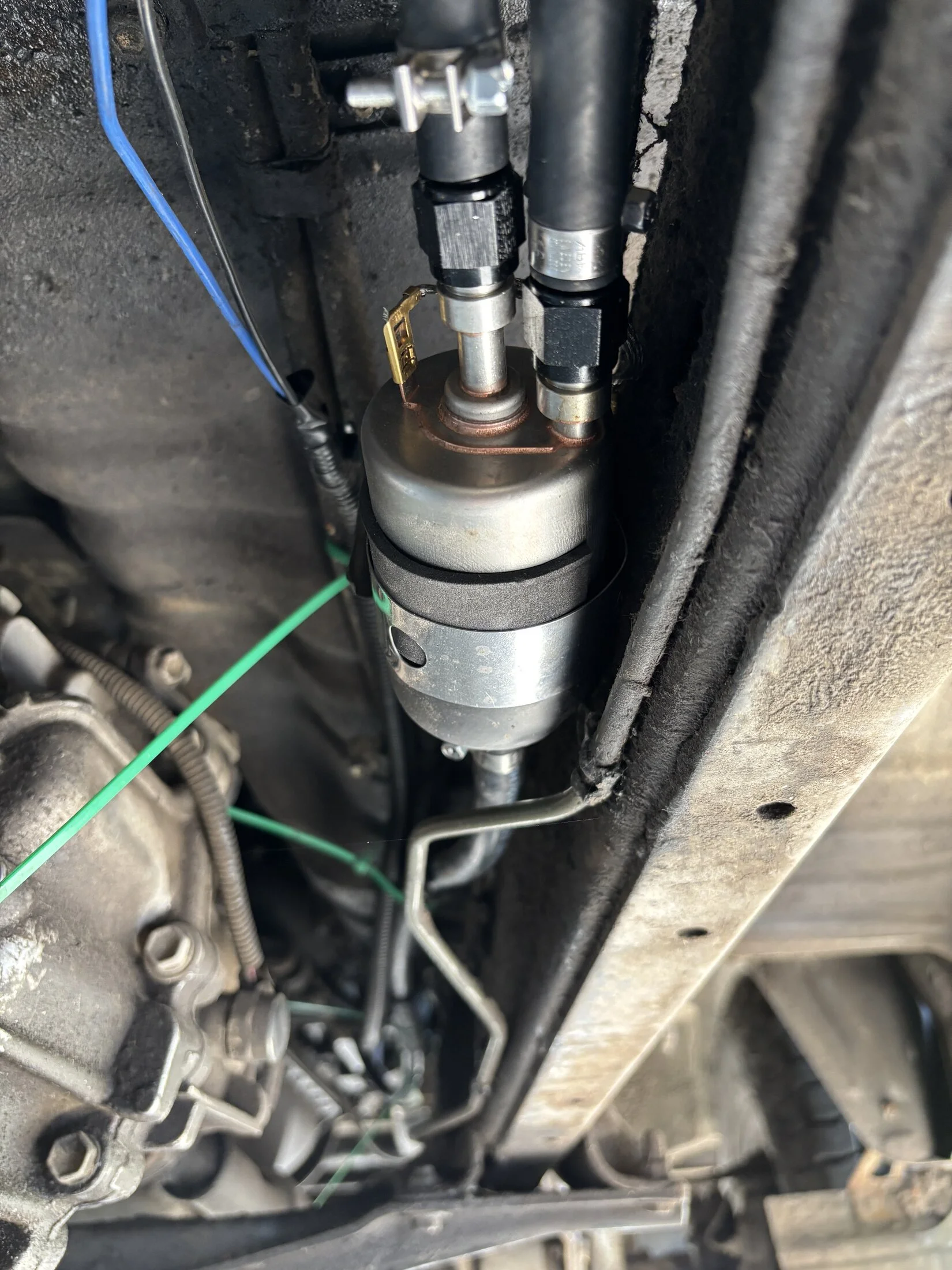

Thanks. Here's some pictures of the filters pump exc.

If you are not getting any fuel, I'd look at the pump and filter mounting. Being on its side you can get a big gas bubble on top and at high fuel flows you could be pumping some gas instead of liquid fuel which would cause issues. I'd try mounting the pump and filter so they are vertical thus self venting.

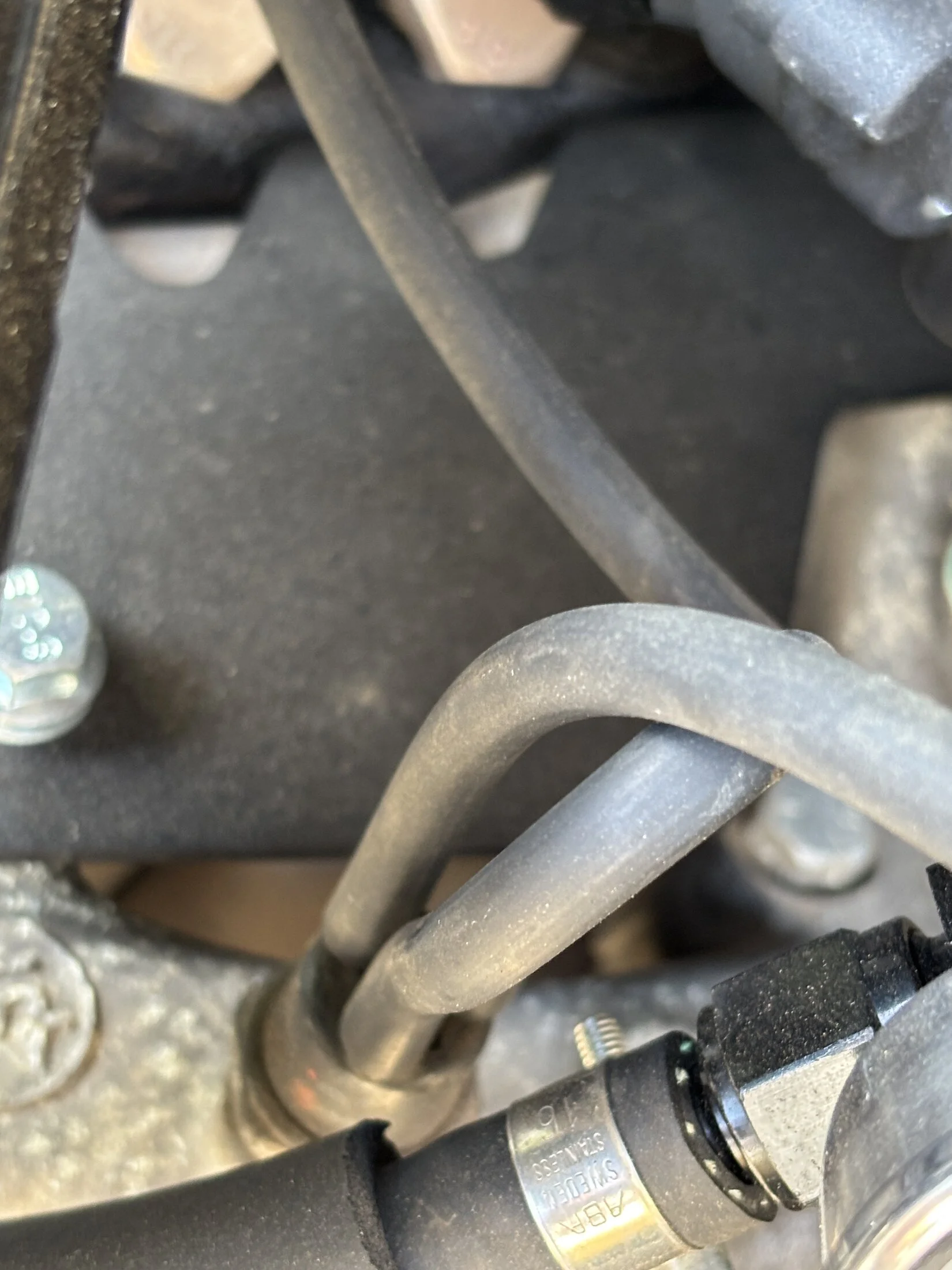

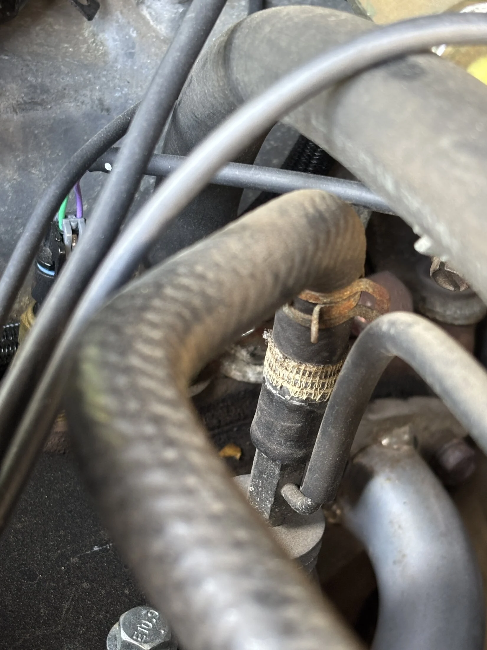

My rig is and 85 fj60 and it is desmogged. I'll put a vacuum gauge on it and see what it reads. Just out of curiosity where does one read manifold vacuum on an fj60?
Seems like it is spraying too much to me as well so I should look into that. My main problem is it not spraying enough under load and with the butterflies opened past the idle circuit.
its making 19 on the vacuum gauge. Looks like two sources of manifold vacuum are attached to each other. Seems like they should have just capped it all. Anyhow, the vacuum seems fine, doesn't look like there are any leaks...amazingly.

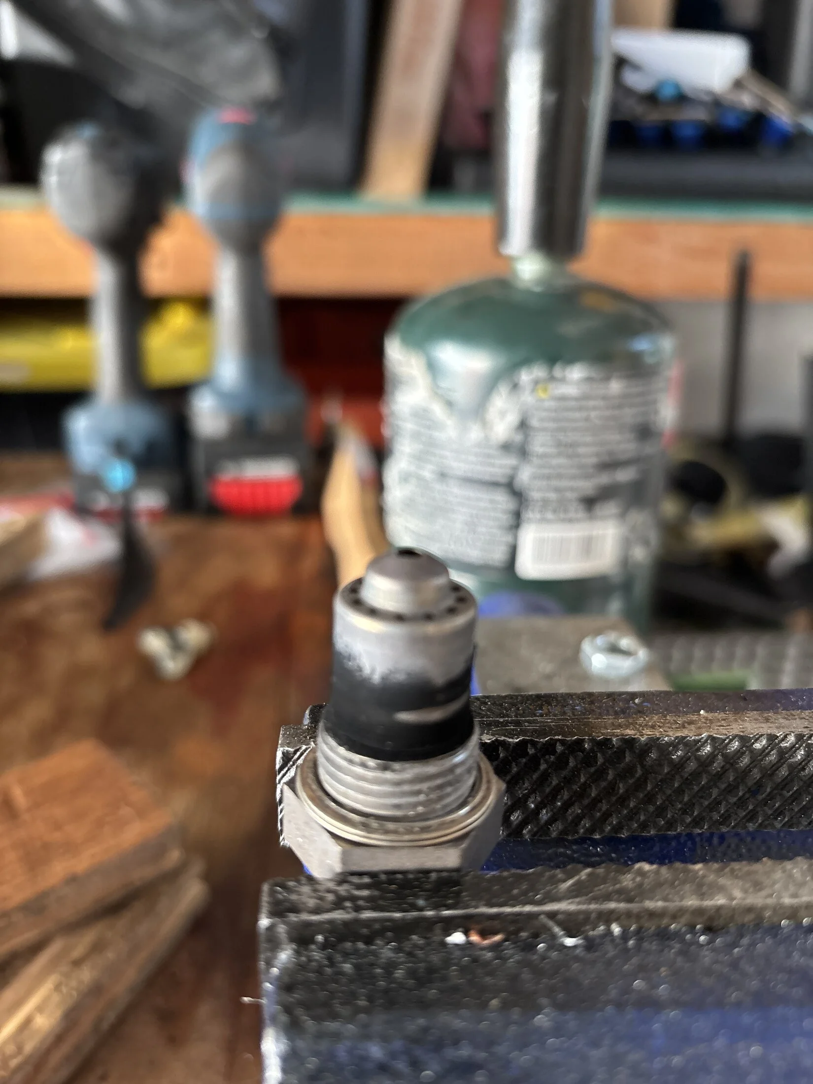

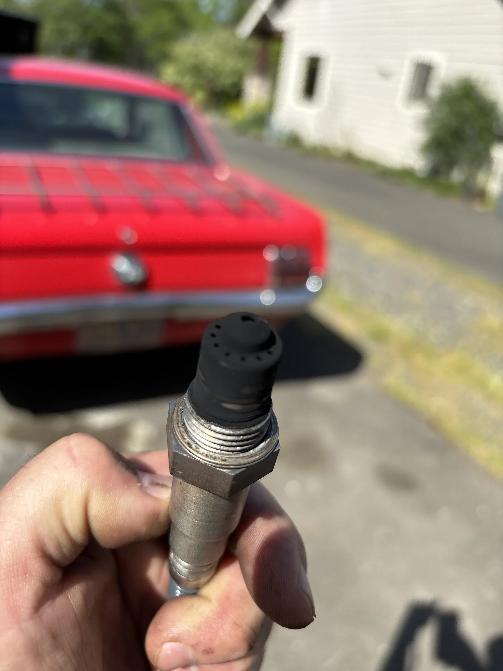

further prompted by your question I pulled a plug and it's fouled, chances are the O2 sensor is fouled as well. If that's the case one or both of the collectors for my headers must be leaking. Funny thing is there are no signs of an exhaust leak. There's no backfiring using the engine as a break down hill none of that...except I have fouled plugs so it's giving me too much fuel.
If your AFR is reading at >35AFR your 02 sensor is either dirty or nuked.
I have a sniper on my 40 and it goes through 02 sensors. I installed a heat sink spacer and that semi-helped.
Id bet that if you take out the O2 sensor its covered in carbon.
It will be covered in carbon because the O2 sensor is reading ultra lean so it will add tons of fuel to compensate.
The massive stumble that you get is actually rich, not lean.
Put it in a vise and heat the end up cherry red with a blowtorch and the carbon will be gone.
Reinstall in the truck and all will be well.
I have to do this about once every 14-16 months.

You are spot on. The fuel sputtering above the sniper at idle should have been my first giveaway. Now I need to try and find where the exhaust leak is.
I was wondering if I could clean the O2 sensors, thanks for that.
I smoke an O2 sensor about once a year. I’ll notice my AFR jump to 15-17 and hesitation at 2700 RPM. New sensor all is well.
I do have an intake pump and I had to reroute the return outside of the dish in the take as it was creating bubbles and allowing air into the system.
At that time I switched to a DW200 fuel pump. It’s wicked silent. I also swapped to the corvette style fuel regulator and filter.
I still need to finish adding my hyperspark CEI and distributor. Once that is finish I will have successfully deleted all vacuum lines.
I think your pump is too far away from your tank. I have mine much closer and have not had the issues you describe. Old picture from my initial install back in 2021.
What’s the handheld saying for MAP? I was still seeing good vacuum readings off my manifold with the missing plug.
Looking at that last pic, that hose looks toast. I wouldn’t be surprised if you had vacuum leaks even with a good vac reading.
