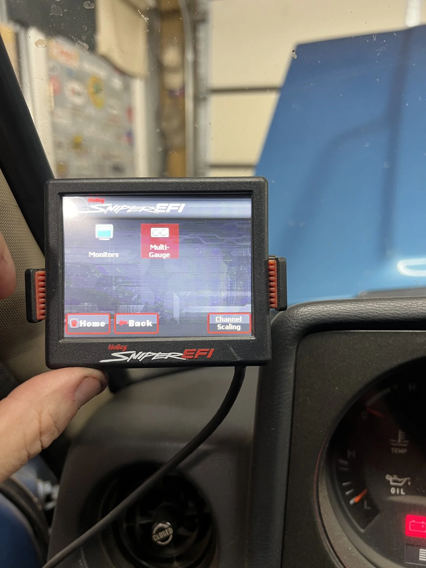

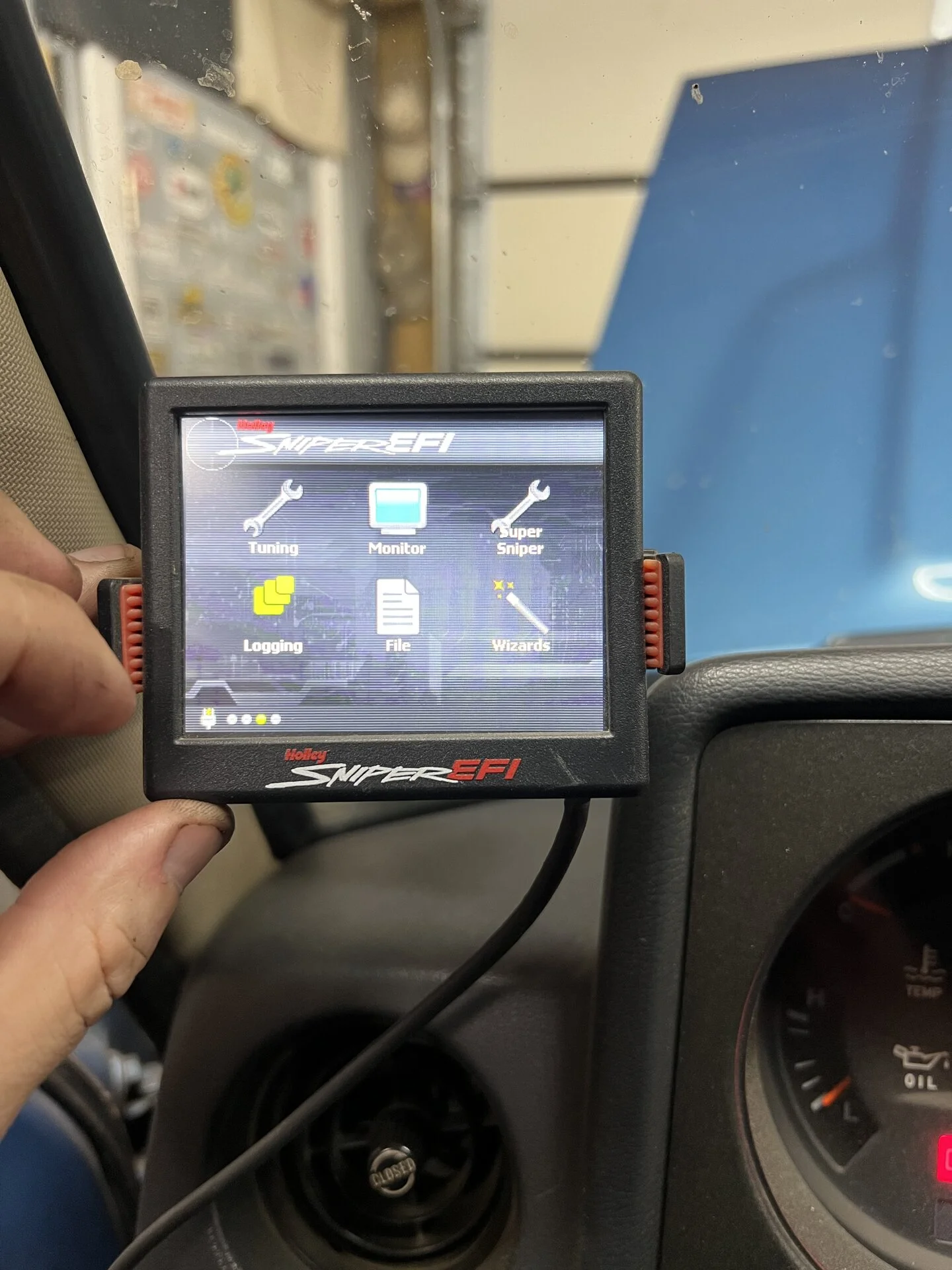

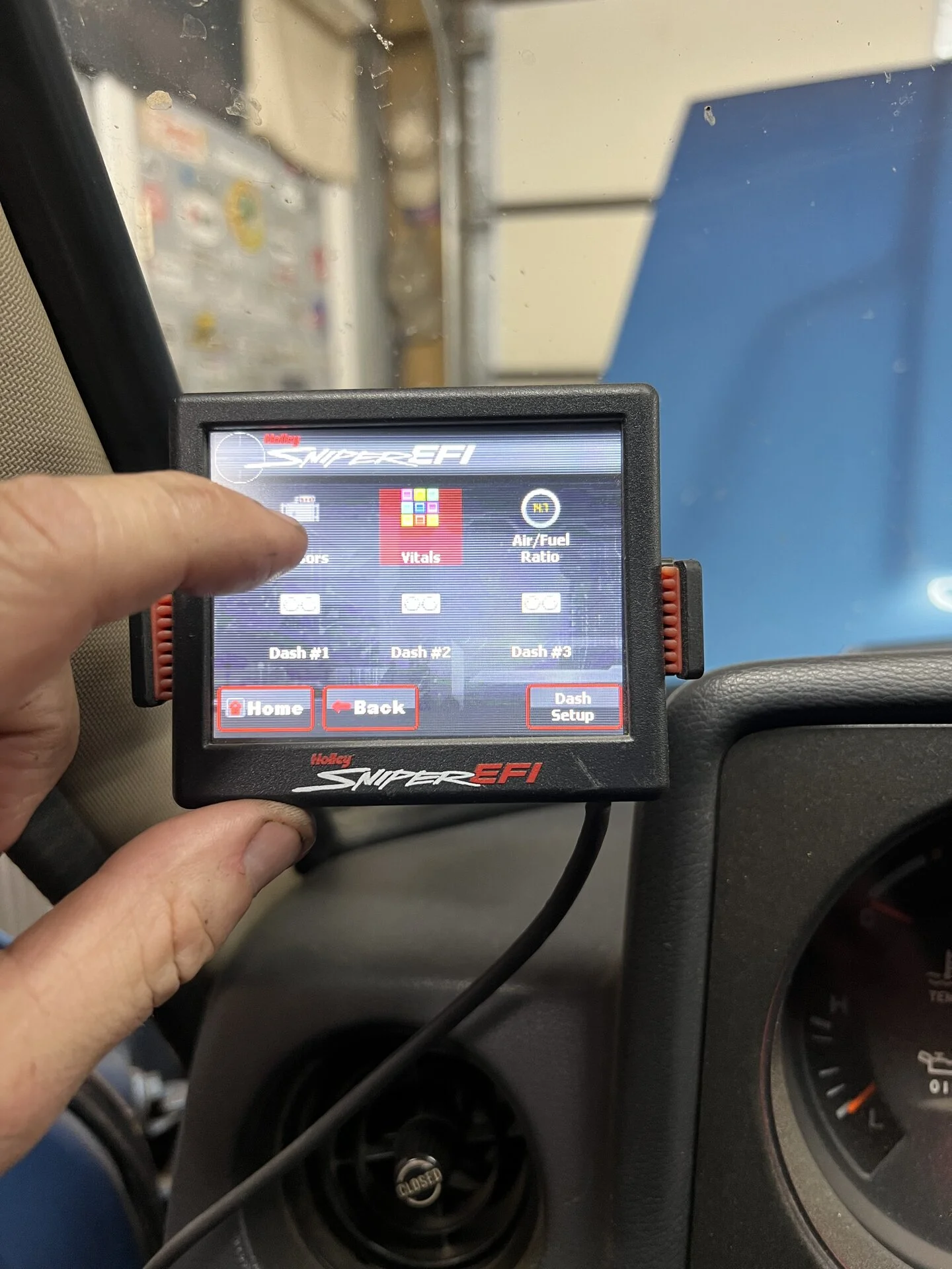

Go to this screen.
Start at home.
Hit Monitor.
Hit Multi Gauge
Hit sensors.
This way you can see Duty Cycle. All the good stuff is on this page

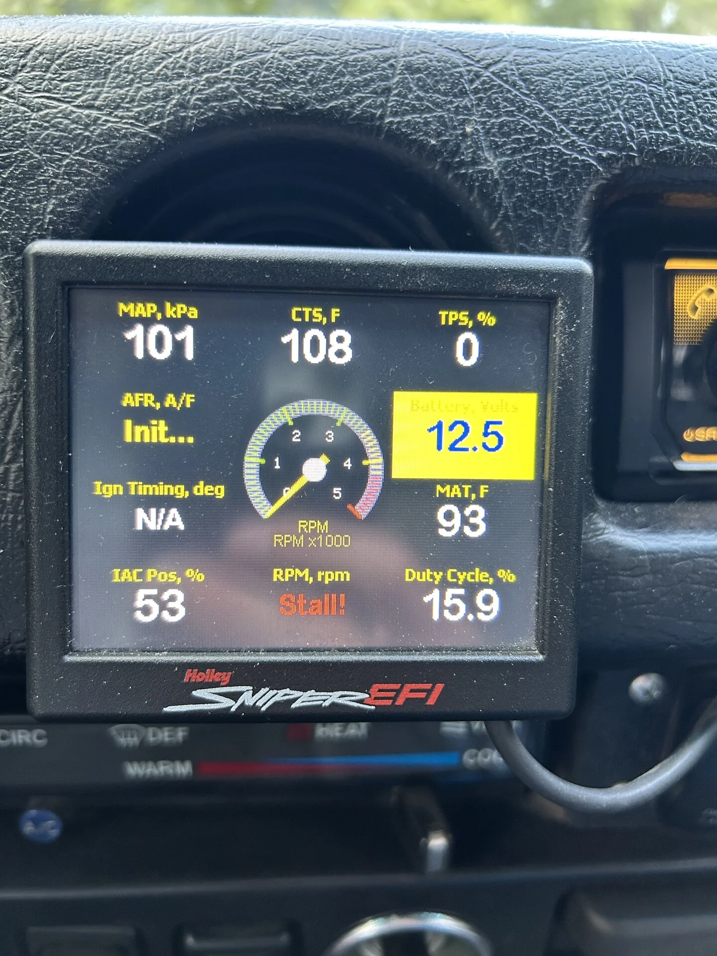

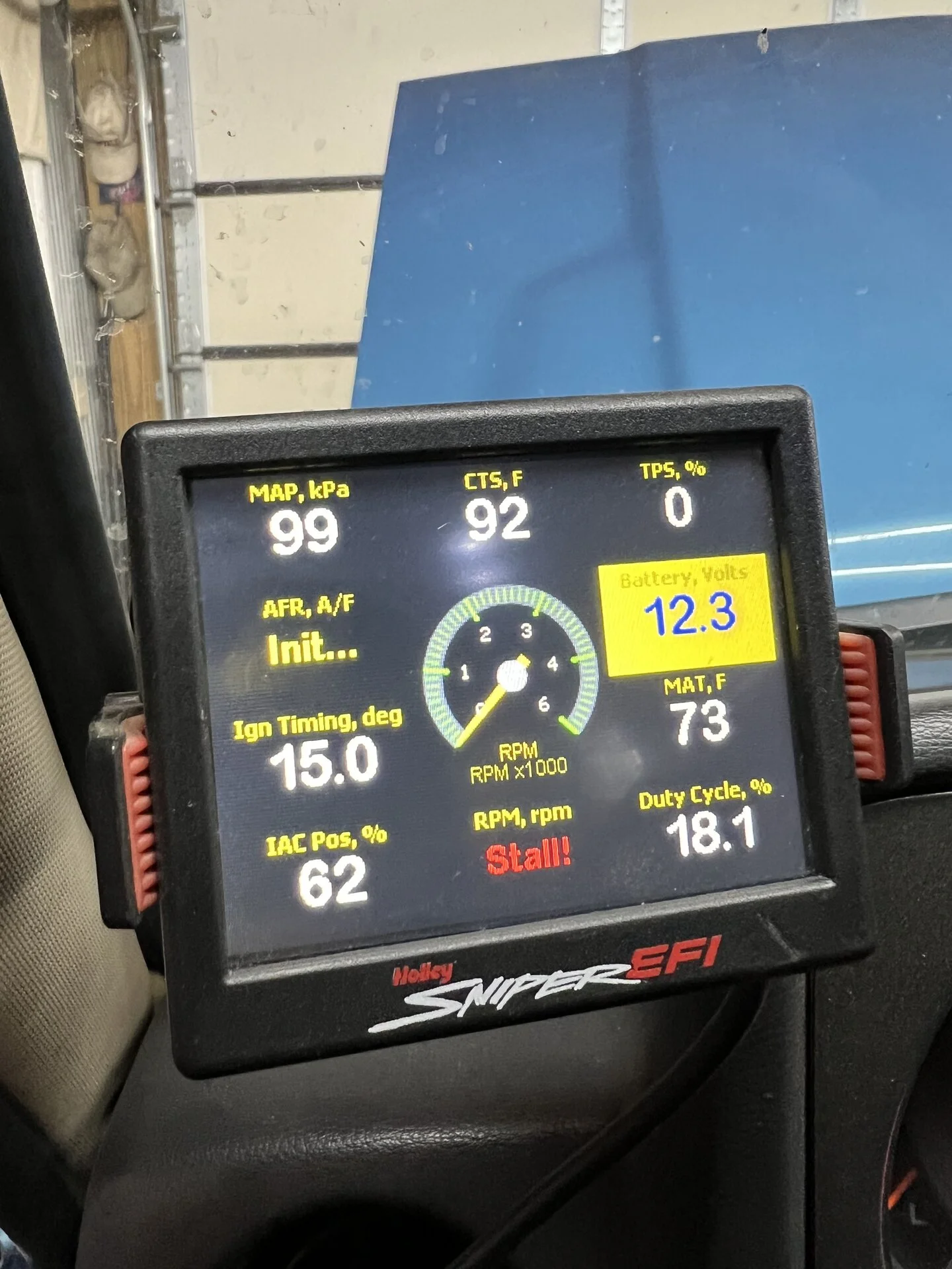

If I changed the ignition module with a different module (not the same part but another GM 4 point module), could that be causing this problem?
I have 20 or so DUIs (real Davis Unified, not a Chinese) and have never had any of them lose an ignition module. For you to lose two is where I would start looking

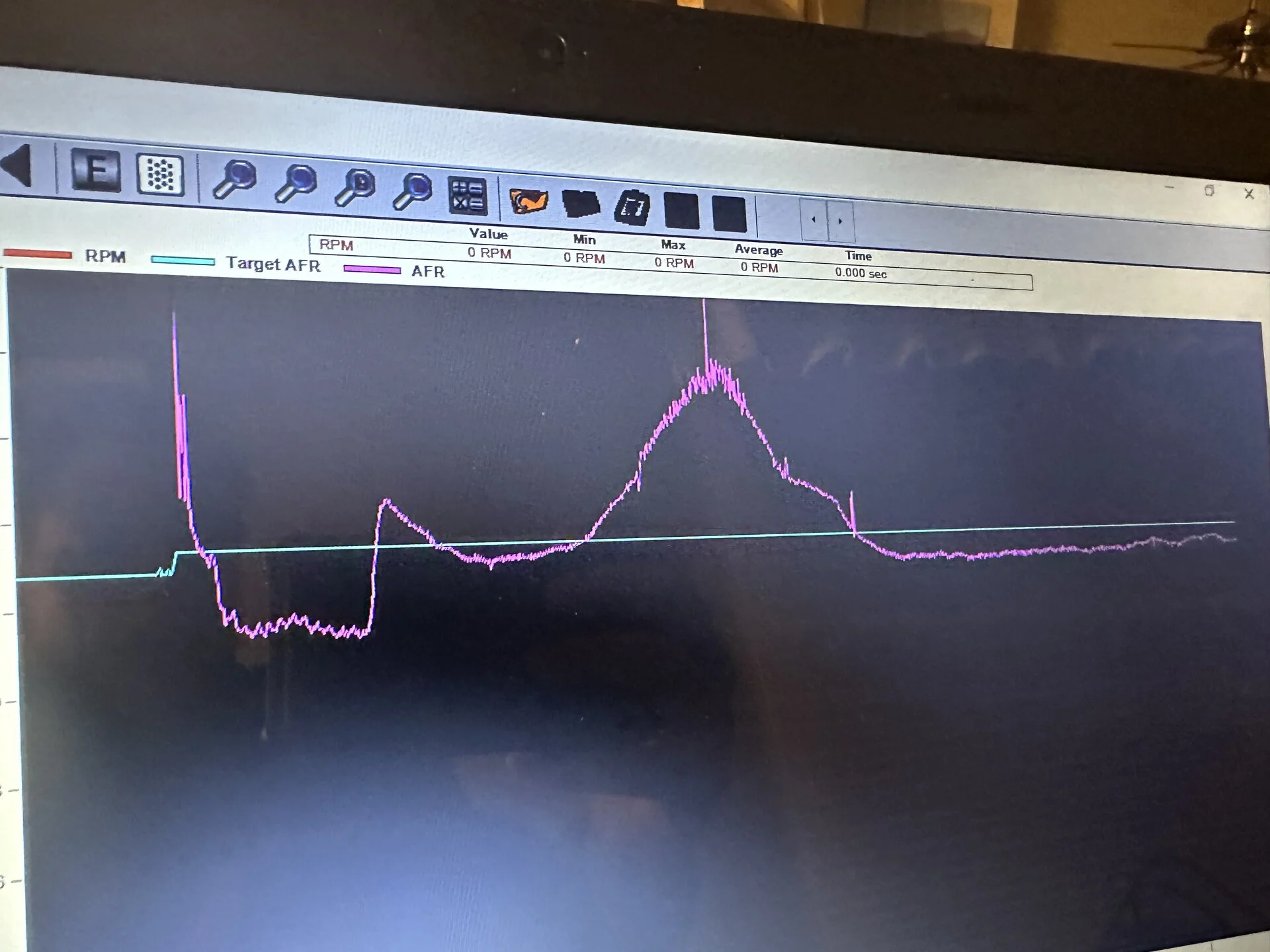

Still having issues with cold start lean spikes. Sometimes it’s fine, most times it’ll lean spike and sputter and recover. I’ve meticulously smoked the intake for vacuum leaks and made 2 exhaust side pre-O2 sensor leak repairs with no real change. A screen shot from a datalog last night shows actual AFR vs commanded AFR and you can clearly see it spike. It will occasionally do it when it’s warm too, but 95% of it is on cold starts.
Obviously seeing it on a graph is one thing, but I can’t really find an input other than condemning the 02 sensor without seeing voltages that jump out as a problem. No other inputs that I’ve been able to find dip with the lean spike. Everything stays steady. Anyone have any insight?

whats IAC % and commanded fuel mass doing at this same time?
IAC at the time of the lean spike is 100%. It goes 100% at approximately 6 seconds into a cold start and remains there thru the duration of the log, which is 18 seconds.
I will say that overlaying after start enrichment over the AFR that after the enrichment lowers down to approx 100% after about 13 seconds is when the lean spike begins. I’ll try extending the after start enrichment some and see what happens.

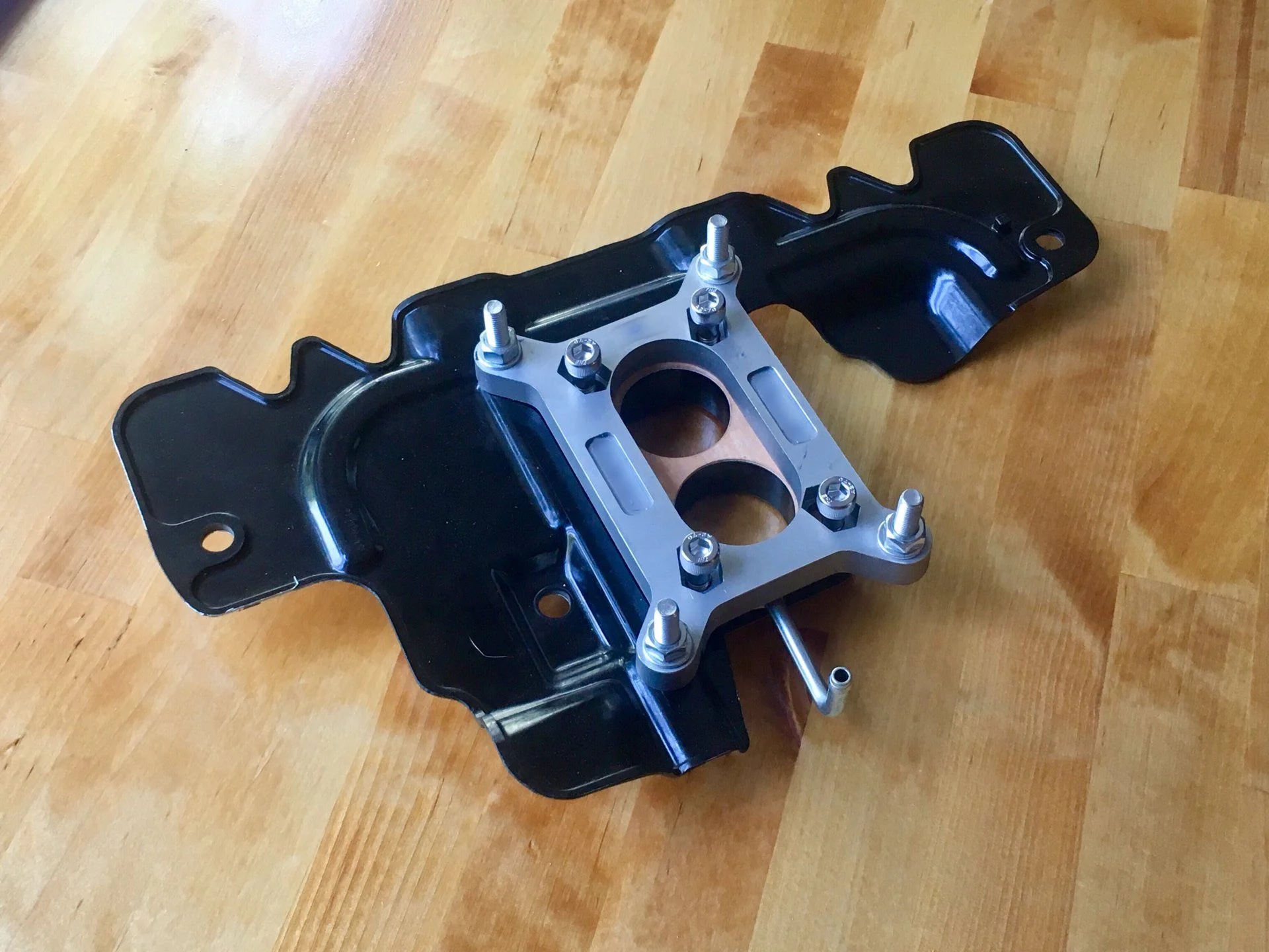

Give me a shout. We modify an inexpensive off-the-shelf adapter so that it sits on the FJ60 carb insulator, which is perfect for getting the height to clear the manifold studs and also acts as a heat shield for the Sniper computer. Comes with all mounting hardware.
I try to keep new carb insulators in stock too.

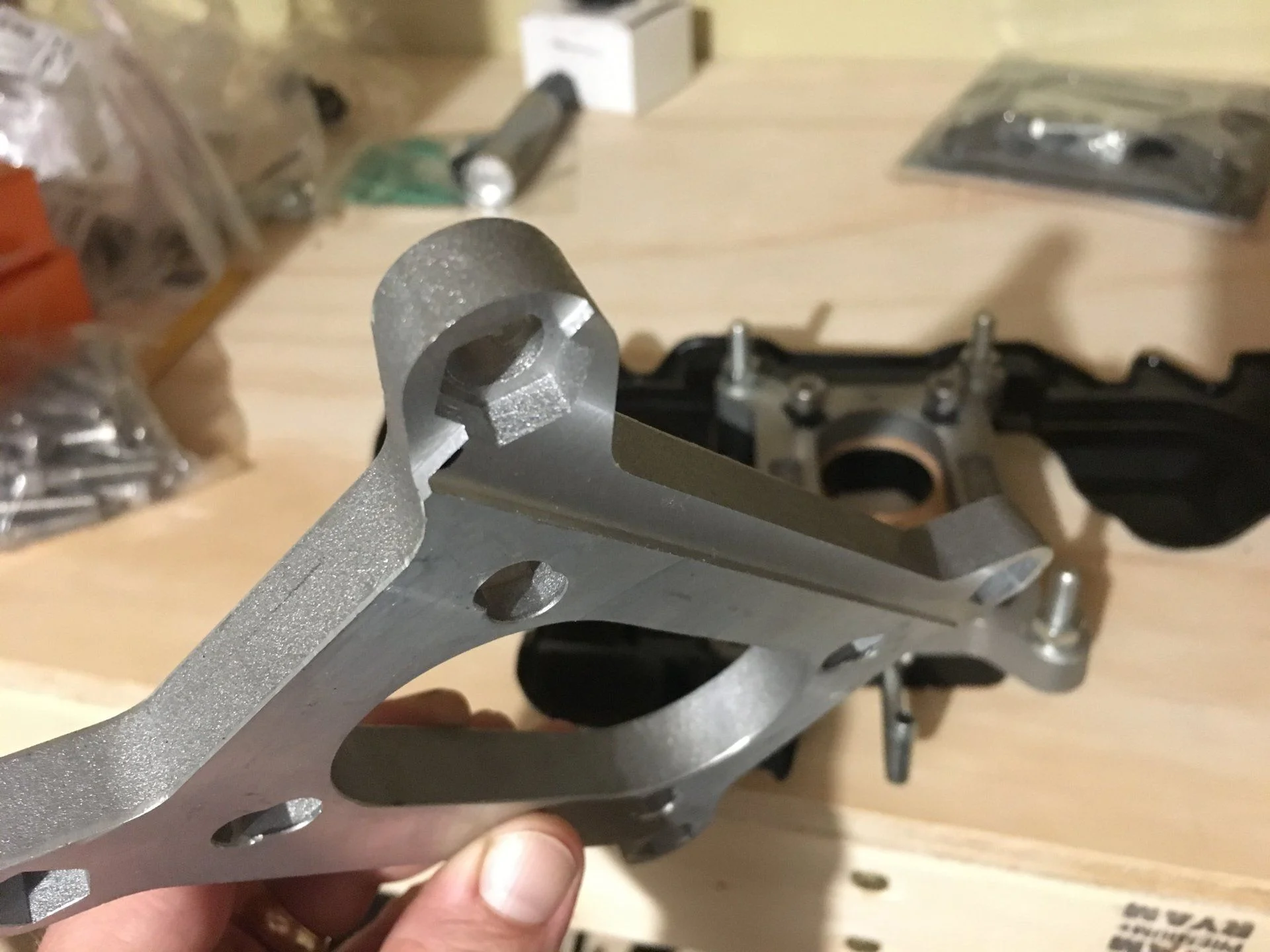

Hello Cameron, FYI the plate I received with my kit from you was possibly fly cut on the top just a bit too much so the heads of the m8 screws are proud by around .5mm (.020”). Not a big deal as I just used some DIN 7984 low head fasteners but wanted to let you know. It could be that the counterbore for that fastener isn’t held to super tight tolerances too since it’s cast.
Cheers, James
