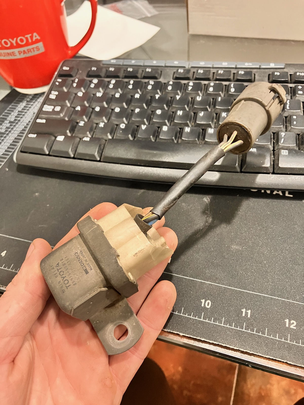

The part number is 85915-60010, they are not available new though. I haven't tried this but I *think* 85915-60030 (the ECU relay from LJ/KZJ Prado's) would work as an OEM replacement. I put one on order to test out, the mounting tab is a different angle but the connector and wires look the same in pictures. We had a KZJ78 at the shop this week and I could have looked at the one on it to compare but unfortunately it just got picked up and went home this morning :(

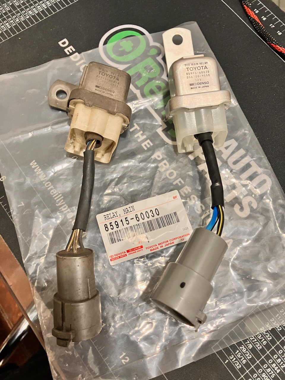

Finally got a 85915-60030 in my hands, looks like this will be a slam dunk as a new OE bolt in-replacement. We have a 62 here getting some work done and will test and confirm tomorrow. Will start stocking them if it works out!
They aren’t cheap but only cost a bit more then the time and materials recquired to make a new subharness with universal 4-pin relay, one could always DIY that with their old one for a trail spare though.

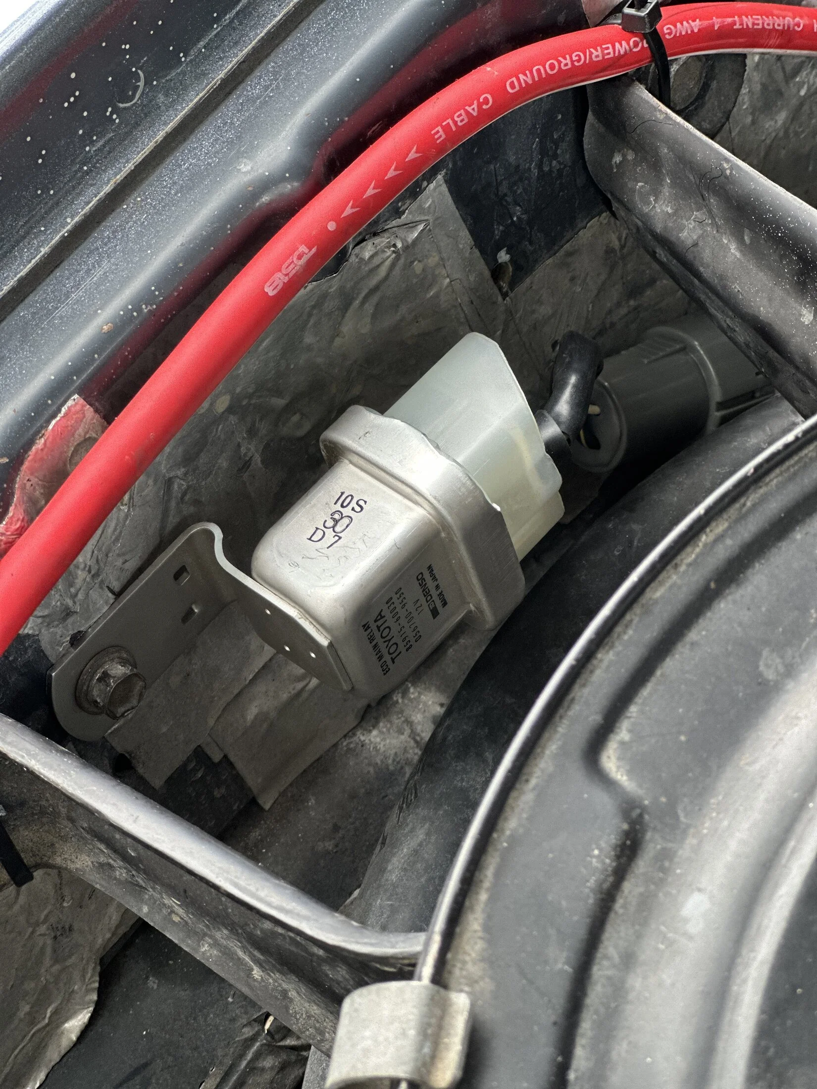

Confirmed fit and function, bolt tab isn’t 100% but it works.
Ignore the stupid speaker cable and aluminum tape everywhere.
