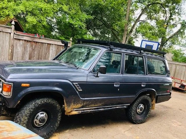

added front frunner rack (only picture I have at this time)

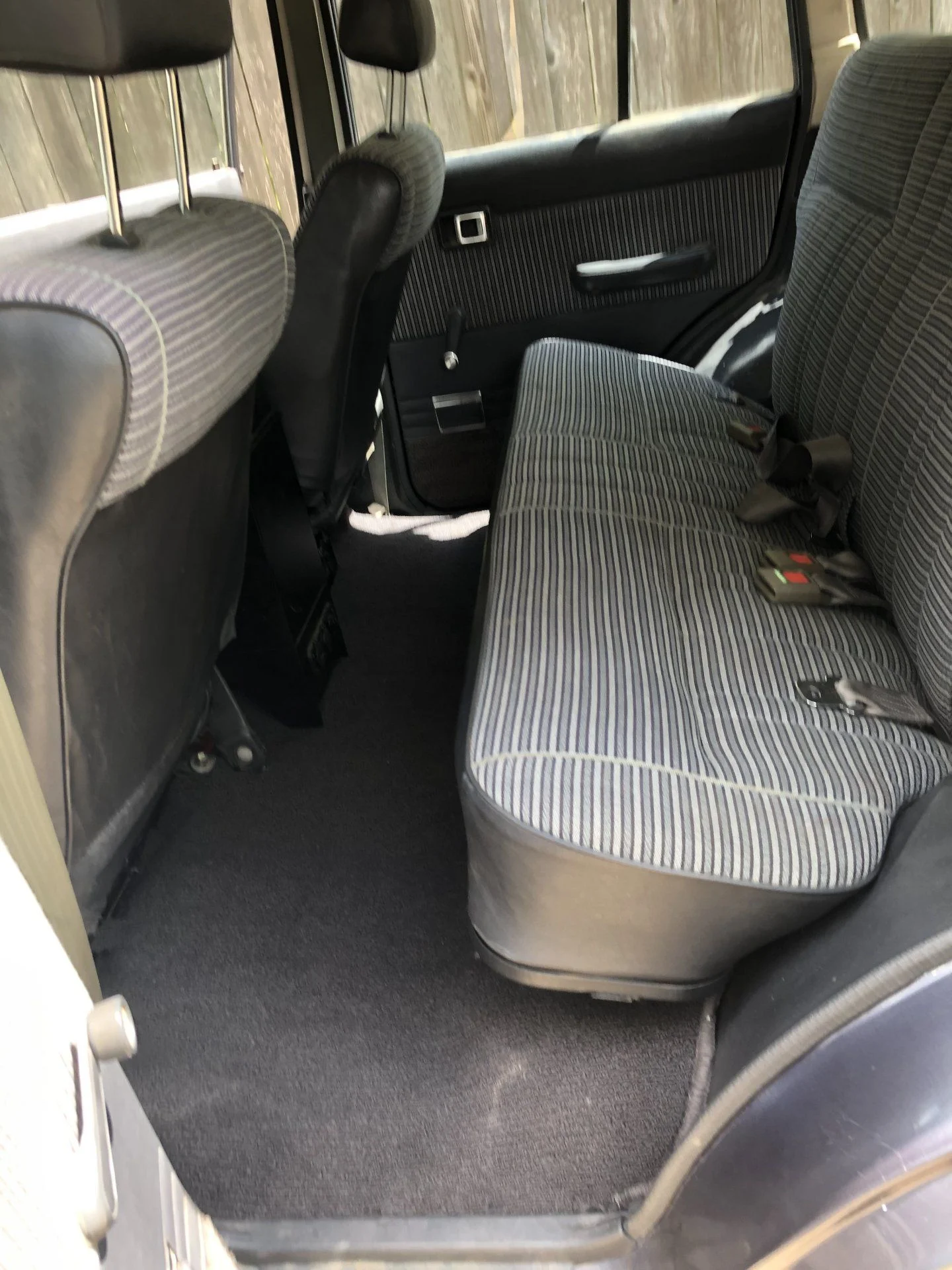

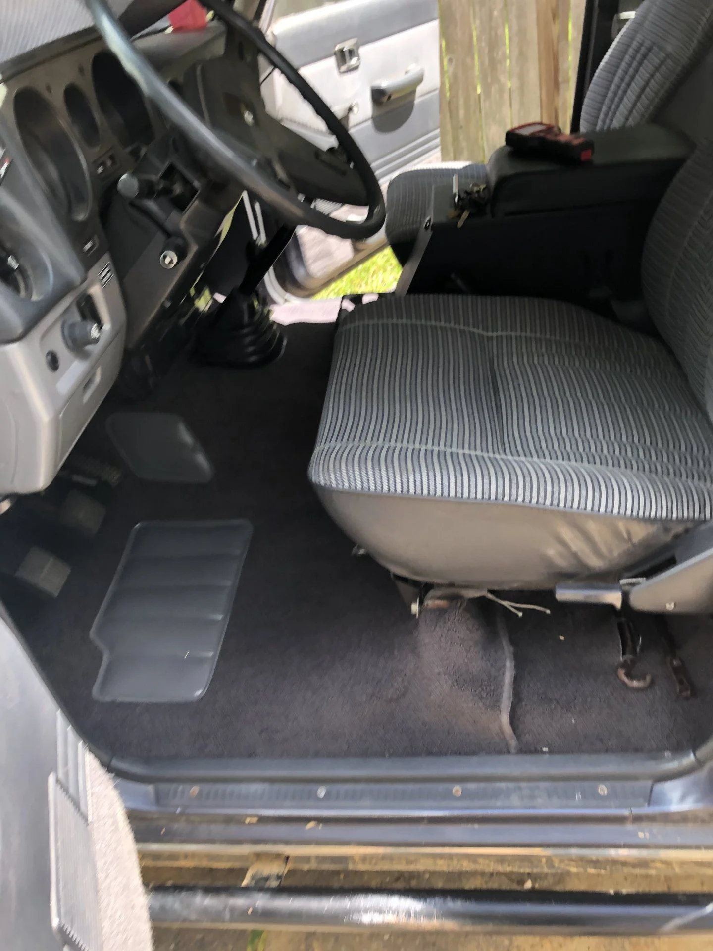

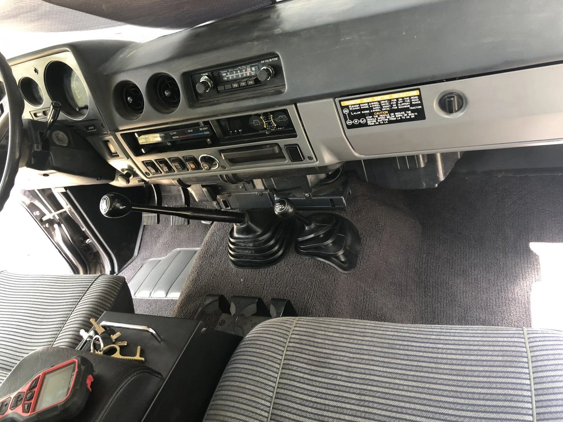

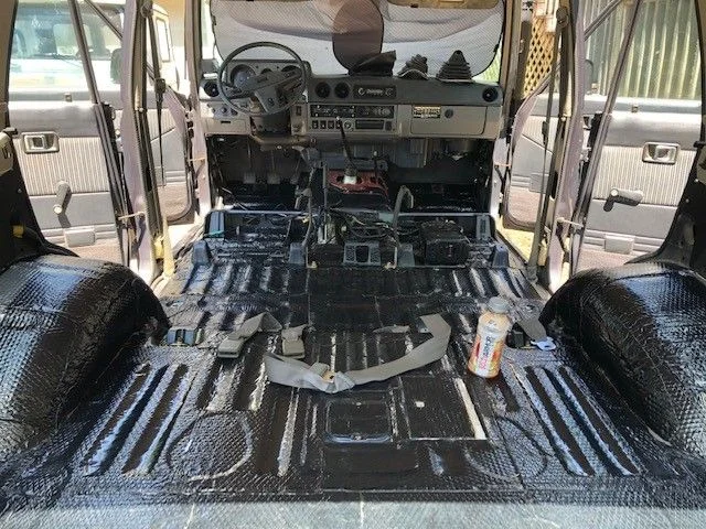

started on sound deadening and new carpet. Carpet kit sourced from @dnp
Sound deadening laid down all over with some solid help from my son and then I started fitting carpet. Carpet takes longer than I anticipated and will require a little more patience than I had this day so it is sitting for a few days.
See post #825 in this thread. I posted pics of the SRK-4000 bracket. Highly recommend the extension lever from Lokar as well. Tight fit working the cable around the brake booster but doable. Curious if these other brackets make for a cleaner install with the cable.
Finished up my carpet install, fairly happy with it. Covered it all up with Lloyd mats so should be good to go. Made a world of difference inside the cab. Took a poser drive way shot as I was backing it in as well.

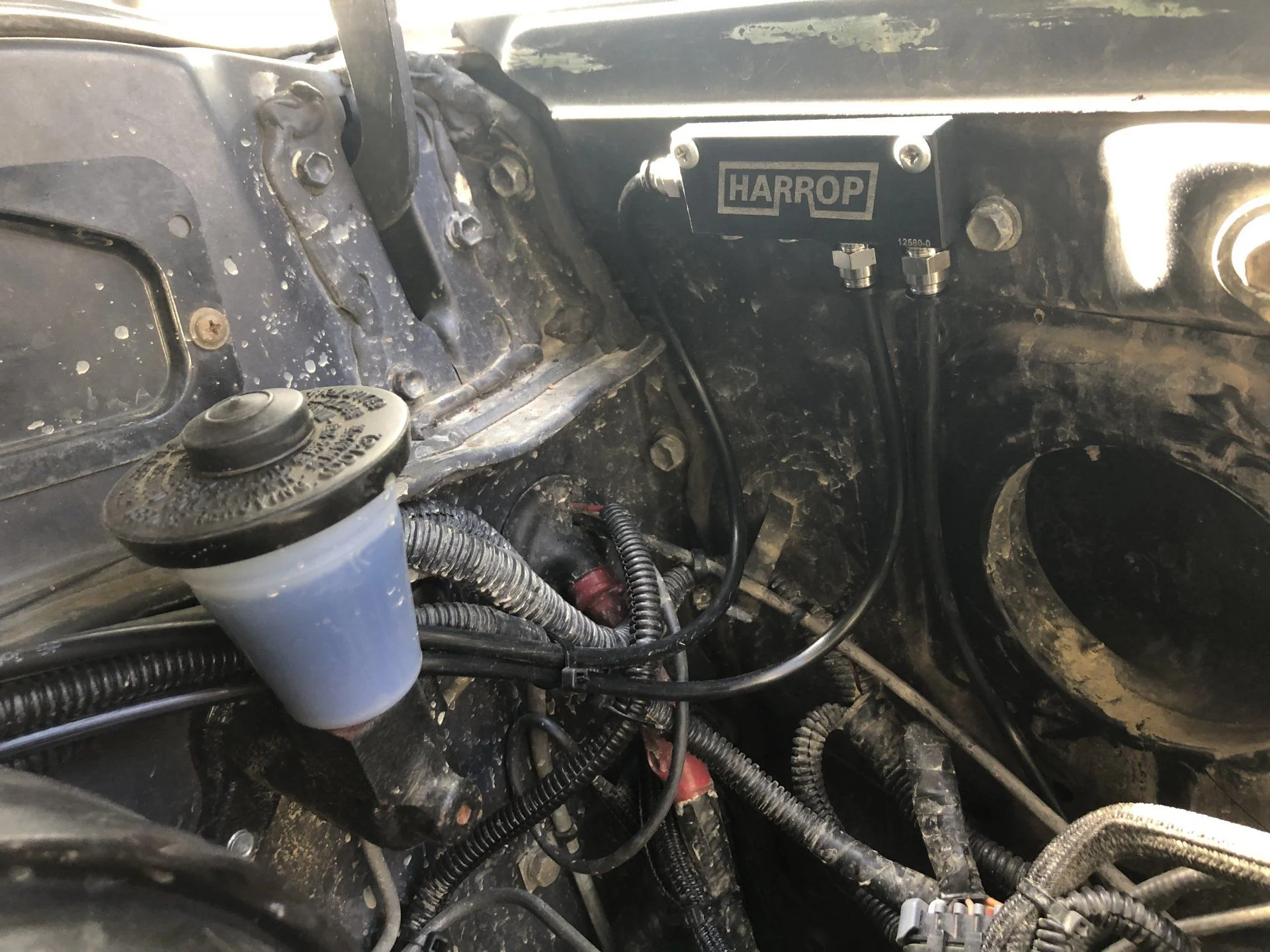

@orangefj45 got his hands on some Harrop dif breathers and sent me one. These are my favorite breather because they vent to a snorkel or air box. Took some time Saturday and got these hooked up. The air box I’m running had two capped ports so no need to drill. Ignore the dirty engine bay... truck has been putting in work!
