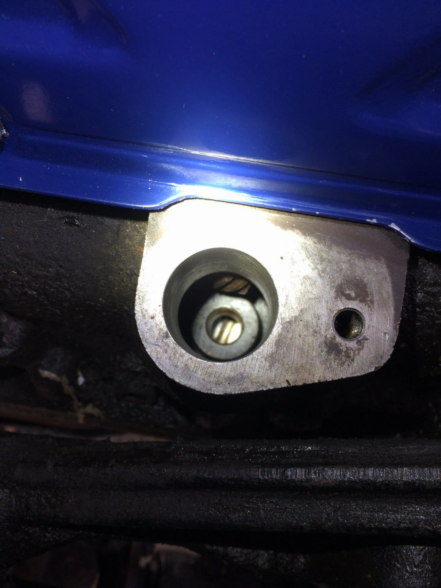

Is the #1 cyl at TDC? If yes, the rotor (dissy) is not correct. Should be between 4 and 3 sparker. Image in FSM.

Ok thanks. I marked the diz housing to the rotor tip when I pulled it out so I lined it up exactly how it was then. I'll check it out tmrw when I'm not working. Thanks Spike!
Fel,
If you didn't set #1 to TDC before you pulled the dizzy, don't worry about Spike's suggestion. There are many ways to skin a cat. As long as you didn't hit the key or move the vehicle in gear, just set the dizzy and rotor EXACTLY like you found it and move on. The main thing is to get the dizzy shaft positively connected with the oil pump and get the rotor where it was when you pulled it. The dizzy shaft has helical gears, so as it drops down, the rotor will turn a bit. If you start the process with the rotor where you want it to end up, you'll miss it by a tooth or two. Back the rotor up a smidge and drop in the diz and it will all line up. You'll get it. Just take your time.
Dave
Fel,
Dave

And that is exactly what I did... even sent you a pix as proof of the first when I sat it and it was off a smidge then I pulled it and sat it again. The pix above is proof of it being seated the second time.
Thanks for speaking up Dave. I knew in my gut that but 'course I had to second guess myself a bit when Spike spoke up. Even called my friend in ME to affirm it out loud.
I got your text. I didn't want you to undo your good work by second guessing yourself. Spike's advice is sound (as usual) but as I said, there are often many ways to accomplish the same task. You are on track. Keep it going!

Totally understood Galen, thanks! And yes, I was using a bright pen light to see the oil pump slot so as to be sure the diz shaft was lining up right as well. Too many times a third hand and another set of eyes would be so appreciated. I knew when the diz was fully seated because the housing would finally sit flush to the mount on the block.

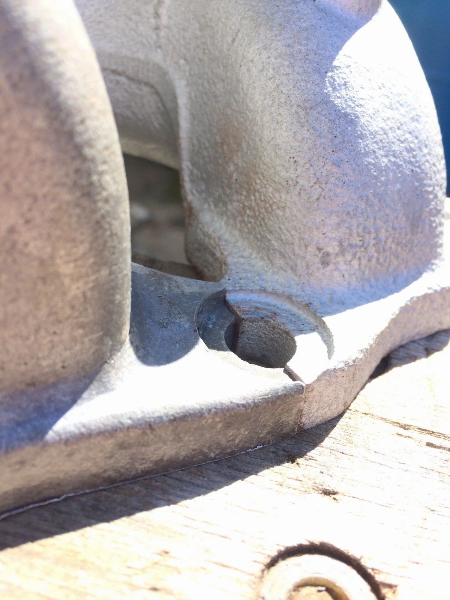

Ok so definetly had to file out the exhaust horn end flange holes. Love the file and how easy that is!
But was able to see the depth was different just on the intake sides of the holes so cut a washer and filed that down as well to fit inplace.

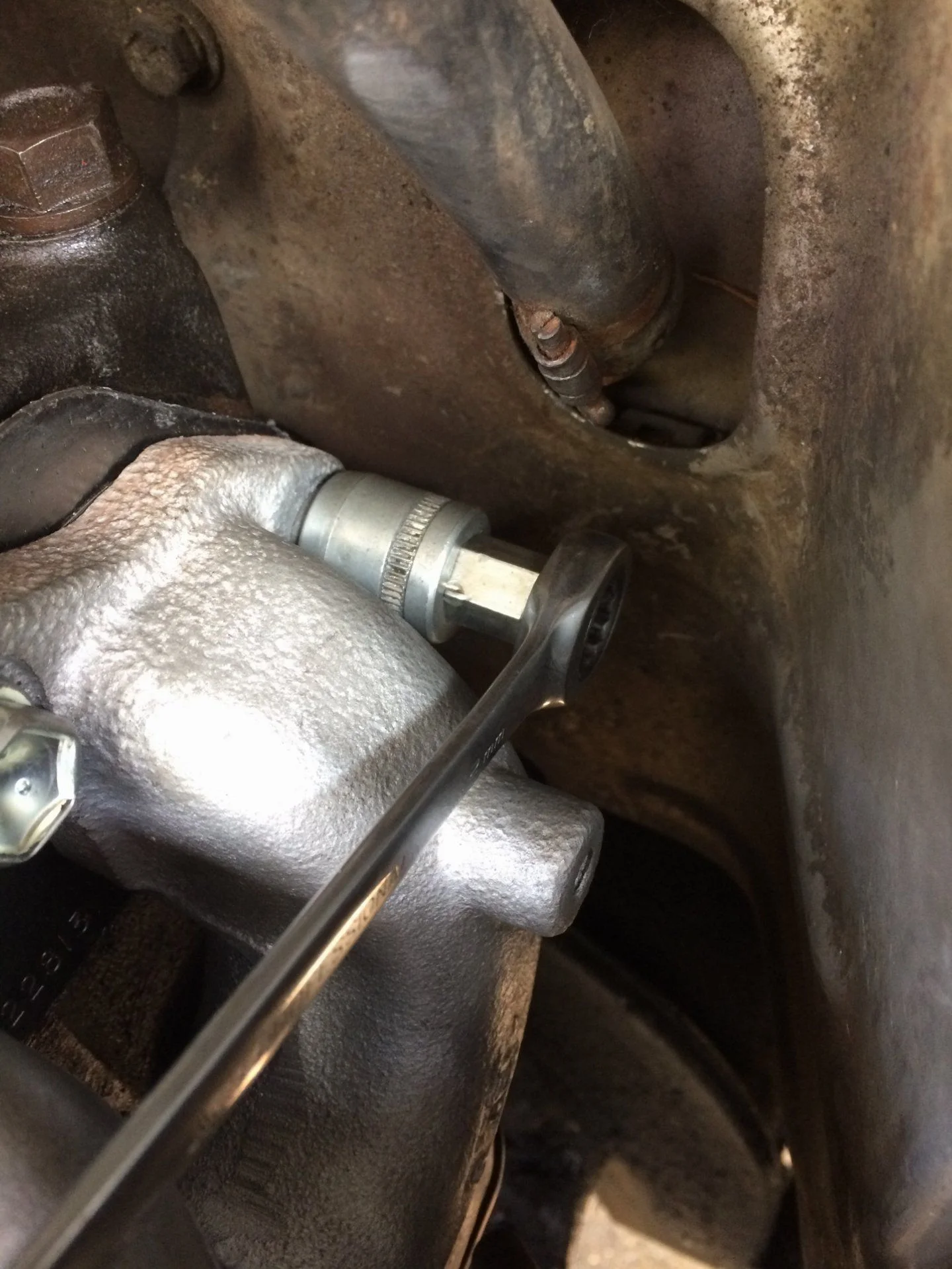

Oh holy s*** the torture of that last bolt holding the exhaust horn near the firewall. I seriously don't know how you men do it w/ hands far bigger than mine?!
I fought w/ just getting the bolt to bite till I finally got smart and used a flathead to separate the horn a smidge from the manifold. Then to get it twisted in I got wise and used an old tool w/ a new tool.
She's on now.
