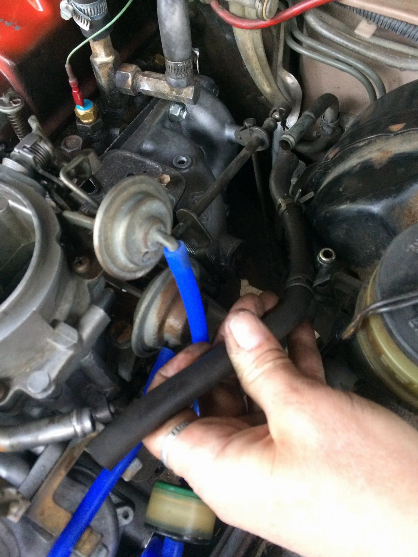

And this hose... I picked up a replacement 12" from Napa but the stuff he sold me is too beefy for the old clamps... he said it was simply air hose? Yes/no?

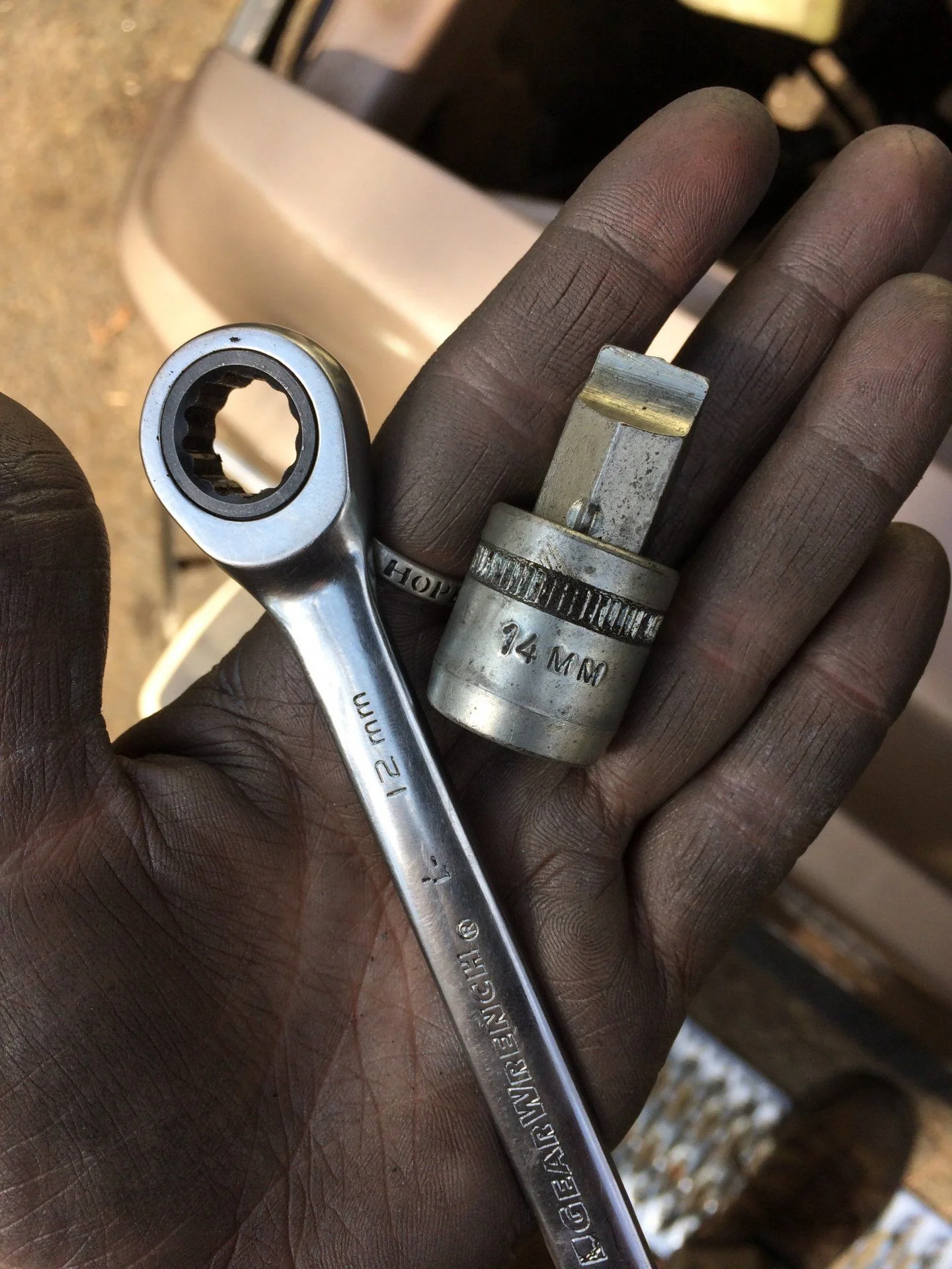

Oh holy s*** the torture of that last bolt holding the exhaust horn near the firewall. I seriously don't know how you men do it w/ hands far bigger than mine?!
I fought w/ just getting the bolt to bite till I finally got smart and used a flathead to separate the horn a smidge from the manifold. Then to get it twisted in I got wise and used an old tool w/ a new tool.
She's on now.

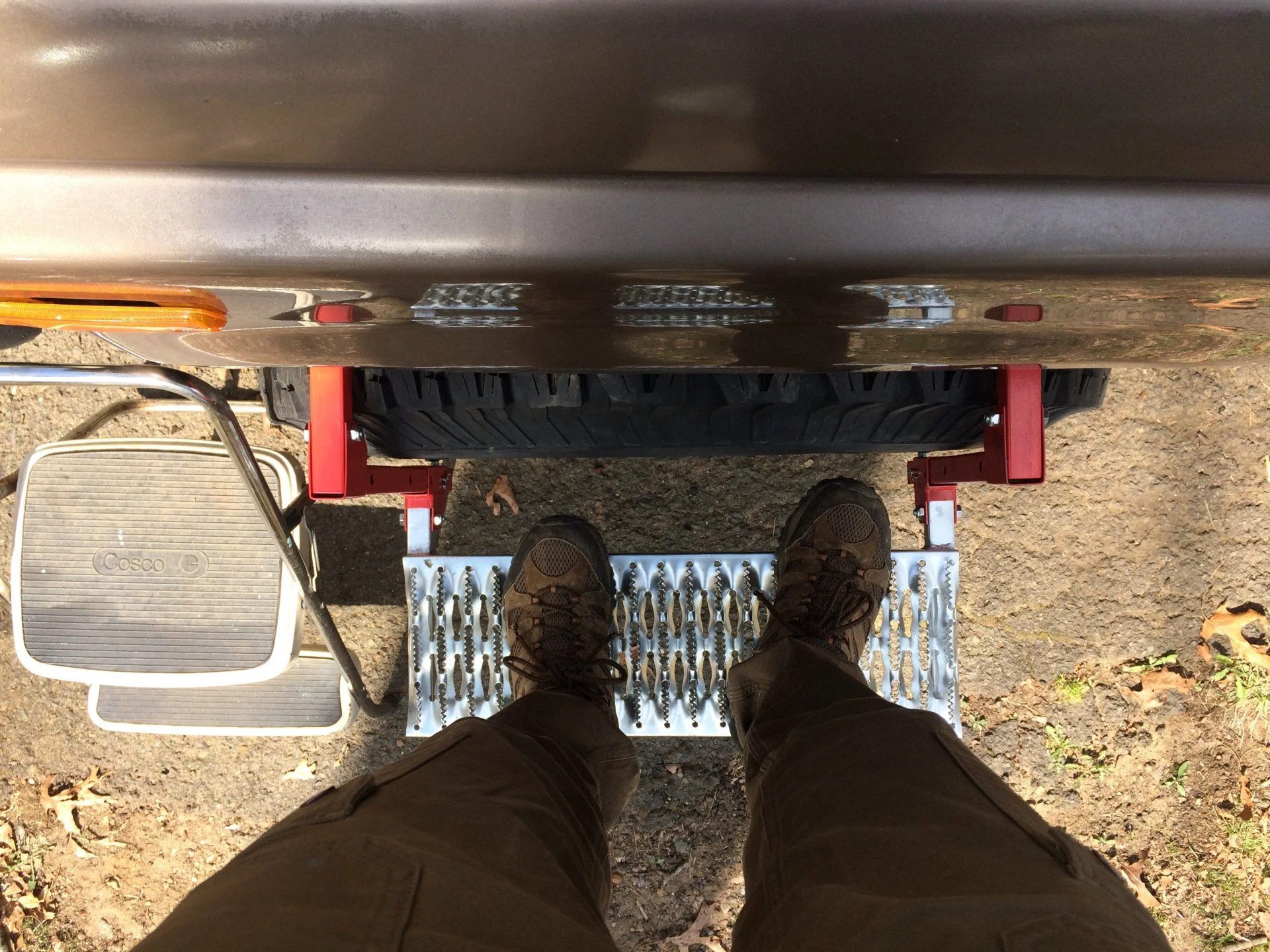

And who ever posted the pix of the tire step stool, thank god. I use it all the time now. Love it! Well worth the $50 or so it cost.
Nice work! Those are the moments I am glad some previous owner installed a 1" body lift on my truck - that much makes all the difference in a few places.
I'm liking the tire step! I can't count the times I have ate sh!t after slipping off my ARB, or the hub. I'm going to have to look for one of those.

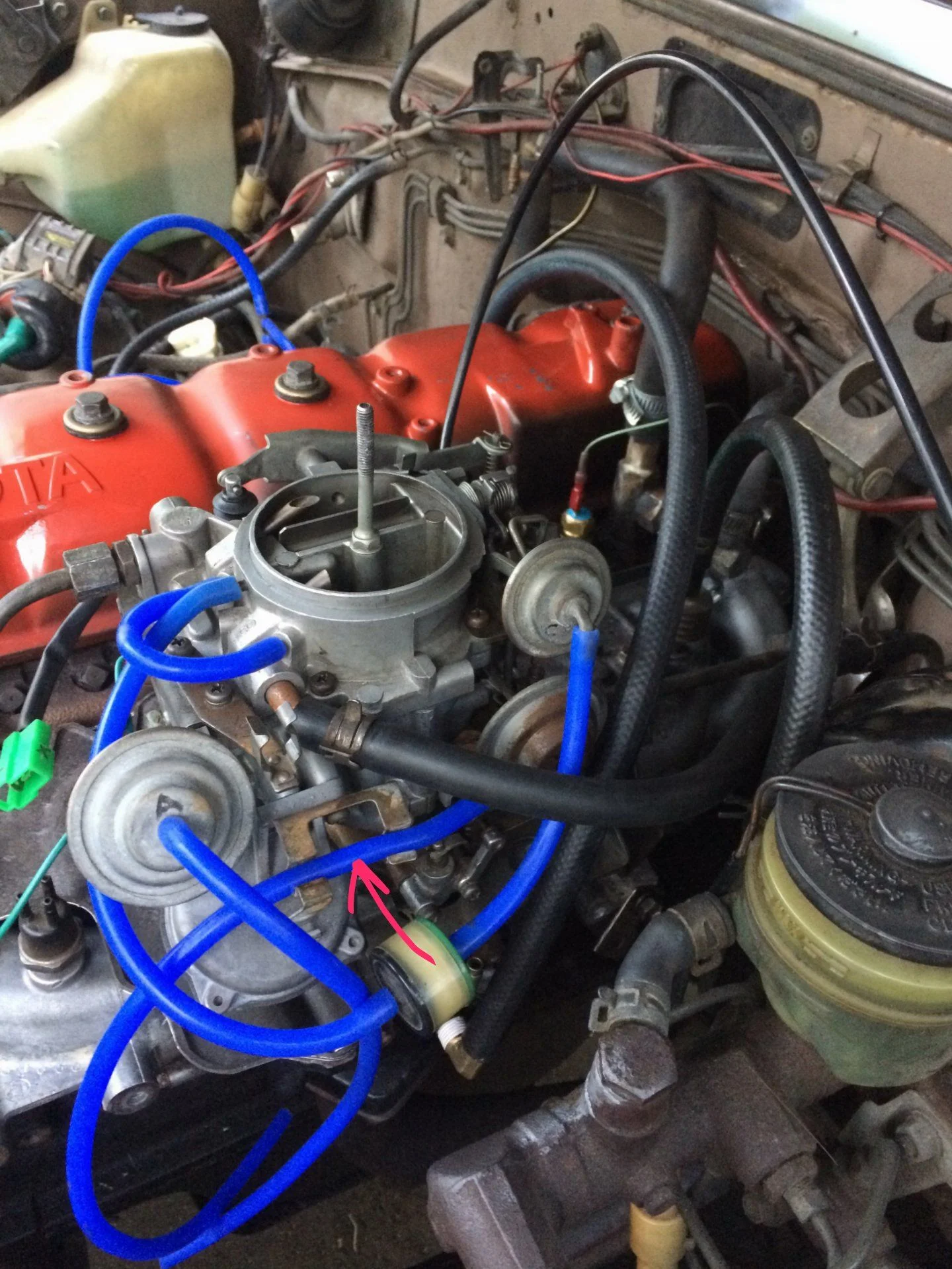

Ok. I swapped the clamps that were on the short section from the brake booster (forgive me if I'm saying the wrong name) to the finned piece. But I gotta find a few others a tad tighter for that pcv hose to the carb.
Yes, that hose.
Nothing on those threads necessary (pipe thread) but I always use anti-seize on stuff into soft aluminum.
"Yea that hose"... What's in that hose? Is it part of the heating system? Am I gonna have coolant leak out when I pull it?
Cut the temp sensor for the carb fan off the hard section of pcv pipe and it's going on the intake where there's two bolt holes meant for it.
That VTV clips in that bracket...
Gosh, what would I do w/o you?! Laughing. Yeah I kept trying to stuff it in there but the other hose was in the way. I need to look up that chart in my saved pixs that @Output Shaft added on a thread a bit ago about the length of hose on either side of each VCV and VTVs.
